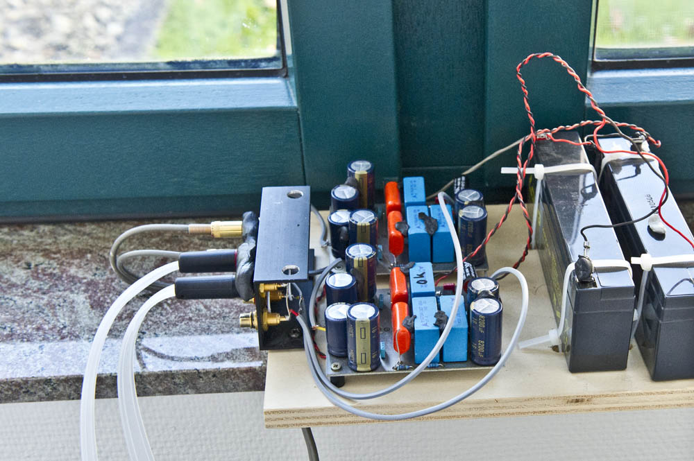

As far as i can tell it is the most popular phono stage i designed. On the FF2011 alone where 3 versions of it, Georg´s on a PCB designed by Holger Barske,
another guy had made a 3D version and Holger had my original "Igel" ( porcupine ) in his system. i think the reasons are mostly simplicity and low cost but the circuit sounds very well too. It also performs well technically.

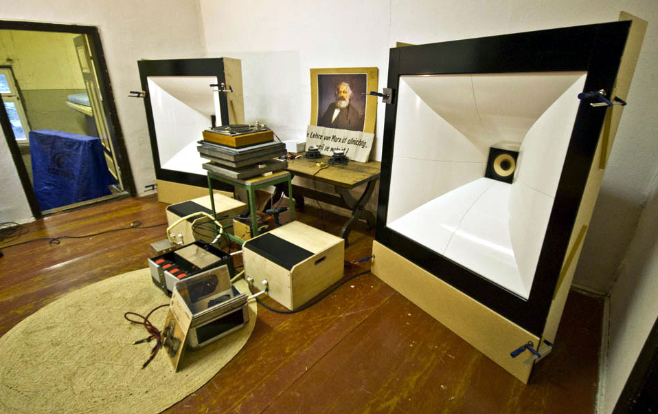

damps the cartridge including JC. That can happen when the cartridge impedance is rather high like in a high output MC. Shortening the inductance can then damp the treble. I have not made that experience, besides the input impedance of the Nobrainer can be adjusted over a certain range. Normally i set it at around 3.5mA and with that value it gave good results with my Lyra carts ( ca. 6 Ohm ), with the EMT´s and Denon 103´s ( 20 to 40 ) 9 and even in system with a 20 year old High Output Audio Technica MC. We played that cartridge on FF2011 on a system from our russian friends and the Nobrainer did not sound much worse then a very expensive siberian tube phonostage with an Auditorium 23 transformer. I was surprised. I will check where i find the specs of the Audio Technica. Andre`said that he found it after 20 years in the waist bin. It played just fine, i would even say spectacular on a restored Lenco L75 so please do not tell my great vinyl must be ultra. The russians, not stupid, had placed the table on an enormous substructure though. I will post a photo. Ok, so some think it´s over damped with a TI ( transimpedance ) stage, other have said like Tominari and Candeas taht it acts like a damper in the suspension of a car, preventing rattle by shorting the moving coil and acting like an eddy current brake. Anyway, i and people i trust like the Nobrainer as is. The last 3 days i have also being working on a discrete version. So there is some new wine in old bottles. So here is the original

Here is Georg´s Nobrainer on a PCB from Holger Barske.
See also the russian system i liked so much at Frickelfest 2011. See the stand for the Lenco. Cheep and effective.
