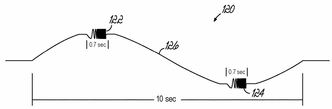

DATS LA and the Klippel LSI Analyzer work differently.
DATS LA measures neither displacement nor sound level. Ultimately, everything is derived from the TSP. A very low-frequency signal (e.g. 0.1 Hz) with varying levels is used to generate the operating point. A 0.7-second sweep for the impedance measurement is superimposed on this signal, the level of which is so low that it has little or no influence on the operating point (see attached pic)
The TSP for the respective operating point is calculated from the sweep. Once I have the TSP for the operating point, I can calculate the frequency response and, of course, the displacement (or simulate it, e.g., with VCAD). Whether 0.1 Hz is more AC or DC is debatable. In any case, it does not correspond to the dynamic excitation of the Klippel Analyzer.

Is there a difference between the Lorentz force for AC and DC current?

Yes I think there is substantial difference. Though in context of usability, I don't claim if one is better than the other. I am not sure if static model is actually more usable, but for the time being, I am fan of that one. It would take to compare static and dynamic measurements and correlate them to THD on few cases.
