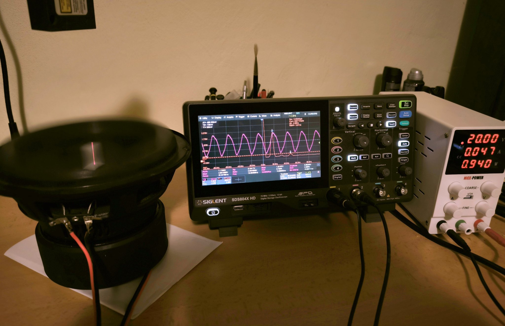

The basic rig for rudimetary testing is materializing! First THD measurements tests done. Crashpc happy! 🤭

It is just a "scope unpacked sensor taped to tripod" very first setup to test the gear function. In time, some metal rig for sturdy speaker mounting with membrane standing normally horizontally will be built, as well as more precise positioning rig for the laser probe, and verification with calipers could be possible and fast. The linearized output of the probe goes to the scope, when needed it is further filtered by mild LPF, then FFT is applied, harmonics levels are read and THD is calculated.
With Klippel approach, current and voltage needs to be read out, and with the cone motion measurement, it can be run through motion equations that ChatGPT provided.

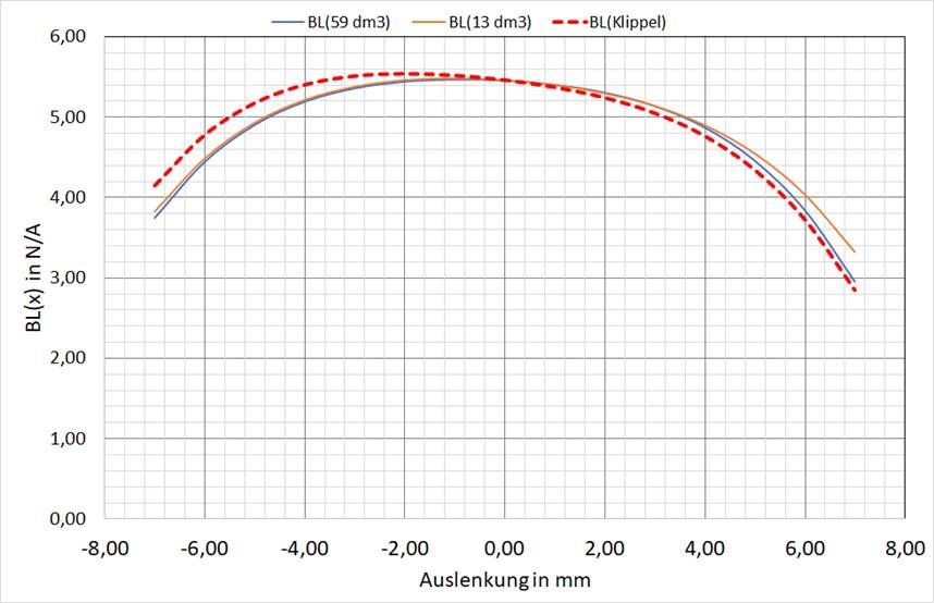

Some time ago, I was able to perform the above-mentioned comparison between Klippel and alternative methods (in this case similar to DUMAS). The DUT was a Visaton AL130. I would like to emphasize that the same unit was used in both measurements.
Regards
Heinrich
Regards
Heinrich
I see different volumes?Some time ago, I was able to perform the above-mentioned comparison between Klippel and alternative methods (in this case similar to DUMAS). The DUT was a Visaton AL130. I would like to emphasize that the same unit was used in both measurements.
Regards
Heinrich
They were all tested in the same volume incl Klippel?
Okay, because that can sometimes shift the results a little bit.No, the Klippel measurement was free air and the "DUMAS" measurement was (to verify the influence of the test volume) in 13 liters and in 59 liters.
But as you mentioned, in this particular case it doesn't seem to be effected that much. 👍 🙂
Interesting results, according to their specs, cone excursion should sit around 6mm (these days they even say 8.5mm, but that's just nasty).
According to these measurements, it's more like 5-5.5mm @ 82% BL
