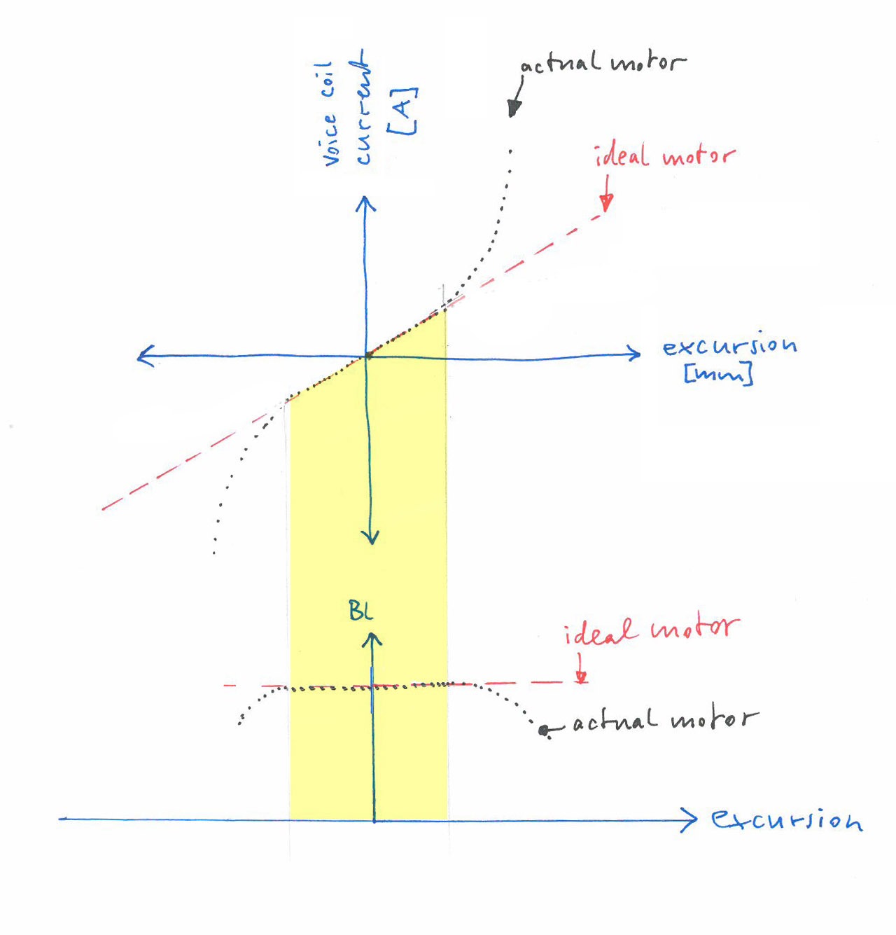

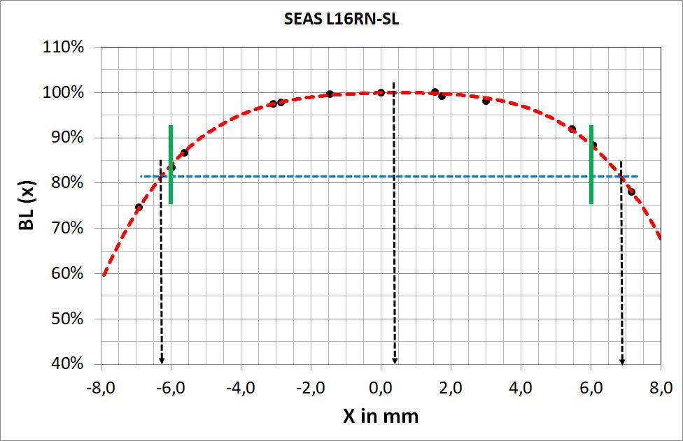

you can translate the excursion/current graph into a relative Bl graph.
see my measurements (only positive excursion, however negative excursions can easily be measured as well):
this would translate into (note i switched X and Y axes):
you could even measure Cms, by applying a defined force to the cone (e.g. weight in the form of rice, sugar, ... 1 kg translates to 9,81 N) and measure excursion and then calculate the absolute Bl value in [N/A].
by the way: [Tm] = [N/A] because [T]=[N/Am]
if I find some time I will try to adapt my measurement!
(edit: corrected second graph!)

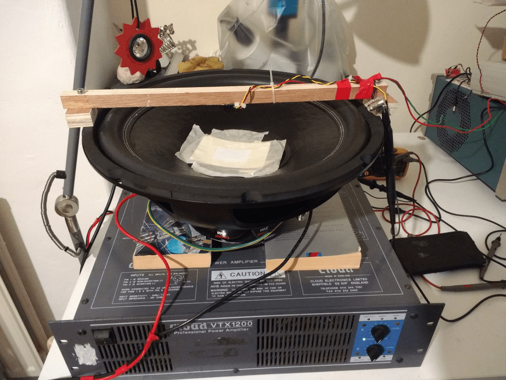

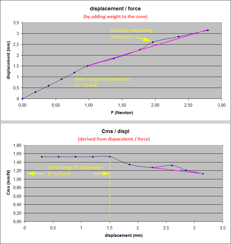

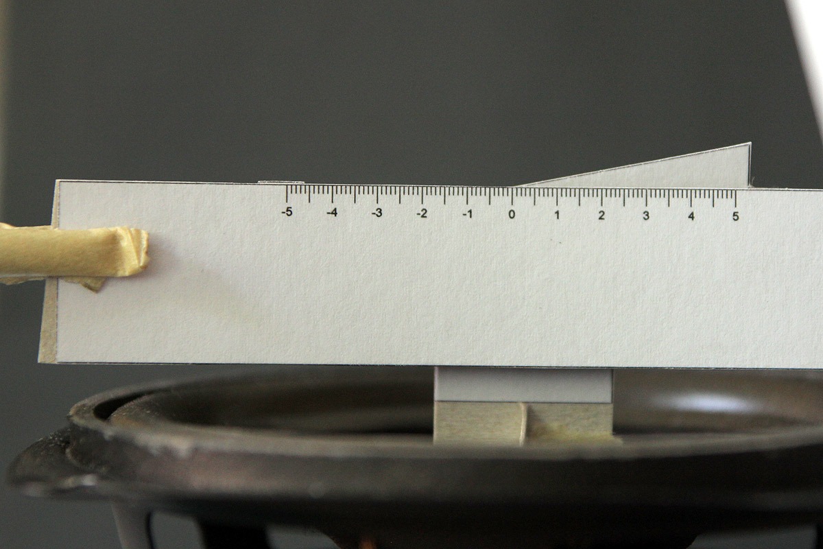

I took the low-tech measurement further:
first I made a new measurement jig, for better readibility. it includes a scale with 500% dimensions and a measurement edge with 1:5 slope.
for keeping the exact same measuring viewpoint I took photos with camera on a tripod.

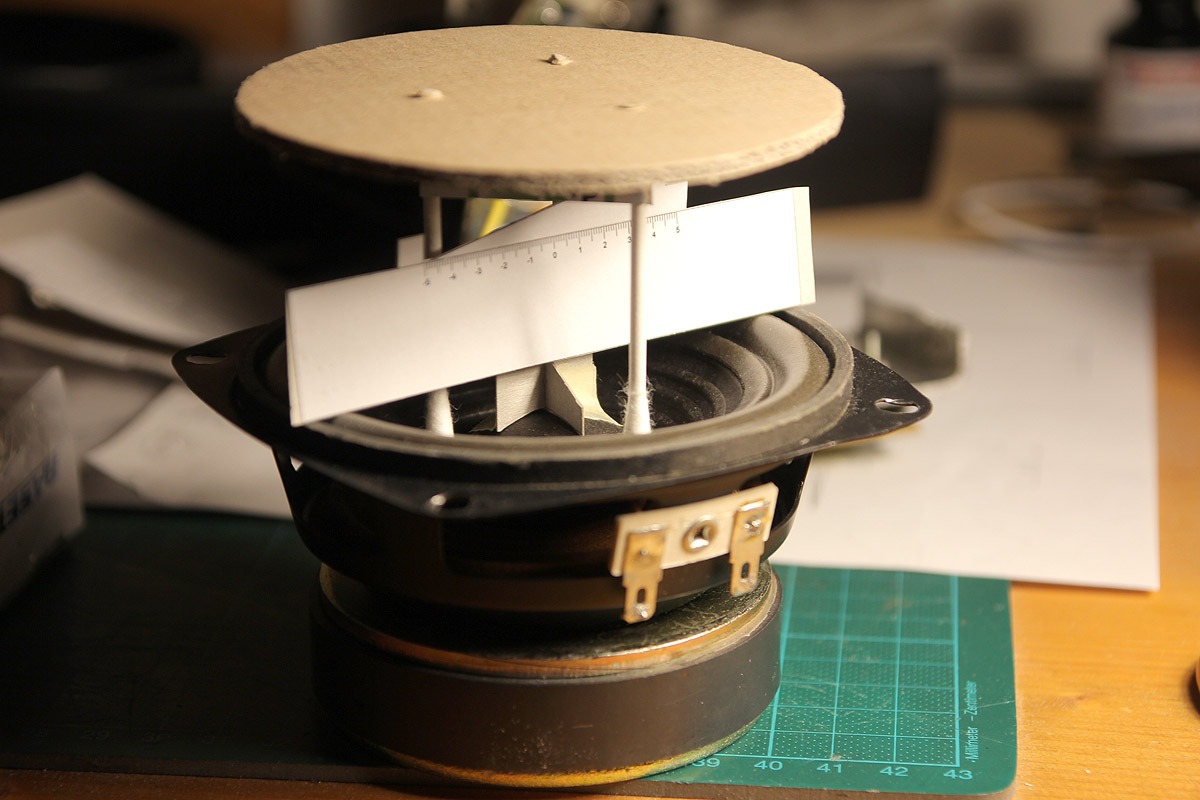

then i made a small platform for adding weight (force) to the cone.
the weight was measured with a small digital pocket scale. force was calculated: 102 g equals 1 Newton (at sea level, but that's ok i guess...).
max weight was 285 g / 2,79 N (using my leatherman tool), which was probably at the limit for this small driver.
by measuring displacement vs. force (= weight) I could derive Cms:
suspension seems to be linear until about 1,5 mm displacement.
obviously with this method I could only measure "downward" displacement.
also, the measuring may lack some accuracy - could probably be increased in a sterile enviroment 🙂.

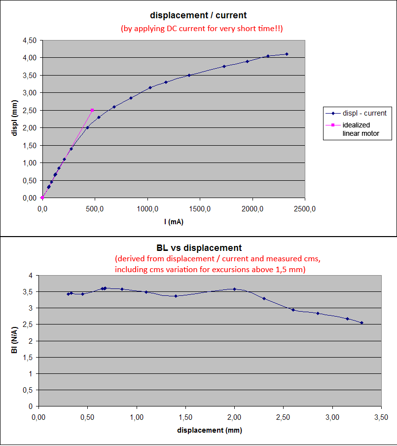

next step:
as done previously I connected the driver to a DC lab suppy to apply current. I did NOT roast the voice coil this time!
DC was only applied for short periods.
displacement / current graph is similar to the one done already.
from the Cms values for respective displacement I could derive the Bl (N/A) value.
again, keep in mind this is a rough experiment, but could of course be repeated with higher accuracy.
by the way:
according to a measurement of this driver in KLANG&TON from the 90ies Cms is 1,5 mm/N and Bl 3,2 N/A. seems to be in line with my measurements.
the manufacturer defines 2 mm Xmax, which corresponds to the Bl graph, however the suspension apparently already leaves the linear range at 1,5 mm.
note that I bought this driver around 1994 and the actual model of this driver definitely has other TSP values.
also it proves that the foam surround used by monacor does not disintegrate after 30 years!
next step:

stv: Thanks a lot for your experiments: the second plot shows exactly what I was looking for.
How have you noticed the surround plays evil above 1.5 mm?
How long should the current "injection" last? A few seconds or so?

not sure whether it is the surround that is "evil" - i rather suspect it's the spider, or both.
this will just result i increasing uneven harmonic distorsion when driving that small speaker loud and/or low.
I noticed it when drawing the force/displacement curve (and then, drawing the Cms/displacement curve).
displacement is proportional to the force up to 1,5 mm displacement. after that the displacement does not increase proportionally anymore.
it took me about 1 second for each measurement:How long should the current "injection" last? A few seconds or so?
- switching the output of lab supply on
- releasing the camera shutter (the cone has stabilized by then)
- switching the outoput of lab supply off
I waited for some time after all measurements for the voice coil to cool down. this is just for the protection of the voice coil. it should not alter the measurements.

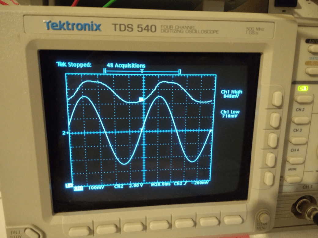

I managed to perform some measurements using a sharp GP2Y0A51SK0Fdistance measurement sensor and a scope. The distance sensor samples at ~60Hz asynchronous to the signal gen so I used 16 average mode on the scope (upper trace is distance sensor). I drove the driver at 5 Hz with a cloud VTX1200. I have also taped white paper to the cone to get a better reflectivity. The distance from the sensor can be found using the following equation (from published curve): z = (V/3.76)^(-1/0.814). From this I found a difference of 1.5 cm between the minimum and maximum value which is ~ xmax (8mm one way). Obviously easy way to improve the results would be to get the sensor closer to the cone into its more sensitive region. I also noticed some asymmetry in the clipping when not driven so hard presumably from gravity.
Quite interesting results could be obtained with some PC data logging and a current sensor as it would be possible to plot the displacement Vs coil current and also the back EMF.

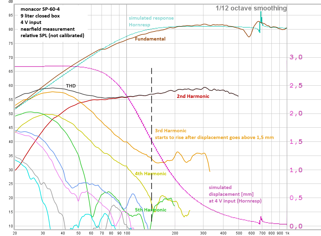

I was curious: how do the DC displacement measurements translate to THD?
attached the harmonics for the tested driver with the displacement simulation done in hornresp.
the correlation between the 1,5 mm linear displacement limit and rising harmonics is clearly visible!
