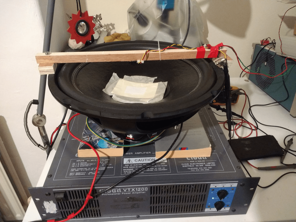

I was playing with this too. Bought Laser sensor to measure the cone distance, but I mostly stopped at the cone loading issue. pro drivers might need as much as 50kg weight onto the back(and front too) of the cone. That is hard to do, and harsh on the cone too. So I'm stuck but as far as I know, Klippel does all this without need of weight at Fs of the driver. He knows more. Go figure. We're too by young and dumb at this point.
"pro drivers might need as much as 50kg weight onto the back(and front too) of the cone"

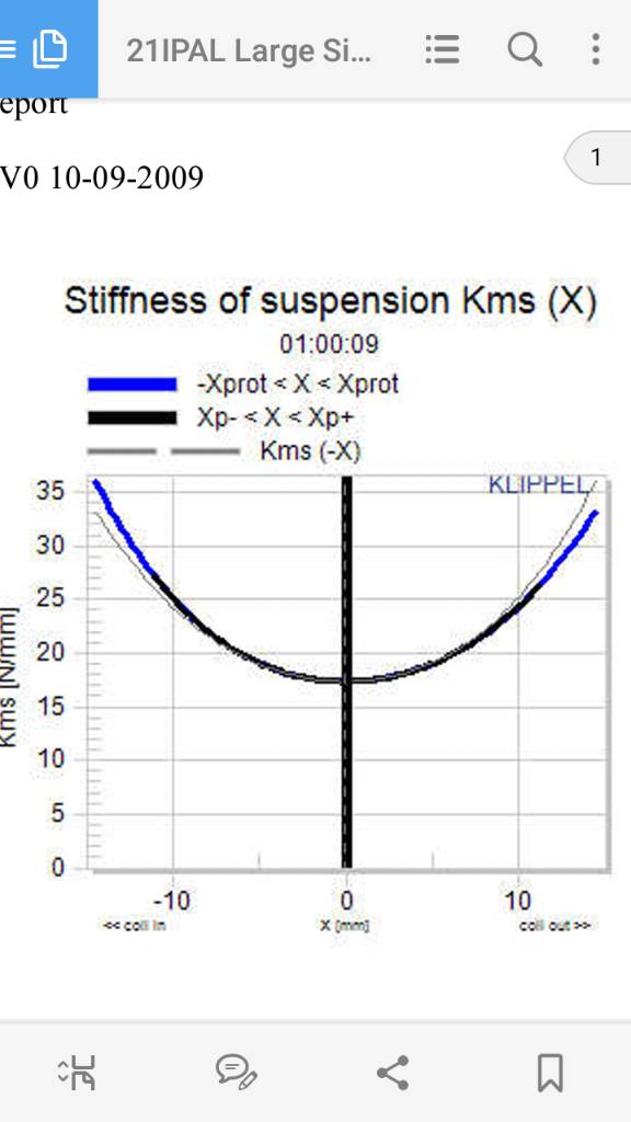

In the attachment, there is 21IPAL Kms graph. I know you can´t do it exactly that way, obviously, but at ~15mm of excursion, you have what seems to be 36,5N/mm stiffness. If you multiply the stiffness by X (15mm), you get 547N. That is, 55,7kg. It obviously will be less, due to the Kms curve, but the IPAL is supposed to move to 20mm of excustion, not 15mm, so the math will more than offset this negligence, if we are just only about the number. And so, for best hardcore, stiff drivers, you might indeed need ~50kg of weight on the cone, if not more. More ordinary drivers seem to float around 20-25kgs.Could you help me out with the underlying calculation of the 50 kgs?
Getting the Cms this way is not gonna work, since the static stiffness is totally different than the dynamic stiffness.I took the low-tech measurement further:

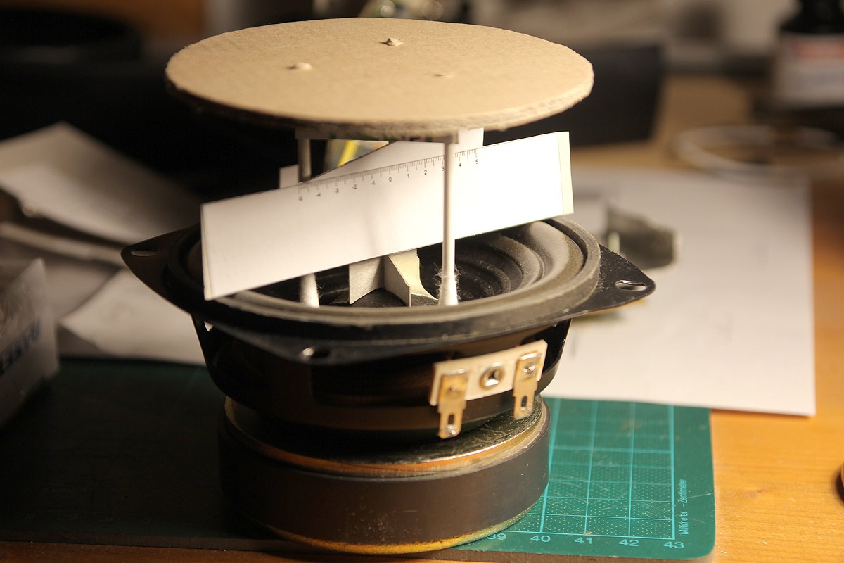

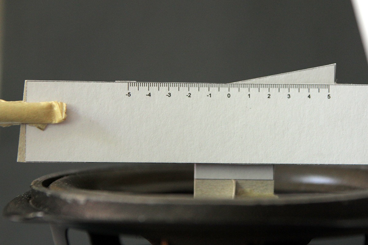

first I made a new measurement jig, for better readibility. it includes a scale with 500% dimensions and a measurement edge with 1:5 slope.
for keeping the exact same measuring viewpoint I took photos with camera on a tripod.
then i made a small platform for adding weight (force) to the cone.
the weight was measured with a small digital pocket scale. force was calculated: 102 g equals 1 Newton (at sea level, but that's ok i guess...).
max weight was 285 g / 2,79 N (using my leatherman tool), which was probably at the limit for this small driver.

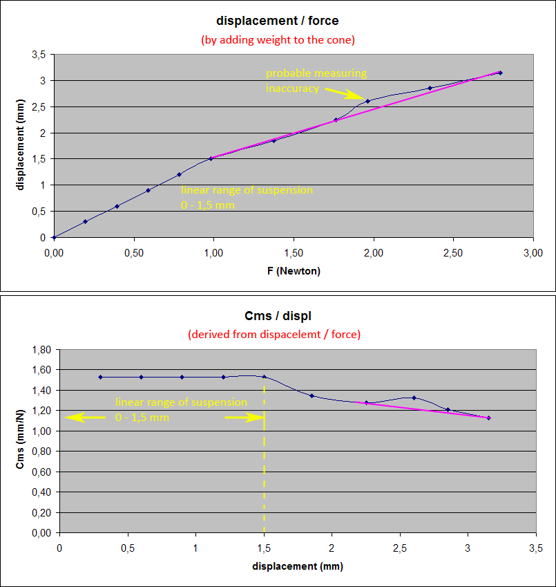

by measuring displacement vs. force (= weight) I could derive Cms:
suspension seems to be linear until about 1,5 mm displacement.
obviously with this method I could only measure "downward" displacement.
also, the measuring may lack some accuracy - could probably be increased in a sterile enviroment 🙂.

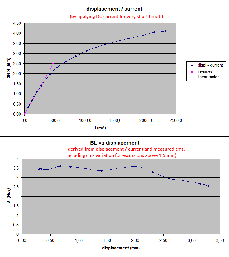

as done previously I connected the driver to a DC lab suppy to apply current. I did NOT roast the voice coil this time!
DC was only applied for short periods.
displacement / current graph is similar to the one done already.
from the Cms values for respective displacement I could derive the Bl (N/A) value.
again, keep in mind this is a rough experiment, but could of course be repeated with higher accuracy.
by the way:
according to a measurement of this driver in KLANG&TON from the 90ies Cms is 1,5 mm/N and Bl 3,2 N/A. seems to be in line with my measurements.
the manufacturer defines 2 mm Xmax, which corresponds to the Bl graph, however the suspension apparently already leaves the linear range at 1,5 mm.
note that I bought this driver around 1994 and the actual model of this driver definitely has other TSP values.

Applying air pressure might not be that hard to do. I once tested a couple of subwoofer boxes for leaks by sealing the speaker hole with a rubber gasket, steel baking tray and some weights put on top, and breathing into the reflex port (don't forget to line the inside with rockwool or fibre-glass batting! 😉 O/t).
As an indication of the forces involved, forcing a large 3-4L breath of air into 40-or-so litre boxes was much much easier than inflating a party balloon. A test box could be fitted with a bicycle tube valve, although the pressure might be too low to get the valve to click. A valve from a mattress or inflatable toy might a better bet.
And then find out what happens to the frequency response at various offsets!

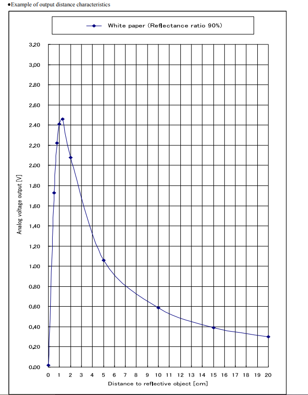

Hi, I know this topic is from two years ago, but I have a question. Your method is interesting, but this IR sensor works at distances greater than 2 cm. Does that mean its precision starts after 2 cm? And is it accurate down to the millimeter?realy nice results, you could replace the manual distance readout with one the Sharp IR voltage output distance sensors for improved repeatability:

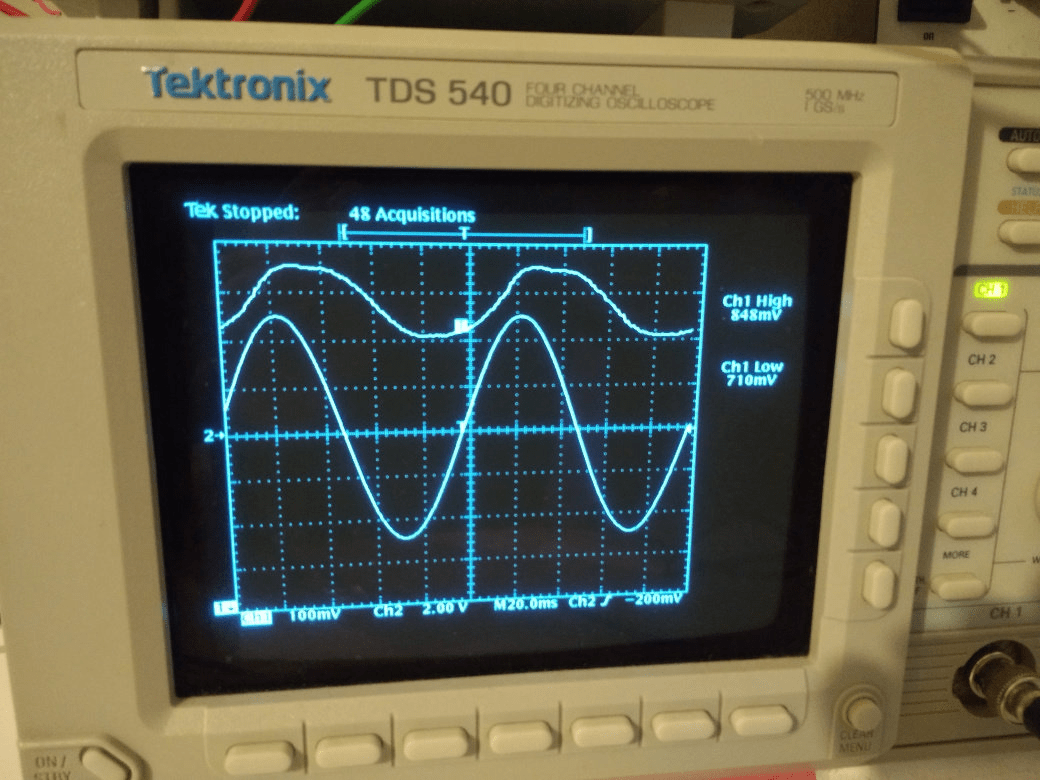

Top plot is distance sensor output and the bottom plot is drive voltage.

@DIY-lover: usually, distance sensor works using mechanical distance range limit or time * phase limit. If the signal does not get received within these bounds, the measurement is failed. There is not much of less precision behavior outside these bounds. It just doesn't work.

The response curve of the SHARP IR (GP2Y0A51SK0F) sensor shows a very steep slope within the first centimeter, indicating high sensitivity in this range. However, positioning it this close to the driver is not feasible. Between 2 and 5 cm, the slope becomes more gradual, with the voltage dropping by approximately 0.4 volts for every 1 cm. This means that for each millimeter, the voltage changes by 0.04 volts. Is it a sufficient resolution for accurate measurements?
