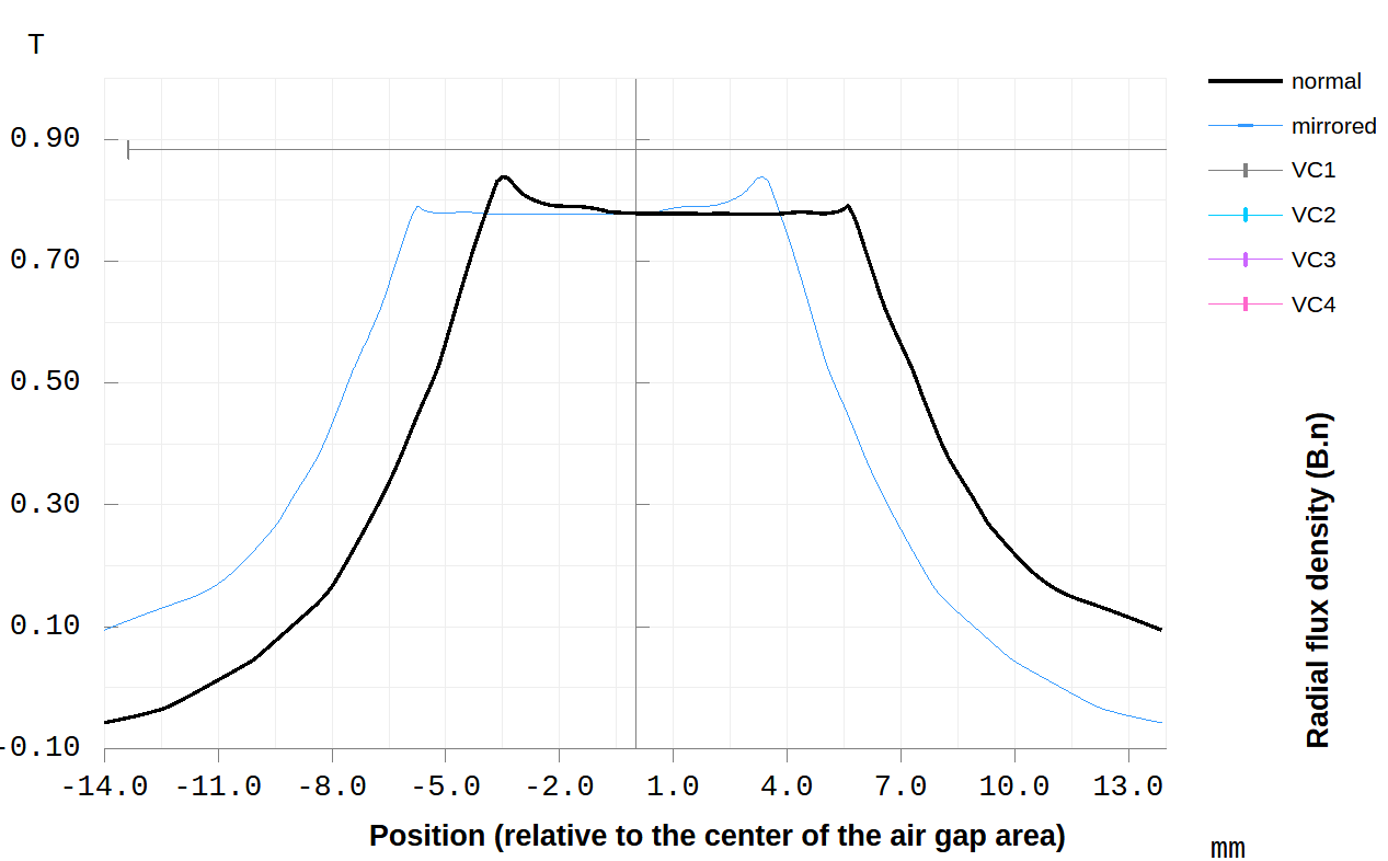

Are you separating the L and the B in the BL concept correctly?Sure, but you supposedly should not have more motor force drop on "both sides" despite "the same motor" and longer voice coil. That does not add up.
L is linear usually unless you have a variable wound voice coil.
The B field is the part where you have non linearity. I'm trying to think of how you could back out the B field measurement from the other measurable parameters. It may be possible. But it will need to be a very low voltage levels so it is not exactly useful.

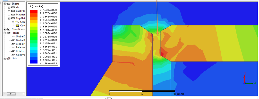

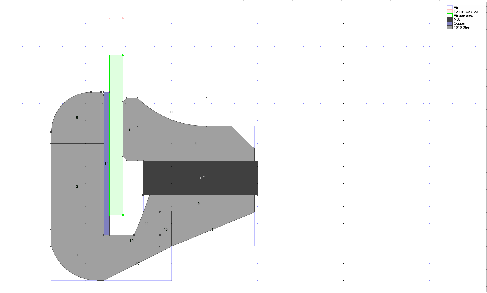

An example. This is not a fully finished design. It is a very long excursion underhung motor. Green is the area that the coil can move within.
The two other pictures are illustrating the B field and the subsequent BL as simulated.
So can you simulate a B field? Yes!
I do not separate B and l.
The issue is that with arguably "same motor", the longer voice coil driver drops Bl faster than the one with shorter voice coil. (So to speak on both +x and -x on average) Once that is the case (I have my reasons and I will ask B&C for more original data), I smell some horsecrap in the mathematical assumptions used to calculate all this in the Klippel method. The first idea is Kms effects leakage to the Bl(x) data.

Hi , are you using multiple segments to be able to optimize change in each part and reduce rendering time & facilitate project carryover or to use different parts (hiperco) for few of the segments.An example. This is not a fully finished design.
Yes. It is a very rapid way to make this kind of a motor. When the DXF is transferred to FEMM4.2 it is transferred as a solid piece.Hi , are you using multiple segments to be able to optimize change in each part and reduce rendering time & facilitate project carryover or to use different parts (hiperco) for few of the segments.

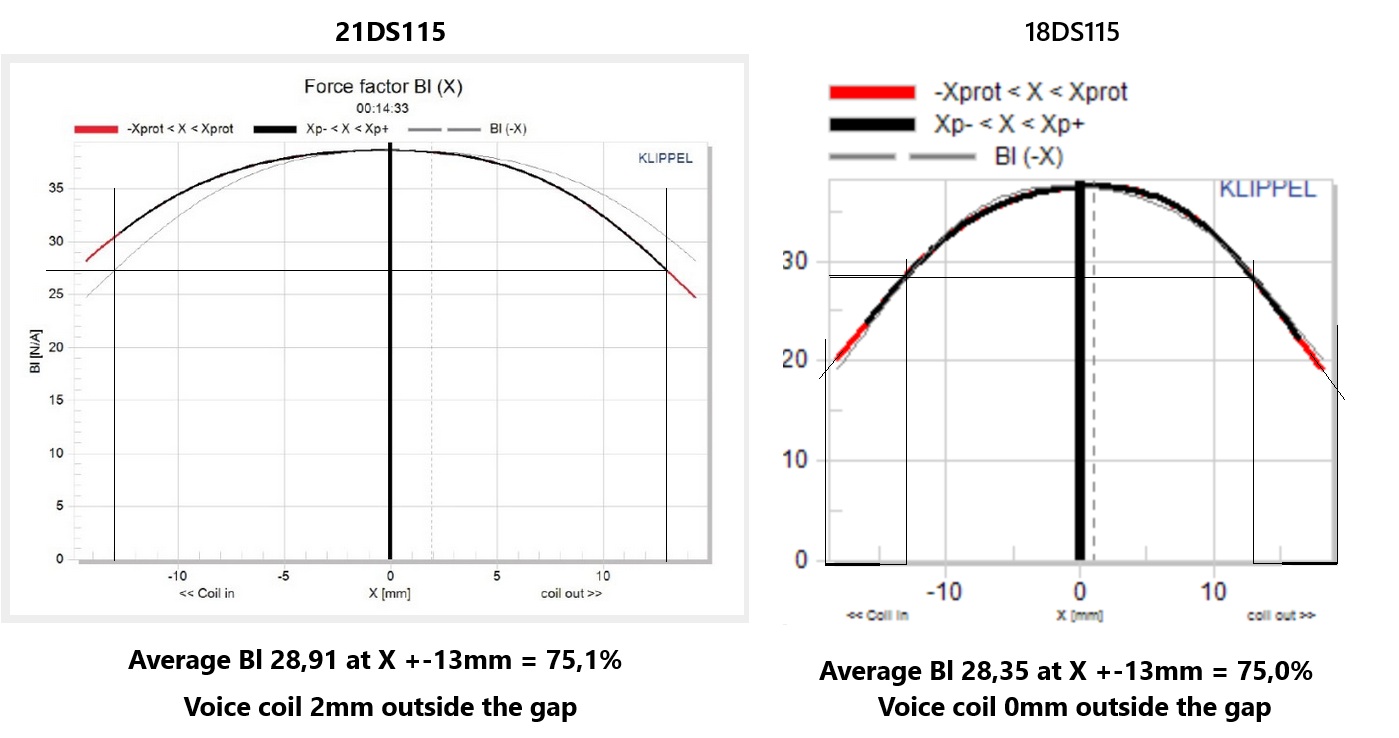

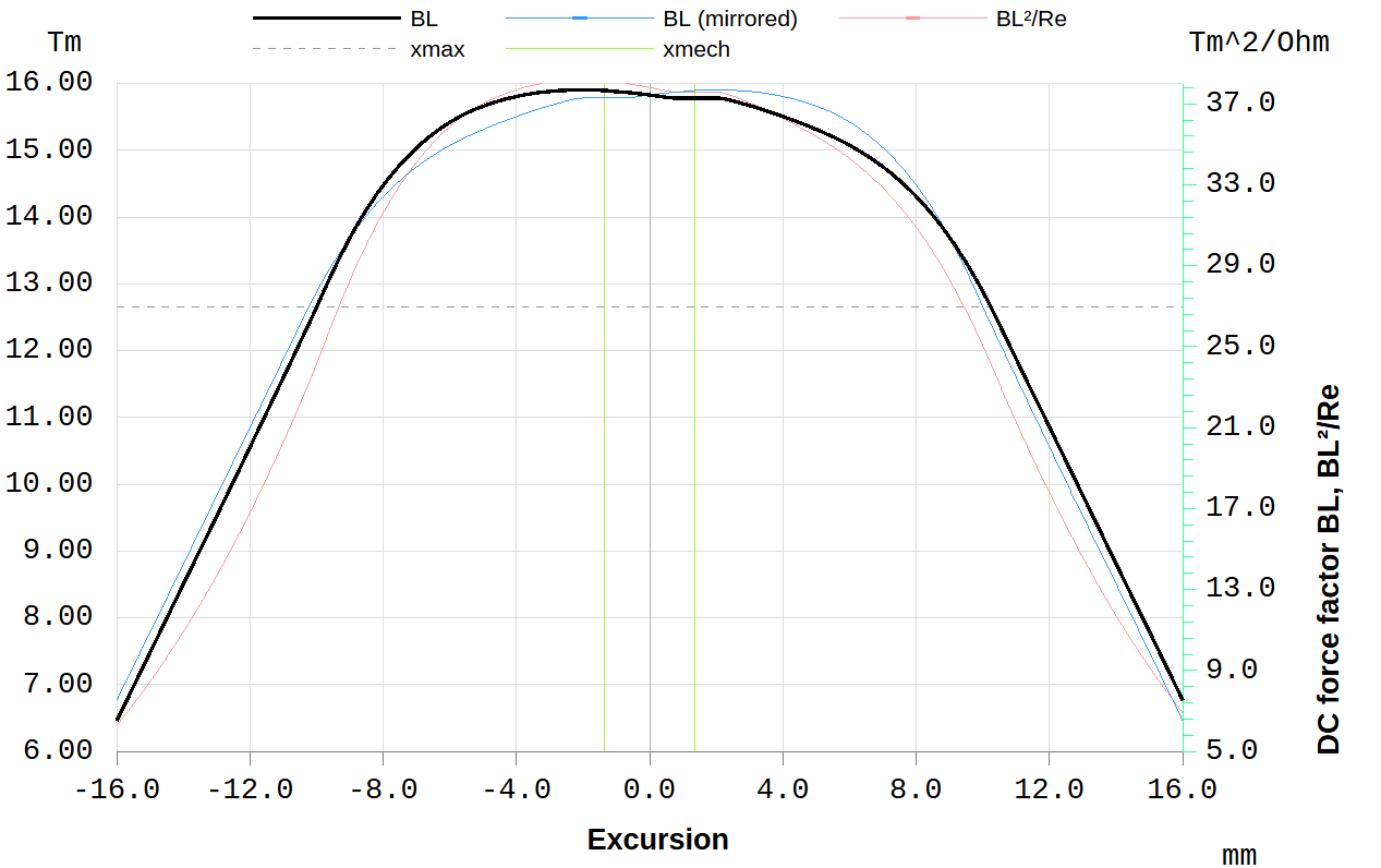

I have requested original B&C Speakers data on 21DS115, but here is the issue depicted:
As can be seen, the 18DS115 with 4mm longer voice coil sees same or steeper fall of the Bl than the 21DS115. Given the "same motor", this does not add up.

Hi Crash PC - are the following same of the 2 B&C models
1) When you remove the coil and actually measure the Gauss in the magnetic system - one will find one location within the magnetic gap that has the peak Gauss - at that moment if you move the probe even a little bit sometimes a hair , the Gauss will not hold > is this optimum point same for both motor structure , meaning are the motors actually similar.
2) Is there any shorting rings or motor structure linearity treatments that are dissimilar between the drivers.
3) Coil are the coils - absolutely similar - meaning wound with the same wire gauge, insulation and VC height and layers, dia etc.
If all of the above is same - then one of the reason I think maybe that - the suspension system of 18DS115 has a higher restoring force at X +- 3mm, this will be more evident from the physical nature - if you see the movement allowed by a cone 21" surround will be more than a 18inch surround - provided the surround has been formed with the same material - heat, hydraulic pressure and binders. Also most likely a larger spider may have been used in 21 inch - again keeping material , forming pressure heat & binder same for both 18" & 21" spider - the larger spider will allow more travel before exerting - one may put as - max braking.
This can be the likely case - as during spider and cone surround forming mostly the dye (forming mold) is changed - where as hydraulic press pressure - material - heat and binder is kept same and these individual as we say in India - Masala - is not changed mostly in volume/batch production.
These are my thoughts - and this is one of the reason if you crack a diy way to measure these large signal parameters - there will be buyers - when you do put this on group buy, there are may that cannot afford to buy Klippel - and do not have access labs and colleges in their country that have the the money or priority for it either.

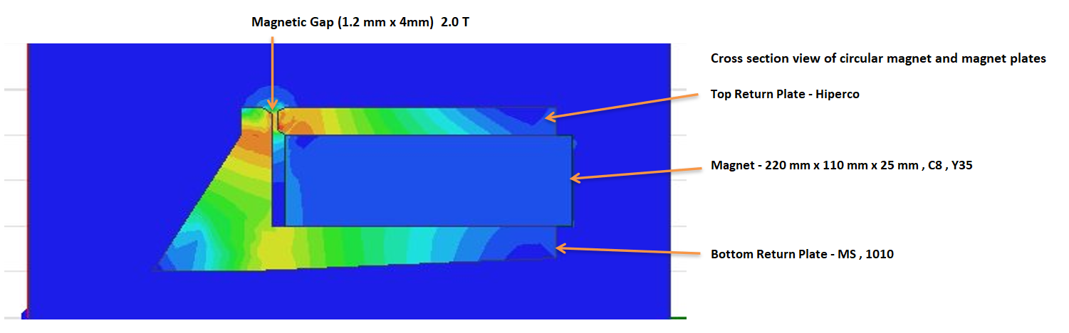

Even if everything looks same - a slight change in the composition of top and bottom plate will have effects.There are so many variables involved in motor design.
Below is a simulation of a common compression driver motor structure - the field is not symmetrical , to make it symmetrical - lot of corrections are required, and then the goal of 2.2T becomes difficult incorporating the corrections.

Probably not. I know why you ask... Though that would more affect general Bl level proportionally, falloff not so much. Somehwat, yes, sure.
Yes, I indirectly pointed to that possibility. But we are looking at the Bl curve here. So If we are justifying this issue by suspension, then I already expressed that I am suspecting suspension (Kms(x)) effects leaking into Bl measurements. And to verify or discard my suspicion, I am exploring three different measurement methods of the same thing. I don´t understand why someone (not you) would be bitter about it...If all of the above is same - then one of the reason I think maybe that - the suspension system of 18DS115 has a higher restoring force at X +- 3mm, this will be more evident from the physical nature - if you see the movement allowed by a cone 21" surround will be more than a 18inch surround - provided the surround has been formed with the same material - heat, hydraulic pressure and binders. Also most likely a larger spider may have been used in 21 inch - again keeping material , forming pressure heat & binder same for both 18" & 21" spider - the larger spider will allow more travel before exerting - one may put as - max braking.
