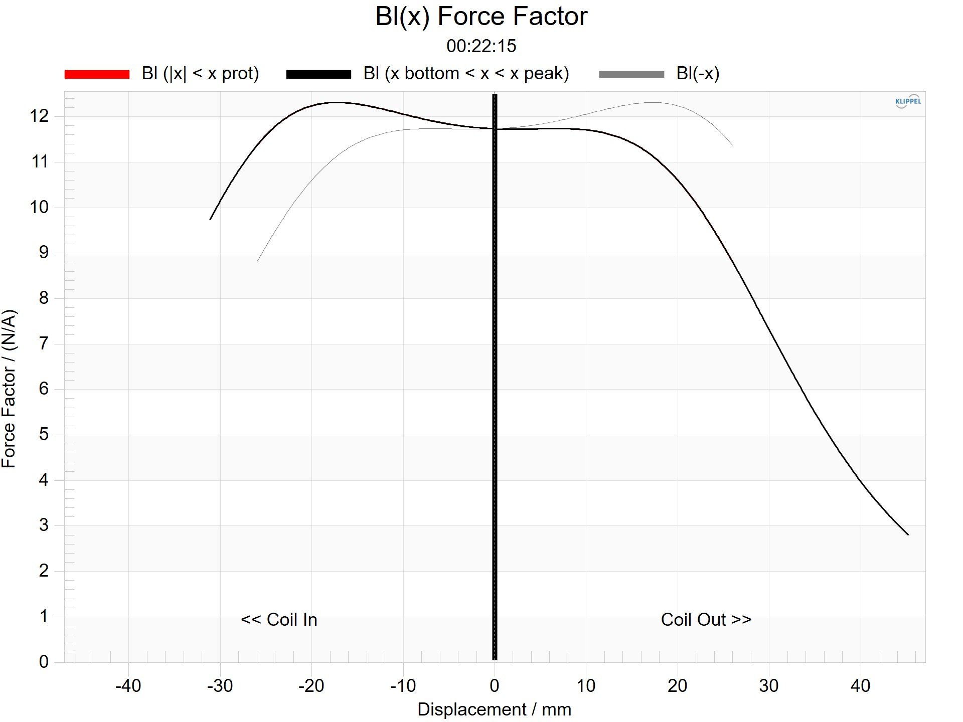

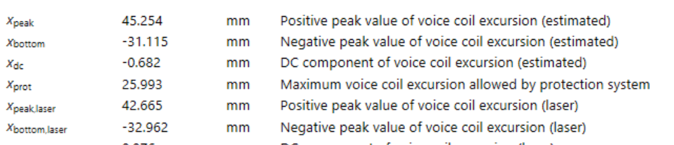

Yes, the klippel current sensor is good but it also isn't perfect. Check out this result where it decided BL protection was 26mm and it peaked at 45mm. 😳

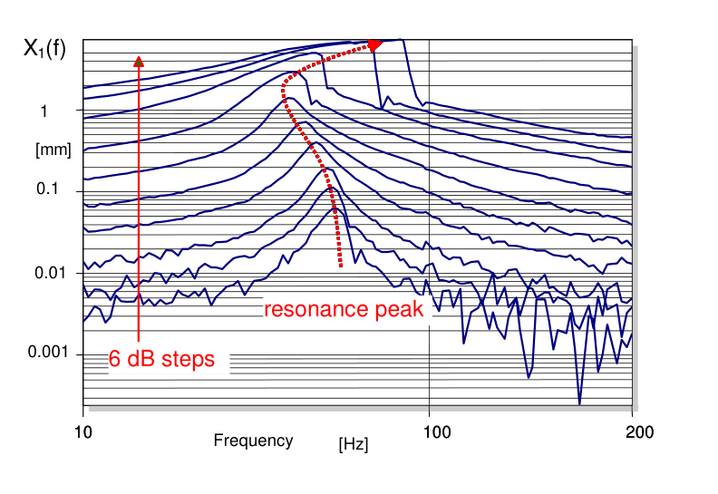

If you know a thing or two how compliance behaves vs excursion, you also very quickly know that all Kms(x) graphs are far to simplified.
I seriously don't understand why there is no hardware one-shot trigger on the output of the sensor with a threshold that can be programmed.
I've tested this with mine, and it's pretty bullet proof.

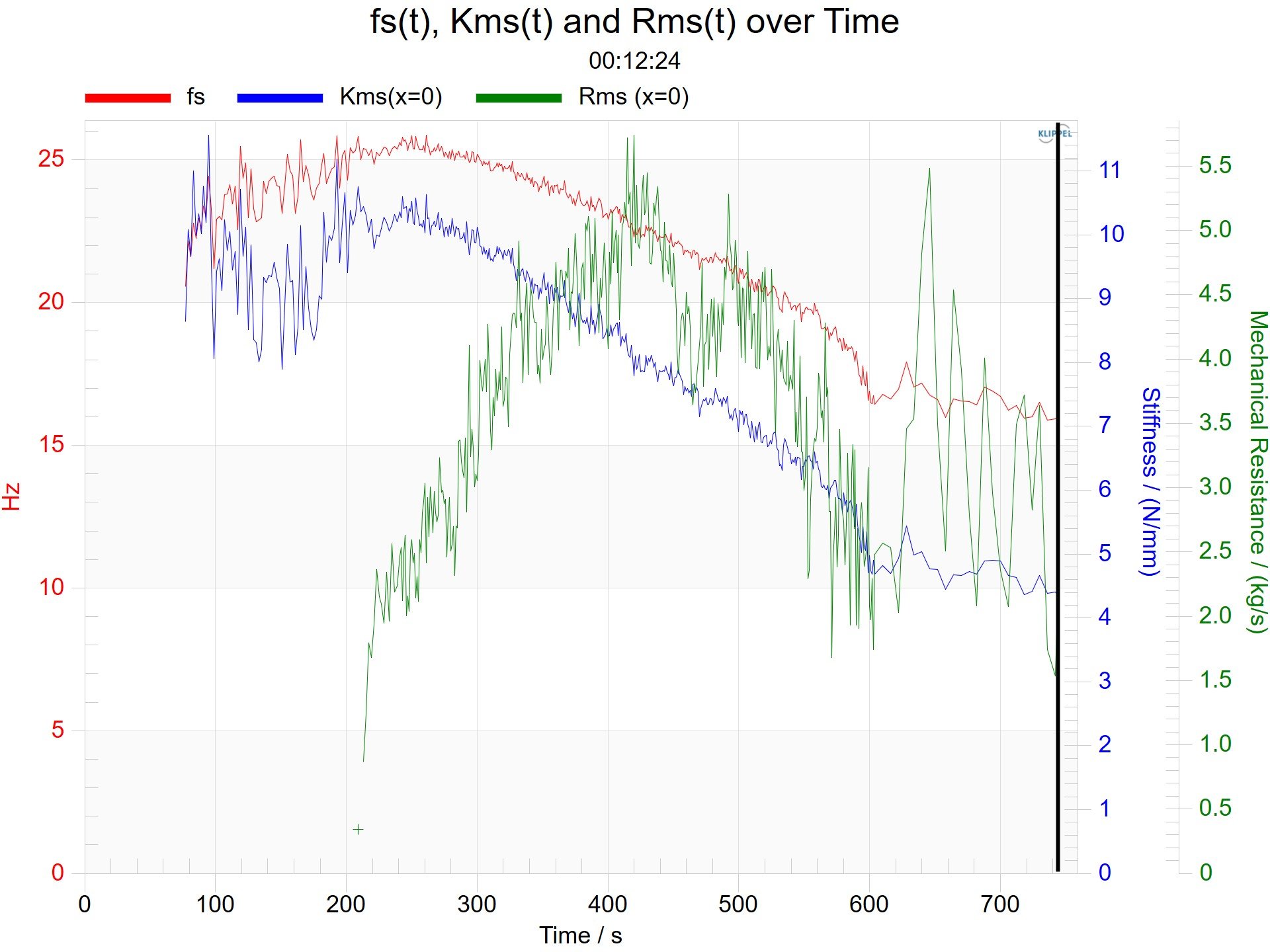

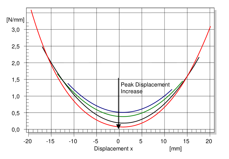

But parameter stability vs time, temperature and power is a whole other can of worms!!!!
Some drivers really struggle to hold a constant compliance over time (or temperature)
Talking about stability, this is the issue of the driver I was talking about before:
This doesn't show up with just LSI.

In the report you have, under the Table States section, what does it say in the BLmin% and Cmin% fields? It will have an entry that is formatted like: 70 (70) %. The first number is what the test has resolved to (unrelated to protection), and the number in parentheses is the protection percentage that you set at the beginning of the test.
For the 18DS115:
Blmin 51.3(30) %
Cmin 31.2(30) %.
I Bow under your tester knowledge arguments, but it makes the revelation of things somewhat worse - those limits do not add up favourably to the graphical outputs, and even with limits in place, that should not stop the data of the speaaker being fairly correct. So the 18DS115's Bl behavior still looks unexplainably suboptimal.

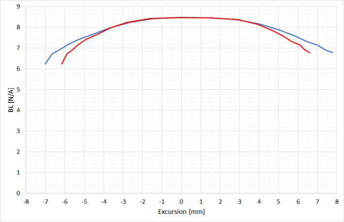

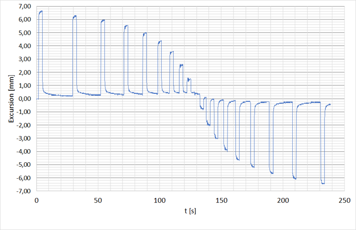

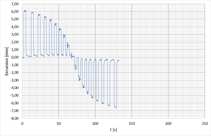

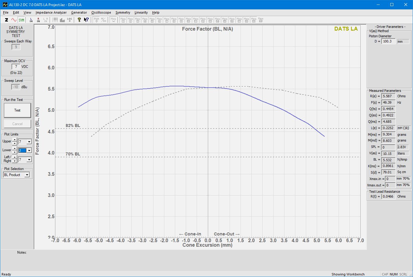

I had the opportunity to borrow a DATS LA at the weekend and take some measurements. Again I used the Visaton AL130 mentioned in post 92 as DUT. Parallel to the DATS measurements, I also ran a triangulation laser for the excursion measurement. Below please find the results.
It appears that the deflection calculations from DATS LA are only correct in the somewhat extended linear range. In addition, the superimposed sweep for the parameter measurements does not always seem to be stable.
I will see if I can borrow the DATS LA again and carry out some further tests.
Regards
Heinrich

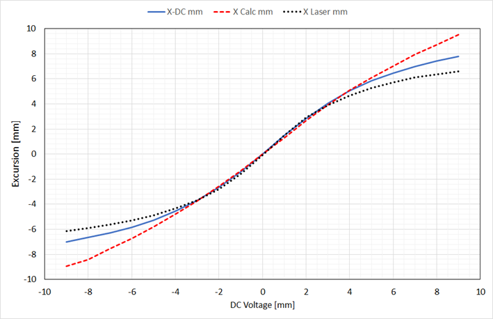

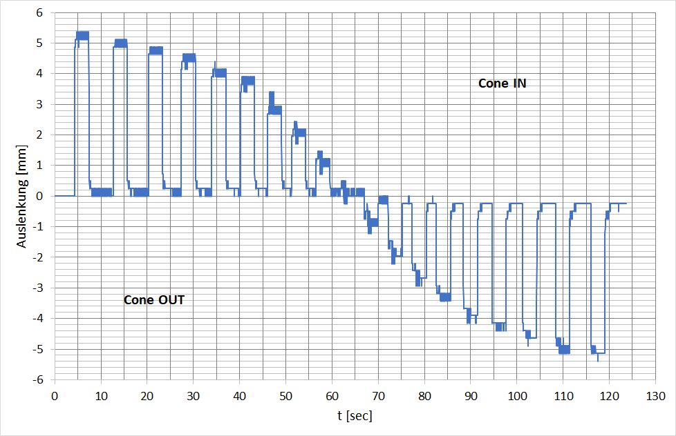

The first short test with the Dayton DATS LA left a number of questions unanswered, so I borrowed the DATS LA again for a weekend.
The first thing I had to consider was how DATS LA calculates the excursion from the measurement data. As the signal for generating the excursion or operating point is very low frequency according to the patent, the following relationship should apply:
X = BL * I * Cms or
X = BL * U/Re *Cms
To check this, I measured the excursion in parallel with the DATS LA measurement routine using a trianagulation laser. In order to test the DATS LA, I selected various drivers as measurement objects, from vintage drivers (Monacor SPH 130) to modern PA drivers (Faital 12PR320).
First of all, I tried to determine from the measurement data how DATS LA calculates the excursion. In principle, the above formula applies:
X(DCV) = BL(DCV) * DCV / Re(DCV) * Cms(0)
With this calculation there is a reasonably acceptable agreement with the excursion values of DATS LA.
After the first measurements my assumption from post 159 was confirmed, the excursions shown by DATS LA are obviously only valid in the slightly extended linear range. Outside this range, the deviations become increasingly larger. Here are a few examples (DCV vs deflection).
Fig. 01 Wavecor WF182DB10
Fig. 02 Faital 12PR320

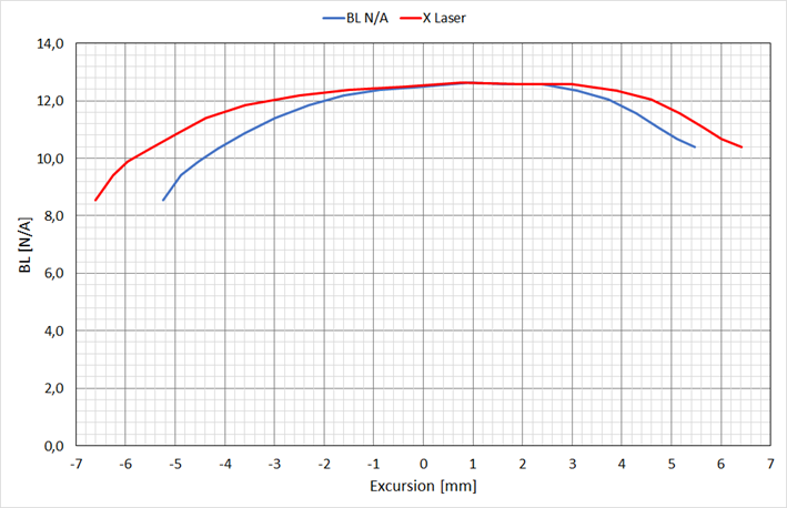

The blue line represents the DATS LA result, the red dashed line the result calculated with the above mentioned formula and the black dotted line the result corrected with the laser measurement.

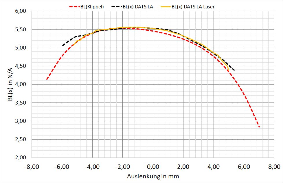

The deviations in the excursion range naturally have an effect on the further results. As an example, here are a few results for BL(x). The blue line represents the DATS LA measurement and the red line the result corrected by laser measurement.
Fig. 03 Wavecor WF182BD10
Fig. 04 Faital 12PR320

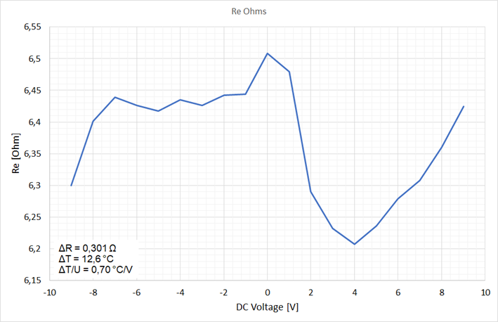

Furthermore, as already mentioned by Clark, it is of course inevitable that the voice coil heats up during the measurement. Here are two examples.
Fig. 05 Wavecor WF182BD10
Fig. 06 Faital 12PR320
DATS LA probably tries to take this into account during the measurement by using pause times of different lengths, but it is questionable whether this is always successful.

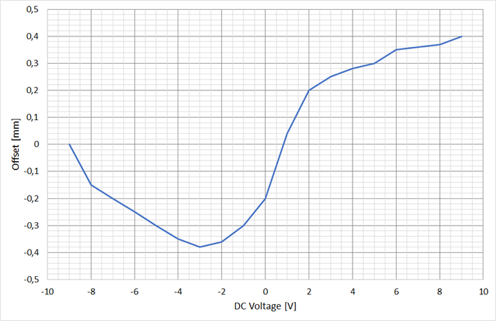

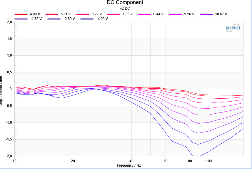

Furthermore, the measurement routine results in an offset, which also has an effect on the result.
Fig. 09 Scan Speak 15W8434G00
Fig. 10 Faital 12PR320
Unfortunately, the programming of DATS LA is so fixed with regard to the symmetry measurement that no adjustment is possible.
Based on these results, I would not buy DATS LA. With the DUMAS-like method I mentioned above, you can achieve comparable, if not better, results, albeit with a little more effort. And the material investment is limited to an electric air pump for around €20 and a suitable housing.
