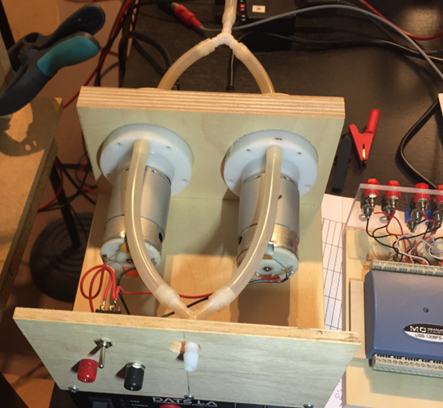

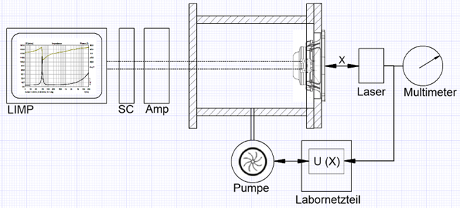

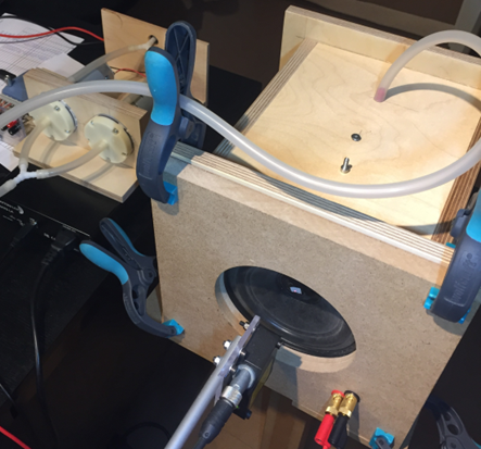

As promised, here is some information and pictures of my DUMAX setup.
The housing is a simple box with a replaceable top and a hose connection. The pump is a 12V air pump that has both a pressure and a vacuum connection. It is powered by an adjustable laboratory power supply unit. The adjustable range of the pump is between 3 and 14 volts.
As the required pressures are so low and the leakage losses cannot be determined, it is not worth planning additional measuring and control units in my opinion. It is easier to set a pressure/vacuum via the pump voltage, wait for the balance between pressure build-up and losses and then measure the excursion and impedance.

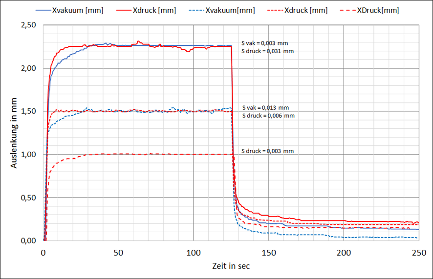

The following is an example of how well the excursion control works by regulating the supply voltage of the pumps.

So I am guessing if you want vacuum of pressure you are simply switching inlet for outlet. One is vacuum and one is pressure. Nice to use a lab power supply.

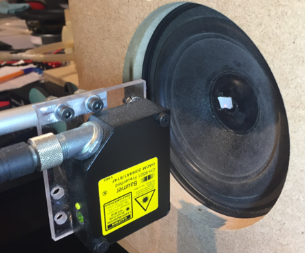

Which LASER do you use? I see Baumer OADM but the number is out of focus.
Yes! Most loudspeakers are not air tight. So to get perfection is not going to happen. If you start sealing and playing with them you have mass added, or stiffness. And that will not be a common characteristic in the other loudspeakers.As the required pressures are so low and the leakage losses cannot be determined, it is not worth planning additional measuring and control units in my opinion. It is easier to set a pressure/vacuum via the pump voltage, wait for the balance between pressure build-up and losses and then measure the excursion and impedance.
So that box on the side of the pumps is the power supply?
Again a guess, you have two pumps for required volume change in a reasonable time period? I see they are piped in parallel.
The type is: OADM 20I6441/S14F. You can find more information about the laser here: https://artalabs.hr/AppNotes/AN7-Estimation_of_Linear_Displacement_with_STEPS.pdf
So I am guessing if you want vacuum of pressure you are simply switching inlet for outlet --> Yes
So that box on the side of the pumps is the power supply? --> No, this is an AD converter with which I record the displacement signal
Again a guess, you have two pumps for required volume change in a reasonable time period? --> With very hard suspended loudspeakers, a pump may not be sufficient. And with very softly suspended speakers, you may need a smaller pump.

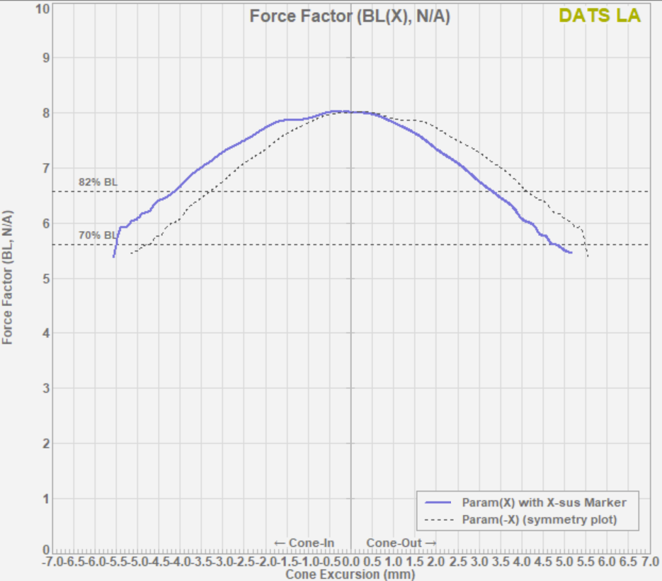

This is one of my current test rigs. Very solid measurements. And not to hard to integrate a LASER into the measurement.
I'm just starting to read the ARTA Application note. Well written!

Is there a DIY technique to measure the BL curve of a woofer?
Hi Boden,
Granted it is not exactly a build-it-yourself DIY measurement system, but like the previous generations of DATS, the new DATS LA system is designed for both professional and DIY/hobbyist use.
Here is a typical BL curve:
