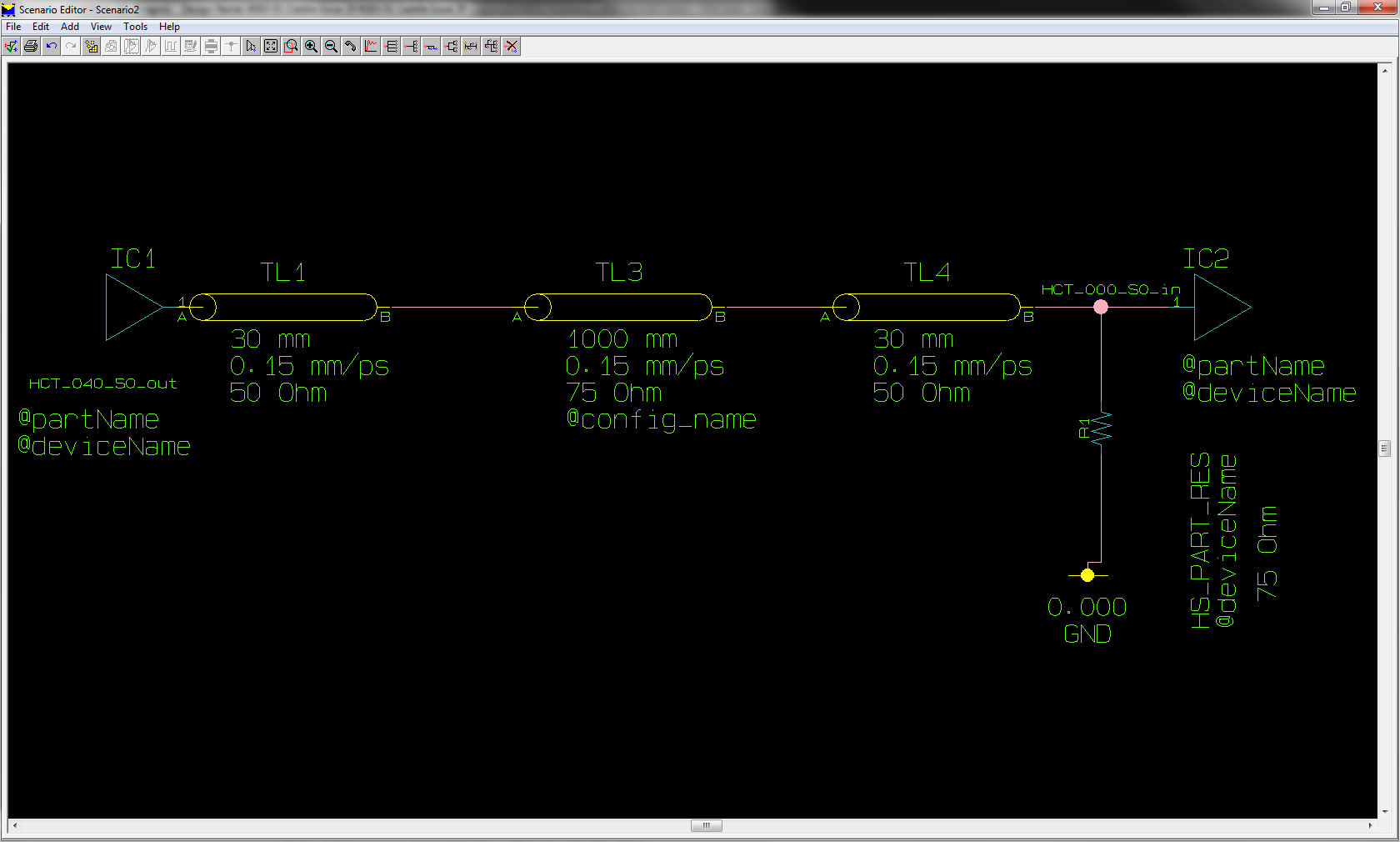

With reference to my post with the SIM shots, the best way of getting a digital signal from A to B is being in control of all the aspects of that signals transmission, with a scope you can observe the waveform (don't forget to take scope loading into account) and try retro fitting some form of termination if required to help alleviate any problems.
Anyway pictures paint a thousand words blah blah blah

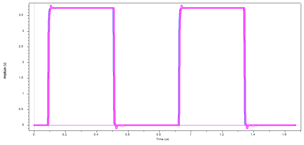

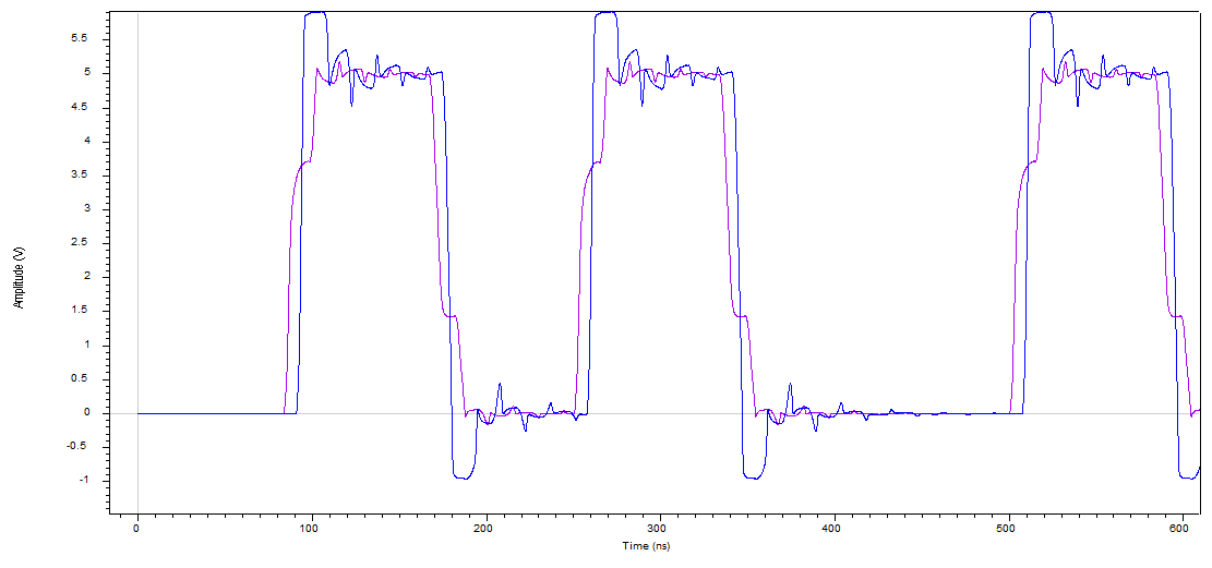

Below is a rough simulation of a SPDIF basic interface, signal was 12MHz, a 1m basic cable at 75 Ohms and two shorter 50 Ohm lines to mimic connectors and PCB (this is a very basic set up done on the fly). The two sims show the results with the 75 Ohms resistor to ground (Terminated) and without (un-terminated).
PS this was done in seconds and is only to illustrate how the terminating resistor will calm the over shoots, but also lower the amplitude, adding a cap to the resistor will solve this. I will do a better example later when I get a bit of time, with connectors modelled.

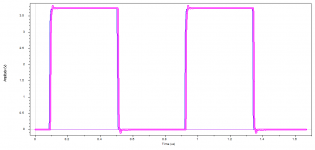

Marce, very interesting and a bit surprising too. how would that look at 5.6MHz? I read somewhere that terminating a short cable with a 75ohm resistor was not necessary, do you think it could help then?
