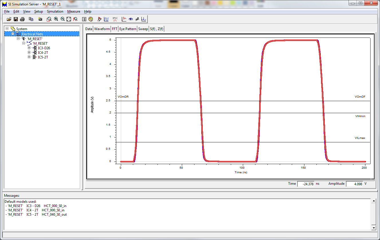

Its not just the cable, there can be numerous mismatches. The attached pdf shows a view of a signal from the point of view of signal integrity (this is taken from a real layout, but I can also model cables, off board connectors, and SCOPE PROBE LOADING) playing with this I can feed signals into the line and look at the resultant waveforms and eye diagrams at various points, I can also do scenarios where I can try different termination schemes, or if possible alter the drive characteristics of the transmitter (this data is stored in an IBIS file).
The resultant simulations can be graphically displayed as shown in the two .png files.
We use this stuff regularly because we do high speed layouts with DDR memory, gigabit Ethernet and other critical digital interfaces.
A few years ago I did set up some sims for SPDif but I think they got lost when a PC went down, if I get time I will do some more, but you do need IBIS data for the driving and receiving devices. (I hope to run some SIMs along with another thread looking at terminations on cables).
So I can simulate an interface, route it to the best sim, and then check the layout with the simulation tools.
playing with stuff like this every day is why I am sure that there is no CORELATION between what a square wave looks like and the resulting analogue if it is going through a convertor...
