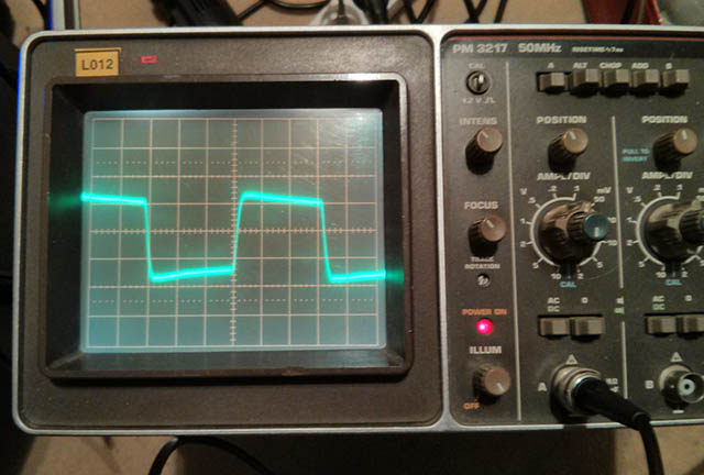

I have just put the scope on my no-name SPDIF cable, terminated with 75 ohms. The signal is the SPDIF from the sound card. One div is 0.1 µs. Probe is 10x.

Very useful Vincent, many thanks for trying this, it pretty straightforward then? How would you interpret your result? Although not a perfect sq wave, a good result though?
