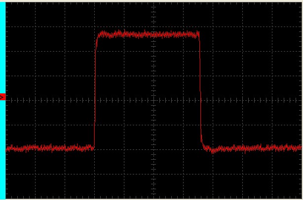

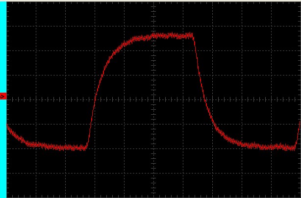

Well, a real life signal doesn't look anything like this. You will never get square signal like this. Termination reduces the overshot sifnificantly, but doesn't make it so square.

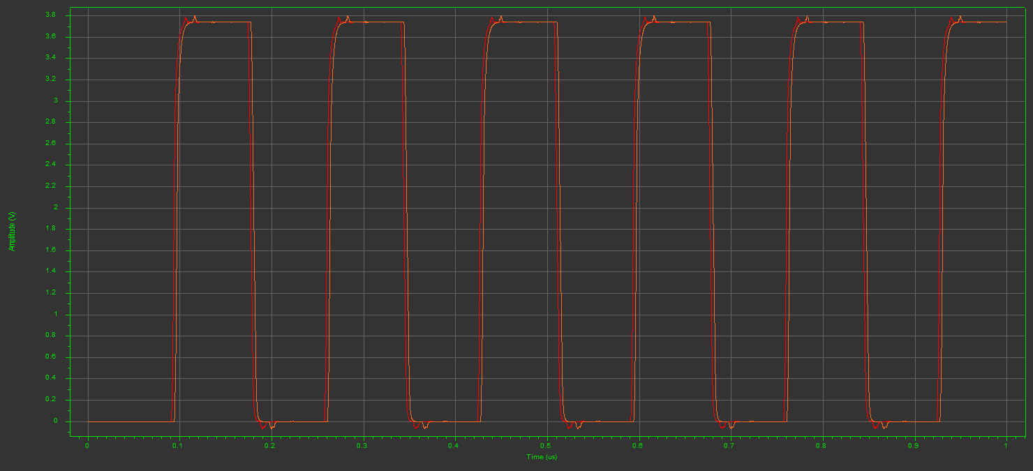

Sorry I have to disagree, just spent two weeks working on a PCB with DDR3 amongst other interfaces, and the engineers been happily simulating the design as I lay it out. The software used is this:
CADSATR PCB analysis and verification | Zuken
Its a real tool and its used for real high speed designs, and some of the waves you see are quite strange, and the tool is used to verify a design but also to try out different termination schemes.
Also don't forget it is a quick scenario made up od an 04 driver and three TL's. The rise time is about 30ns on the terminated one, its the way the x and y of the graph are shown that make it look so square.
Termination as well as absorbing the excess energy put into the line, visible as over shoot, also damps the reflections, thus reducing there effect on the transmitted signal.
Marce, very interesting and a bit surprising too. how would that look at 5.6MHz? I read somewhere that terminating a short cable with a 75ohm resistor was not necessary, do you think it could help then?
Rather than trying to explain termination, and have to refer to documentation, a quick visual demo is easier and more understandable, that's all, but as shown it does help alleviate problems caused by mismatches.
It looks like you're running about 2.5MHz, which isn't very different than (say) spdif. If memory serves, you'll get a good square wave if the frequency response is flat for a decade above and a decade below the fundamental frequency (in this case, 250k-25M). So it seems to be completely reasonable data.

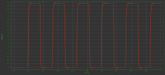

Masurements especially made for marce. Two different waveforms, will they both sound the same?

As long as the switching points are crossed data will be transmitted by either. The DAC should reclock the signals, so the slight change in mark space ratio should be sorted. A well designed DAC should be able to cater for both waveforms as you don't know the quality of the up stream transmitter or how good the cable is going to be.
From the waveforms shown there is no way of guessing the sound output...and bad data transmission is pretty obvious, as drop outs, not a change in the sound. jitter we have discussed and is down to the DAC and related circuitry to sort.
I would like to hear an explanation of how they could sound different?
A quick sim, two 1000mm TLs 75 ohm one 0.15mm/ps one 0.10mm/ps
The waves shown are at the receivers, both waves launched at the same time,
I would like to know how different Vf of cables could effect the sound:scratch:
