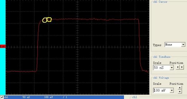

We can always discuss, what is audability of those two glitches. Especially with short cables, where those two glitches could have affected rising edge of the signal
Yes, let's do that.
And what effect do you think the glitches have on the timing and value of the received data?

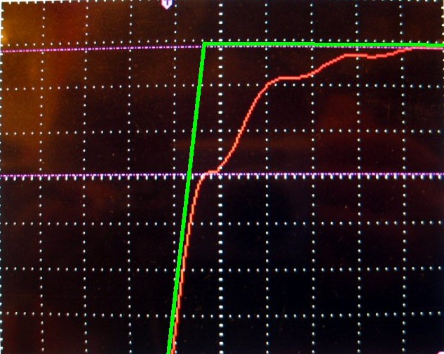

real measurement, magnified picture bellow. Short cable, impedance mismatch influencing edge. Ideal waveform (theoretical) marked with green line.

Real measurement? Of what, using what equipment?
I think he meant the scope trace under that, which is entirely unrelated to jitter.
Ah, yes.
I would like some measurements, to see how bad it is. I would suspect minimal as neither waveform is that bad for digital.

Are we talking non-monotonic rising and falling edges?

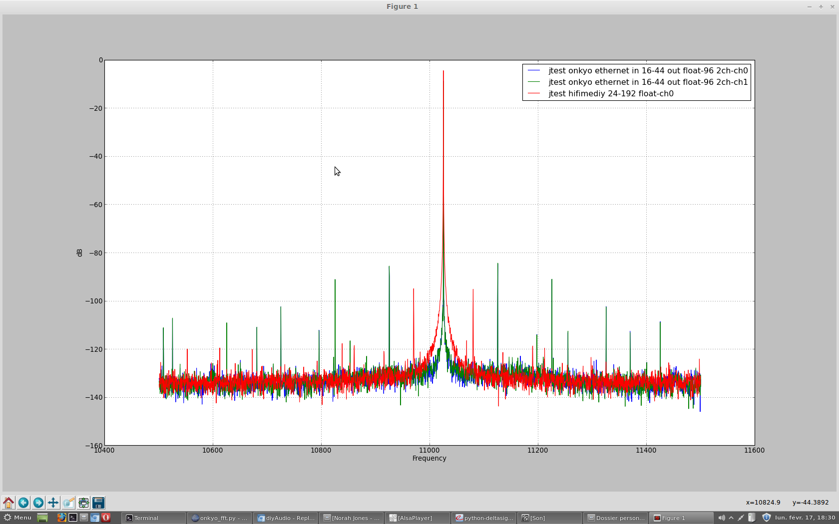

I've got this ONKYO TX-NR 905, expensive, heavy HT receiver ; it has an ethernet port and can play files from the network. Not a very useful functionality since it uses DLNA/uPNP (which is crap) and only plays WAVs.
I was wondering why it sounded so atrocious when using the network play, while sounding excellent with the vinyl input... and average with the HDMI.
Turns out they just slapped a mini-PC-in-a-box in the chassis (a RISC based single board computer actually) with a PCI sound chip in it, which outputs SPDIF, which is then routed to the SPDIF inputs. There are other factors to the extremely bad sound quality (even the laptop sound chip is better), notably the horrible internal signal routing (all connectors have 1 ground pin, the SPDIF/I2S go through over 9000 connectors and snake through all the boards, the poor PCM1796 are on a double sided board with no ground plane mezzanined on the DSP board with its noisy DDR bus 1cm below, etc, etc).
Attached image is FFT of the traditional JTEST signal, played as a WAV from the network, taken from the "Preamp Out", and digitized by my PC motherboard sound chip. I throw in a 30€ Hifimediy DAC for comparison to this €2000 receiver.
I won't say I can hear all those jitter spikes, but I find it quite ironic that a crap motherboard sound chip can clearly measure the difference between a top of the line piece of gear and a cheap chinese DAC........
Incidentally the Hifimediy sounds much, much, better. It is listenable, the boat anchor isn't.

I must say in the last post I was a bit unfair, since the TOSLINK connector did not fit in the Hifimediy optical output, which is actually a 3.5mm Jack LED with at the bottom, I just taped it in place, which no doubt provided some attenuation. The receiver didn't have any lock problems and data was transferred correctly though.
So, I dug up this HYUNDAI CD-DVD-MP3-USB-Piratebay player from the bottom of my stash, it seems it has a TOSLINK output, let's connect that to the ONKYO, and play a JTEST CD burned for the occasion.
This time, no need to zoom.
There is also suspicious looking hairs around 22050 Hz (only for the Onkyo)... it was there in all previous tests, wonder where that comes from... Could it be some digital crosstalk in one of the 9000 connectors with a single ground pin ?... Hm...
