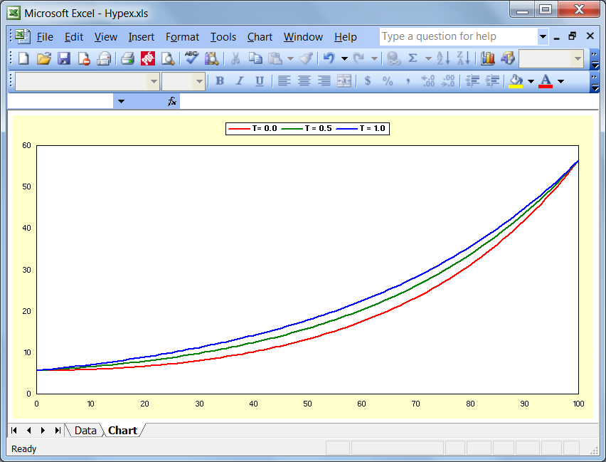

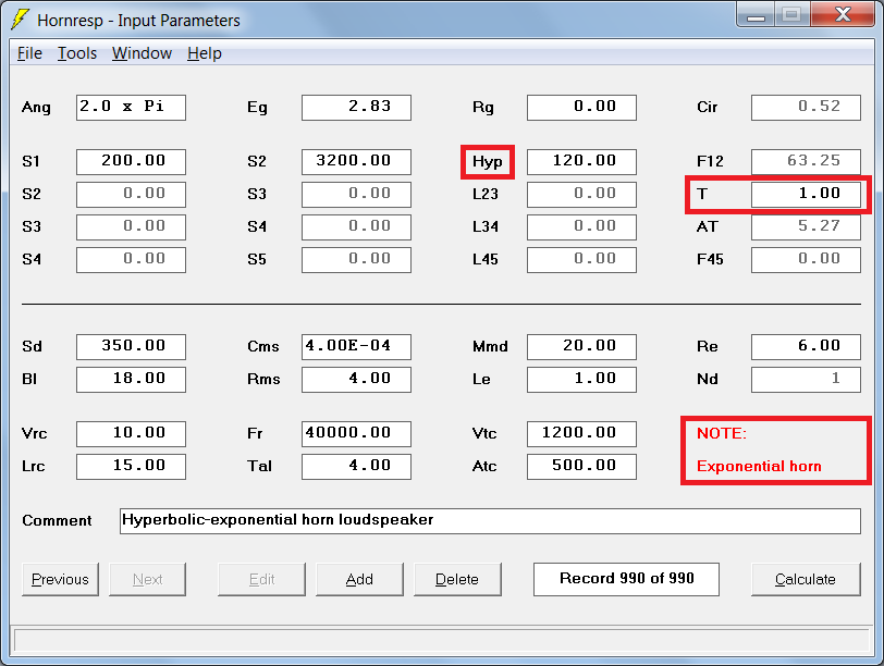

Hyperbolic horns with T < 1 will approximate the exponential horn expansion a certain distance from the throat
A hyperbolic horn with T = 1 has an exact exponential expansion over the full length of the horn.

David, in the sim you demo'd here, can you share the input or file please.
I am trying to reverse engineer the ideas from the electrical impedance....If you own the horn there is no need to reverse engineer, just read the measurements lol. Marks approach nulls the parts that he cared about...Group Delay....

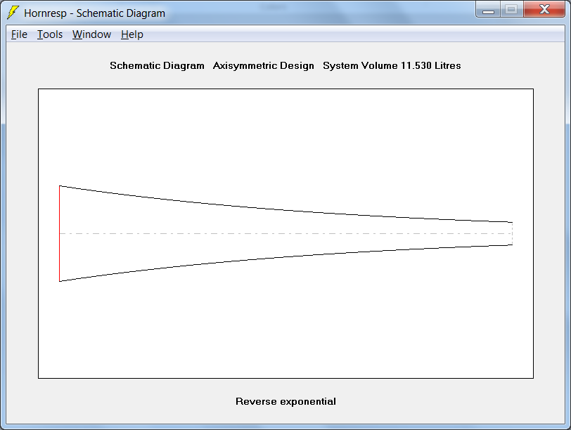

Transmission, Transformation, Attenuation, Propagation
Martin King is using exponential horn geometries to attenuate the bass backwave with minimum reflection back to the driver at the mouth. The bass driver is at the mouth of the horn. The throat is the open backwave exit.
It’s the reverse of a high pass horn, where the driver is at the throat of the horn, and propagation is at the mouth; hopefully with minimum reflection back to the throat.
If the bass transmission line reverse exponential horn system is built properly, you have predominately resistive attenuation of the backwave to low frequencies determined by So, SL, and L(the length of the tube/horn). Notice how L(length), and So(area of the throat), can remain constant, while varying SL(area of mouth), and Fc changes by a factor of 4.5. Varying SL is like varying the flare rate. See Table 5.2 in the Martin King pdf.
Don’t confuse bass transmission line ‘tuning’ with high pass horns just because they can both use an exponential taper, and can both be called transmission lines. The goals are opposite.
Think the bass section of something like this:

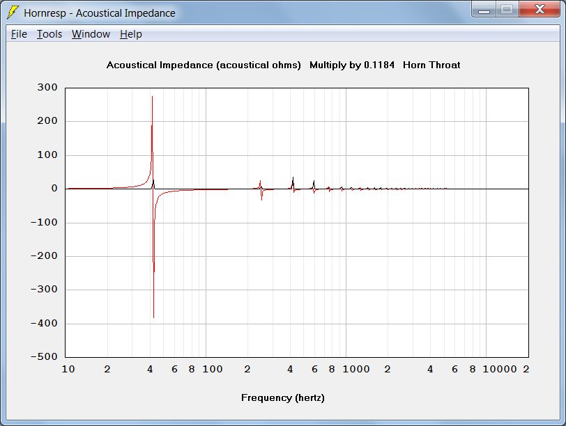

Attachment 2 shows the acoustical impedance loading the rear side of the driver diaphragm for the undamped (no absorbent filling material) system given in Attachment 1.
