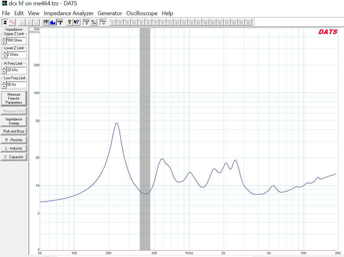

B&C says it loads to 300 Hz and I see nothing in there to doubt them. The raw impedance of the dcx has a lower peak of 400Hz in free air that moves to 300 and is damped quite a lot on the ME464.
I dont recall ever saying the horn does not have any loading at 300hz. "Loading too" is another statement used vaguely...to what degree of load....not all load is created equal.
I said what I said about peak resonance, group delay, decay, and if Mark chooses to expose the group delay and it lands where I predicted then what? I described a method of choosing desirable bandwidth, and if the measurements concur then what?

That is NOT a 150hz horn....is NOT good at 300hz...
That horn is tuned to 400hz...and group delay should confirm....max resistance/reactance is at ~400hz....measure GD on horn with no filter for nail in coffin.

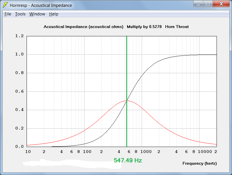

Cutoff in a conical is even more of a hopeless description than when applied to OS.
The cutoff frequency of an infinite conical horn is given by k * xt = 1, where:
k = wave number = 2 * Pi * f / c
xt = distance from the apex to the throat
c = speed of sound
Therefore:
fc = c / (2 * Pi * xt)
In the attached example:
c = 34400 cm / sec
xt = 10 cm
fc = 34400 / (2 * Pi * 10) = 547.49 Hz
