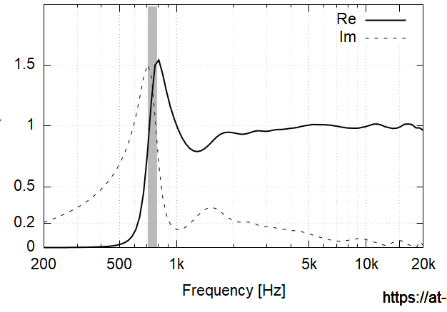

I think that we all think of different things when we think "cutoff". The point is to be clear what we mean by that. 1/2 power is a norm, but that's not consistent with it's usage in "horn" theory (and some physics) where it means complete shutoff of output. Very different things.
The 1/2 power of the above would be at 660+- Hz. Since there is output, then this can be the only applicable definition of cutoff in this case.

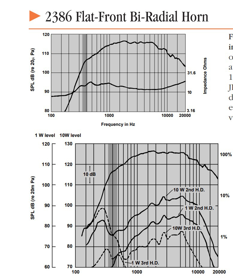

attachment.php
Sometimes by putting up a number, implying cutoff without saying the words, "cutoff" lets one get away with murder...then again, without being totally specific about what one means by it, it, can essentially mean anything.
attachment.php
"Full loading to 400hz", it says......IN my mind there is no full loading past the point where acoustic impedance peaks...it falls off above or below this point depending on Q of the peak but below, it seems to fall off most, in my research.....Potentially the drivers F is a factor but looking at the graph above I would think that this horn cutoff is where I highlighted....why am I wrong? I guess I should look at this as old data maybe not governed in the light of the ideas we have now? I just know there is a group delay bump in there but maybe its just a small one...
Don't know....Marks experience with his horn, can't trust it without confirmed horn cutoff data.

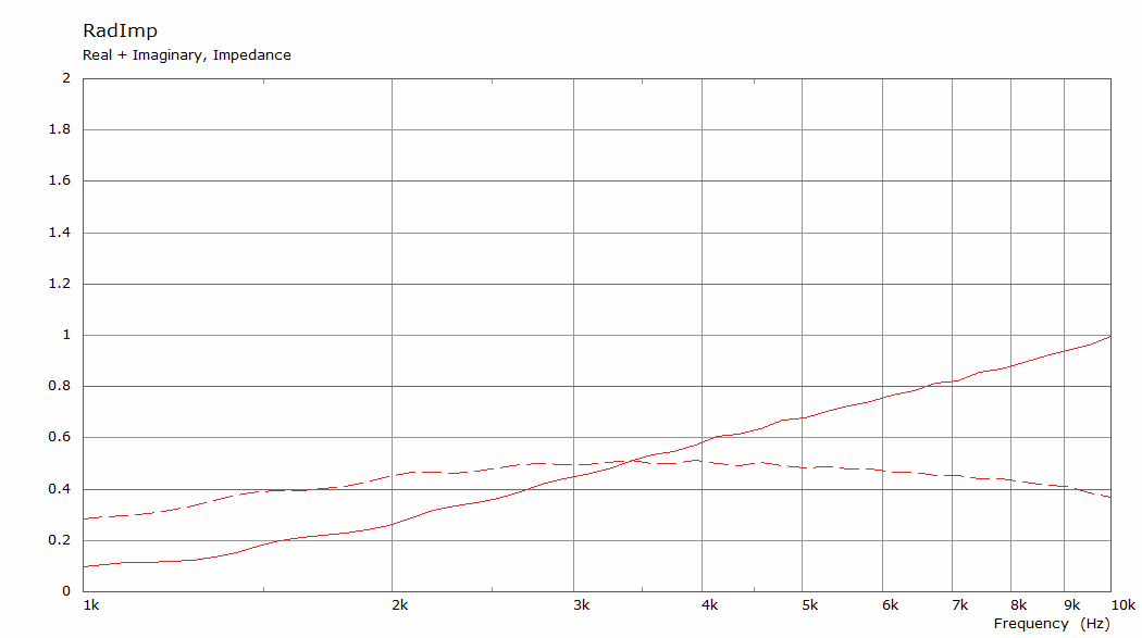

Cutoff in a conical is even more of a hopeless description than when applied to OS. Here is a pretty big 50x50 modelled after the SH50.
This is the radiation impedance the scale only goes down to 1K because it is already at virtually nothing by then. Apart from concentrating the radiation into a smaller space there is not much help from a flat sided horn. Real = Imaginary at about 3.4K. A secondary flare hardly changes the Rad Imp at all, it does a lot for directivity though.

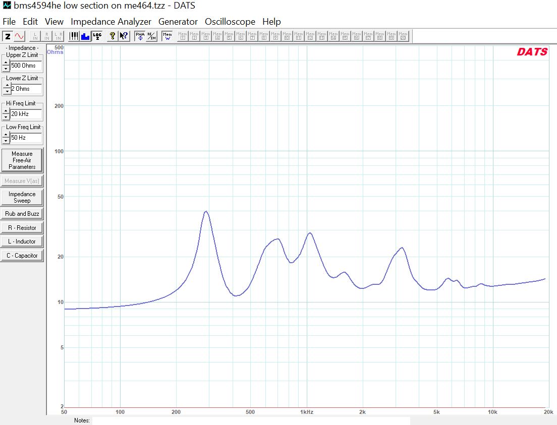

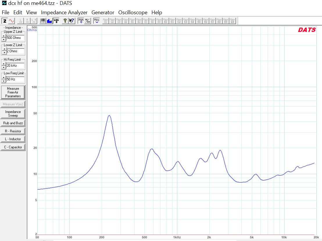

A number of pages ago i said i'd look for impedance traces of the me464. Found i didn't have any so just now made some .
Here's the lower section of the dcx464 CD, first with no horn and then on the me464 horn.

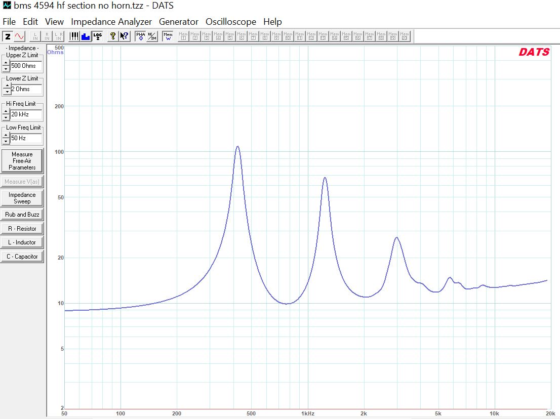

Here's the same thing with the bms4594HE.
CD lower section no horn, then on the me464.

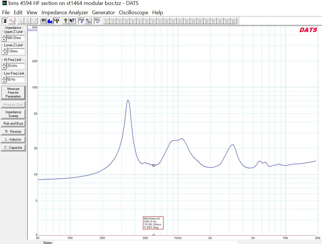

Here's two more horns with the bms just for comparisons....sorry don't have the horns for the dcx too.
bms 4594he lower section on XT1464 (in a box with very small baffle)

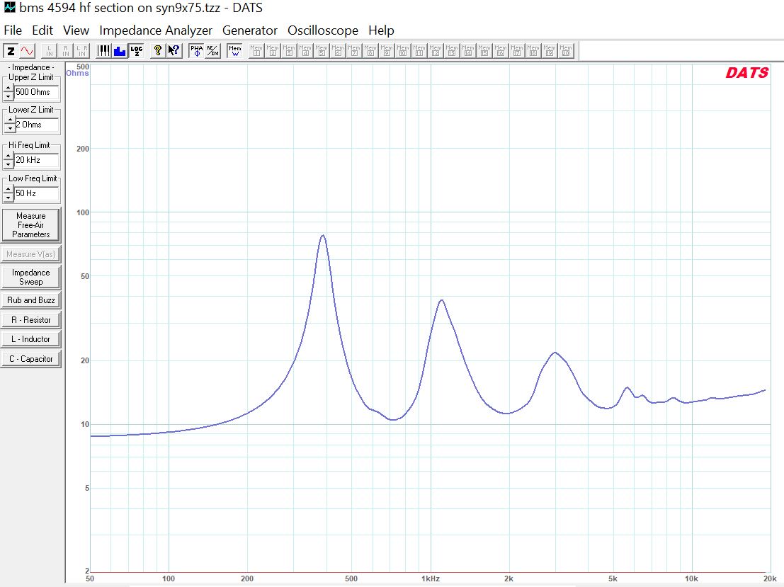

And last, bms on current syn9 75x60 conical horn.
It's similarity to the CD without a horn illustrates fluids last post i think

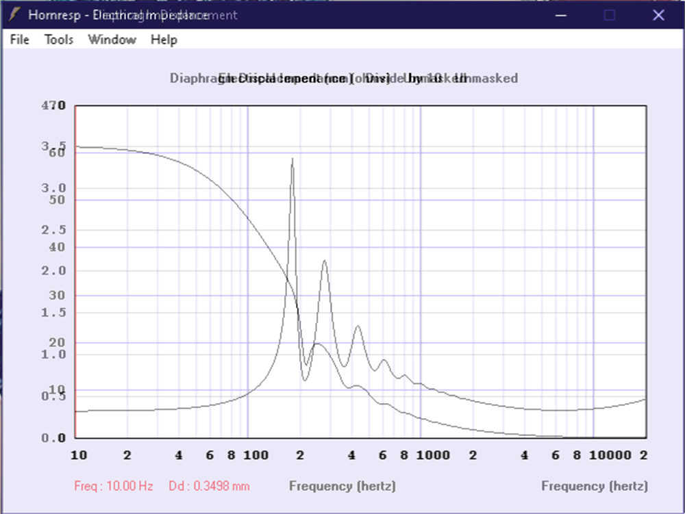

B&C says it loads to 300 Hz and I see nothing in there to doubt them. The raw impedance of the dcx has a lower peak of 400Hz in free air that moves to 300 and is damped quite a lot on the ME464.
You should be looking to the impedance troughs, not the peaks. Loading lowers excursion and thus electrical impedance.
Excursion super imposed over impedance.

attachment.php
The peak of acoustic impedance is riiiight there, its not directly on the dip in excursion but its really really close.

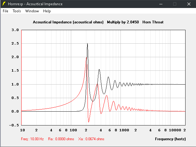

.max resistance/reactance is at ~400hz....measure GD on horn with no filter

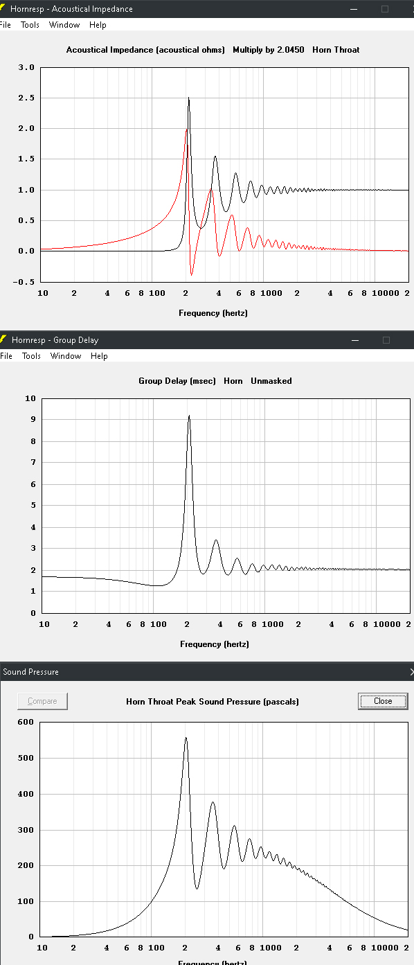

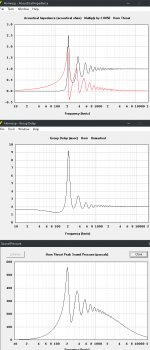

At the tuning note, at the fundamental, at the root mode, at max resonance etc etc etc
Group Delay peaks...Pressure Peaks.... I've said this stuff before, I wonder if its been passed off as "my crazy theories"....maybe pay attention to horn resp more? I described group delay (in a horn) as a function of pressure on the diaphragm, causing the diaphragm to lag behind. Another one of my crazy theories? Maybe....:wave:
attachment.php

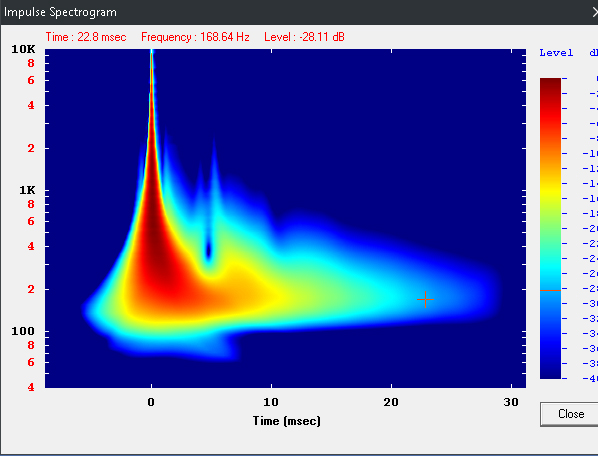

I also said that excess decay can be found here...
attachment.php
Non of these things are good for Sound Quality I said.
OK so you can't explain it because you don't understand it. These horns you show with the horrible impedance and group delay are examples of how not to build a horn. Your current attitude is at an all time low. This feels like arguing which I have no interest in.
