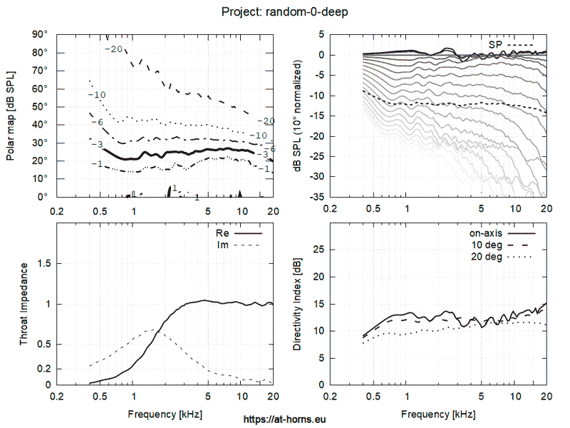

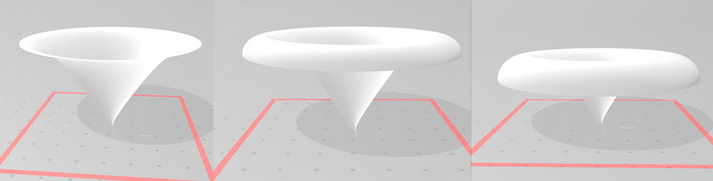

I don't remember 😀 I tried to look the data and found out I've been very poor archiving things. Found an interesting GIF though and the associated models as well. It seems to be a test how mouth rollback start parameter affects things in the ATH model. Depth and angle in the configuration file is 20cm and 33 degrees for all. Random-0 is some random settings without rollback, random-50 has rollback starting 50% of the profile length and the random-80 is starting at 20%.
Many things can be observed from this particular set:
- mouth rollback removes the resonances, but also makes the DI rising with frequency.
- The impedance/loading stays pretty much the same.
- Overall depth reduces with the rollback, first one being 20cm deep, last one ~14cm deep.
- The pattern is quite narrow and DI is "flat" only without rollback.
- Overall diameter on all these is about 14" give or take and the initial profile stays about the same until rollback kicks in.
- Bigger rollback smoothens the response very nicely.
The impedance doesn't seem to be affected by the changing depth. DI is rising with frequency with rollback, in fact the high frequency DI stays about the same but the low frequency DI drops with rollback, reduced depth or does the effective mouth size reduce with the rollback? Profile before rollback and overall mouth diameter both stay about the same on all variations. So the impedance is probably related to "the expansion", profile before rollback? Does this fit your model? I haven't thought about it, just playing with the simulations.
Anyway, in this case the impedance and "beaming" seems to not be related and perhaps can be tuned separately? I mean the beaming as rising DI since this particular model is as narrow dispersion as defined in the script.

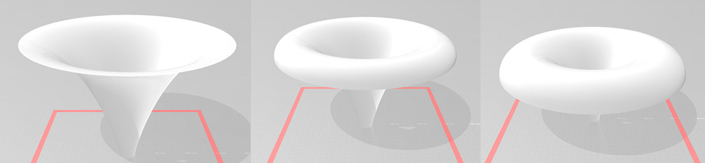

Okay same scripts but length = depth parameter changed from 200mm to 400mm and plot is from 400Hz up instead of 800Hz up in the previous.
Overall diameter varies 28"-29" give or take. Depths are 40cm, ~34cm and 28cm.
I don't know how the script uses the rollback start parameter, here the rollback start are 50% and 20% of the profile length as well, but it looks like much less on the models, don't know why is this. Profile, or expansion, should be the same since the profile defining variables wasn't changed here?
Amazingly the impedance is pretty much the same as with the lot smaller device 😀 so, it looks like the impedance can be changed at will rather independently of the other general aspects of the device (depth and mouth size), the pattern control.
Question then becomes can the pattern be varied at will if loading extends lower in frequency and can it be smoothed out? Already the pattern is different here, worse looking than it was with the smaller version so the profile would need to be changed to smooth this random deep model out. Actually the smaller would benefit better profile as well 😀
Now how do I increase the loading, make it lower in frequency? Need to test but it is late already but I'll try to change some settings to increase loading.
edit. Playing with the profile in desmos, looks like the k parameter could increase loading and if I remember higher k got smoother response on some experiments. Give me some time to prep this

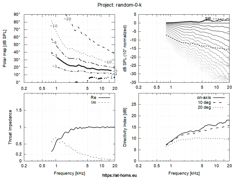

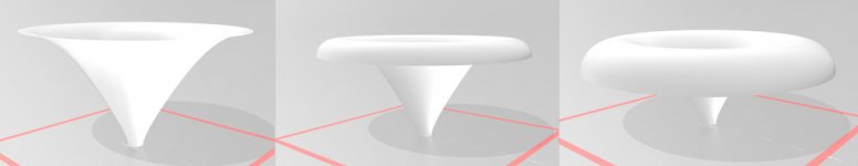

Alright, the first script so 200mm depth setting back in. This time OS-SE formula k parameter is 10 instead of 2 in the previous two sets. Now overall radius is only 11"-12", depths 20cm, ~17cm and ~15cm.
This seemed to lower the impedance only a little.. Other observations
- the impedance is not as stable as before, adding the rollback makes different kind of ripple to it
- response is a lot smoother even without rollback but the beaming is there now
So at least this time very smooth response was achieved along with increased loading but the beaming is here (DI shoots up) and impedance is not as smooth.
Too late to think deeper on this, or do more sims. The 400mm deep version would be cool to see, does impedance still stay the same and pattern control just extends lower, still beaming? I'm not sure how to really increase loading, impedance plot below 1kHz, mabat, others?
