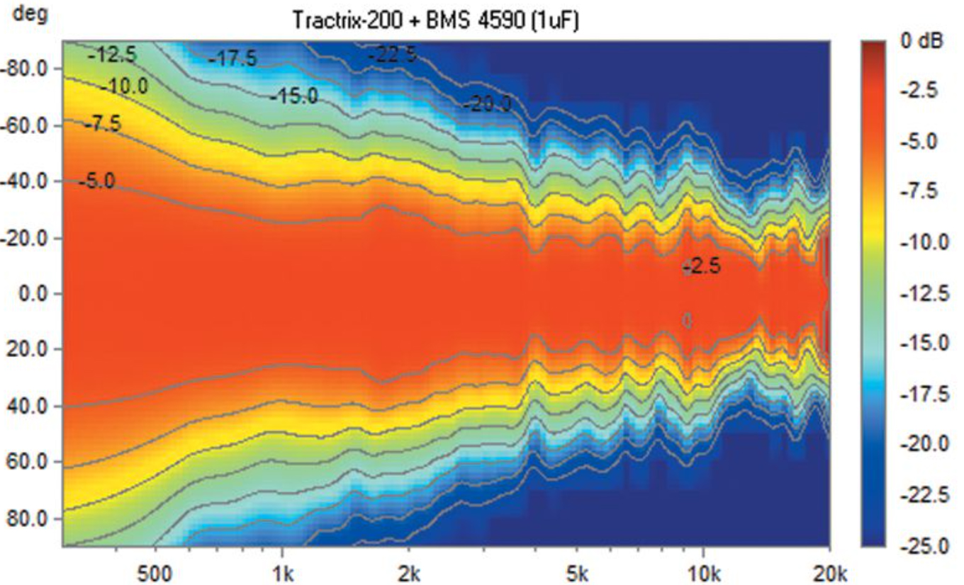

Here I present a challenge that displays easier what I am trying to figure out.
Which waveguide can I use to create directivity as strong as the above down to 500hz....
At 500Hz the directivity is not very high in the above image. Anything with a big enough mouth to give you a 120 degree pattern at 500Hz, if you also want it to have a 50 degree pattern at 20K them it won't be pure OS. If you used Ath you would want to up the k parameter and make it deeper to get more slope to the directivity.

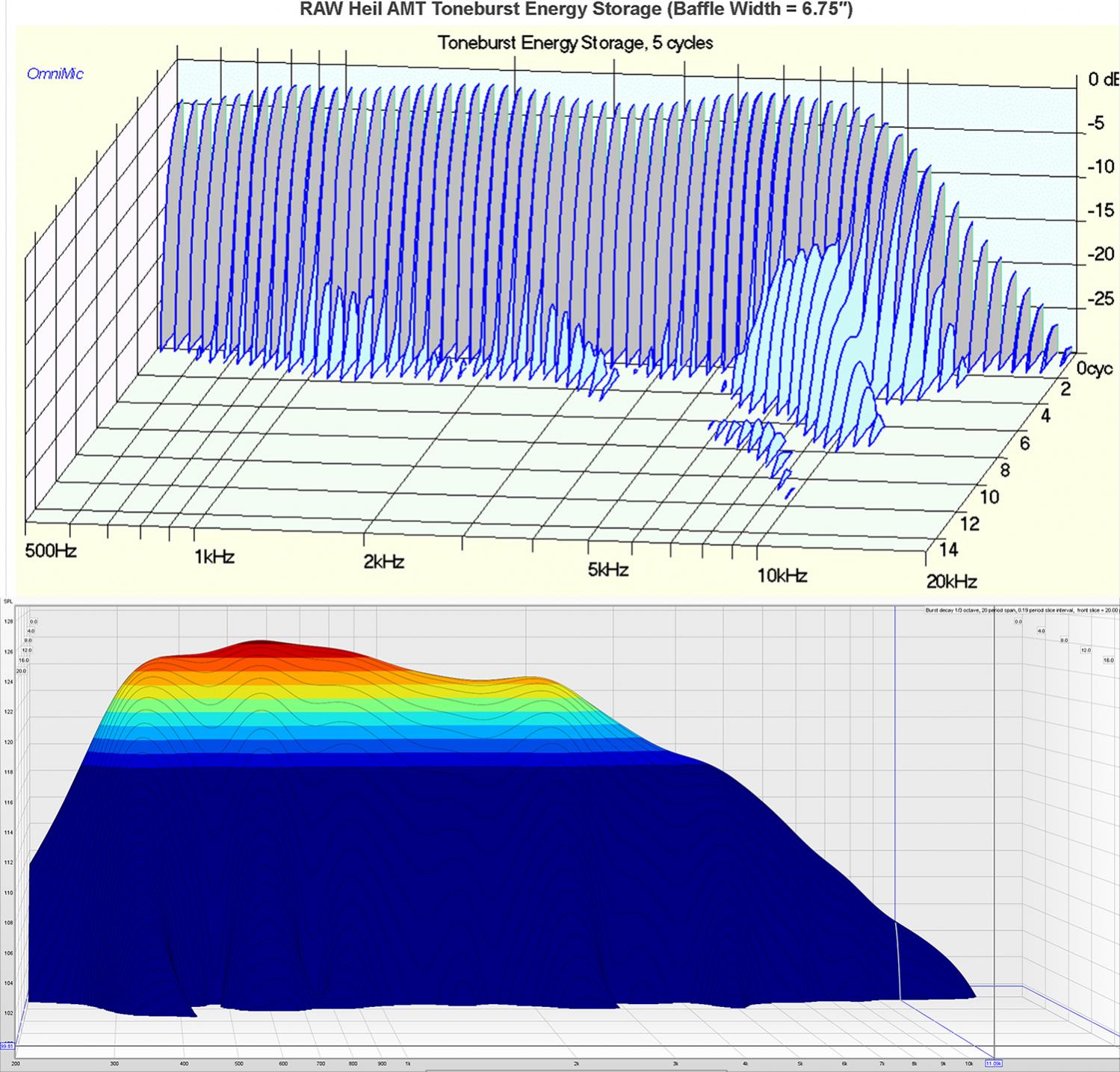

You cannot normalize group delay in REW for Burst Decay mode in the Waterfall...But We've seen the normalized Burst Decay in the other graph, I posted. This AMT should be a good example of how clean these style drivers can be. A good compare and contrast.
The cycle increments on the Axi+350 horn are units of 4.
The directivity could easily be the same, but a tractrix would a have a different radiation impedance profile that would probably help the drivers output at 500Hz.So directivity as strong as the above, down to 500hz, could be done with a wave guide with the same diameter mouth as the tractrix horn above? Or maybe I should stick with down to 800hz.
A normalized polar map doesn't show you the raw output level so whilst the native directivities might be the same the output levels could be very different.

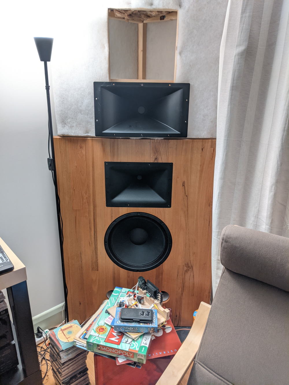

Attached is my 2 way setup so far, where i previously had a peerless 2535 on a QSC clone waveguide, which sounded very clear and detailed but lacked weight.
Then testing a large format compression driver (JBL 2453J) with the horn from the first link (and a 3d printed adapter plate) crossed over at 600hz, instead of 1100
Plenty of weight, plenty of HF extension and detail, almost as good in the treble as the smaller horn setup
The cost of this was way lower than the time cost in analysis paralysis
Next is to build another set of klipsch K402 clones and another set of woofers and run this as a ceiling height WTW setup
