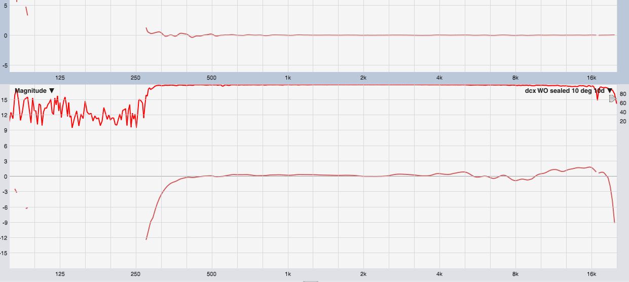

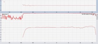

I'm not holding out on you, you just won't accept i gave you what i have.
(and that i don't feel the need for more)
Here's is the on-axis tuning trace (10 deg H) that was in the set of dcx/me464 measurements of mine you posted in #7974. (from Smaart)
I toggled the phase graph to change it to group delay for you.
As you can see ....it's flat 0.
You can also see both mag and group delay traces disappear below about 275Hz. Reason is it was windy and i use Coherence blanking to drop data where data is no longer good...(the bright red trace at the top of the magnitude pane is coherence.)
Without wind, both mag and group delay would extend lower cleanly.
But even with the difficult meas conditions, you can see how clean things are to at least a -12dB summing region......
....which illustrates why i use steep linear-phase xovers....
It avoids all the unnecessary group delay issues and crappola everyone spends so much time on.
I get flat mag, flat phase, great impulse, and most importantly.... beautiful sound....easily.

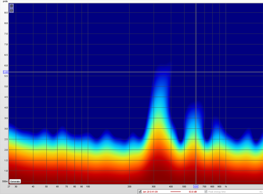

Prepare to be confused =)
It took me a while, to realize what the negative side of the graph is...though it should be obvious, that is unless I am wrong. In the case that I am right...We are witnessing the creation of pressure...time to peak energy is no less...time to peak pressure... Why is so much pressure being generated so much earlier in the bass region vs treble.
The blue trend line is the first recognition of pressure in my mind at this time. Correct me if I am wrong. And where in the heck is the real 0 in time!
Burst decay gives a n interesting view since the time scale is relative to Frequency period. It appears here that The time to peak energy is now the base line 0 for Burst Decay...potentially this makes Burst decay slightly misleading btw, since we have no idea when the signal started, truly....
please correct me if I'm wrong

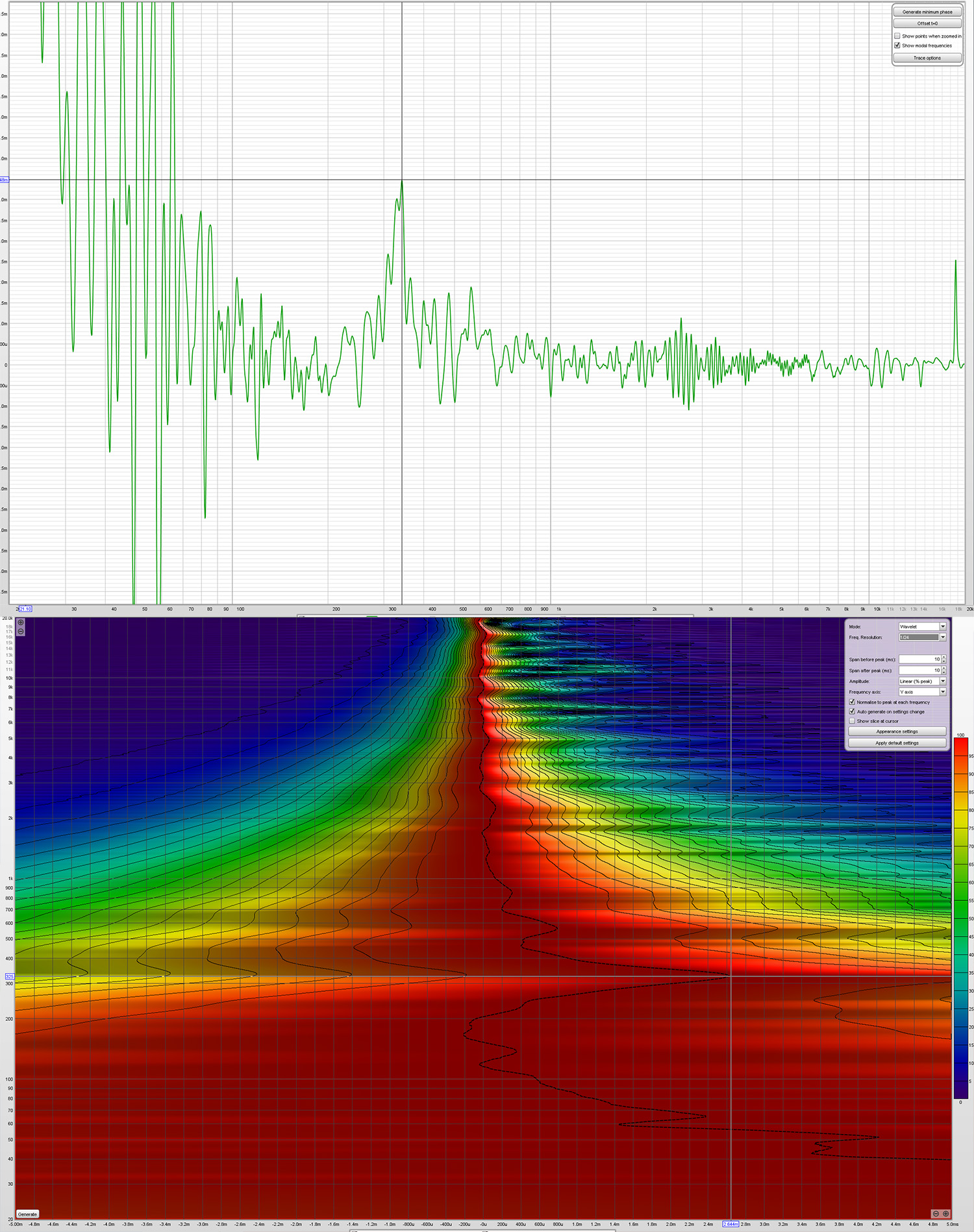

Yeah but do either of you understand the negative time area of the CSD in wavelet mode
Why would anyone want to try to understand what you believe are your 'never before realized advanced discoveries', when it's so readily apparent to all that you don't have much of a grasp on the basic fundamentals of measurements?
Not trying to be harsh...just saying please get real, so when you do have a bright idea, you present it with an air of humility that comes with a search for understanding, rather than from an air of look at how smart i am.
I presented some theories and asked to be corrected if wrong........................................................................................................................................
You literally just quoted one of my main questions.....and told me no one wants to understand lol!!!
I don't have any discoveries, I have theories and questions lol

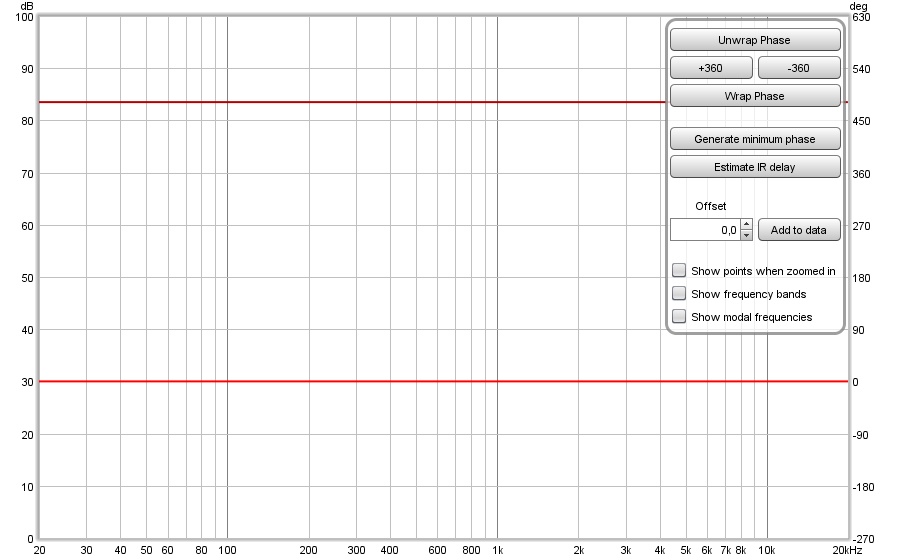

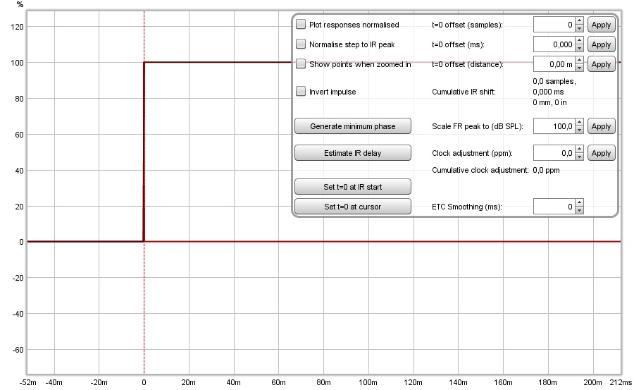

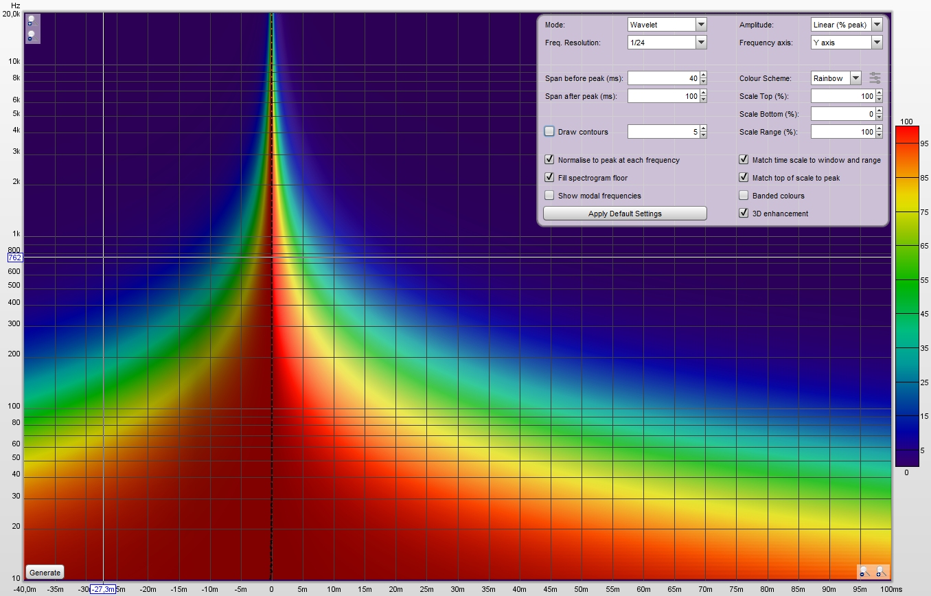

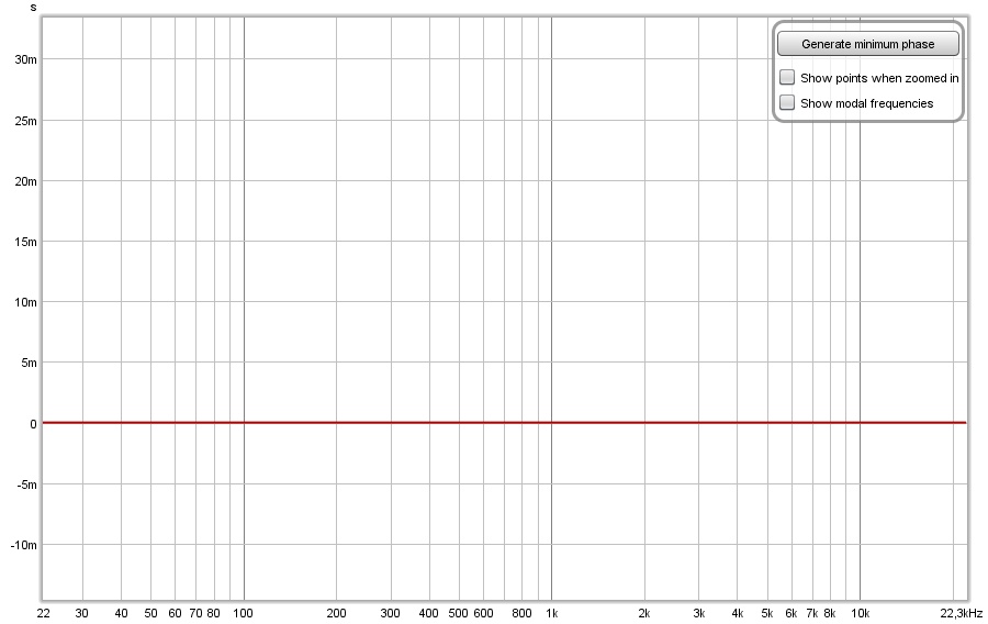

camplo,
Here's a perfect Dirac pulse, can't get any better than that:
Impulse and STEP
Frequency and phase
Group delay
Wavelet
Does that answer your concerns about negative time area in CSD mode? The above graphs are from basically an ideal source. So every note is instant, no group delay and from zero to infinity Hz. (well almost)
I created that Dirac pulse with RePhase, and so could you. That could serve as study material and an the example of the illusive ideal.
