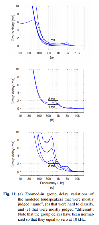

https://acris.aalto.fi/ws/portalfiles/portal/52513428/Audibility_of_Loudspeaker_Group_Delay_Characteristics_AAM.pdf
Here is some research that could be seen as a good target to aim for. In this research the impulse responses of varying amounts of group delay were time reversed and listened to forwards and reversed to see if they sounded different. Whilst this doesn't say what the actual level of audibility is if you keep below these levels you can reverse your impulse response and likely not hear the difference. The levels where is was hard to hear and obviously different give some clues where things start to go wrong.
This image is the conclusion for those that don't want to read the whole thing

Is anyone taking notice to how fluids posted graphs supports moving the xo 1.5-2x above fb....this is fun =)
Remember my 350hz horn example with the 3ms gd peak at 350hz?
Whats that? 2.7ms at 350hz....group C? Mostly Judged different? For real? Whats that? Lets put a filter on top of it to exacerbate GD even further...oooookkkkkkkk =(
Bad sq within crossband = bad crossover performance
Gd is also not good in areas around fb....move xo 1.5-2x above fb = better gd performance before adding filter and afterrrrr
I guess we shouldn't stop you from wanting to move the crossover higher. Even if moving it 1.5 to 2x would get you at what frequency... somewhere between 1050 to 1400? Really? You wanted 300 not too long ago. 🙄 You are talking about octaves, right? One octave above 350 being 700...
So you're looking for half to a whole octave higher. Not 1.5 to 2 octaves at all.
If that's your answer, be sure to EQ the output flat below fb before applying the crossover. Or you won't get what you're after if using the 1.5 number.
(I'd still say 2 x 350 is 700, yeah I noticed the "Last edited by camplo; Today at 11:26 PM." 😉)
You didnt see that :lickface:
The idea is to have flat initial fr through the cross band. With a sharp enough xo I would think that whatever is behind fb is useless so you must be talking about low order xo like 1 and 2? Im aiming for the strict side, hence the 150hz horn....I think this will allow 1st order at 300hz? Im not certain
