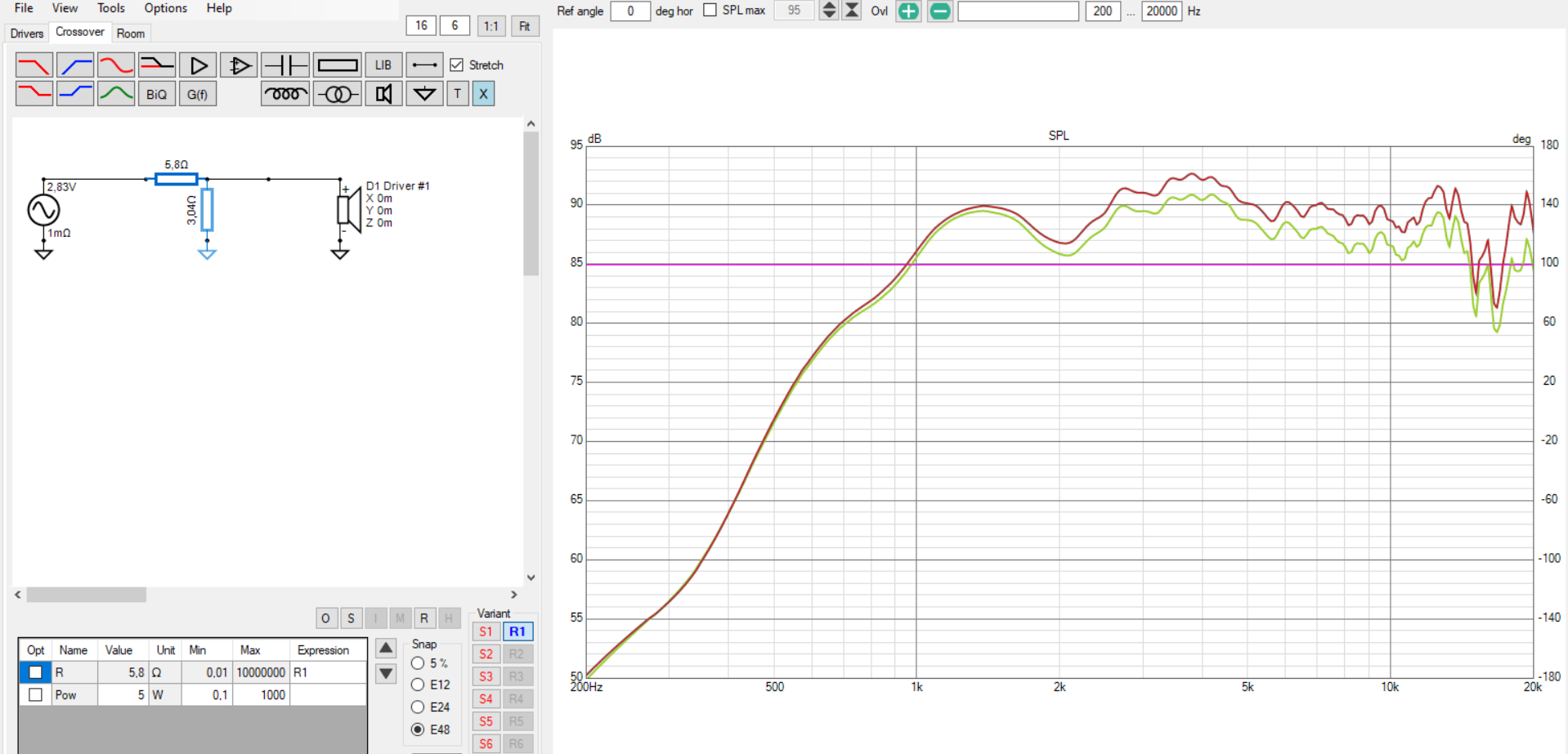

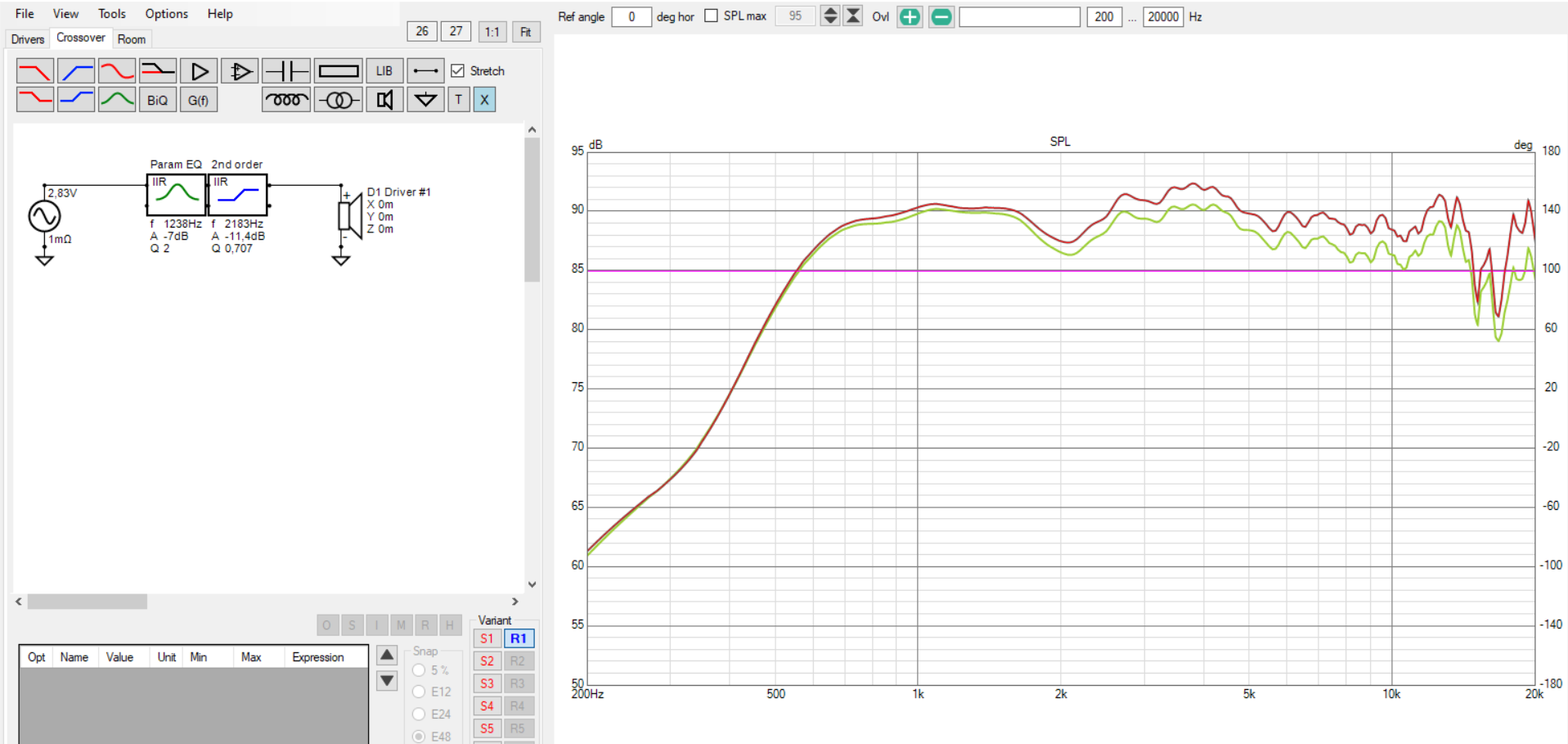

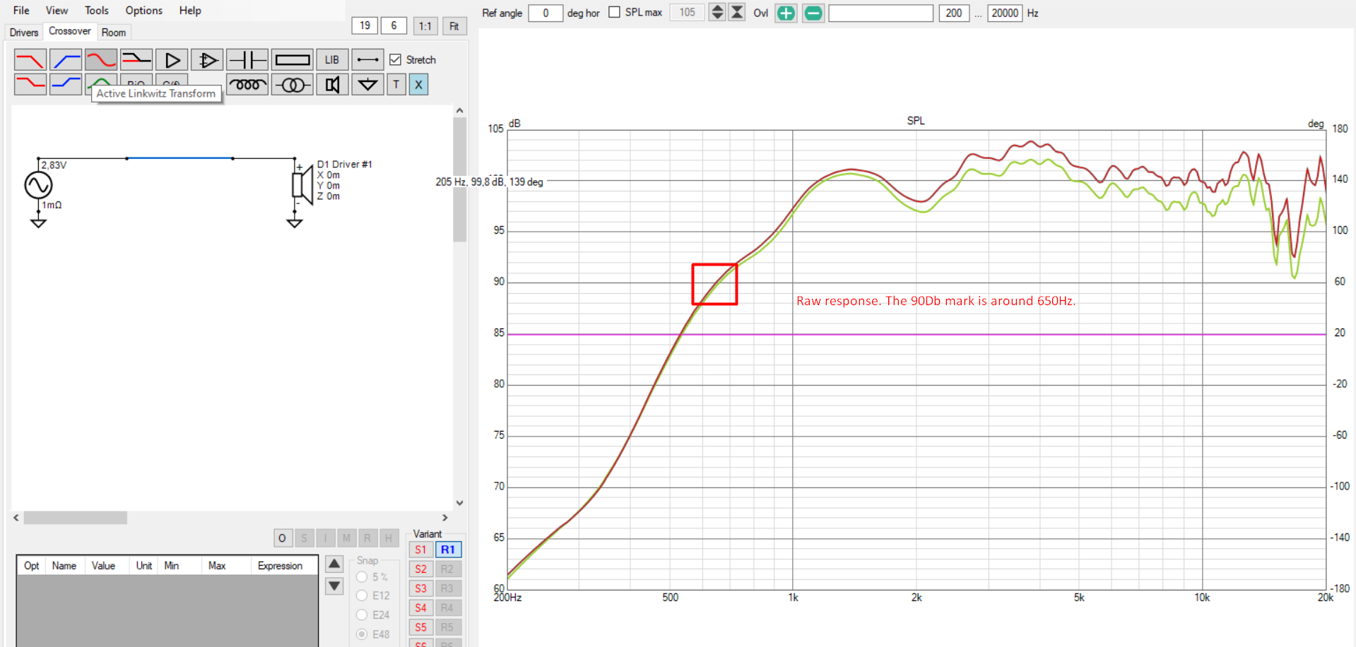

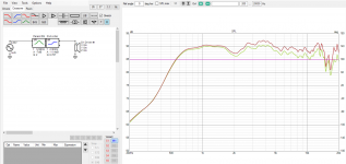

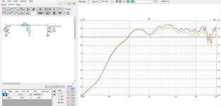

On my current setup I need to pad the compression driver ~12db to match woofer below, around 90db system sensitivity. This is about an octave worth of "free" low extension if done by EQ instead of a pad. See the attachments and pay attention to the 90db line. Attachments are:
1. raw response
2. ~90db target sensitivity with a pad
3. ~90db target sensitivity with an EQ.
The same driver that manufacturer suggests to high pass above 1kHz in its intended use (live pa systems) suddenly has response way below 1kHz for home use. High pass would still be needed, but the main thing is there is plenty of sensitivity available for most home systems without loading. If the system sensitivity was above 100db then the loading could be of use, but the whole system would be completely different set of compromises (huge woofer boxes or horns). If I had chosen the loading here for this system instead of "waveguiding" I would need to pad it down, wasted effort, a bad compromise.
^ yes this was simplest demonstration I could come up with, I'm using l-pad to get rid of amplifier noise, and can boost the <1kHz with DSP if needed but no need to since I've got to match the directivity and crossover way above 1kHz. If I had bigger woofer I could.

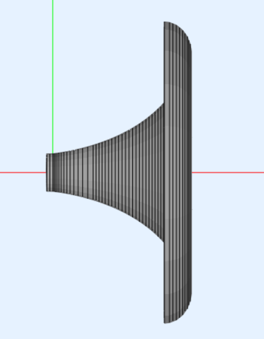

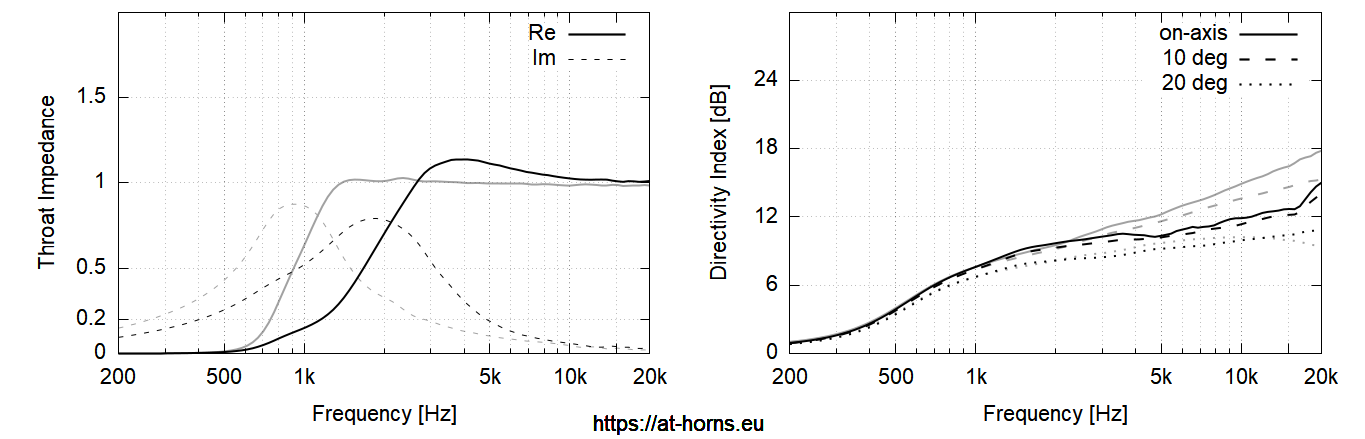

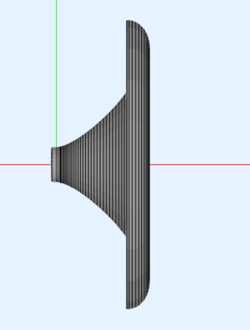

I don't have tractrix but I can show you two OS-SE waveguides of exactly the same mouth diameter (284 mm), with quite different profiles - as you can see, at least up to 1 kHz (λ ~ 334 mm) the DIs are virtually identical.
