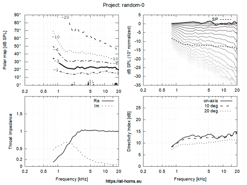

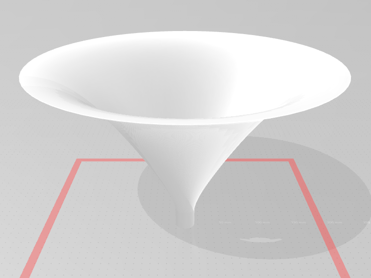

To continue the yesterday experiments here is the random-0 profile (k=2, 200mm depth) with pipe throat adapter added in 5mm, 25mm and 250mm in length. Even the very short 5mm added pipe changes the impedance, but not much of a change to the overall response except on very high frequencies. Longer pipe seems to introduce reflections (impedance wiggle).
This is conical throat extension with Throat.Ext.Length and Throat.Ext.Angle = 0 parameters. Can these define exponential expansion in ATH script somehow? It would be great if both impedance and pattern could be tuned separately. Complete control of the device would make everyone happy 🙂

1. GIF showing no throat adapter, 5mm and 25mm long straigt pipe.
2. mode lillustrating the 25mm pipe added
3. the 250mm pipe introduces crazy resonance, but the overall response is almost the same.

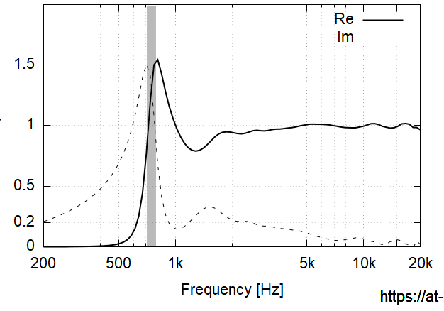

The highlighted area is what I would call the "root mode" or "fundamental" or "Tuning Note".....if you guys didn't already have a name for this portion of the response of a horn/waveguide.....your welcome
This is where the horn has max loading/resonance is it not?
Well I would never use such a crap so I don't really need a name for it but I would think you could call it cutoff 🙂
I call it cutoff too but horn hornresp doesn't....go figure... I typed it but then redacted only to have you bring it up anyway lol...we need to be specific on how we each intend to define cutoff. Its an abstract noun though it can be defined by senses....it remains an idea first. I just gave my horn builder an ear full mainly because I am use to products lying about where "cutoff" is..... "product plays to 20hz".....10inch sub with 5mm xmax.. you don't say....I guess they aren't lying, rather, using a definition of cutoff, that differs from my own...
BTW, if you took that device and scaled it 2:1 (i.e. made it twice as big, with 2" throat), the "cutoff" would be twice as low, i.e. around 400 Hz (let's say it's 800 Hz now). To make it 200 Hz you would have to either make it twice as big again, or make it even a more beaming monster...
Just one more remark - the sharp peak in the impedance as presented here (which should mean there's a reflection somewhere), could be easily eliminated if one desired, that's pretty easy to do - it doesn't have to be like this.
(That peak will increase efficiency around that frequency, that's for sure. If it caused a local group delay rise in the response, which I can imagine it could, it would still be correctable with a simple EQ.)
