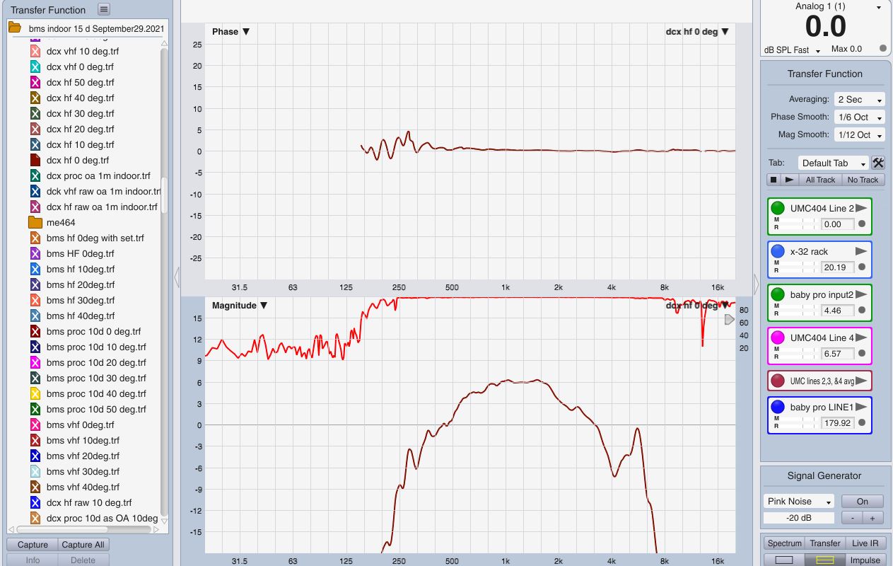

Here's dcx464/me464 lower section raw on-ax.
"Phase" graph is group delay. Someday the Smaart guys will fix the label when toggling from phase.

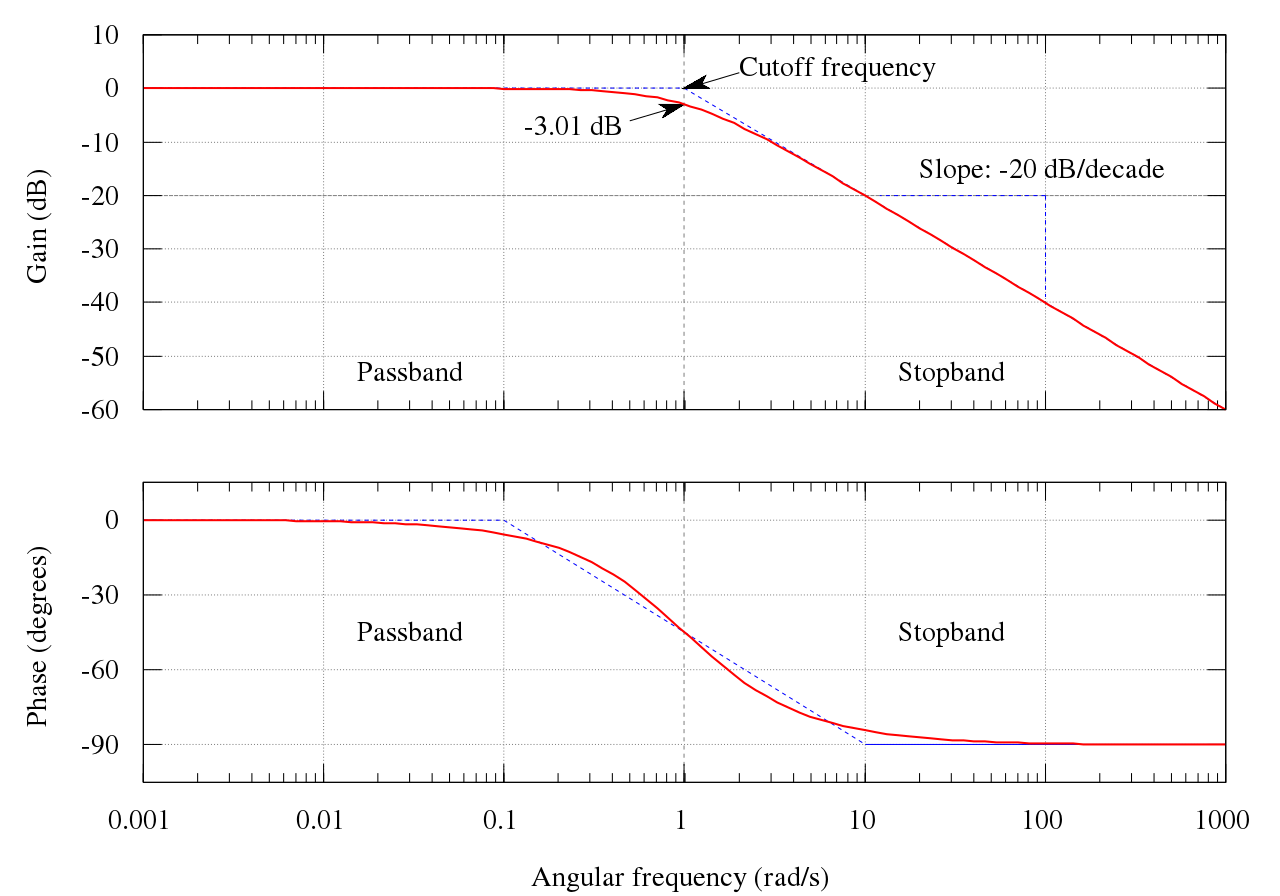

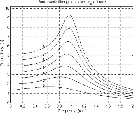

What you see is that the group delay peak comes quite close to the -3dB cutoff of the high pass filter response of the driver and horn combination.
You can look at a Butterworth filter to see the same effect. The peak in group delay comes around the hinge point of the phase shift. The steeper the slope of the filter the more pronounced the peak is and the closer to the cutoff frequency it gets.
Beat me to it; observing a rise in group delay at that point isn’t worthy of a ‘eureka’ moment. You’ll see the same on any speaker, and any filter you add for high pass.

This is a measurement taken in the real-time two-channel mode of Smaart, using the default MTW frequency-dependent window, right?
Unfortunately, I don’t personally class that as a very accurate measurement procedure for the characterisation of absolute phase and by proxy, group delay. It is very easy, but Smaart in real-time mode can make speakers look much better than they really are. That's a side effect of the software's focus on getting 'actionable data' for alignment of multiple speakers at events. 1/6th octave smoothing doesn't help either!
If you use the IR mode, it is easier to post-process as needed, with less chance of introducing error into the data. I use Smaart a lot, but it's also good to know where it's limits lie - and why there are still plenty of awesome measurement platforms that offer non real-time measurements, with a wider variety of data processing as a result.
