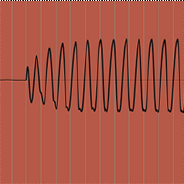

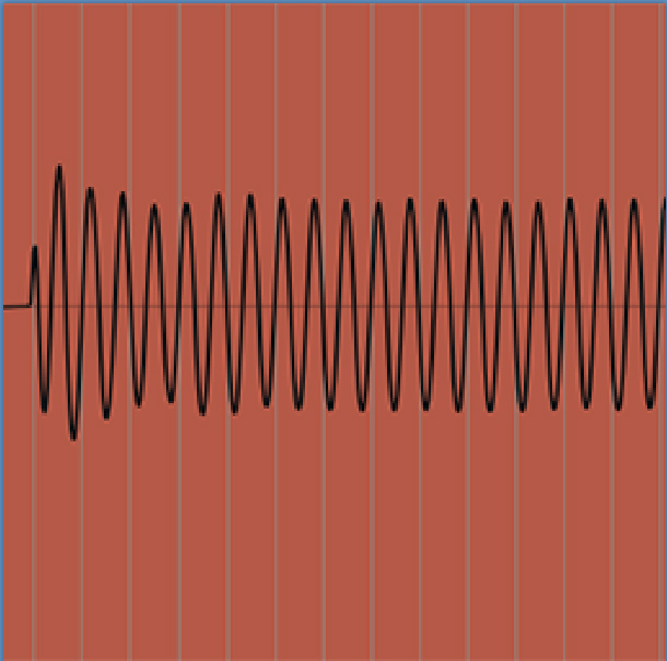

Compare 225hz (above) with ~6ms of group delay
with 294hz (below) with -763us
The amplitude takes time to reach a consistent level with 225 and 294 does not get there on the first cycle yet over shoots amplitude level almost immediately and balances off shortly after...
I saw what I thought I 'd see for the instance of 225hz.... attenuation to the of beginning of the initial signal lasting a few oscillations. I did not expect to see an overshoot within the beginning oscillations of the 294hz signal meaning to be a representative a low latency GD reading vs the example meant to be the opposite.
There were deviations from perfect among the first 21ms of both signal burst with the 294hz -763us GD being way more intense in the very first oscillations than 225hz 6ms GD

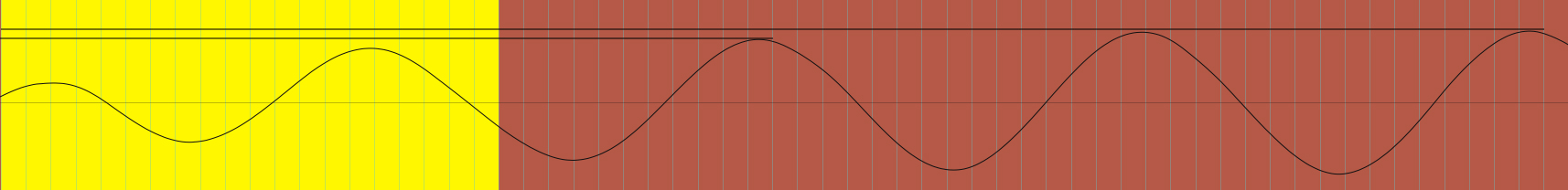

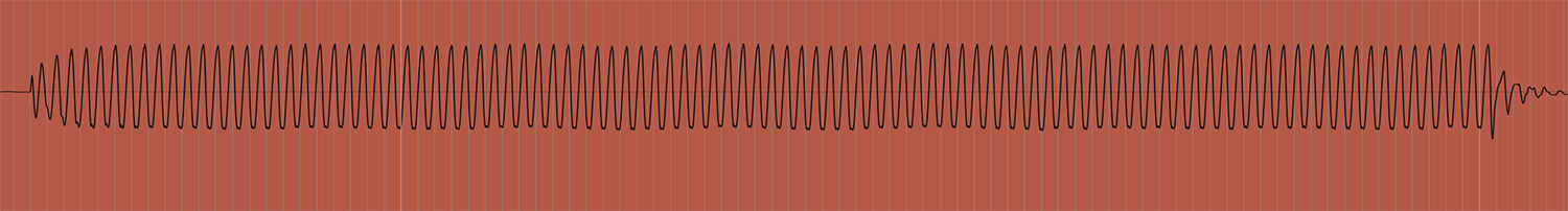

Below we have 400hz with a 3ms GD, the first ~3ms are selected.
So far these few experiments are evidence that GD is a distortion of the Amplitude Envelope, a term common to signal generators involving characteristics at the beginning, middle and end of a signal, based on key(input) press(start) and release(stop)....attack has to do with the very beginning of the signal, sustain is what the signal is doing as it is held constant and decay is whats done after input has stopped...The source signals are all intended to be perfect in amplitude, every oscillation...

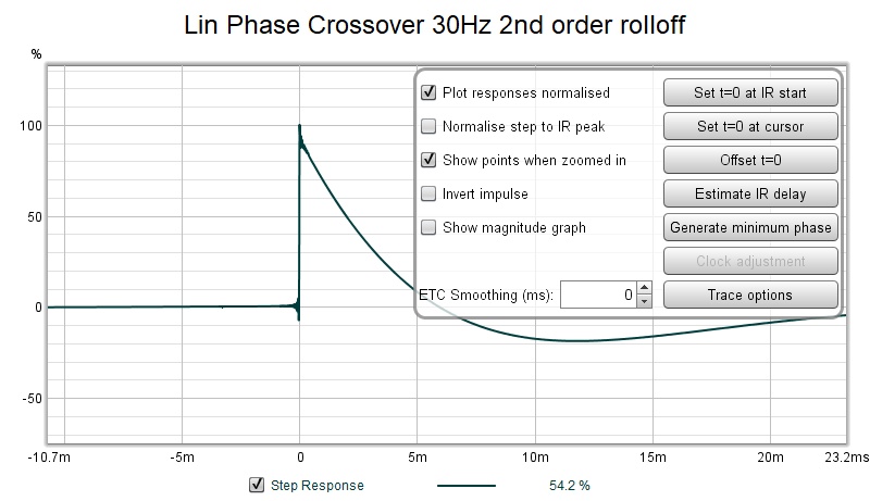

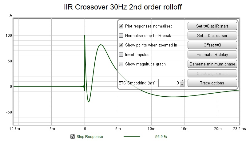

6ms of group delay is quite a lot and implies a reasonably steep filter.
To demonstrate here are some synthetic impulses to show the difference between the HP rolloff by itself, crossed over to a woofer with a 2nd order rolloff at 30Hz and the same thing but with a liner phase crossover. 300Hz in this example.
The group delay increase a little from the pure HP but that can be removed by making the crossover linear phase. You can see the difference in the step responses. The linear phase one will perform better in the sort of waveforms you showed above.
The group delay of the IIR version exceeds 1ms at 400Hz so it does fall into the sometimes could be heard if you time reversed the impulse from the research I showed before.
