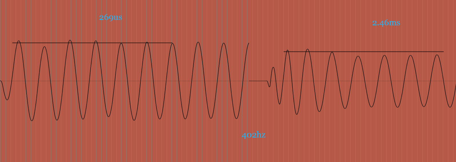

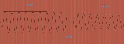

attachment.php
the left with no XO and the right with 48db LR at 500hz.
Some of the amplitude character is unique as far out as 9-13ms in these examples.

Is it you judging that your intuition was right 😉 The more I learn, simulate and measure the less I want to rely on my own intuition
Not because we can't make some accurate guesses but because there are so many different aspects. All I've learned truly is that there is much more that I don't know. In discovering this aspect of group delay in a more intimate way, I've discovered other traits that I had no idea to anticipate.
This technique of recording signal and comparing it to source signal as a form of deeper analysis? Seems legit... You might be surprised at what you find :scratch2:

You mean like this?
As measured with a demo version of APL_TDA at the listening spot some time back in 2016. As said, nothing new.
Probably have some REW files too, showing more of the same. As I kept nagging John about getting the APL type of display into REW (which he did).
Mark will have plenty of measurements that would show similar results.
We've already told you how to get there, fluid did so only a couple of posts ago. But you kept on discovering all these new things about GD.
