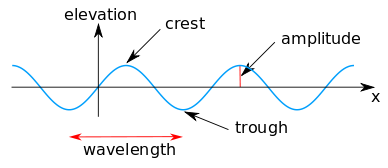

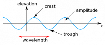

Now that, is a wow moment for me. I was certain that they were separate. I guess looking at a reference signal, any other version of it, with the same frequency, would be "out of phase? In other words phase accounts for not just the X axis of the graph but the Y was well? If we change only amplitude but leave frequency alone and put them "in phase on the x axis" they will be in sync on the X axis.
If thats the answer, I'm down.
Normally when I think "out of phase" I think of cancellations ...in this form of "out of phase" there is no cancellation

Visualization of what I am describing. This....is out of phase...is what you are suggesting. Jumping back to group delay....there is a change in amplitude involved.

I really don't get what you are trying to show Camplo.
From what i'm gather from your last message it seems to me you forget one thing in your approach: we are not dealing with devices which have infinite bandpass ( don't even know if it is relevant as i don't get what you are trying to say! 😉 ).

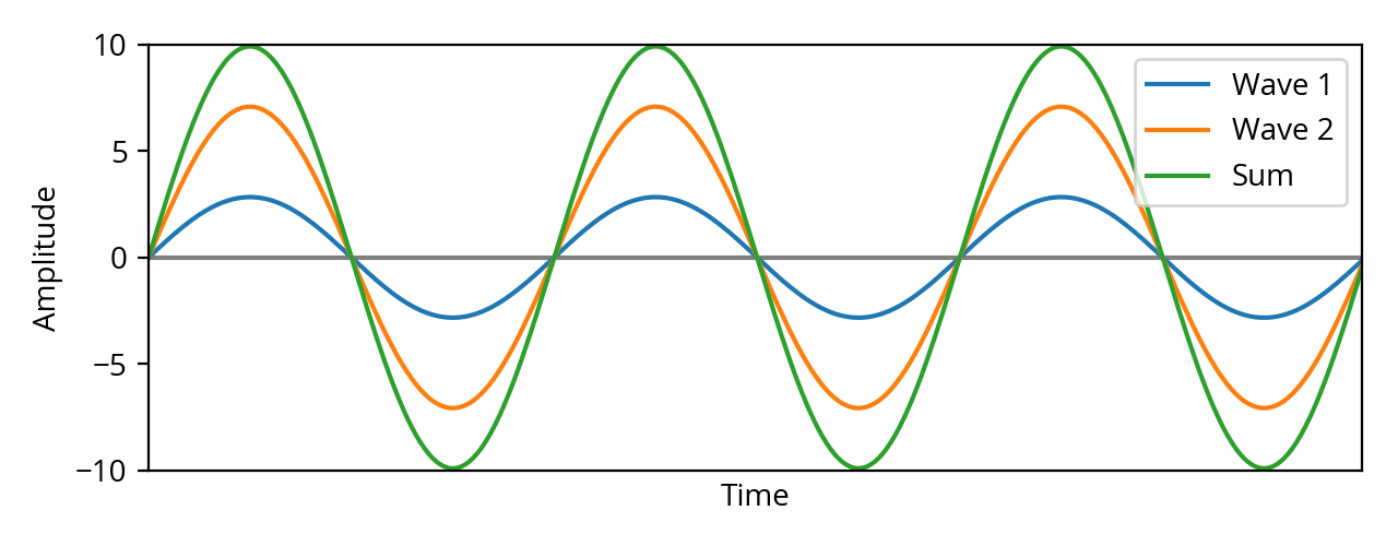

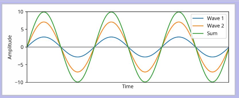

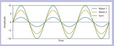

That is a graph of two sine waves and their summation.
The two sine waves have the same frequency, but different amplitudes. They are completely in phase with each other, and simply sum to a greater amplitude.
There is nothing in that graph remotely about different phase or group delay ....
