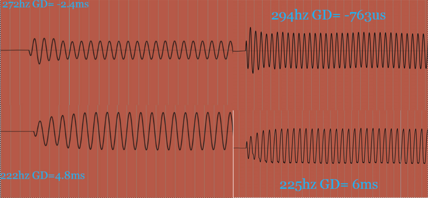

The change in the amplitude at the beginning of these burst, have an audible effect...when the group delay is high enough, it takes a longer time to go from 0 amplitude to max amplitude....this is what I believe we hear at the point and past the threshold of audibility
This involves a distortion of amplitude over time.

They are recordings of a loudspeaker playing tone burst from REW.
Wether I chose high/low group area to play tone burst, or if changed GD using xo filter....the trend was there.
I already knew about this effect along time ago though....I'm not sure if I read it or if I theorized it based on peoples experience with it.... what helped me to stay confident is the idea that I can hear it in the bass reproduction where group delay is really bad....Because of my experience in signal design when I hear something, I can do a good job on hypothesizing what it might look like, in this particular instance its really easy to visualize a small amplitude rising to a larger amplitude, overtime, based on what I heard in those bass reproductions with bad group delay...
Also not forget that a "tone burst" is never a single frequency - can't be. The rest depends on the frequency response in the band around this frequency, if not on the whole FR. Actually these burst will have pretty wide spectra, as they all seem to start rather abruptly.
I specified which was which, in my original post
The above left is a 4" mid vented, tuned to 70hz....the right is the Axi2050 on a 350hz horn. Which was only intended to be used to 400hz but since I have ordered a 150hz horn to be used to 300hz or lower if possible.
The frequencies and delays written in the pictures seem arbitrary, it is a bit hard to follow. The steady state sine in the image is at frequency you have marked? where the group delay number comes from? Trying to get handle what is it that we are looking at.
Can you repeat the test at higher frequency? The frequencies are quite low, difficult to get good measurements without reflections.
Filter effect on transient response is a known thing...in a bass driver with really high GD the filter causing this is a high Q acoustical filter on the vent. High Q filters result on high group delay

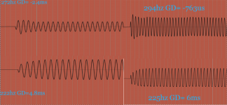

Horn left and dynamic driver on the right, I still have a trend going, regarding GD times and amplitude vs time at the beginning of the wave.
Did the "trend" reverse?
Is the "trend" that longer GD delays longer?
Camplo - since your test was of a horn, which is minimum phase. if there is GD then there is also a frequency deviation from flat, probably a peak. Both will cause the transient modifications. How do you know which it is that you hear?
Mabat - if a linear system is feed with a pure tone then only pure tones can exist at the output. There will be a transient, but its frequency content will still only be at the input frequency. In an FFT, it will have a broadened peak - the spread due to leakage - but the center tone will always be at the input frequency. The width of the peak will depend on the signals duration, i.e. the FFT window.
Earl, there can never be a single frequency in any real scenario - it would have to take infinitely long time. A finite "tone burst" itself has a pretty rich spectral content. That was the core of my comment - that much more frequencies are actually at play on those pictures.
