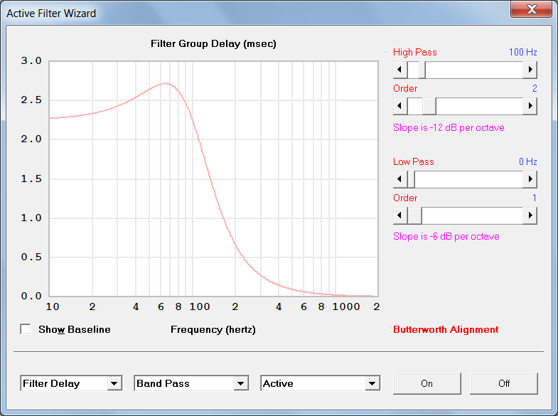

How is it that group delay seems to start low, peak, and come down again? Do computer simulations keep track of direction of spin, or can they be tricked? I've seen some moving pictures in which an object was spinning, but the direction of rotation seems to be differing between observers.
It felt like a glitch that group delay always seems to latch on to different directions of the spin in graphs, defaulting to the shortest rotation. Or is this observation not what happens in the math?

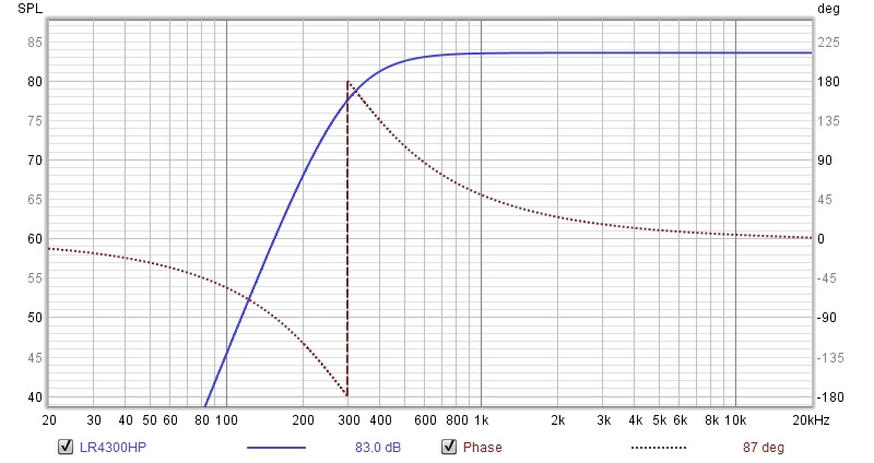

Group delay is calculated in programs like REW from the slope of the phase trace. If you look at the phase graph of any standard filter you can see where the shape comes from. The rate of phase change begins slowly then ramps up before settling down again, High to low in a High Pass filter.
attachment.php
Maybe it would be clearer to some readers if the phase on the diagram is displayed without the 360 degrees jump.

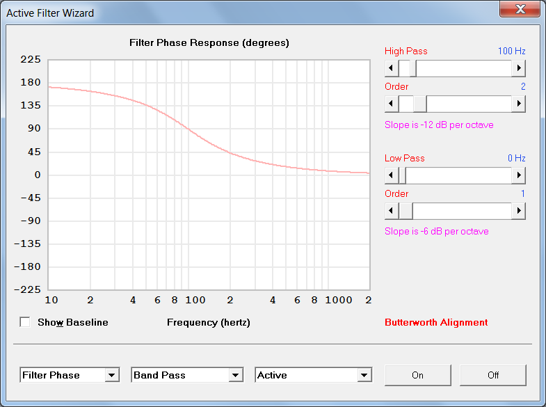

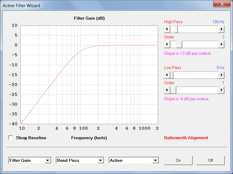

The attachments show the gain, phase and group delay characteristics of a 100 Hz high-pass 2nd order Butterworth filter.
Group delay is the negative derivative in milliseconds of the phase response. It is a measure of the rate of change of phase with respect to frequency, and is positive when the phase slope is negative.
