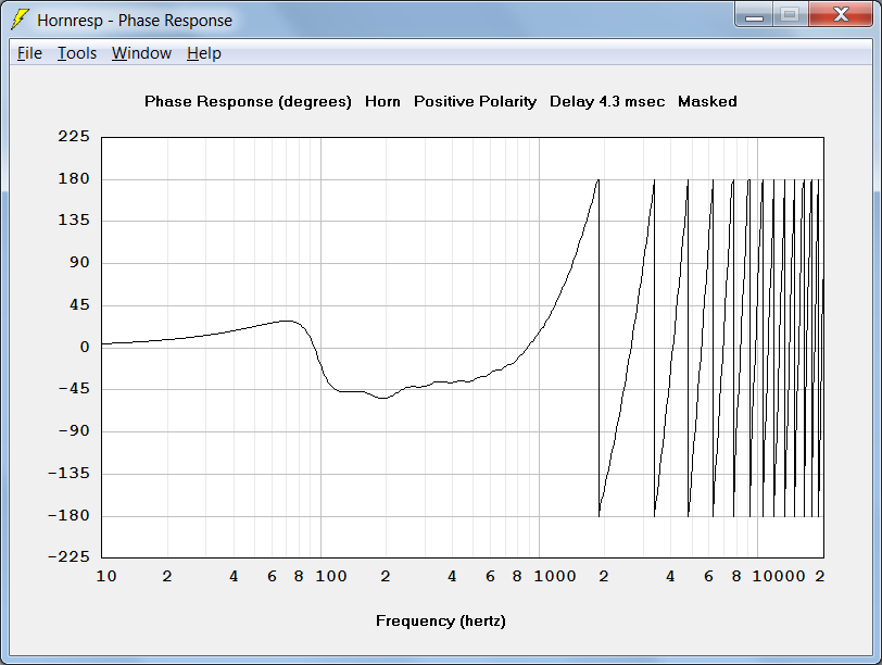

Was not expecting the thousand+ degrees of phase rotation in the pass band
The phase response chart in Hornresp shows the phase-angle difference in degrees between the input signal voltage and the output sound pressure of the loudspeaker system. In the case of a horn loudspeaker, the longer the horn the greater will be the overall phase shift. At 1000 Hz a horn with a length of 103.2 cm is 3 wavelengths or 1080 (3 * 360) degrees long, assuming that the speed of sound is 344 metres per second. The actual phase difference through the horn as calculated by Hornresp will be slightly different to that given by the above simplistic calculation, but the general principle remains the same.
The phase shifts through the driver and throat chamber (if present) are also taken into account.
also appears that horn rolls off closer to 24dB per octave than 12.
The slope tends towards 12 dB / octave as the frequency decreases. For the simple single-segment exponential horn example I gave, the SPL at 20 Hz is 67.3055 dB and the SPL at 10 Hz is 55.0740 dB. The difference between the two levels (one octave apart) is 12.2315 dB.
If I recall correctly, applying a delay equal to the path length of the horn (or path length + one meter?) flattens the simulation's phase response over the flat amplitude region of the horn.
Standard wrapped phase is displayed by default. The Delay tool can be used to add a linear phase offset as shown in the attachment. The default offset delay correction value is equivalent to the mean group delay across the -12 dB delimited SPL bandwidth.

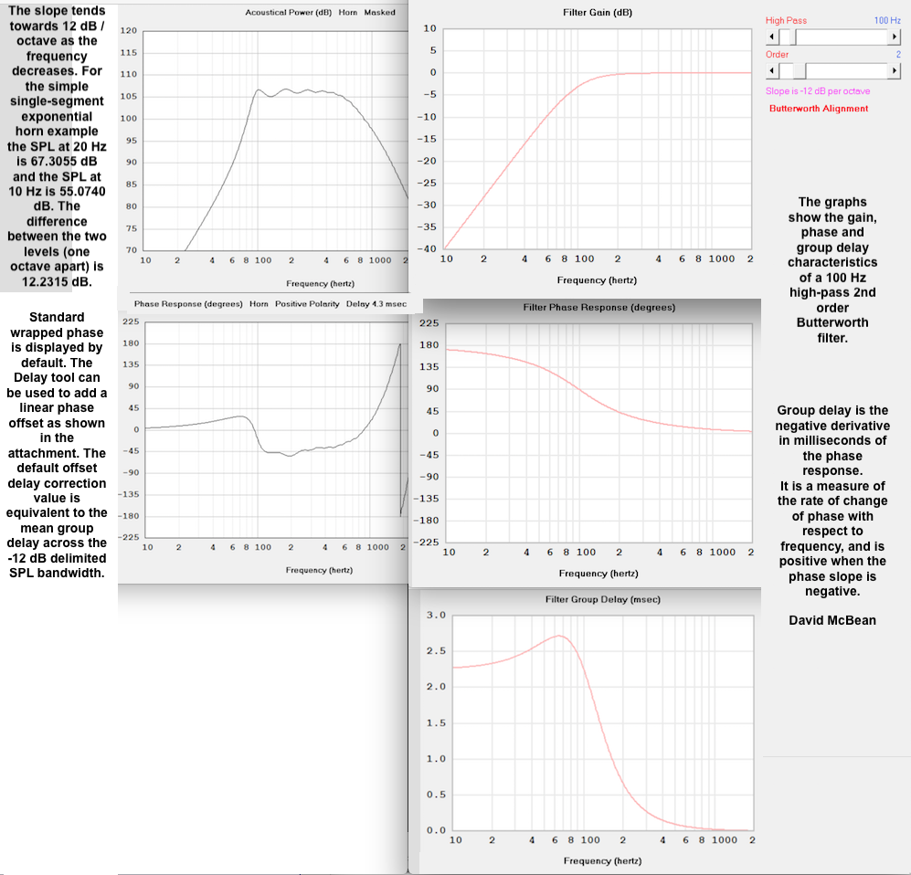

David,
Had forgot the Hornresp default does not include time of flight compensation as is normally used when measuring, or aligning a horn with a longer acoustical path length to a "front loaded" driver.
It appears including a time of flight offset delay correction would reduce GD and "phase wraps" in the horn to similar values as IIR filters with the same frequency response.
Thanks again,
Art
