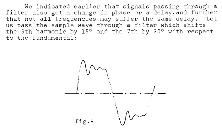

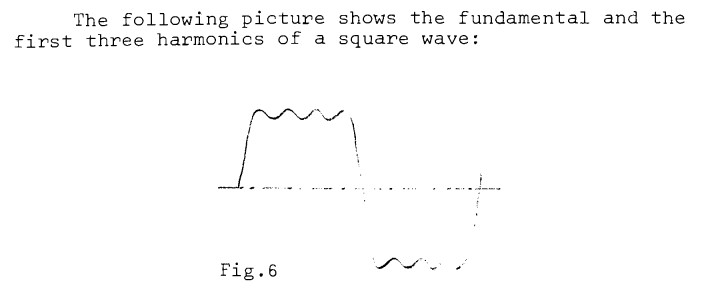

From the CATV reference there is an input wave
attachment.php
and then the same input when passed through a filter with group delay, the amplitude envelope changed, the waveform looks different.
attachment.php

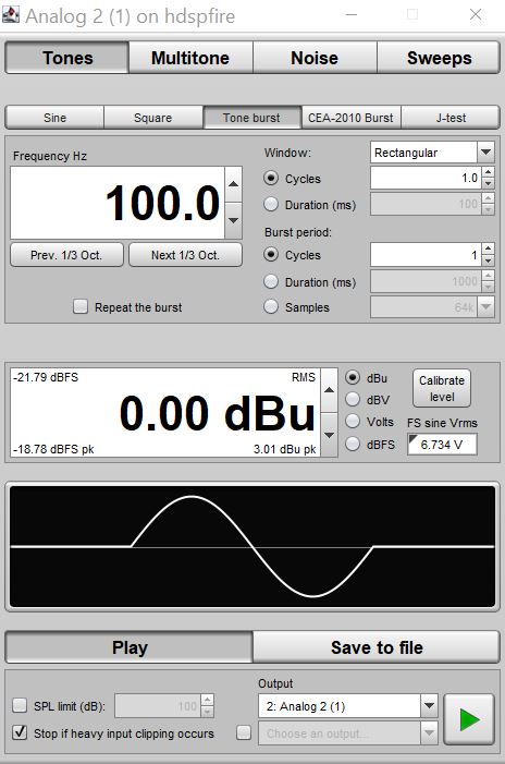

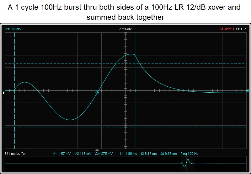

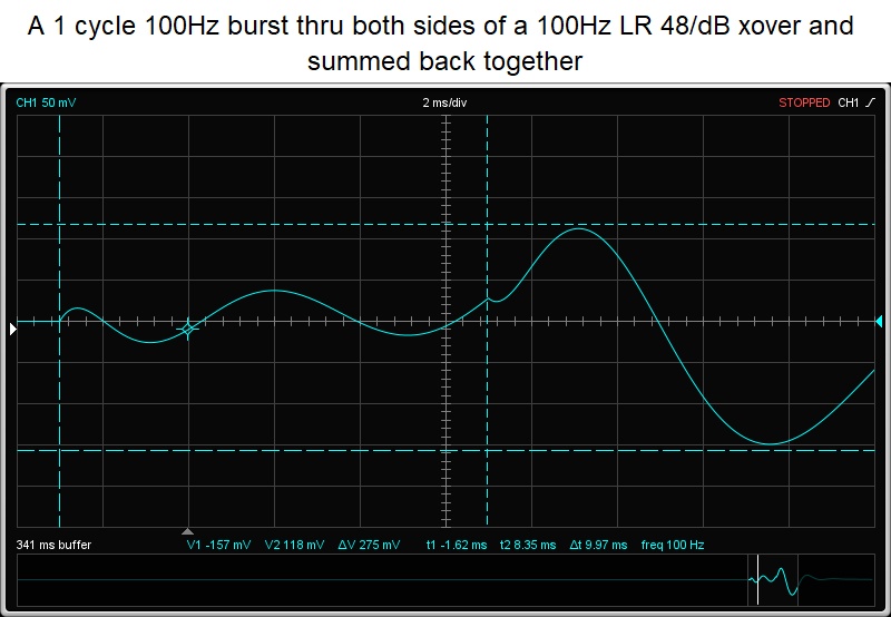

Here's the burst. A one cycle 100Hz sine wave.
I chose one cycle to make the burst even more transient than a wavelet.

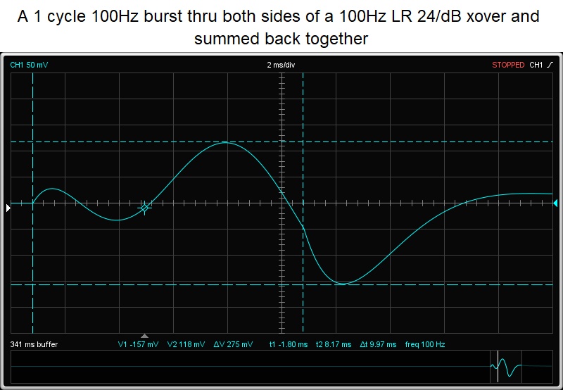

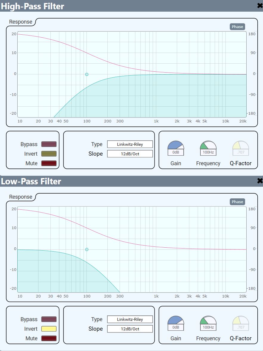

Experiment was to run the burst thru both sides of a xover, and then sum the two sides back together. Knowing that different order xovers would give different degrees of phase change wrt freq.
(I could have used a varying number of all-pass filters for the rotations, but i'm used to working with xovers.)
Here's an example of the two sides that get summed back together electrically and measured with REW's scope.

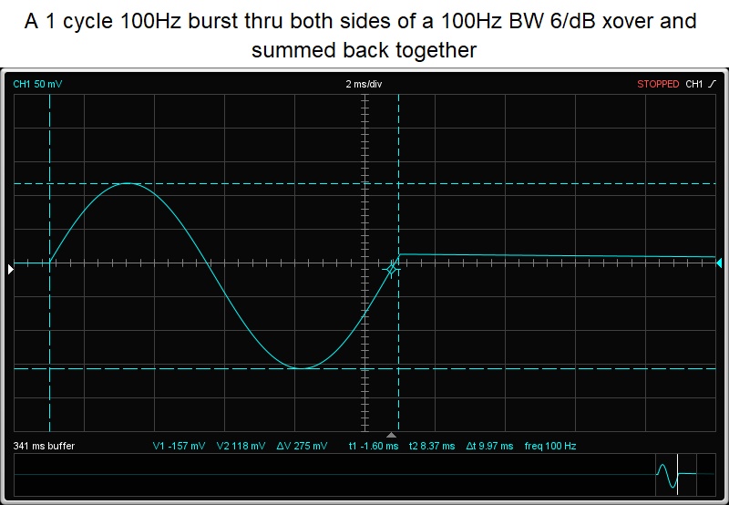

OK, the first scope capture is the burst thru a BW 6dB/oct xover.
That we know has zero phase rotation. Trace looks perfect.
Please note the scope time cursors (vertical) are set to the period of the sine burst, 100Hz.
The cursors will not move as xover order / phase rotation is increased, to help show what phase change wrt freq does to the burst.
Next a 12dB/oct LR
24dB/oct LR
48dB/oct LR

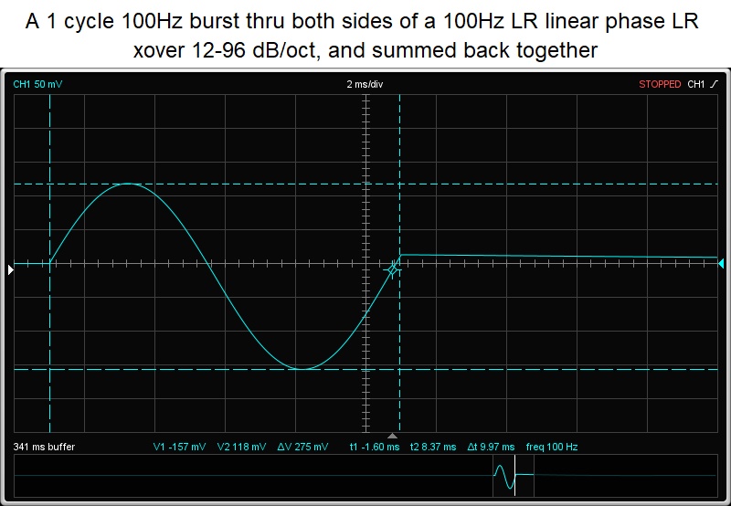

And of course, my ever ongoing plug for complementary linear phase xovers with zero phase rotation at any order desired..
Here's a 96 dB/oct lin phase LR
I've looked at impulse responses of xovers aplenty ...many of us have...but the burst is new to me. All due to awesome software like REW and AARTA.
Btw, the REW scope is super! So is the signal generator, and the ability t do these type experiments. All that's needed is a good flexible dsp to play with.

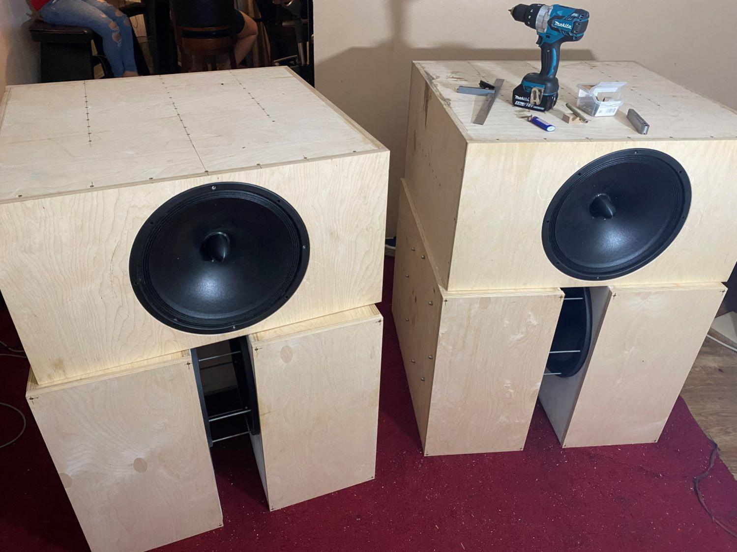

This is where I left off...soon after this, I ran into the issue with the measurements of the AEtd15m being wrong and until I get that sorted I am sort of at a stand still....The 150hz horns probably will not be here for another 4 weeks...I have another 5-6 weeks of work left so the timing is good. I work crazy hours in the summer and then have 6 months off. Hard to do anything but verbal discussions online. Tis the life of a road construction worker.
Maybe its time to start developing a waveguide for the Axi2050.
Any suggestions? Seems like 15" diameter is the place to start....

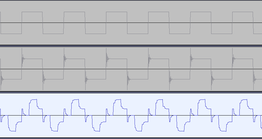

This is my best effort at a simple demonstration. I have attached three audio samples zipped up. There is a square wave at 440Hz. Then two different allpass filters are applied to the square wave. The first one causes clipping at the front of the step, the second one mangles it completely.
But the sound is really quite similar. The clipped one sounds a bit distorted, but they don't sound anywhere as different as their respective amplitude envelopes show. All that was changed was the phase and associated group delay and this was the result.
