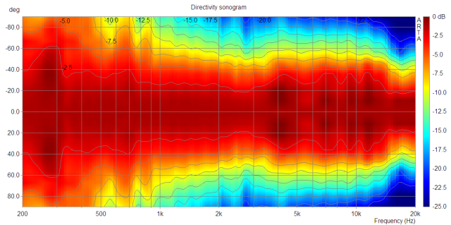

The waveguide polar is more effective for comparison and contrast if we know what it is lol

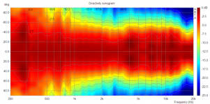

I just seen a nice looking polar and jumped on it.
S15 Econowave is what its called...Looks to be a 1khz XO with a 4th order slope.

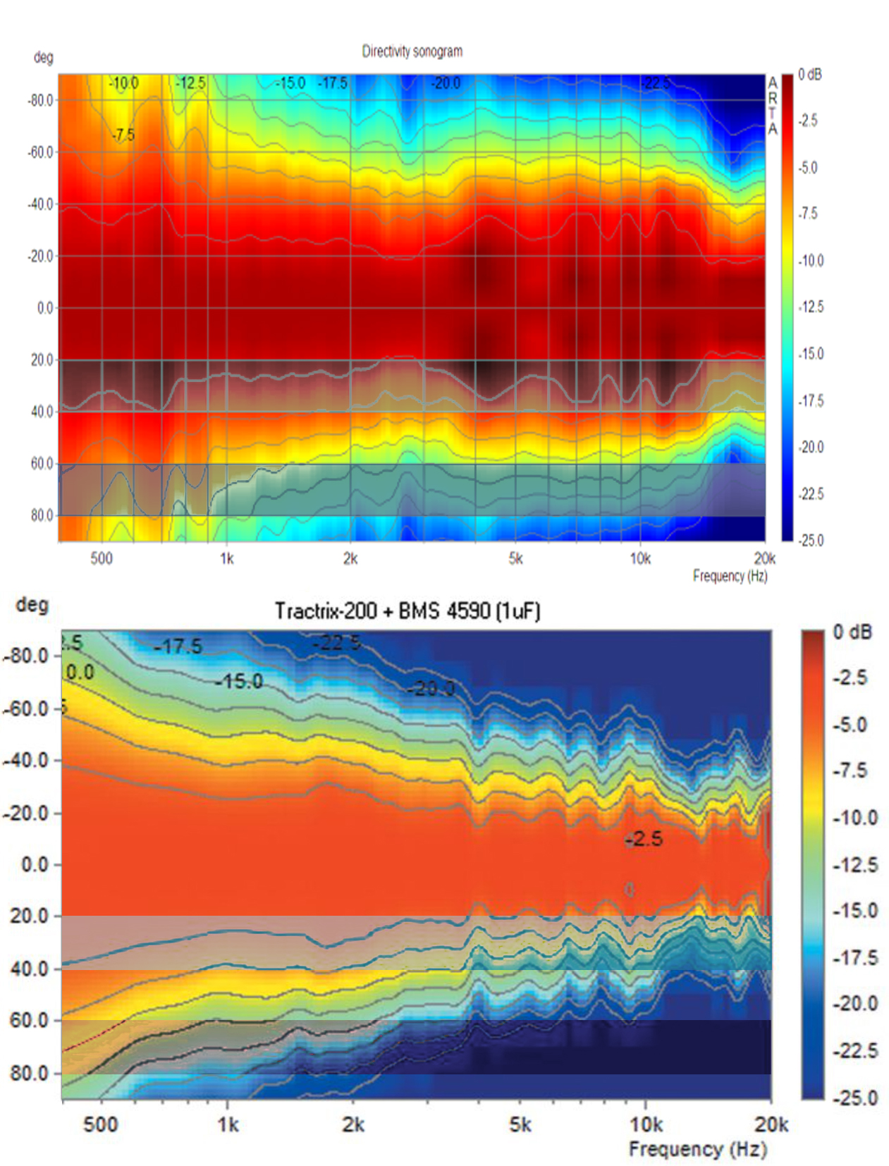

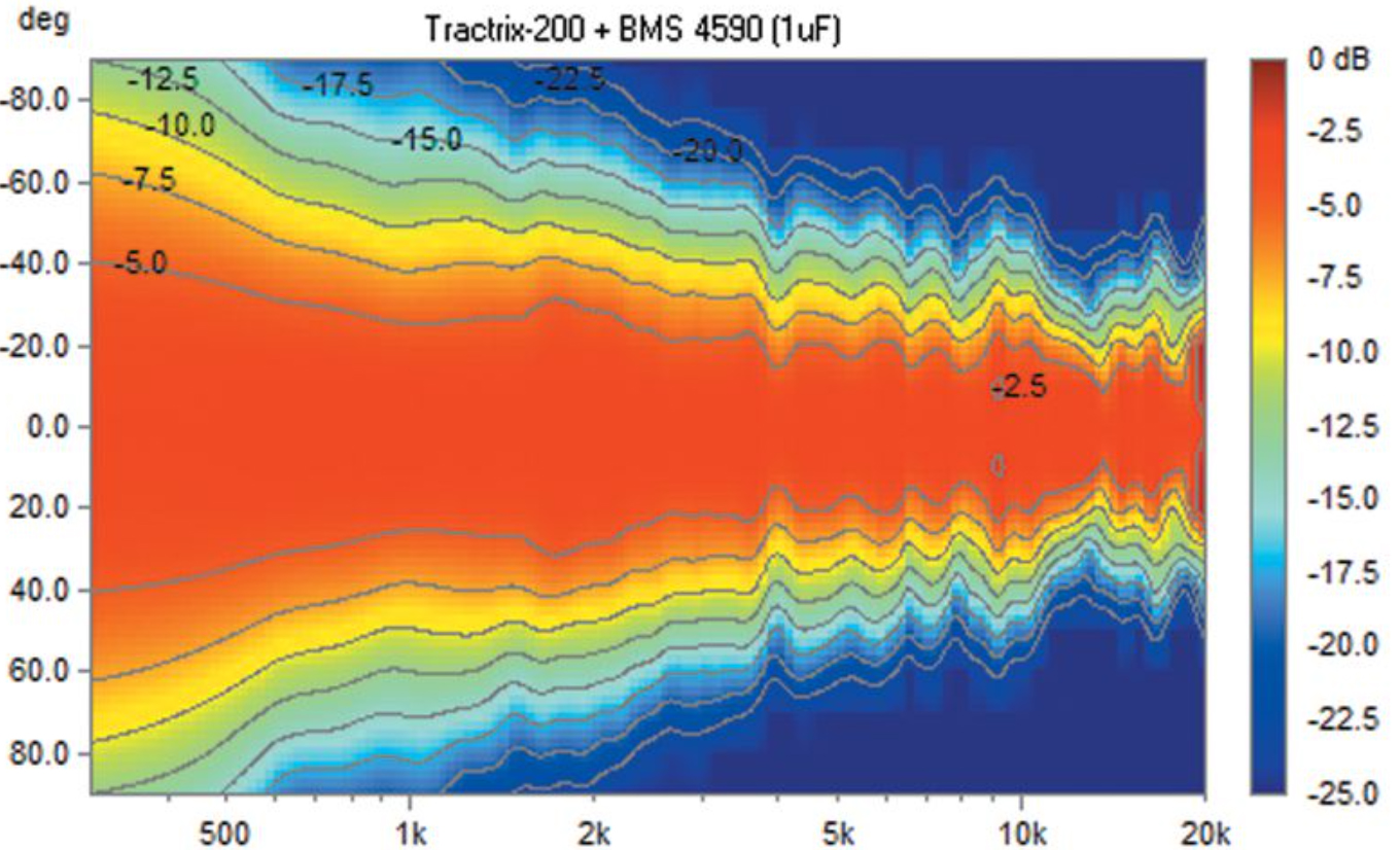

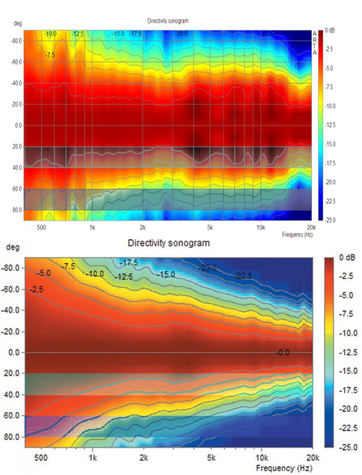

I made this to start the compare and contrast of a nice performing waveguide and something generic to the horn philosophy though still successful.
These two examples likely have similar dimensions of mouth width. 350hz tractrix and the econowave waveguide pictured above
The larger horn, to me, represents a higher level of performance in a certain light, for horns. I think the Waveguide shown hear has a lot of qualities that are good, that is, higher level for waveguide. The best of the genre improves on FR smoothness? Coverage angle is still similar of the "best" waveguides?"....With a waveguide you cannot run the driver below the cutoff of directivity, with a horn you might be able to. So with a 15" wide waveguide, directivity falls much so after 900hz or so? With a 15" wide tractrix horn, same thing but this horn will play till about 700hz or so? With a 23" wide tractrix directivity starts to fall after about 589hz and it will play down to about 400hz. 2x fc rule....but I am learning that F is still up in the air on what a manufacturer will tell you. Anyway, all that must be considered will matching polars with the woofer, thinking of 15" in general. A waveguide will lean towards a mouth the size of the woofer its matching....a Horn can be mismatched mouth size vs woofer via playing into the area after directivity falls.
The scale on the 200hz is slightly disported I believe, being that its base level is -2.5db vs 0.0db. So It is in effect, slightly wider coverage area than it appears. The general trend should still show. Don't forget, 1khx XO on the Econowave...

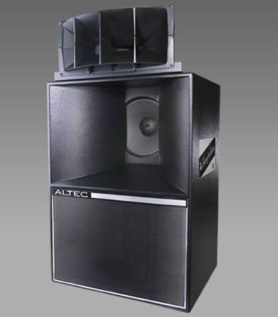

Anyone have an actual polar map of an Altec 604?

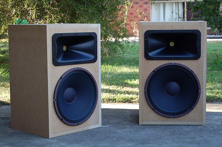

From the few waveguides I have used in a prototype it seems that you want to crossover somewhere around frequency that is one wavelength of the woofer nominal diameter give or take some for smoothest transition depending on the size and pattern of the waveguide/horn. On a 8" woofer I don't get quite as smooth transition to RCF H100 waveguide around ~1200Hz as with a bit smaller STH100 around 2kHz. These are the xo where each of the devices give their smoothest transition to a 8" woofer looking at the DI and early reflections DI. 8" would be wavelength of ~1600Hz.
Based on this limited experience I suspect your smoothest xo with 15" woofer would be around 900Hz give or take depending on your horn/waveguide. I don't know how meaningful "a step" in the DI graphs would be. I suppose it reflects to the sound somewhat but I don't have enough experience to state how much of a difference there would be in each case or is it good or bad compromise for some other qualities.
The STH100 is a tractrix horn with rising DI, and the RCF H100 is almost constant directivity device. Based on this small sample I have reasoned a narrow pattern horn benefits crossover higher in frequency and a wider pattern waveguide benefits crossing over a bit lower in frequency (compared to the woofer size) to get smooth transition. Physically the wide pattern device has a bit larger mouth than the narrow pattern device. I'm not sure if you would get smooth transition with big narrow pattern horn unless having even bigger woofer (maybe array of smaller woofers) to crossover to. You should measure your devices in possession to see the differences in a simulator and then check out which device sounds better.

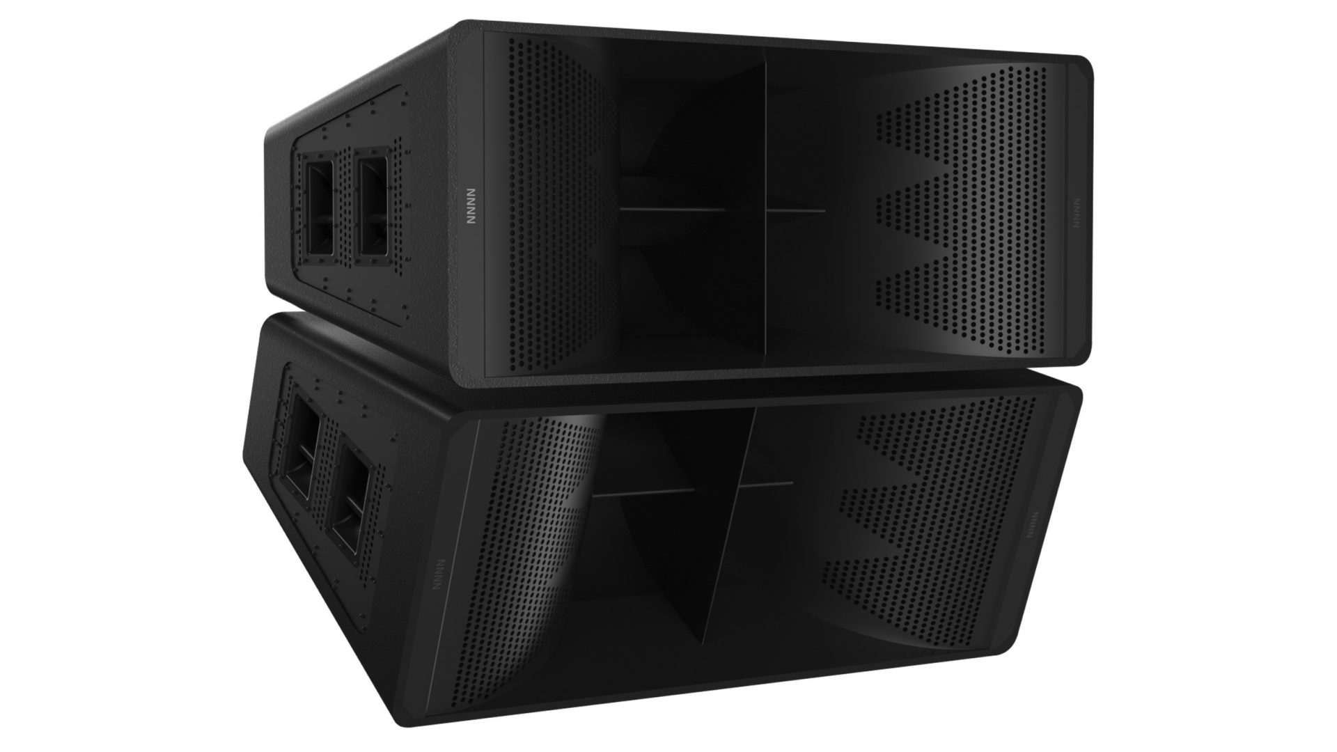

In that pro world, a Norwegian company called NNNN had a short-lived product called the Graft 40 which used a Celestion Axi2050 alongside some clever patented lossy chamber approach for the low section. I believe it got postponed or sent back to the drawing board due to COVID:
Sizing information is still available here:
https://nnnn.no/wp-content/uploads/2021/02/NNNN-Press-Kit-1.4..pdf

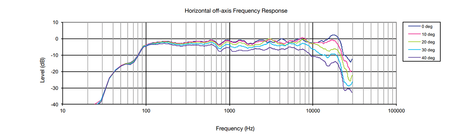

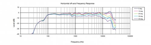

Oh, and as someone who's worked a fair bit in anechoic rooms of various types - it isn't as uncomfortable as you'd think. Most HiFi or studio speakers sound pretty strange in there though, since they're designed around their intended final usage location. You might find things feeling a little 'thin', and the aforementioned 'giant headphones' feeling is prominent for anything I've listened to in there. It doesn't mean the data obtained in one is any less useful in practice, as it can be convolved with room impulse responses - generated, calculated or measured.
