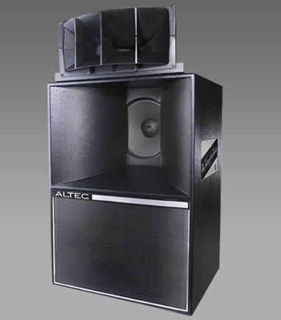

You would think the slot caused some type of ill affect on the woofer here?
604-8K with the [then] superior Mantaray diffraction horn: 604-8K
?? You mean the horn's throat? Why? There's no parallel sides and it's a 1:1 CR.
The 816, 817, 210 horns with parallel sides is a whole different matter though when compared to the 825/828: http://www.lansingheritage.org/images/altec/specs/components/515g/page3.jpg

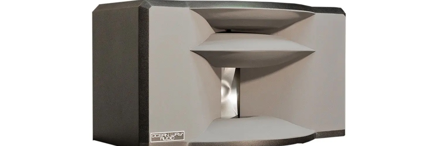

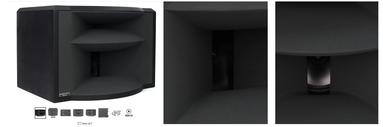

GM - I was referring to the way the sides of the slot overlap the woofer cone....theres a bit of area on each side of the woofer that is covered by....the slot. That, has no negative effect on SQ? Just a mere change in dispersion? There should be distortion at the edge of the those surfaces, shouldn't there?

This construction with the partial coverage leads to some compression like it is used in compression drivers. Although with a much smaller ratio. But the throat shape of the VOTT isn't very smooth which will have some negative effects. A similar construction with a much smoother shape was once made by RCF. The same RCF horn shape is still used for the larger Ocean Way monitors.

Not really, the horn only loads to ~338 Hz and the only real anomaly in its frequency response is due to the XO in the 400-500 Hz BW. The slight 'ripple' is due to the truncated mouth; add its original baffle to make it 50" wide x 67" high and it's nominally ripple free, flat down to ~66 Hz: 800 VOTT

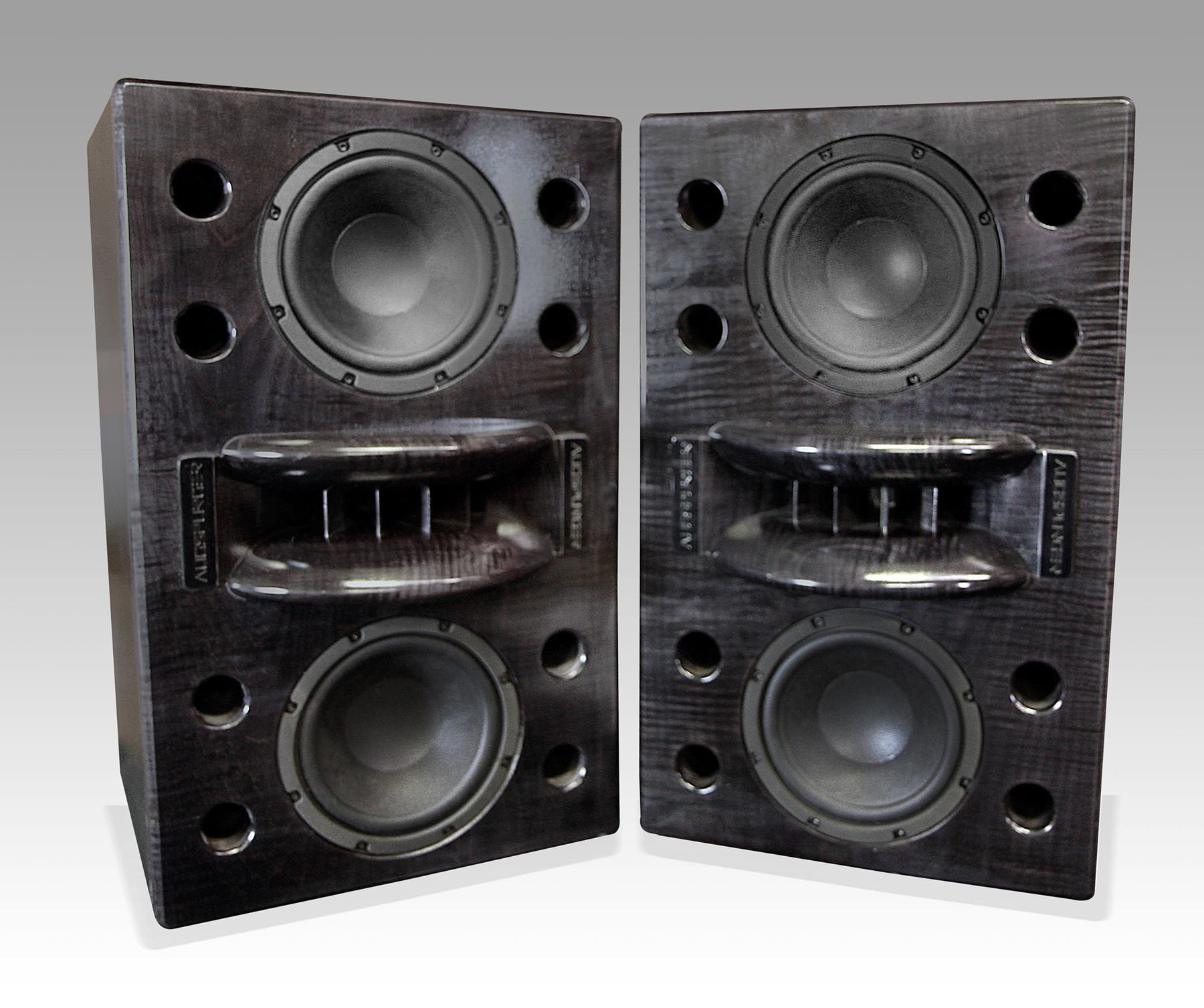

1)When using drivers capable of wide overlap in the crossover region, in most cases reducing the frequency bandwidth required from the HF driver in it's lower frequency range, and covering a bit higher with the woofer (or low mid) improves sound quality. The "pioneers" of horn speaker development recognized that around a decade of operation was the limit for really good sound quality from horn/driver combinations, which has ultimately resulted in most HF drivers now being used above 1000 Hz if they are required to cover the extent of HF hearing.
2) The Ocean Way monitor uses a more narrow slot to match the wider dispersion of it's HF horn crossed over at a higher frequency than the 1950's era RCA model MI-9462 radial mid-bass theater horn it's design is based on.
"Mere" matching of LF to HF horizontal dispersion in the 500-1500 range where slotted woofers typically cross over to a HF horn is considered quite important to most critical listeners.
3) Covering the outer portions of the woofer creases an acoustical low-pass filter, which reduces both the upper range and harmonic distortion components.

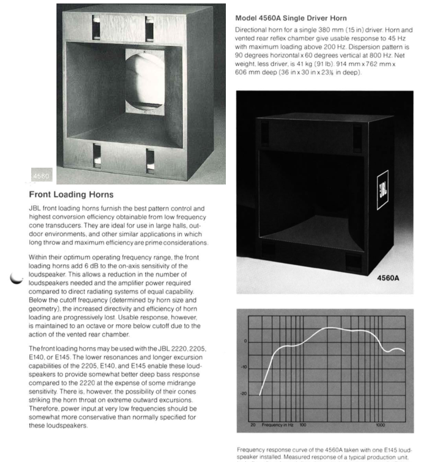

The JBL 4560 is typical of short exponential type mid-bass horns, it's frequency response illustrates +5dB horn gain in the 200-700 Hz region followed by the acoustical LP reduction of around 8dB, dropping to a few dB lower than a front-loaded speaker's response in the 1kHz range.

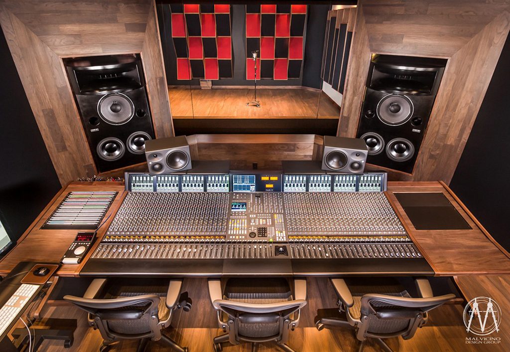

The waveguide on the midwoofers here, whats the science behind this? A live sound guy tells me that these loaded with smaller woofers are replacing 15" mids...claimed that smaller woofer had better transient response, due to lighter cone, and the bullet thing in the middle was not exactly a phase plug but provided front pressure and helped balance the diaphragm with the pressure behind the woofer via cab....

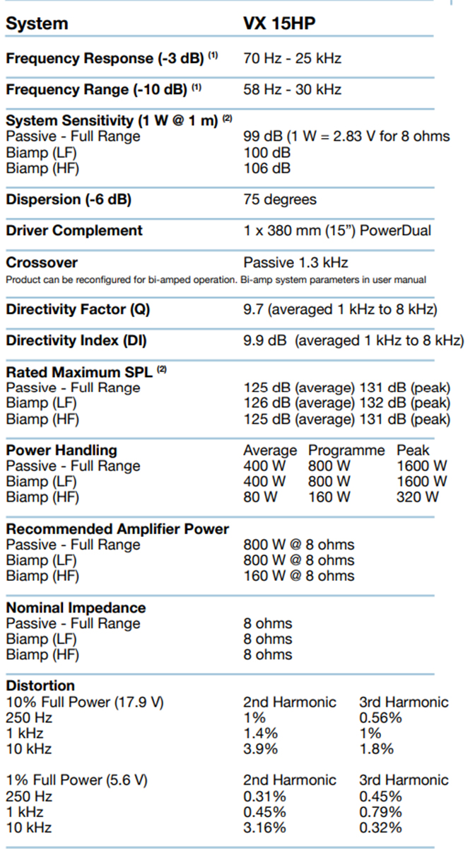

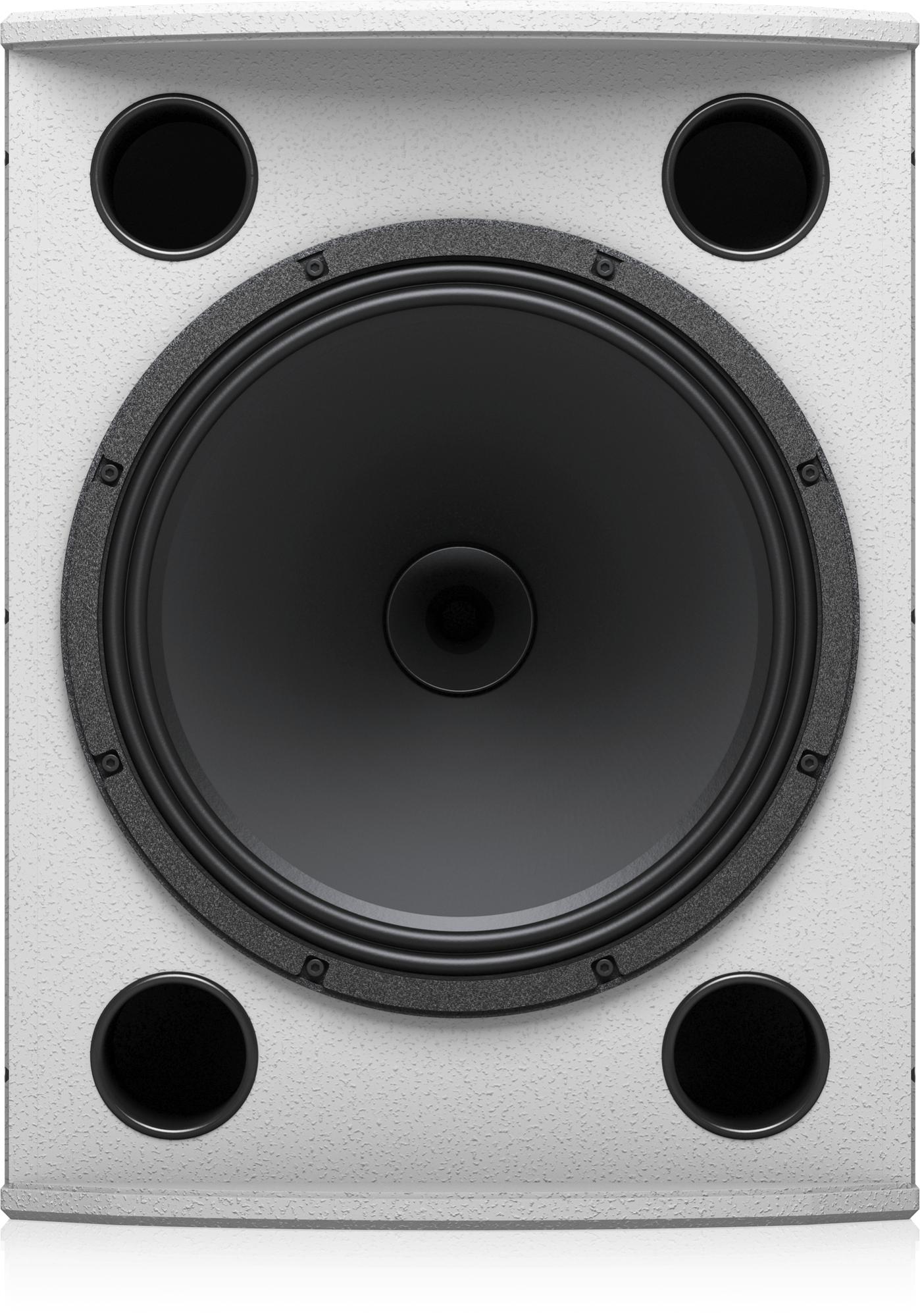

A driver like this, in an MTM configuration with pair of 15s or 18s. I noticed that with the Kingdom model the Tweeter is being crossed at 700hz... Its likely that the same potential is true for the Tweeter in the VX line. From there one would cross over to the low woofer at what?....... high to low order XO could be used...several different ways to keep excursion from the Middle mid....
Sensitivity is high for both the tweeter and mid woofer of the Tannoy vx15
Has anyone seen or heard anything like this? The SD in the crossband of the 3 woofers would be very large in accumulation. I could see this pairing well with the Pairs o 18h+'s I have. Not a 2 way technically, but retaining the limit of 2 axis, that a 2 way has.
