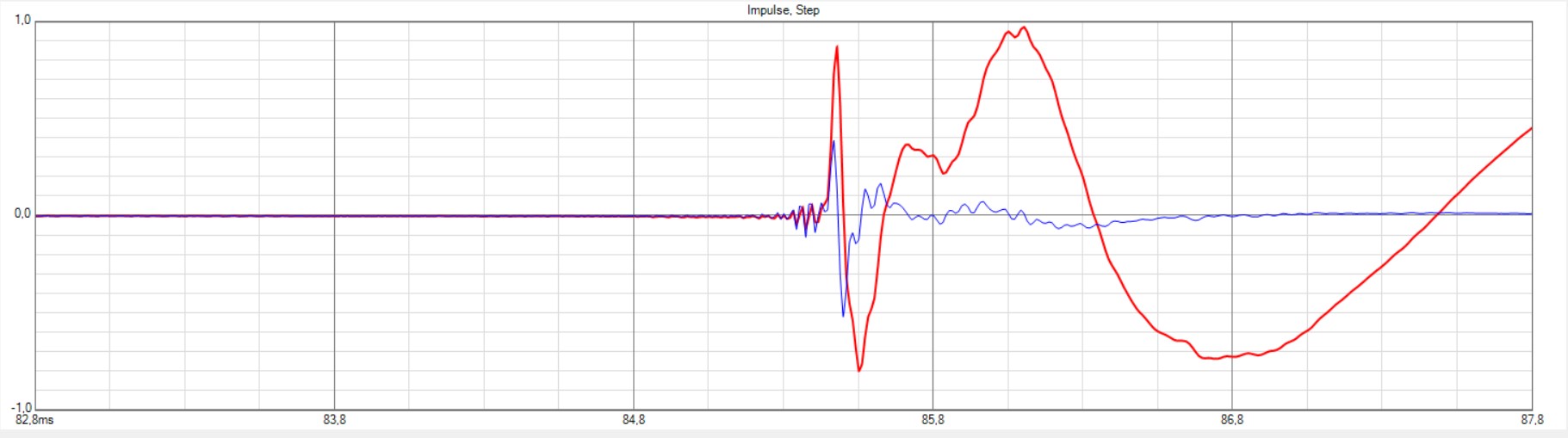

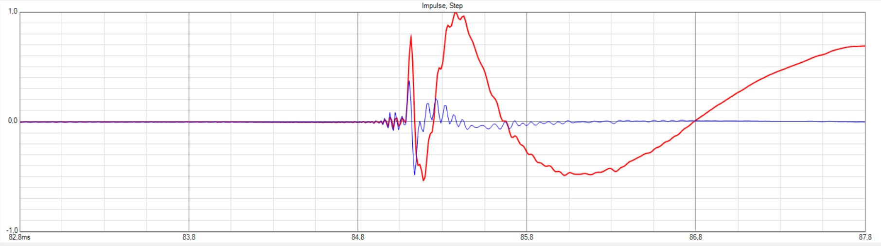

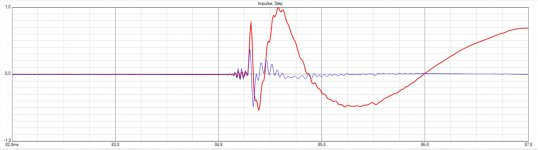

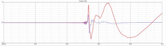

Visuals to aid. Here is step and impulse response of some of the previous examples I posted. The first is from the simulated listening spot, ~90cm tweeter and ear height sitting down 3 meters away. The second one is otherwise exactly the same system but the simulator coordinates are tweaked to show response if standing up at listening position, 90cm above the tweeter axis 3 meters away. Third and fourth are the respective six-packs showing the other responses for reference.

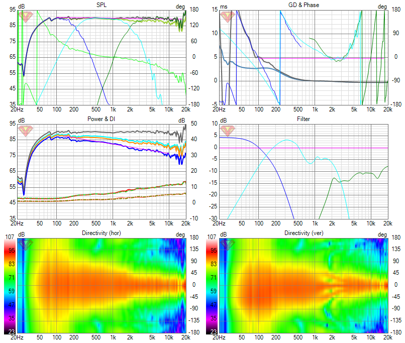

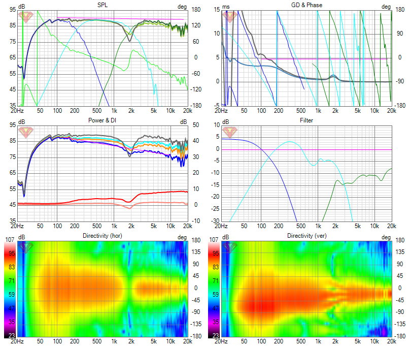

Either "position" could be made perfect with changing the crossovers, relative delays, EQ and linearizing the phase with FIR but not both because the drivers are at separate physical locations. On a coaxial (constant directivity) system both would be more similar to start with. Of course the room would affect in any of these cases etc., the main point here is to illustrate the transient performance depends on where you are at and the response can be tweaked to be better at that position. Only thing one has to care about is the frequency response / phase, and the transients are as good as they are. It would be really difficult to EQ a system looking at the impulse/step response, luckily it can be done by looking at the frequency response and phase!
Edit added GIF of the impulses aligned. There is time of flight difference as well as difference in the shape.

Thought experiment continued: Why a coaxial system would sound better given that a coaxial and the non-coincident system both could be tuned for same response at a particular spot? Reasoning from the examples there would be at least two reasons it would. Other is effect of the room in a far field listening situation and the other is sensitivity to the sweet spot in near field listening situation, head moves on the vertical plane relatively much.
In a far field listening situation the room sound (power response) would dominate over direct sound and could be more uniform with a coaxial system but earlier simulated demonstration showed this could be achieved with some non-coincident systems as well. There should not be much difference between the two with far field listening and minimized effect of the room so a coaxial system would not benefit much or at all. Near field I think coaxial could possibly always win, more stable sound, directivity further off-axis doesn't matter too much.
