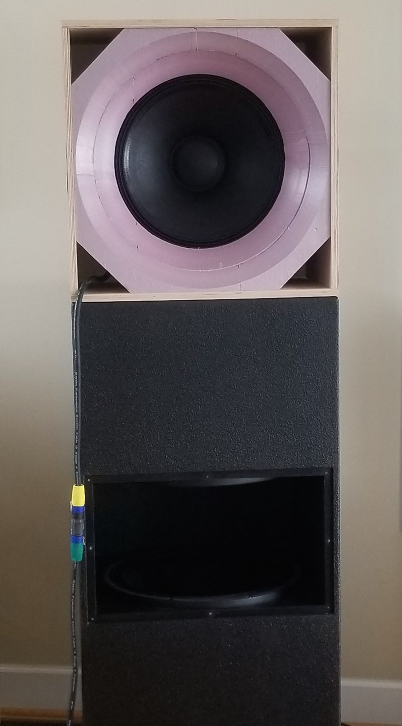

Here's a 15" B&C coax i made with the same idea, 4 reflex ports in corners.
The foamboard horn ring was about trying to get some extra horn umph.....
.....horn ring didn't work and i got rid of it in favor of a flat baffle.
And then painted and put a screen grill on the box, to go with a pair of 18fh500 reflex subs. Stuck it all up in dock rafters for party by the water. 😀

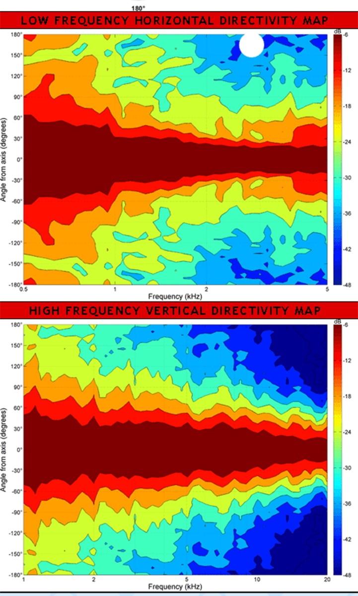

This polar is pretty much like the polars of some Horns and waveguides I've seen. The mass missing in the center helps keep the cone light. Comparing this to a compression driver +waveguide/horn crossed to a 15" woofer.... If one could get the coaxial as smooth as +/- 2db or so...who does the Coaxial seem to be "missing" something. The tweeter is a waveguided compression driver. 108db sensitivity for the tweeter and 100db sensitivity.....I'm guessing almost identical situation for the common 15" woofer + waveguided compression driver situation....

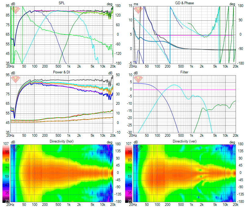

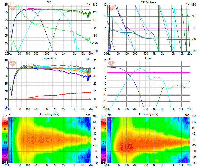

The big challenge for me in optimizing this particular coax has been to find the acoustic centers of the drivers. FIR has been absolutely essential in taming this particular beast but having done that you will have a driver that images really well.

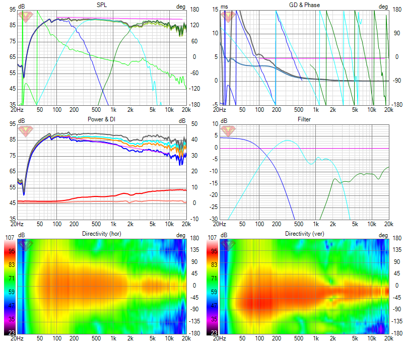

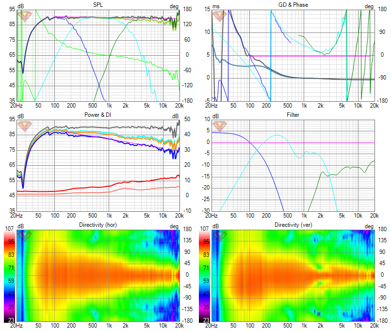

(semi) Dual channel measurement would have the relative time difference included. Check out VituixCAD and its documents for easy future projects 😉
For some circumstances there wouldn't be too much difference between coaxial and separate devices, at least it looks like so with a quick simulator test. Attached is a GIF showing real system (simulation based on measured data) and a what if situation where the waveguide is brought coincident to the mid range in the simulator. Not much difference on the design "plane". Based on the mild difference on the DI and early reflections DI I'd say at least some non coincident systems can approximate sound of a coincident system pretty well at listening position including the effects of the room. If the listening height varies the sound would be different for a coincident and non coincident, but for planned listening position there really is not much difference which to use. I'd use the non coincident if it allows better set of compromises on the woofer and on the waveguide.
The DI and early reflections DI are remarkably similar. The c-c here is crazy 1.8wl, ~30cm at ~2kHz. Anything less the difference is far greater around xo, until ~< 1/3wl they start to look like the coincident case again.
Anyway, just an example that in some cases both should sound equally fine. I haven't yet tested if the holes near vertical 0 axis are audible in far field at living room conditions. The in room response (orange trace) says not much difference especially if the xo region was EQ:d a bit which we could very well do since the DI is very similar on both.
For completeness sake here is GIF of the same situation but inspection point is 90cm above tweeter height approximating stand up listening position instead of sitting down on axis. Now the ear is smack dap in the dip and the difference between non-coincident to coincident is apparent.
A mere "BBC dip" so the sound is actually better!?😀 looking at the phase and group delay there should be some weird phasey sound at the xo, unless the early reflections mask it. Simulations are interesting.
Here is normal c-c spacing, as close as possible which is in this case ~1wl. No GIF this time, would have to make two 🙂 The stand up listening position doesn't have as bad dip in the response since the main lobe is wider and the head doesn't quite end up at a vertical null. But at the same time the vertical early reflections have more difference to the coincident case than in the previous example. Visible even without the overlay like in the previous images since I forgot to add it, sorry.
Anyway, these demonstrations are at core of the compromise. It is possible to approximate response of a coincident system with non-coincident system but the listening spot gets ever smaller where this is achieved. Expense is worse response outside the listening spot. However we are able to use two separate device optimized for their own (woofer and horn) and achieve that much better sound for the intended listening spot (plane). What ever that better is. Remember to use the best there is to better a coaxial system! One should remember what the listening situation would be to be able to select the most suitable system. I suspect all of the examples would sound equally fine at home for "critical listening" at the sofa and for background music during the chores. If I had time to stand around the listening spot doing nothing then there would be perhaps easily spotted differences.

I’m using VCAD, and I was talking about the acoustical center in the Z plane.
This is the tricky bit to determine for the exact frequency of the crossover since it seems to
shift with frequency and does not adhere to the physical properties of the driver.
Isn't it all in the data? if you do measure both without moving the mic or DUT, the baffle as reference plane/rotating axis, the phase information all should be there in the impulse responses.
Convert the measured impulse responses to frequency responses using same windowing. Using VCAD IR to FR tool this would be done using the on-axis measurement of the tweeter to find suitable window. Set the window start a bit before the peak so that the woofer peak that probably arrives earlier fits in the window as well. Now export the tweeter files. Then load in the woofer files but don't touch anything else, export them using same settings you just used with the tweeter. The Z coordinate would be left 0 in the driver settings if you do it like this because the Z information is now included in the measurement data.
I don't know what exact difference of acoustic centers would tell or why would you need to know it other than patching in the Z coordinate in case you lost the timing data in the measurements. Using calculated minimum phase (losing the measured phase) is not advised because it gets tricky and not as accurate.

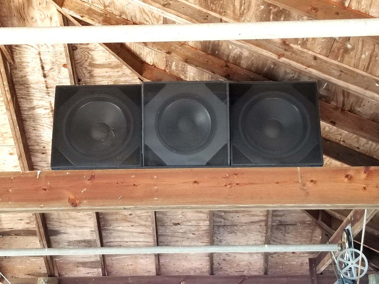

So it didn't become your main system.
"The foamboard horn ring was about trying to get some extra horn umph" "horn ring didn't work and i got rid of it in favor of a flat baffle" - It would seem that if waveguides were as effective as horns, that you would of been successful here. I think effects of sensitivity is the missing factor you describe as "umph" What did you conclude on the source of the lack of "umph"???.....
I was trying to copy what DSL does with their SM-80, a very popular box used for small to medium live-sound and DJ gigs. It uses a 12" B&C coax mounted in a molded horn.
When i showed them what i had built and was attempting, I was told it even took them a few tries to get their molding working right.
As I had already seen the coax wasn't going to meet my accustomed level of SQ, I just ditched continuing the horn effort.
All that said, it sounds great down on the dock 🙂
(Btw, the 18FH500's make for really nice single 18" subs...)
