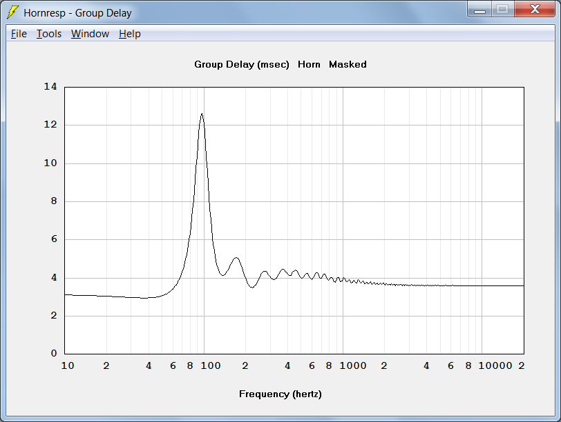

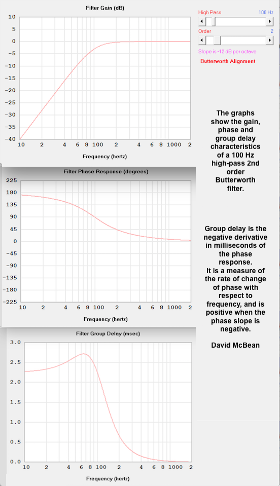

David,The attachments show the gain, phase and group delay characteristics of a 100 Hz high-pass 2nd order Butterworth filter.
Group delay is the negative derivative in milliseconds of the phase response. It is a measure of the rate of change of phase with respect to frequency, and is positive when the phase slope is negative.

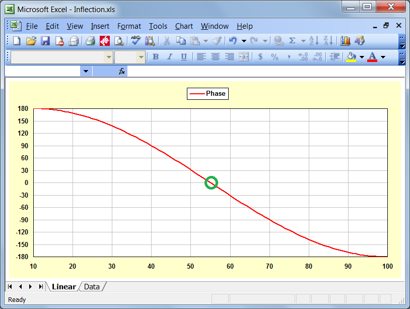

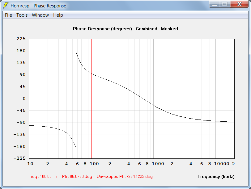

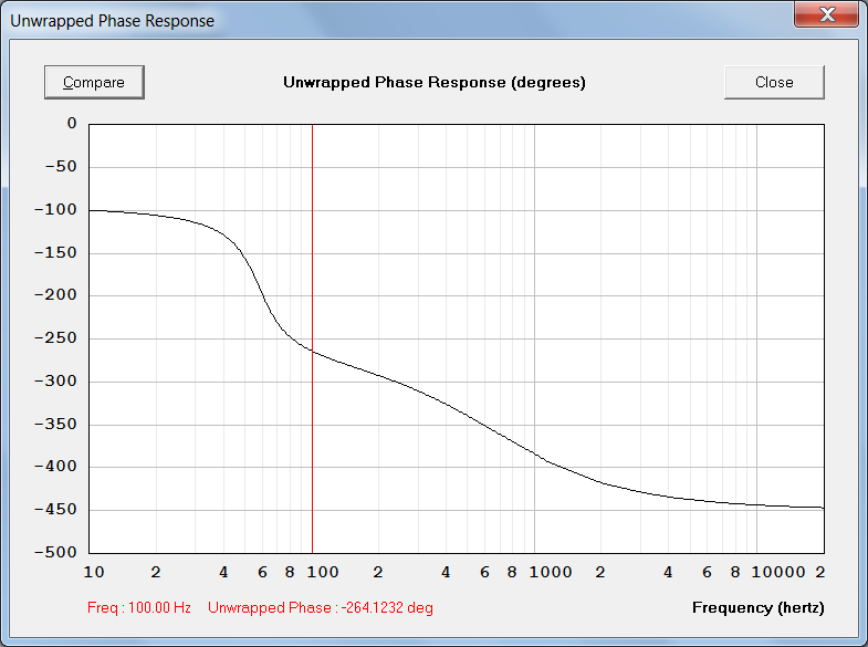

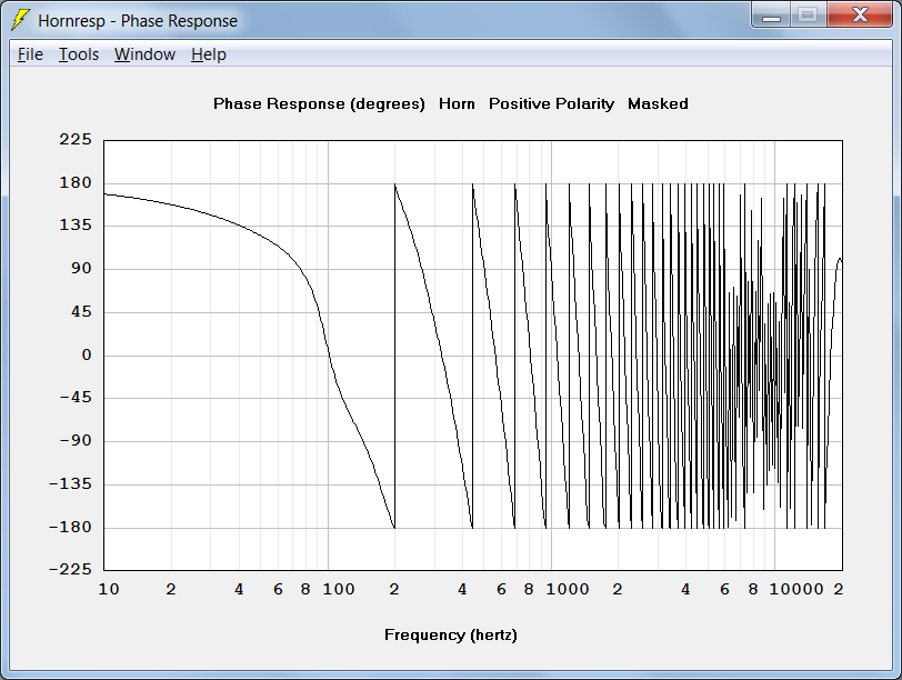

Phase wrap is just a compact way of displaying information. Once it is understood that it is NOT a 360 degree jump, confusion falls away, and the graph is clear.
The first attachment shows a phase response wrapped between +/- 180 degrees. The second attachment shows the same phase response unwrapped.

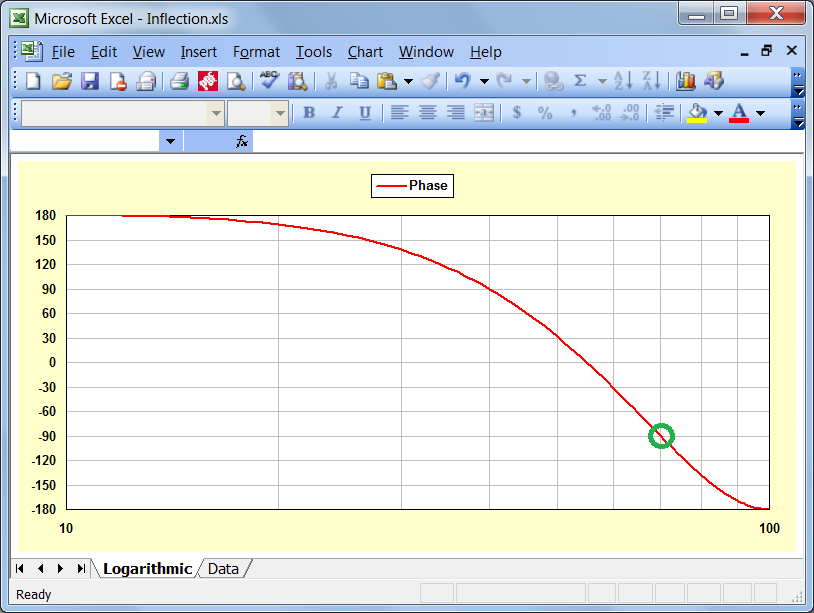

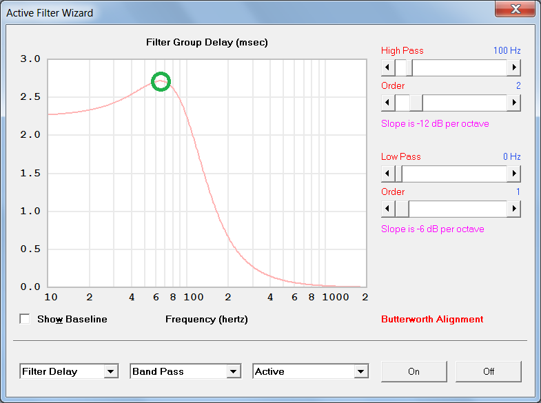

note that the logarithmic frequency scale will make even a perfectly linear phase response look bended
It is useful to keep the above in mind when comparing phase and group delay charts having logarithmic frequency scales.
In the charts I posted earlier, the inflection point in the phase response appears to be at 100 Hz (see Attachment 1) whereas in the group delay chart it is calculated to be at 65 Hz (see Attachment 2). If the phase response was plotted using a linear rather than logarithmic frequency scale, then the phase inflection point would indeed be at 65 Hz, as identified and correctly shown in the group delay chart.
The example given in Attachments 3 and 4 shows how the phase response inflection point can appear to shift from its true frequency of 55 Hz to 70 Hz, when plotted using a logarithmic rather than a linear frequency scale. Note however, that even though the curve shape has changed and the inflection point has appeared to move, the phase values as plotted with respect to frequency nevertheless remain correct.

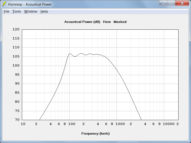

it would be of interest to also show the comparative phase and group delay of a horn/driver that rolls off at 12dB per octave below 100 Hz.

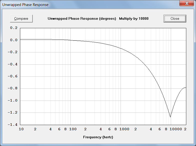

Hi Art,
Example attached.
The unwrapped phase chart is correct up to 10 KHz. Above this frequency, the sampling rate is such that the phase unwrapping algorithm cannot identify individual wraps.
Kind regards,
David

Thanks.
Was not expecting the thousand+ degrees of phase rotation in the pass band, also appears that horn rolls off closer to 24dB per octave than 12.
If I recall correctly, applying a delay equal to the path length of the horn (or path length + one meter?) flattens the simulation's phase response over the flat amplitude region of the horn.

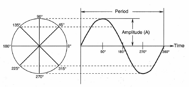

Or in layman's terms as this topic seems to keep going around in circles🙂 wish me luck...
If it takes 1 Second (1000ms) to complete one full cycle (1Hz), to complete a quarter of a cycle would take a quarter of a second / 250ms.
A quarter of a turn is 90 degrees - 360/4 = 90.
If it takes 1/10th of a second (100ms) to complete one full cycle (10Hz), to complete a quarter of a cycle would take a quarter of a second / 25ms.
So
90 phase @ 1Hz = 250ms
90 phase @ 10Hz = 25ms
180 phase @ 1Hz = 500ms
180 phase @ 10Hz = 50ms
etc
so 90 degree phase lag at 10Hz would be equivalent to 25ms of group delay (GD)
etc etc etc.
