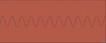

Remember the signal being sent is (should be) perfect in amplitude...showing no variance from peak to trough...I've been in sound design long enough to know that for lack of a better phrase....**** happens....and you get stuff in your signal upstream/downstream that could be missed (windows os audio, software programming, etc etc) but we are operating on the premise that we can trust our eyes at this point.

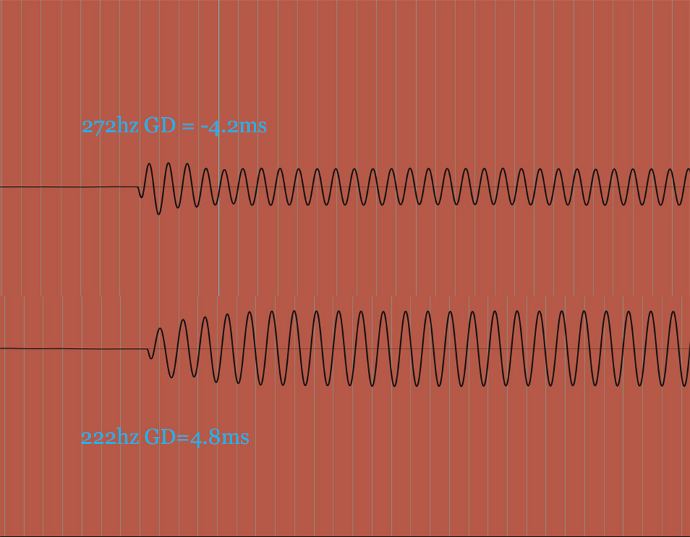

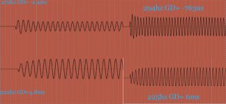

I am using REW for tone burst, my measuring mic, and Ableton for recording...
I do not visually sample the initial tone burst but several burst in I'll grab a visual.
attachment.php
Here we see the same type of trend in the signals attack characteristics as with the horn, but pressure does not correlate as closely. I would have to normalize some things to see for sure. Either way, group delay seems to have the same trend on the initial signal
The visuals in the previous thread were of the Axi on the 350hz horn....
The visuals in this post are of a 4" vented midrange. Vent tuning is at 70hz iirc

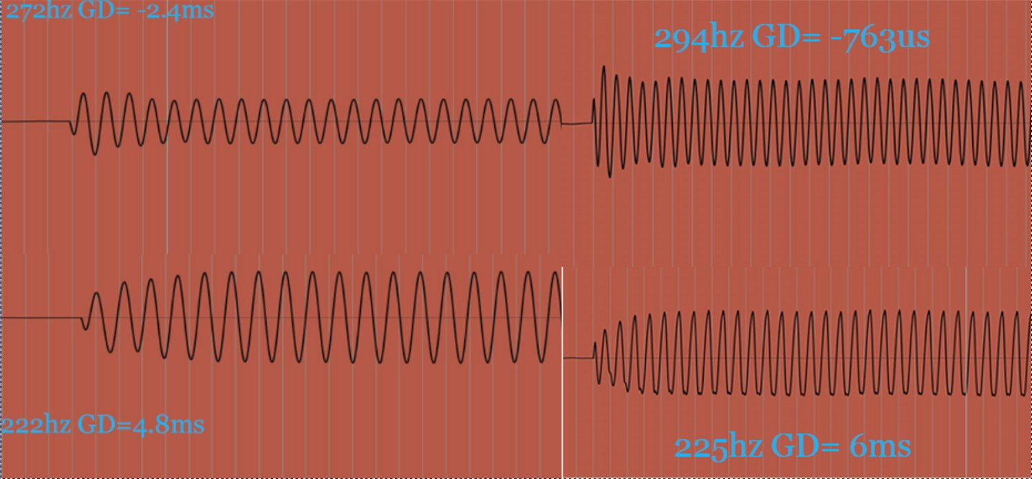

The measurements I've shown investigating GD are interesting. I don't know what track you think I'm on. I see trends....and the trend is showing compression on the amplitude of the beginning of the signal where ever group delay is in excess. The areas where group delay or the on the opposite of the spectrum, Amplitude is overshooting at the beginning of signal.
Not my opinion, just what the data is showing.
(GD on the 272hz example above should be -2.42ms)

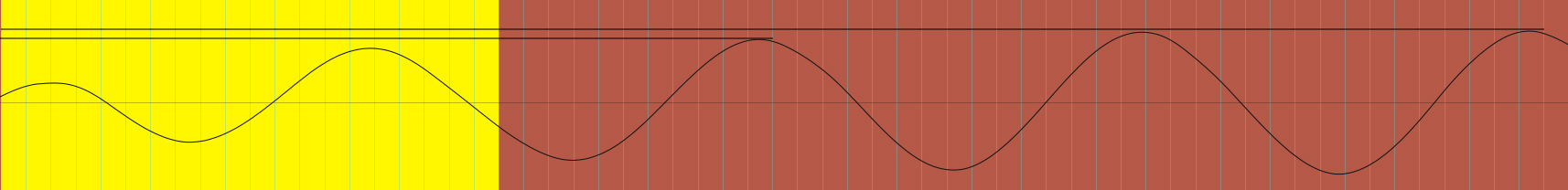

My argument; Group Delay has a connection to time to peak energy, and results in a distortion of amplitude vs time at the beginning of the signal. Perfect phase is 0 and likely perfect Group Delay is 0 as well.

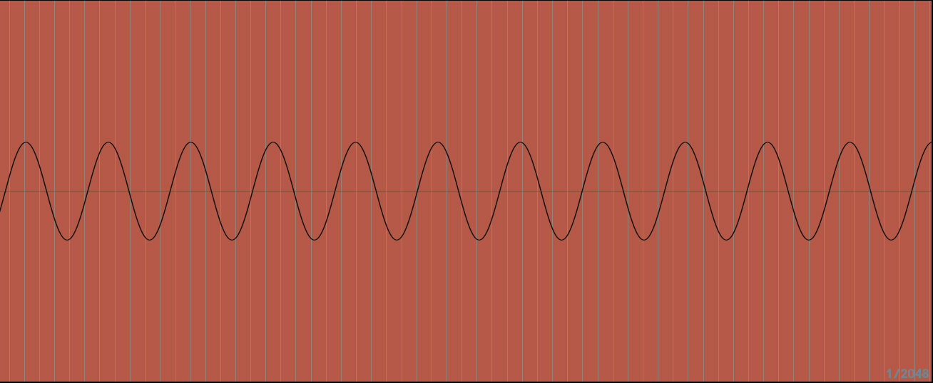

The signal used to supply the above recording had no deviation in amplitude.

Horn left and dynamic driver on the right, I still have a trend going, regarding GD times and amplitude vs time at the beginning of the wave.
So lets put it this way, whats the connection? If this isn't GD....what do we call it what causes it and why does it seem to follow GD....but more importantly.....what do we call it!

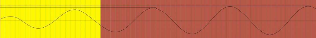

Propagation delay?....I think you said this once before. My point is that I am only wanting debate the issue of the amplitude vs time and nothing to do with phase.
As long as this aspect of amplitude vs time is supposed to be included in what you said about GD above... then we are on the same page I think.

What I think that you are talking about is the startup transient in the pulse - the part of the system response that decays with time. Followed by the steady-state response (whose definition is self explanatory.) Yes an excess group delay would after this. Does it mean anything? Honestly I don't understand what you are trying to say.
So we are calling it "start up transient".... The start up transient, matters...thats what I am saying.
The start up transient appears to follow along with Group delay....A longer group delay results in a longer start up transient is what I think happens.
A long enough Start up transient will change the way something sounds in the terms of texture at the beginning of the event.

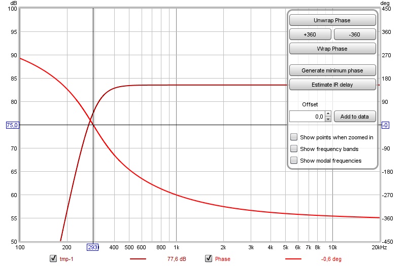

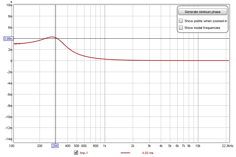

Simple example from rephase and REW, perfect Dirac pulse with LR48 crossover, frequency and phase:
attachment.php
Group delay:
attachment.php
Do you see anything familiar? Your horn shows a rapid roll off at the frequency where you measure maximum group delay. Just show the frequency plot along with it, there's nothing special about the group delay plot, other than being another plot derived from the impulse.

You are trying to relate frequency domain concepts - like GD, which is derived from the frequency curve - with time domain effects that you can see. Good luck with that as this can be very hard to do. That's why most of us prefer the frequency domain. But make no mistake everything in each domain is reflected somehow in the other - impulse response => frequency response and visa versa. So what you are trying to figure out probable can be done, but not easily, hence unless you do it, which I think that you have admitted you can't.
