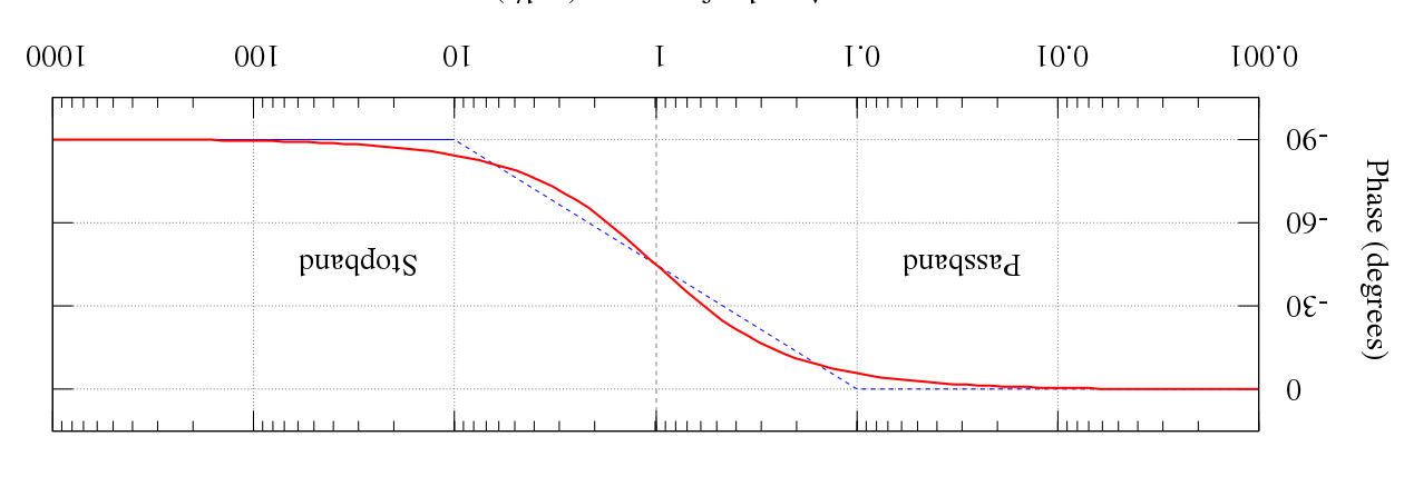

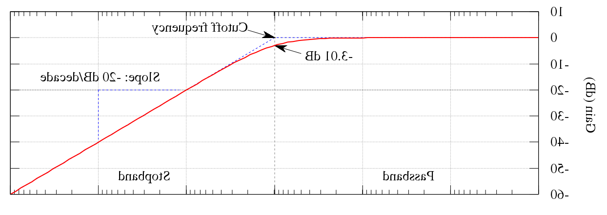

Good point, these were some images I could quickly find to try and save a few thousand words, good images for high passes eluded me, I tried flipping them in Paint but it seemed more confusing 🙂Just want to mention that those figure are for a LP filter and would be reversed for a HP. But thanks.

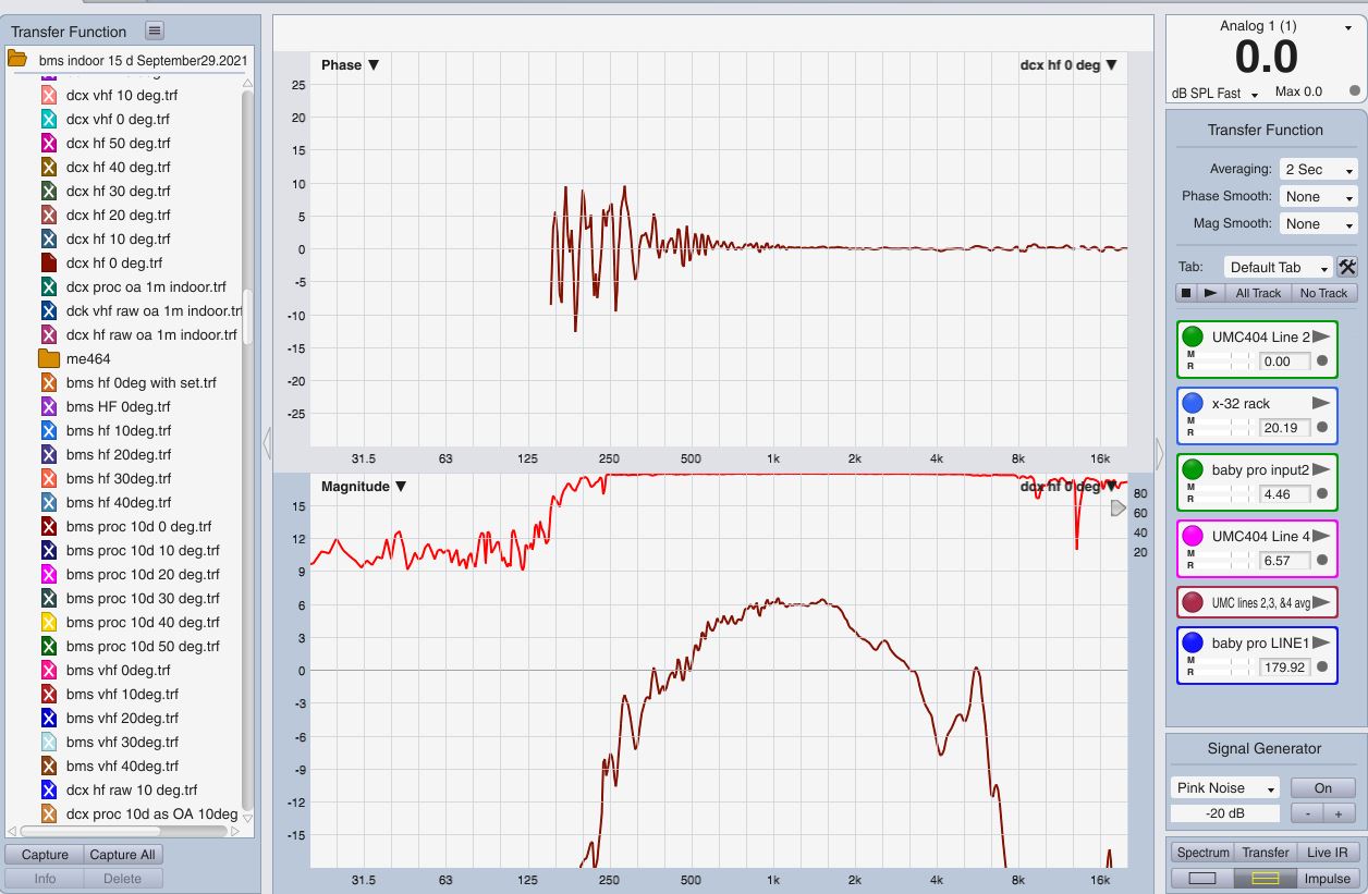

Here's dcx464/me464 lower section raw on-ax.
"Phase" graph is group delay. Someday the Smaart guys will fix the label when toggling from phase.

How far away was the mic for this measurement?
Can you re-post that pic without the SMOOTHING So we can see the RAW response
You spoke of the "bigger picture".... I think you would like to visit burst decay and avoid the same area where GD gets too high, which is also the area with excess decay

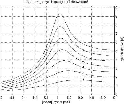

Fluid
Unfortunately your pictures do only tell the truth when it comes to amplitude- and phase- response.
The group delay has the same lowpass-like shape for the high- and lowpass. This is because group delay is defined as the negative derivative of the phase response. And the phase response of high- and lowpass filters have the same kind of shape that is falling with rising frequency and asymptotally reaching a finite value at zero Hz and infinity. With the only difference that the phase response of a lowpass is zero at zero Hz and -90 degrees per order for frequencies approaching infinity while the highpass has +90 degrees of phase shift per order towards zero Hz falling towards zero at infinity.
If the group delay of a high pass was like the one you showed then the design of multiway speakers with simple analog crossovers that can reproduce square waves would be a walk in the park.

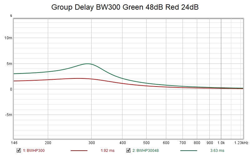

I thought the connection to time to peak energy, was exactly that...
The point in time when the peak energy is leaving your speaker is not determined by the group-delay alone but also by the spectral content of the input test signal.
When you have a peaking group-delay but no content in the frequency range of the peak then that GD peak is meaningless for the outcome.
Same for group delay rising towards lower frequency. A speaker with a very low cutoff frequency will have higher group delay around its cutoff than one with a higher cutoff frequency. But the one with the lower cutoff frequency will most likely have less group-delay in the lower midrange.

Yes that was the point I was trying to make when I said they they were confusing when flipped. I should have left the flipped group delay out. I have been able to make my own graph now to show the high pass group delay correctly for a BW filter of 24 and 48dB to make it easier to see the group delay peaks. The main point being that group delay peaks around the cutoff -3dB point of a filter.Fluid

This is a measurement taken in the real-time two-channel mode of Smaart, using the default MTW frequency-dependent window, right?
Hi, correct.
My poor man's anechoic is outdoors, albeit in a noisy environment. Real-time temporal average of music with some background pink thrown in, let's me make non-annoying measurements, compared to averaging a bunch or IR sweeps.
Unfortunately, I don’t personally class that as a very accurate measurement procedure for the characterisation of absolute phase and by proxy, group delay. It is very easy, but Smaart in real-time mode can make speakers look much better than they really are. That's a side effect of the software's focus on getting 'actionable data' for alignment of multiple speakers at events. 1/6th octave smoothing doesn't help either!
I use Smaart to easily capture as you say, 'actionable data'.
If i've wanted to dig further, i normally go to REW or ARTA.
What do you use to capture 'absolute' phase?
I've heard TEF can, but have no experience with it or anything other than what I've mentioned.
As you know, unsmoothed data is what's captured. I probably made a mistake posting the group delay with 1/6 octave smoothing, but knowing the over-theorizing going on in this thread, that was what i was trying to avoid with a 'bigger picture' view.
At any rate, will repost with unsmoothed next.

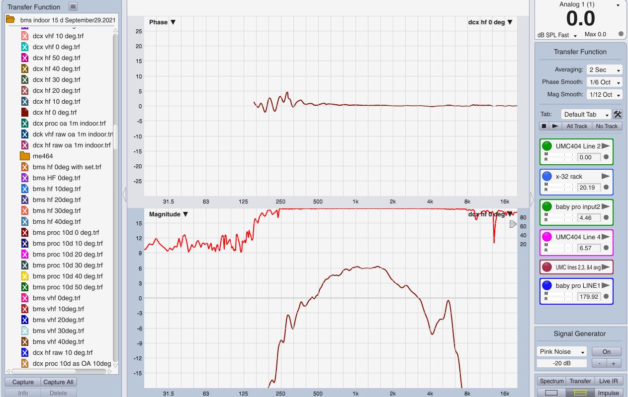

Hi camplo,
About 3m away.
Here's no smoothing.
And NO, i don't give a damn about burst decay, or area of excess decay, or etc etc.

Maybe you should should learn how to read and interpret the graphs you are asking for.

Dang it! I thought you'd know better than to include the room in the measurement. Basically a measurement at the mouth, vs 3m away...The cutoff is low enough to be within room interaction... wanted to see just horns response not horn plus room.
Haha...i always specify if it's an in-room measurement, to let reader beware.
Default is 3m outdoors, off my back deck which opens out to empty space nicely.
True enough, if you ever feel like the bother...a direct energy measurement can be taken without having to move your horn from its current location....just put the mic barely an inch away from the horn mouth, dead center and fire away =)
It gives you a clearer view of what your horn/driver is going.
Measurements for horns should be taken in far-field conditions. So should any speaker, really. Taking near field measurements is only appropriate when they are manually convolved with a majority of far-field data.
Group delay is also derived from phase data, which is influenced by relative distance, reflections and the like.
All of the ‘mic’ type ABEC/Akabak observation types default to a far-field determination which is then compensated to produce the response at the designated measurement point. So it calculates the response at 10 metres, then adjusts the gain via inverse distance law to give the response at 0.1 metres, if that’s where you set the point position.
There’s a good reason for that. It’s also why anechoic rooms are qualified via inverse distance traversal methods, plotting the deviation from theoretical results for different angles and positions of source and receiver.
A good rule of thumb is to measure at 3 or 4x the diagonal distance of the baffle for the device under test.
