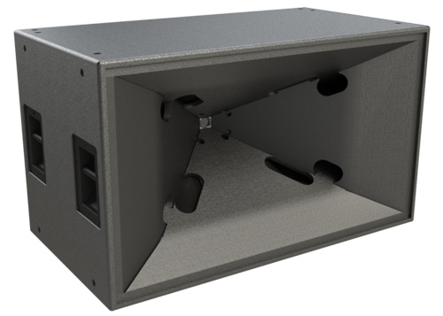

The baffle design gets me here
All from a Single Acoustical Axis within a Single channel of woofers.

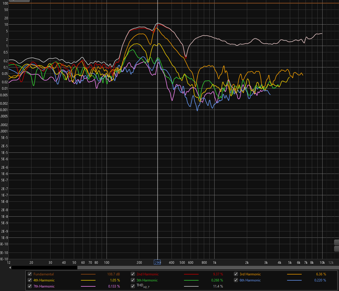

I have shown the THD without the horn, taken with the voltage needed for headroom, with the mic as close as possible to the exit before clipping. This is the most intimate way to check THD as a horn skews the results.
However "intimate", measurement without the horn you chose is virtually useless.

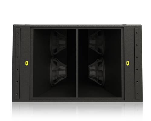

I've heard no velocity related complaints regarding the cone drivers in DSL's multiple entrant horn designs.

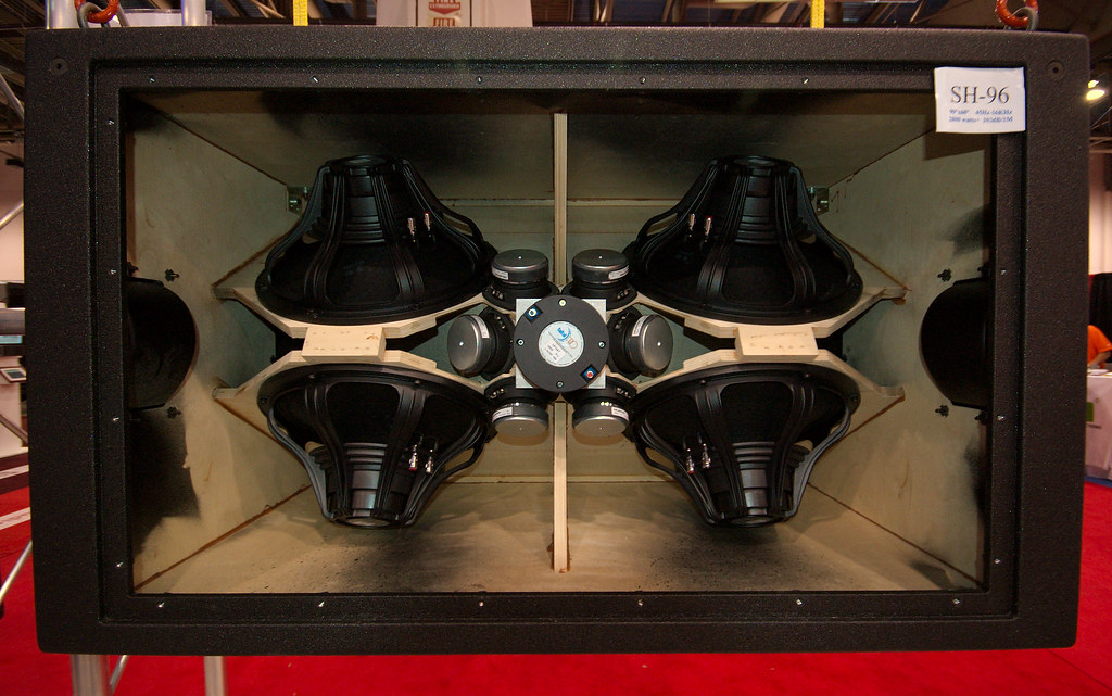

The SH 96 uses six four inch cone drivers for midrange, around 12 times the displacement of your AXI2050 diaphragm.
The active low/mid crossover SH96HO (high output) raw response allows an acoustic crossover as low as ~300Hz, although with around a -6dB dip in that range in the passive crossover 3way SH96:

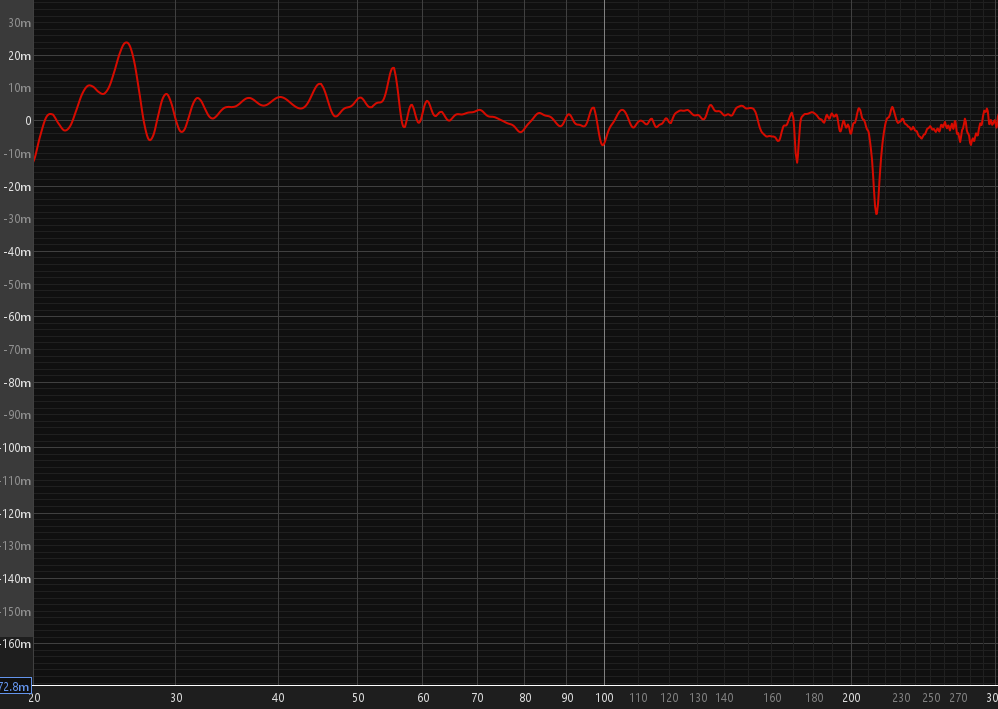

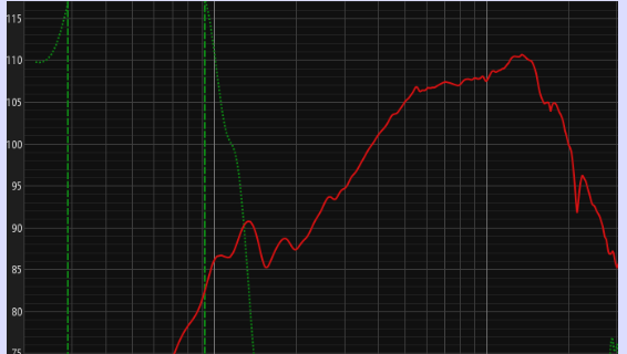

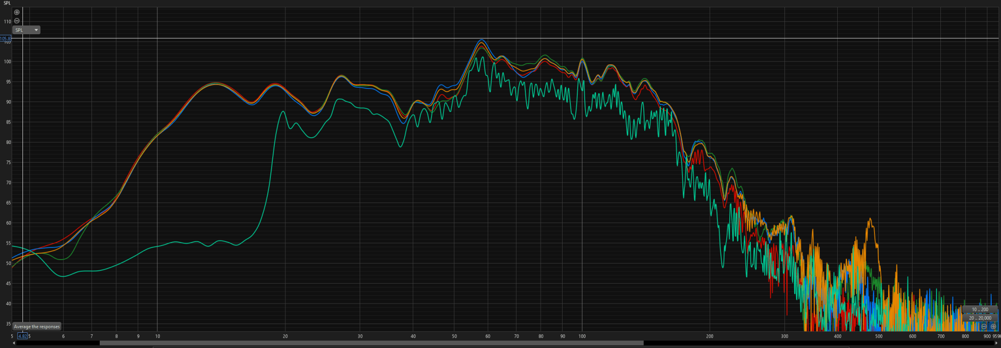

This is the first iteration of the PPSL with no filtering and floor carpet damping. There is no flaw in using EQ to flatten this response. The rising
There's no alot going on.
That said, the SH-96 doesn't require as much EQ as your slot, and it's mid/high section won't suffer the IM distortion of a single HF driver required to cover 200-20,000Hz as in your proposed system.

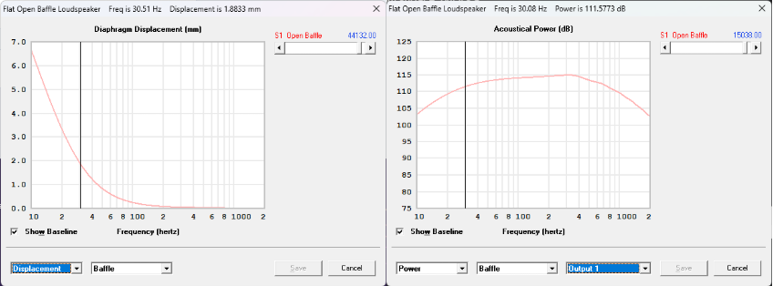

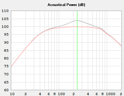

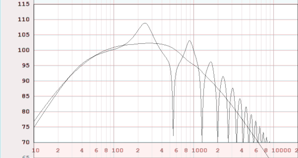

Here is a similar sized closed box superimposed over the slot sim. OK there's a resonant peak.. There's one Filter. Wow.... In comparison to the SH96, too which I am only considering the LF driver performance... I would be very surprised to hear that there is no filtering to remove the Resonance that is created by every offset horn I have ever seen. Even if the peak was nulled by a low pass filter, it still has a response similar to mine and any other offset horn of similar fashion. In other words, Tom Danely "fixed it" with EQ, Just like I will and there is no Harm in doing so. My slot proposedly will make it can be crossed high but with one channel of woofers, instead of 2. "That said, the SH-96 doesn't require as much EQ as your slot" How much eq do I need? I judge EQ amounts by filter count, not by how much the boost or cut. How many filters are used in the SH96???? The distance from the LF source to the beginning of the line is pretty large... and I'm too familiar.... that means there is a Peak in the FR of the sh96[HO] and it must be Eq'd out.

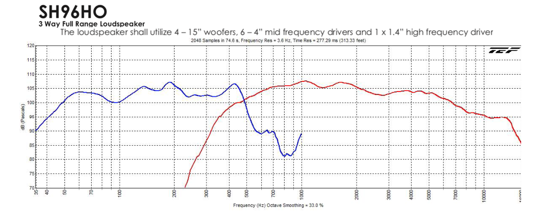

The loudspeaker shall have an operating rage of +/- 3 dB 45 Hz – 13.5 kHz."... 4 15"s that are only anticipated to reach 45hz could be a tell of the consequences of restricting air flow. No reason why this thing shouldn't make it to 20hz.
Because it is rated at 133db continuous, 139db spl max. Having a avg. sens of ca 103db. Using 4x Faitfal FHxxx.
Meaning it must sustain those levels reliably and continiously, over many years in any 'normal' condition.
If it is used in 50 celsisus summer conditions, compared to your 25 c living room it needs that much extra thermal capacity. Also at any altitude from 0 -4000m.
The LF drivers excursion capabilities needs to keep up the 36db of headroom at 45hz, without over-excursion or thermal issues over a long time.
A commercial product like that needs a slight safety margin, else the road is short to warranty, replacement parts, lack of robustness and systems breaking down in use.
A different reality then our home systems.
The quoted range is 45-16khz -3db.
With the recommended 40hz, 24db/oct HP filter.

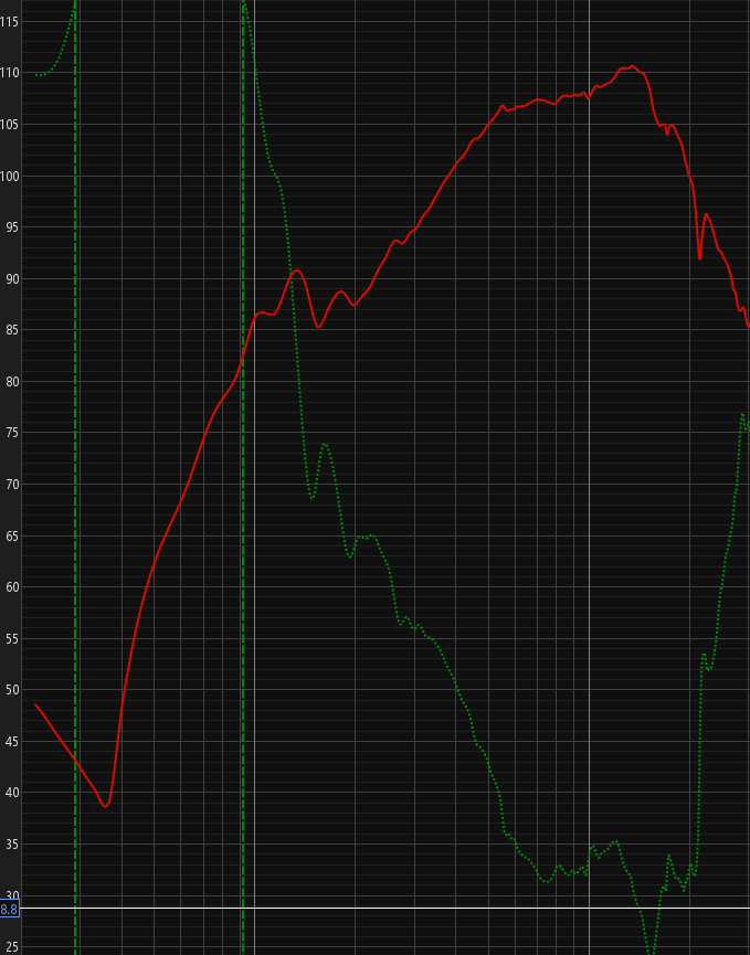

With no frequency indication, can's tell what pass band this is, but appears ~20dB deviation in the range you chose to post above the green line.
20 dB is a power range of 1/100, which is "a lot".

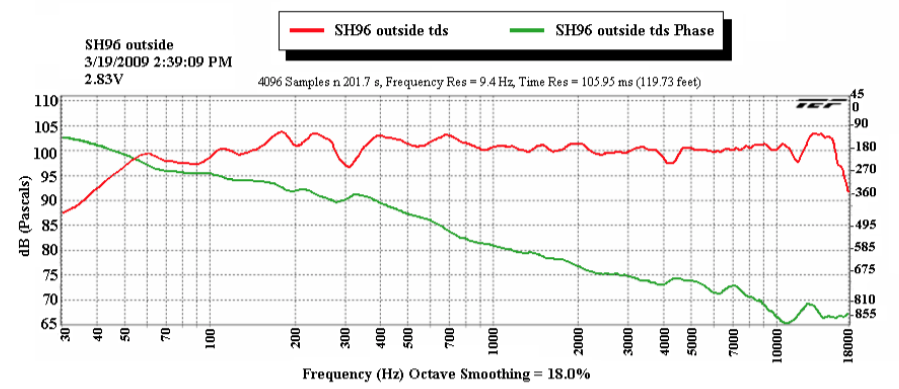

Surprise, the horn load bass reflex SH96(HO) raw response shows approximately +/-4dB over it's potential 50-500Hz pass band.
The SH96 uses a LP above it's pass band, EQ is optional.

No electrical filters the raw response.

"The loudspeaker shall have an operating rage of +/- 3 dB 45 Hz – 13.5 kHz."... 4 15"s that are only anticipated to reach 45hz could be a tell of the consequences of restricting air flow. No reason why this thing shouldn't make it to 20hz.
It's a bass reflex enclosure with an Fb ~45Hz as can be seen by the phase change at the low corner, the four bass reflex ports, and steep decline in frequency response below Fb.
No designer or user should expect useful output below Fb from a bass reflex.

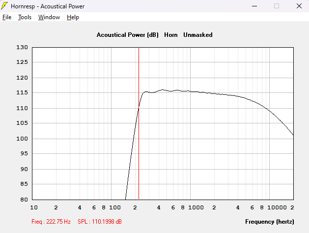

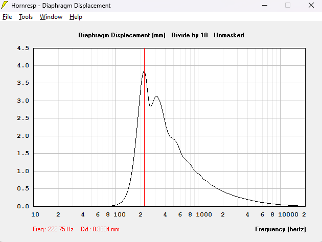

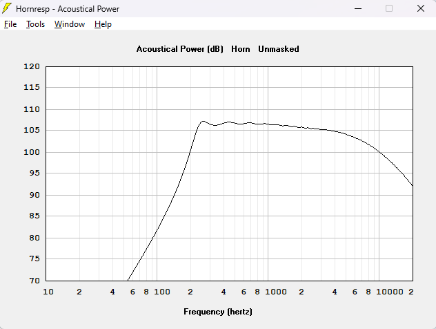

These sims are rough drafts of a Axi on a lesser efficient horn than what I have..... The Axi has linear excursion suposedly up to 1mm... when exactly does the IMD/THD problems kick in????
THe best thing I did for myself was to design for PSL goals using a single channel....
My horn has some flaws in the LF roll off than can be avoided by crossing at about 250hz.... WIth a better horn, one with a proper roll off... I see no excursion problems in simulation.
I think this is at 3volts... which is enough headroom for about 113db/1meter in stereo, with the 200hz XO. No signs of over excursion.
Can someone show me a simulation suggesting otherwise?

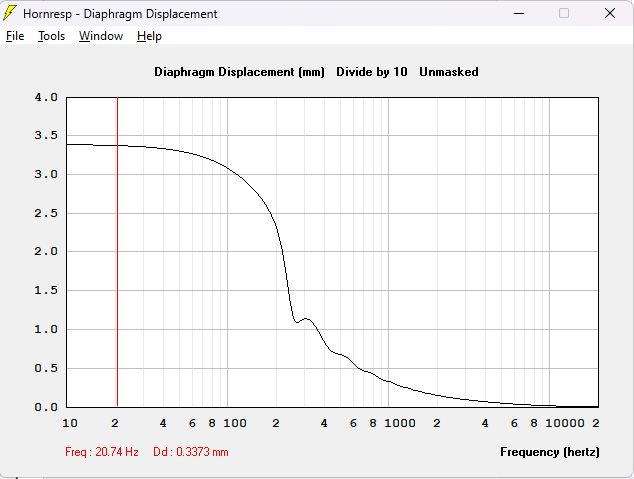

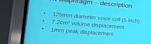

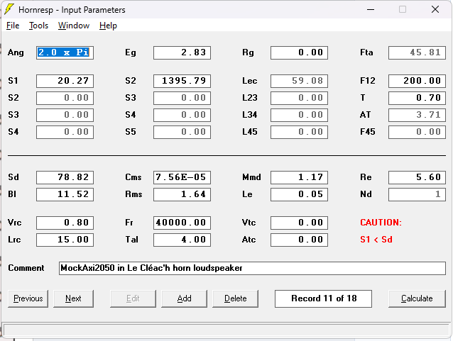

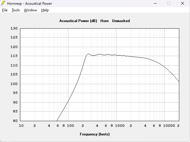

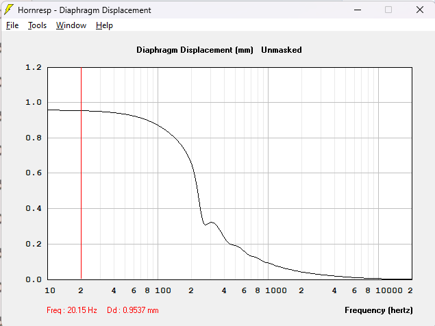

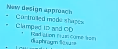

Dr Jack Oclee-Brown mentioned at about 55:38 in the video describing the Axi2050:
“We’ve got a 1mm gap between the front of the diaphragm and the phase plug at it’s widest point which comes down to almost nothing where it’s clamped”.
That means 1mm is Xmech/Xlim (not Xmax), and it's average displacement might be as little as half that when the diaphragm reaches the phase plug, if the suspension allows that much excursion.
He also mentions the displacement of the annular ring AXi2050 is about the equivalent to that of a 4” dome.
JBL engineering data specifies their large format compression drivers Xmax as 0.5mm, with a diaphragm to phase plug distance of 1mm.

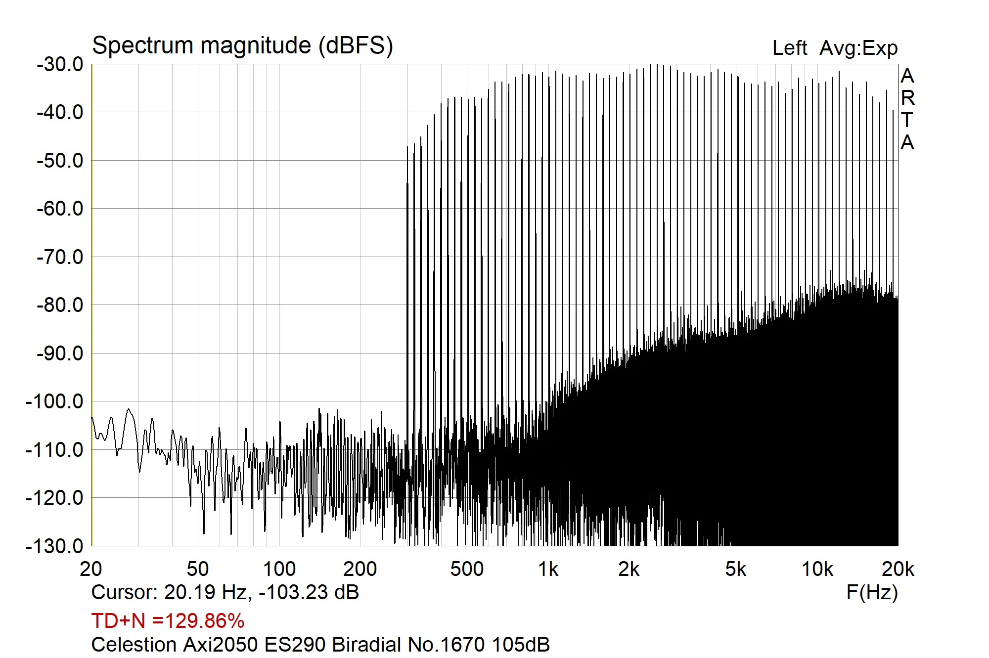

You "think" the graph was at 3volts, (around ~1 watt) and it shows 10% distortion, so the diaphragm has likely reached Xmax.
I recall you posting other measurements of your horn/driver combination reaching 100% distortion, obviously exceeding Xmax by a large margin.
I can't, but speculative simulations suggesting something other that what you have already measured with your unusual horn/driver combination does not seem useful.
This is my point about taking measurements of Thd without the horn. Looking at the measurements with no horn its obvious that those measurements showing crazy thd numbers were not accurate. Those 100% thd readings were very low level measurements buried far below cutoff. Taking off the horn isn't going to lower thd, but it allows the microphone to get close enough to bring the signal well above the noise floor.
In the Axi video the presenter says the Axi has 1mm of linear motion in either direction at 50:55

I will go through the motions again when I finish these dang boxes... the way I test is to play the highest frequency I can hear and then sweep the with another frequency through cut off. I don't recall every detail of my test but don't you think thats a good test?
Not knowing what your test is trying to measure, or what you are trying to hear, can't tell whether it is a good test.
What makes IMD objectionable is the inharmonic sum and difference frequencies are basically noise.
As an example, play a 250Hz (near or above Xmax) and an 1100Hz signal, and 850Hz, 1350, 1600, 1850, 2100Hz are all generated in addition to the second harmonics of 500 and 2200.
IMD is kind of like a distant weed blower revving up along to your music.

The center portion of the AXI 2050HF driver's flexing annular diaphragm can make contact with the phase plug (1mm peak displacement at Xmech or Xlim, the mechanical limit of excursion) while moving "in a linear way", as Dr Jack Oclee-Brown says.
