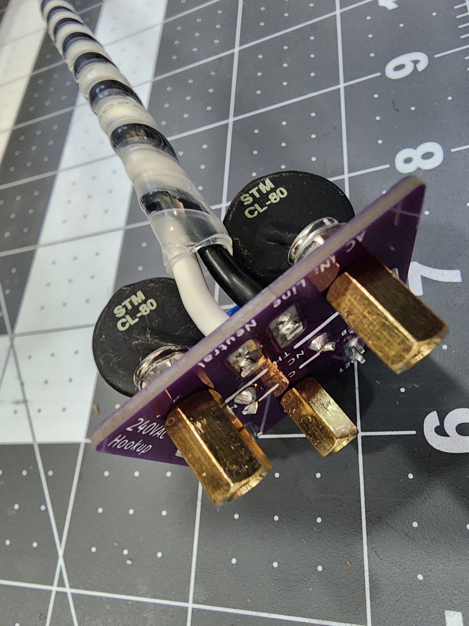

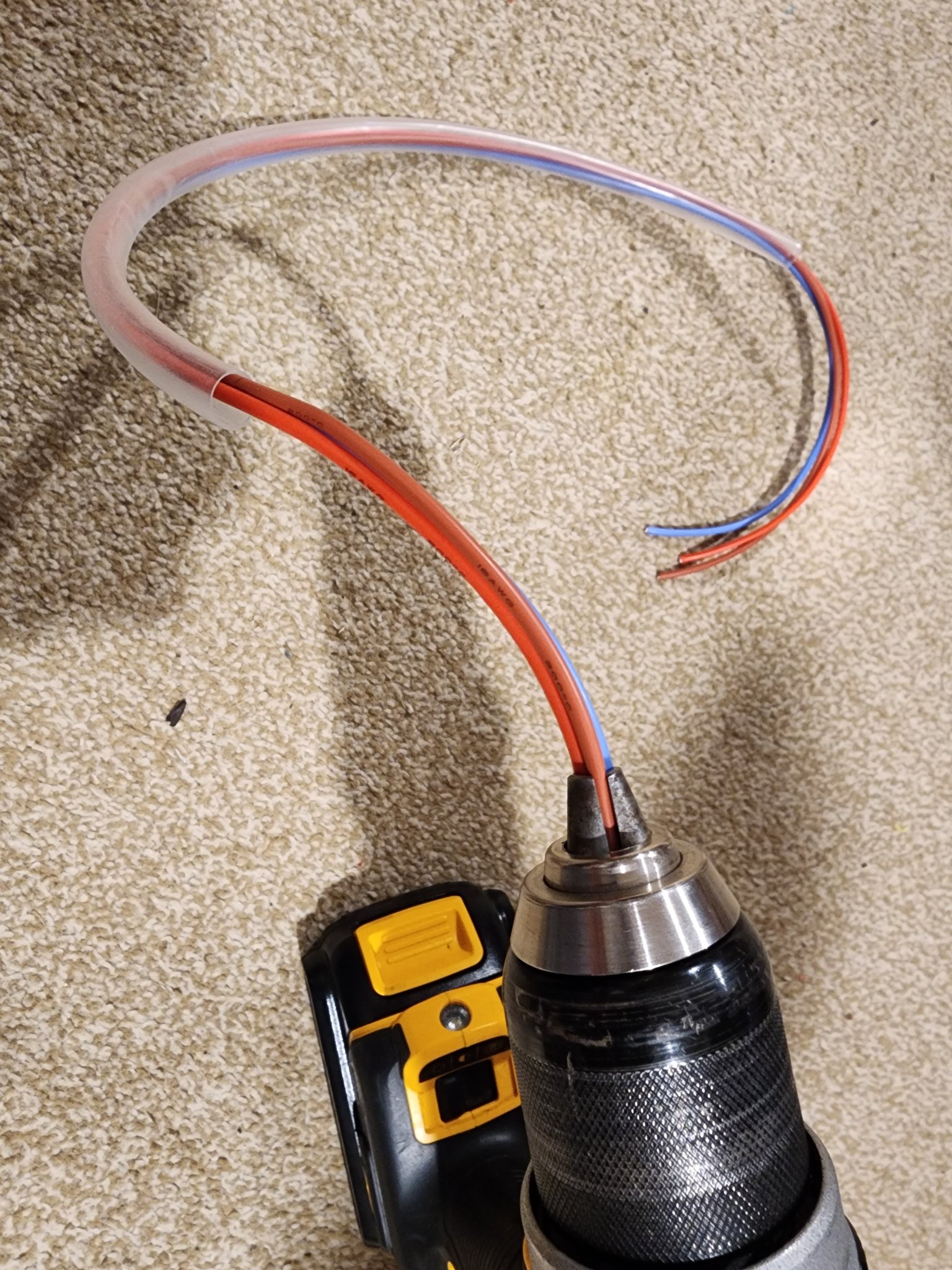

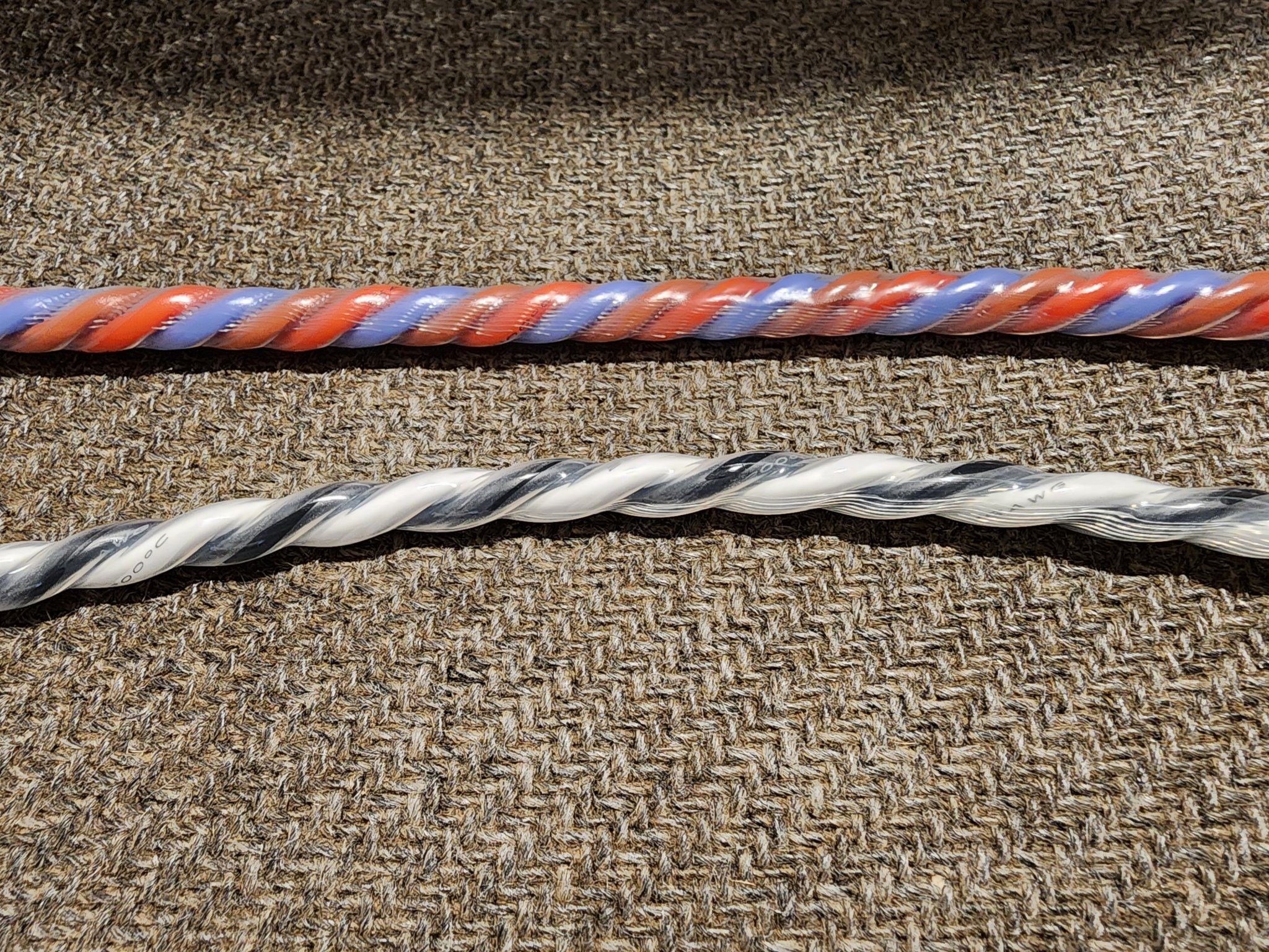

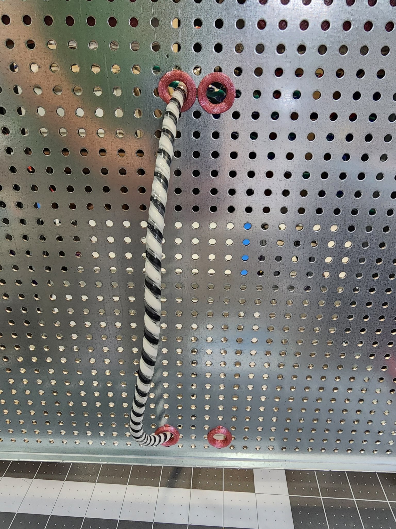

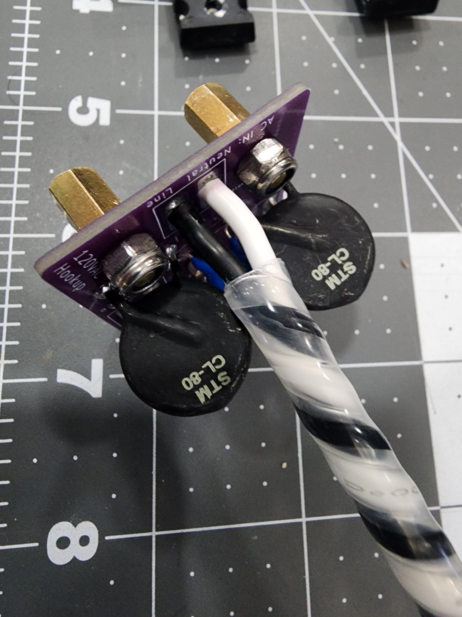

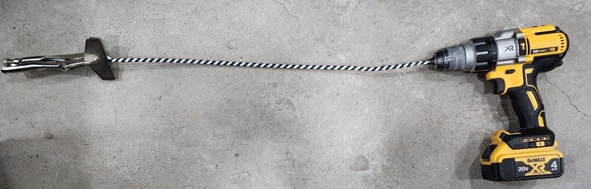

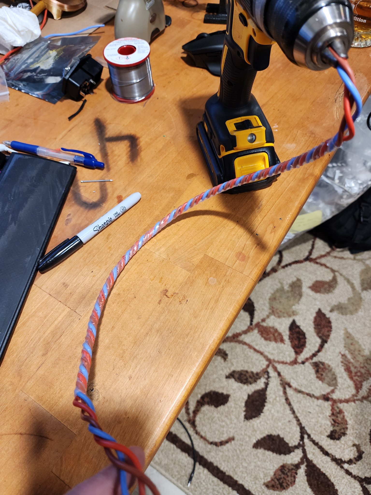

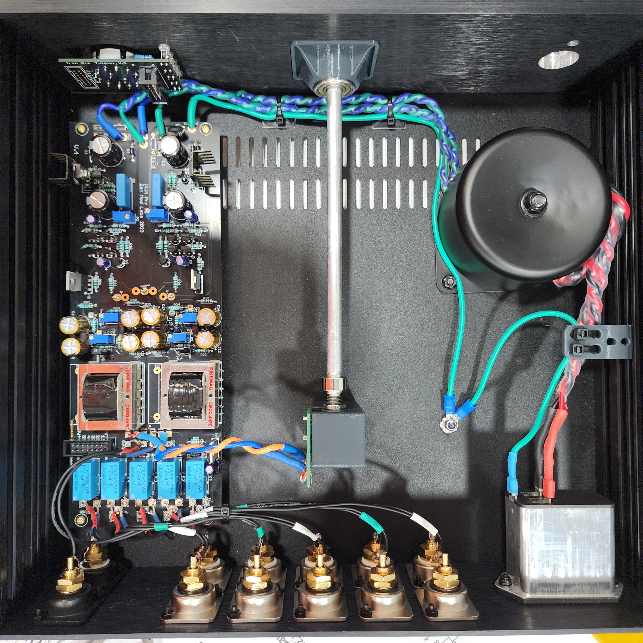

I'll say that twisting and heat shrinking to lock in a tight twist is likely mostly for "looks" and not for noise/EMI reduction. Not to discourage you from buying a good tool (Heat Gun) as I'm all for having good tools for the job, just saying it's more of a "nice to look at" thing in my mind than anything else. @rhthatcher was the inspiration for the power drill to twist wires and adding heat shrink to "lock" in the tight twist was the logical next step.
For anyone interested in doing that, I'll say it's extra work, but looks really nice and makes for tidy wiring. Here's my technique....
Step 1: Cut off more wire length than you need by say 25-30%. (2 wires, 3 wires, or even 4 wires if that's what you need).
Step 2: Slide the untwisted straight wires through some quality heat shrink (I've pulled the wires through if needed using a string if the length won't push through. Don't bother trying to "lube" up the wires with water, or oil in an attempt to make them push through a long length of heat shrink....tried that...not a good idea. The length of heat shrink should be 2/3 the length of the wires as they will of course get shorter once twisted and you don't want to stop twisting because you bumped into the heat shrink length.
Step 3: Clamp one end (or hold with fingers if you have strong grip strength) with a vice grip, or pliers, and chuck up the other ends into the drill.
Step 4: Run the drill slowly to twist the wires inside the heat shrink tube until it's all twisted up to your liking. If you go too fast with the drill, the heat shrink will catch on the wires and start to twist, which you don't want. The heat shrink diameter should be large enough that the wires twist freely inside the tube of heat shrink and the heat shrink remains as it's straight "tube form".
Step 5: While holding the twist with the drill and pliers (or fingers), use a heat gun to fully shrink the heat shrink around the wires. You'll need a third hand, use your feet, or a heat shrink gun that sits pointed up on its own.
Step 6: After the heat shrink is all shrunk, while still maintaining the twist by holding both ends to prevent "unwinding", run that now very hot heat shrinked wire combo under cold water in your sink (or perhaps dunk in a cold bowl of water?). Only after the heat shrink is back at room temperature (takes 30 seconds running under cold water) do you unchuck the wire and remove the vice grip. Now the wire maintains the twist permanently.
Step 7: Install wiring as needed. Cut to length and cut away excess heat shrink enough to allow you to solder to boards, or install ....dare I suggest Faston spades for those folks willing to risk ridicule from Zen Mod 🙂
Cheers, you got some nice looking wiring you can route and zip tie as needed.
Reference: I use 3:1 marine grade heat shrink in 1/4" for 2x 16ga wires, 5/16" for 3x 16ga wires, and 3/8" for 4x 16ga wires. I am using clear heat shrink from Bezo's bookstore, XHF brand (but Haisstronica 3:1 works well too, but it's just not clear like the XHF).
Edit: Definitely OCD driven approach 😎
