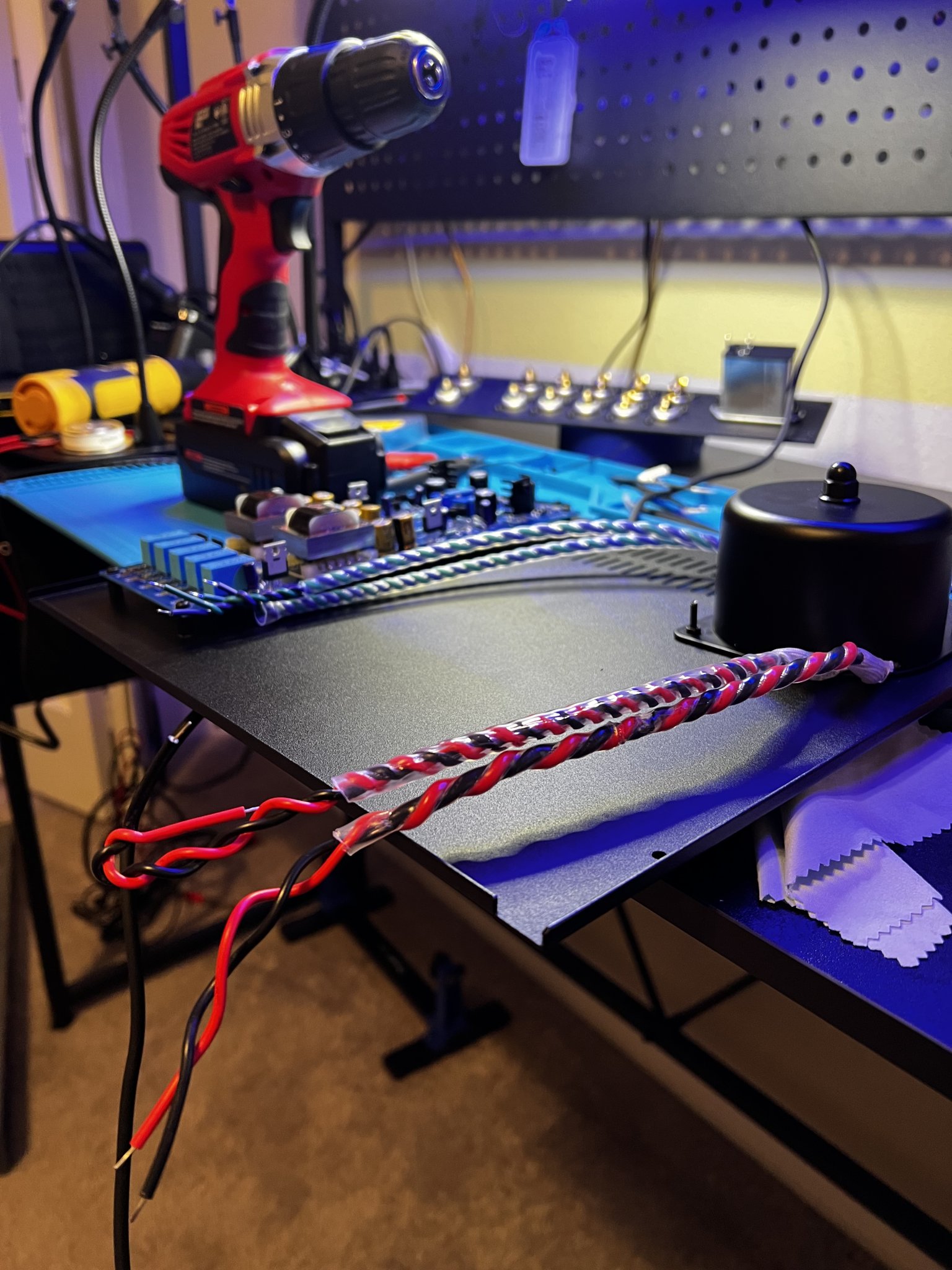

While I am making a fool out of myself in other parts of this site. Heres a little wire porn!

Back on top man. I'm glad that I got all of the Iron pre that I need (for now). Not only did I get the Iron pre straightened out, but the class D amp as well. Both were messy wiring that just was unacceptable. Otherwise, I use a stand in amp that is great, but this class D amp is by far the best. And now, set back listen to music that I heard in a long time and relive so many moments with new detail and image.

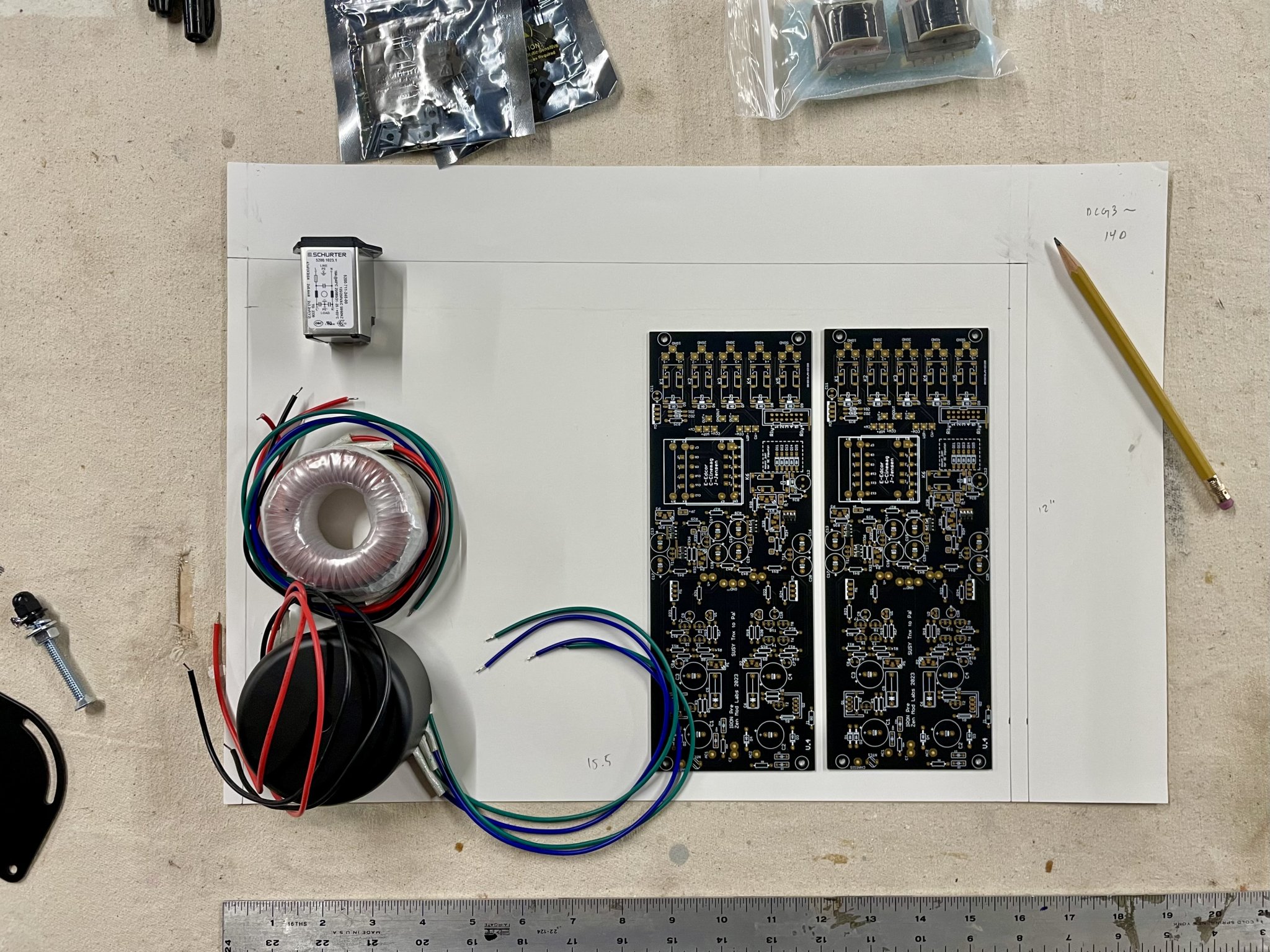

Here's the first version—have wanted to make it dual mono for years at this point...parts in hand, will build. It will have full logic, no pots or knobs.
