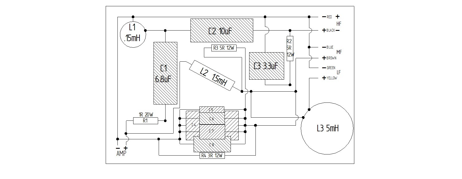

Your drivers are very different from my B&W P6 speakers. So don't know if this will help you but I built it by ear and the tweeter is reversed polarity. I've been told it is a 2 1/2 way XO. The P6 has a 6.5" woofer, 6.5" midrange and a 1" tweeter.

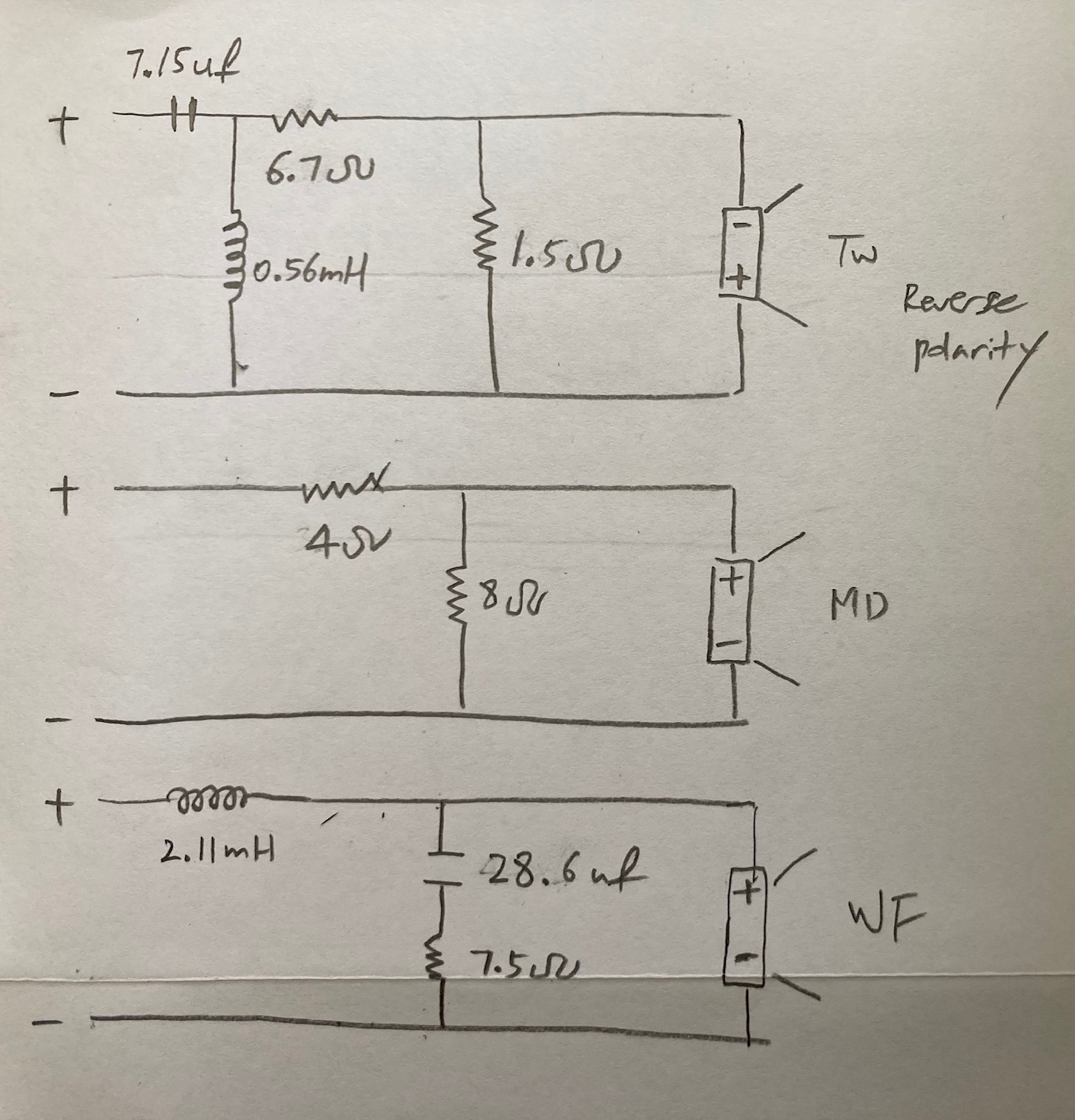

Not sure if I understood correctly and based on what I understood, I drew the crossover for 3 ways as attached. I added L-Pad for both Tweeter and Midrange and added Zobel circuit on Woofer. Not sure if I need to add an inductor and caps on midrange though. Hope I am not totally misunderstood.

My bad, it's the way I said it.
The L-pad looks OK. Now you can alternately pretend the mid is the tweeter being crossed to the woofer as a two way, then pretend it is the woofer being crossed to the tweeter. This way those extra components get added to the mid to the left of the 4 ohm resistor... except with different values that suit the mid itself.

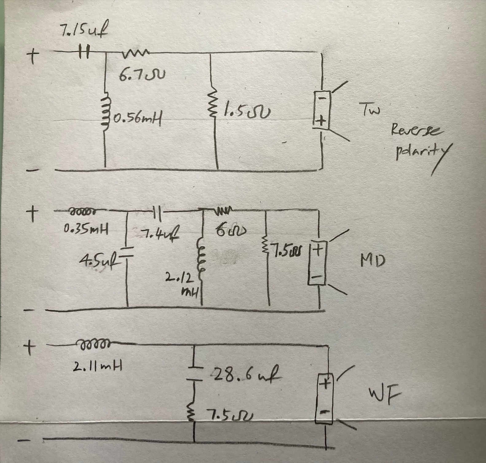

Thank you, Allen. To be honest, I am not 100% sure if I followed you correctly and treat the mid-driver as tweeter as well as woofer. Then, came up with this modified crossover schematic.
In short, 2 additional inductors and 2 additional capacitors were added in the Midrange and also replaced L-Pad resistor values to 6 ohm & 7.5 ohm respectively.

That's the way, and that circuit should work.
One of the things to be aware of is that if you bring the two crossover points close together then they can interact.. not that it has to be a problem. If you're ever looking for an excuse to do some simulating.
The question of first or second order (for both the low and high pass sections, and whether you should keep one or two of those components) is more a matter for experimentation here. There was some mention of it in the tutorial but the factors involved (the driver depths, responses and frequencies involved) may be different with a 3 way.

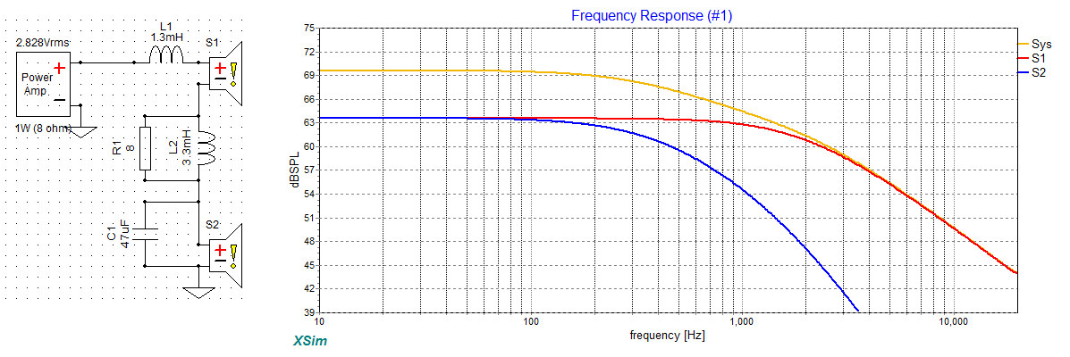

You can treat the two woofers as one 8 ohm unit and follow the tutorial as normal... However, MTM is a good opportunity for a 2.5 way. In a 2.5 way both woofers play bass, and one rolls off at the baffle step frequency (say 600Hz) and the other plays up to the crossover. This usually gives a fairly easy baffle step compensation, which helps if you do this without measurement. Another is that it avoids the narrowing vertical dispersion that MTM unfortunately has below the crossover if you can't cross them really low.
Since you have them in series, you'll need a couple of extra components. C1 causes the woofer labelled S2 to roll off at 600Hz. R1 and L2 make sure woofer S1 stays steady while that happens. L1 is the actual crossover at 2,500Hz. If you have any problems at the crossover you can add the RC zobel circuit across S1 as described in the section about flattening the impedance of the woofer.

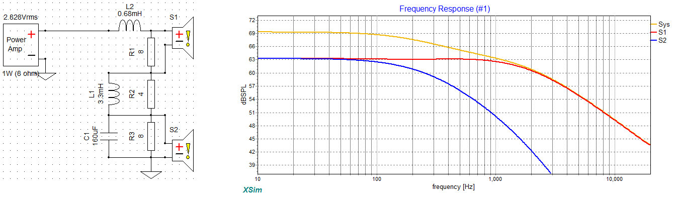

If my boxes are 12" wide, should I roll off S2 at 380Hz or so instead of 600? If so how should the values change for these 4ohm drivers?
Also how/why would the woofers being in series increase the number of components? How would it look like in parallel? Not that I want my speaker to be 2ohms, I just want to understand the circuit more. (though I do have both car amps and PA amps that can drive 2 ohm loads for extra power.)
First with this post I'll describe the series circuit.
Everything is scalable. There are 3 things to note...
1. I've put 8 ohm resistors in parallel with the drivers for the simulation to make them act like 4 ohm drivers. Do not add them to your crossover.
2. I made this change...
for 4 ohms, halve the inductor and resistor values and double the capacitor.
3. Then I adjusted the capacitor and the middle inductor together to make the baffle step frequency change.
Tweaking: While everything is open to tweaking, notice that the top end is down 3dB at 2.5kHz. Some crossovers are down at 6dB at the cross. These are not the frequencies you want too much energy. It might turn out necessary to try larger values for the top inductor, even twice as much.

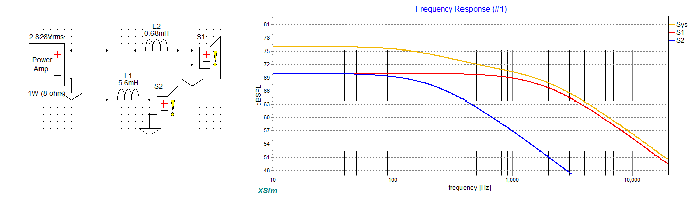

An easy circuit when in parallel. I normally don't go for the series option when I have a choice when doing a 2.5 way.. in this case it's just that the MTM is also a tricky option and it's hard to say which is better.
The simplest parallel 2.5 way...
In addition, the Zobel (RC) circuit may be added to the woofer that plays up to the crossover frequency.
They share the amplifier drive Voltage. As I remove the higher frequency energy from the baffle step woofer, the other one tries to compensate. (Recreating a finite, non-infinite, non-zero impedance from within the middle of a circuit requires both series and parallel components.)
Reactions: GM
Ok, you can treat the two as a single 8 ohm driver when working out the inductor. Work out the resistor and capacitor as for one woofer, then double the resistance and halve the capacitance.
The other thing to note when using two in series is that the total sensitivity stays the same as for one woofer.
