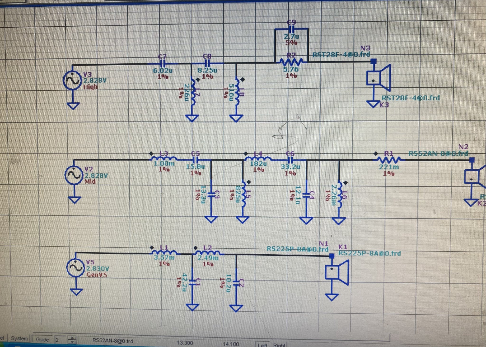

This is worth looking at, and it's fortunate because I was meaning to ask whether Toaster79 had considered the baffle step. Obviously if it isn't then when it is it would change the crossover.

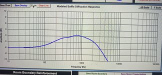

These components are sometimes used to create baffle step compensation, but they may just be for shaping. There may be other ways to do the same thing. The downside is that if not done carefully they can introduce problems with low impedance, it's important that there is a resistor in there.
I haven't planned a baffle step, also don't know if I will need it. The plan is to have ports on the front side and speakers pretty close to the wall.

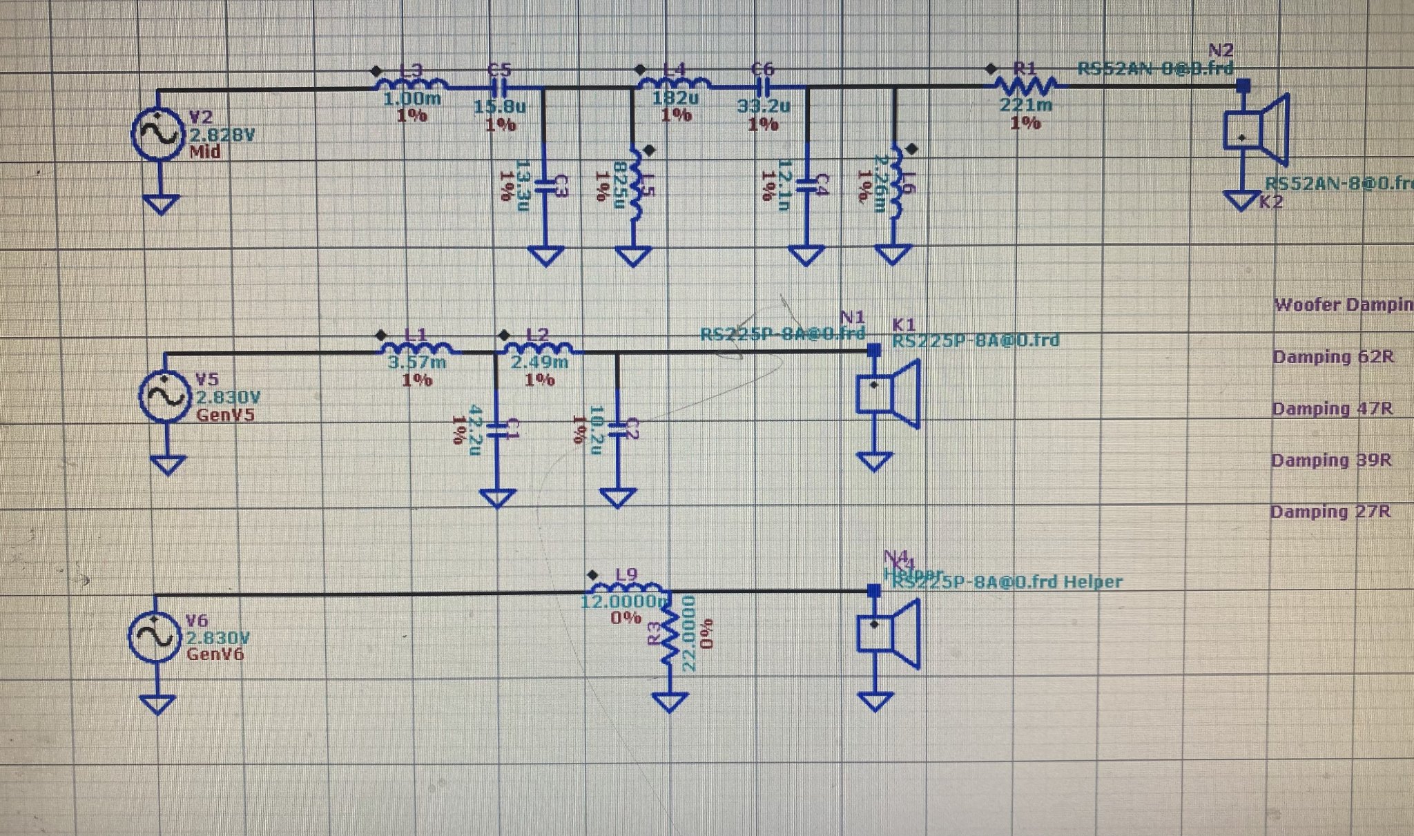

l would try removing R3 and C5. I am not sure the purpose of these parts.
Can you outline your driver layout and your baffle dimensions?
R3 and C5 are there to further suppress the woofers cone breakup section so it doesn't interfere with the other two drivers.

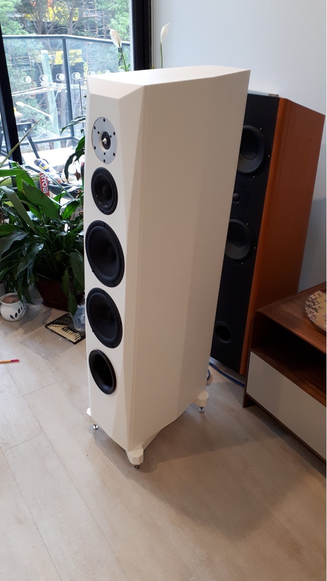

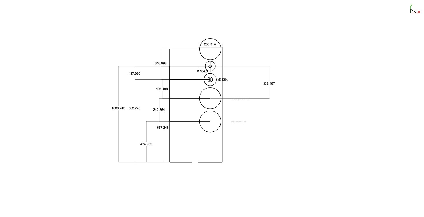

The idea is to have a baffle the size of about 250x1100-1200mm, tilted 5° in TMWW arrangement, similar to this
Thank you for posting the proposed layout.
One potential issue that you may find is vertical lobbing of the two woofers up towards the crossover point. Secondly you may find ripple in the crossover region due to the difference in the distance of each woofer from mid dome. Unless Xsim can locate your drivers on the baffle these issues won’t be obvious.
I had a look at XSim tonight.
lts a cool diy tool to get your basic filter values in the ball park. As discussed listening and then adjustments validated with a measurement tool like REW will keep sanity in check.

l will see if Jeff Bagley’s excel program can provide insights on diffraction/ baffle step and run some box simulations. For example what you could do it’s load one woofer as a critically damped seal enclosure and the other a custom bass reflex alignment. Tune it all for your room and have a good in room bass responses.

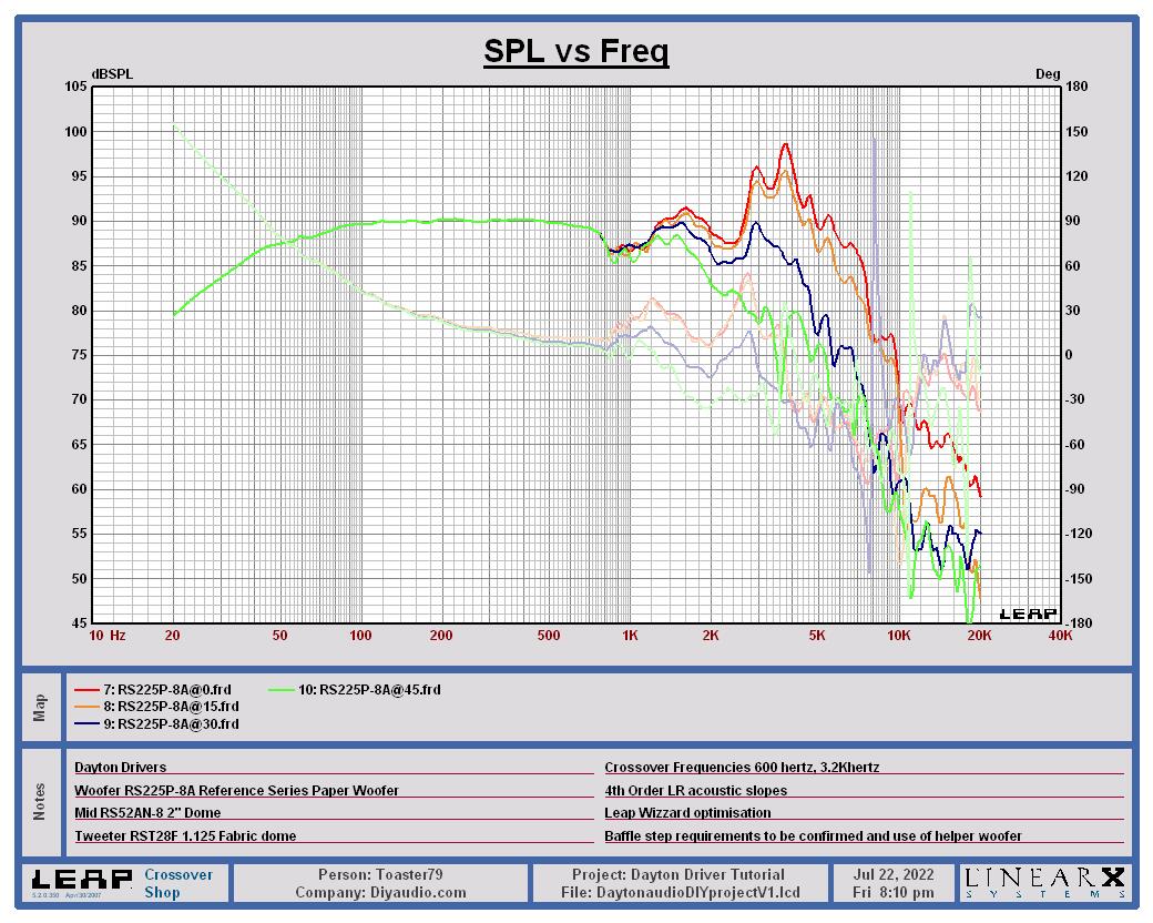

If I put them all on the one attachment you would go crazy.
Starting with the woofer you can see things start to go crazy above 800 hertz and around 3 khertz we see cone break up.
Most of us have perhaps heard the term cone break up. What it is is the cone actually flapping and self resonating as opposed to the cone moving in and out as a rigid piston. That's not going to sound very nice. So ideally we need to make sure we can't hear that cone break up.
This means we need to start thinking about the woofer crossover point? Technically it needs to be below the point where the response becomes erratic. The reason is that we want to have a smooth crossover region. That at least an octave either side of the crossover point.
After thinking about I decided to make the crossover point at 600 hertz - just for this exercise. The other important thing to understand is the driver sensitivity which I have referenced to 2.83 volts (1 watt into 8 ohms).

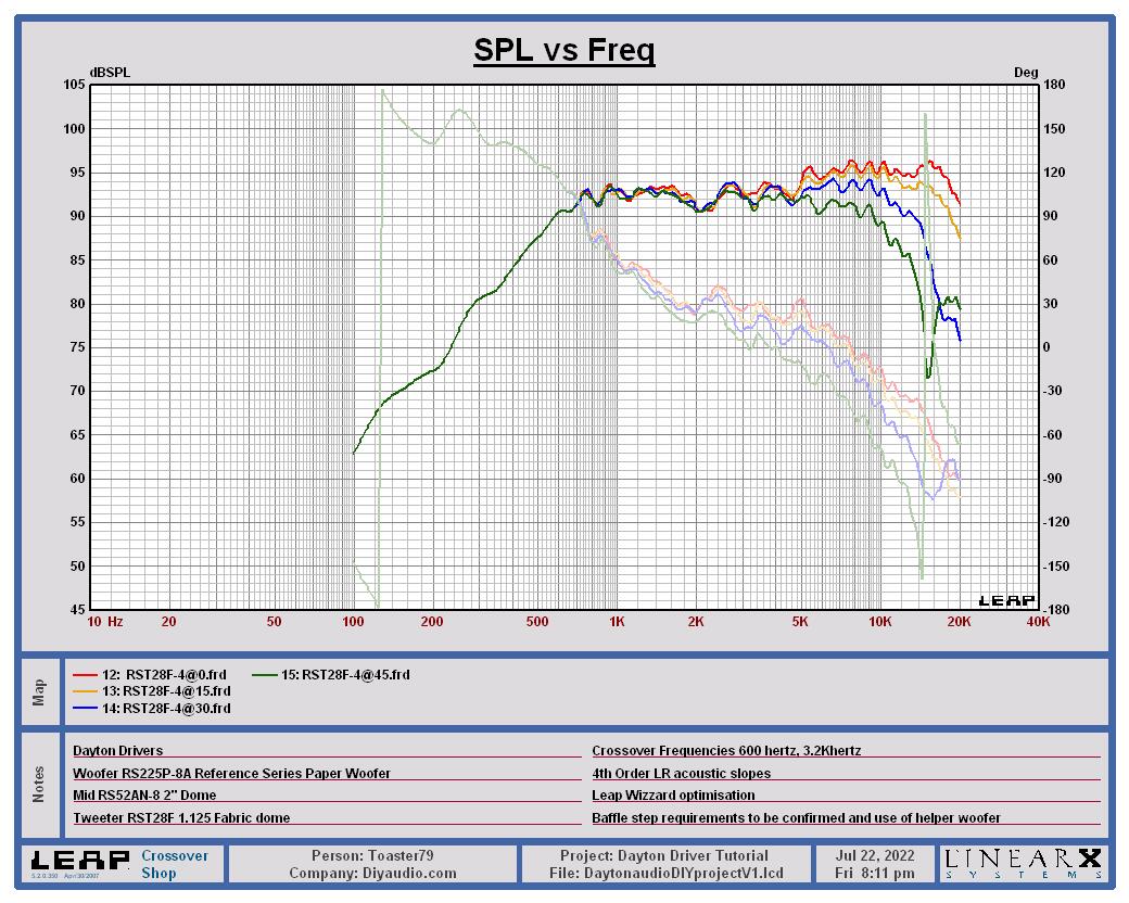

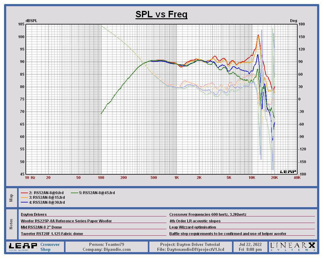

With the tweeter we have some variations in the overall flatness that needs to be considered. This can be addressed on the crossover network by building TILT into what is referred to as the voltage drive or voltage curve going to the tweeter.
We can see the on axis and the 15 degree off axis tracks well with the on axis response and the 30 degree response holds up well being only 2 db down and 10 hertz. There are no issues with the proposed 3.2 khertz crossover point to the mid dome. Level matching to the mid dome driver will need be applied. This dome tweeter is a 4 ohm ohm driver..

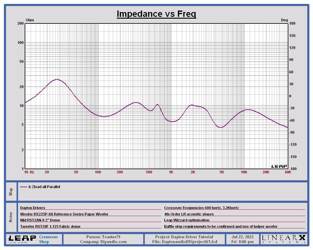

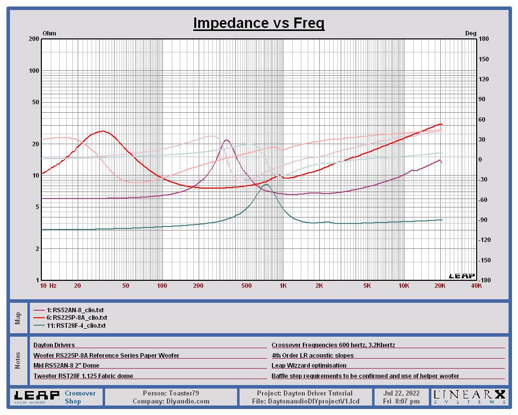

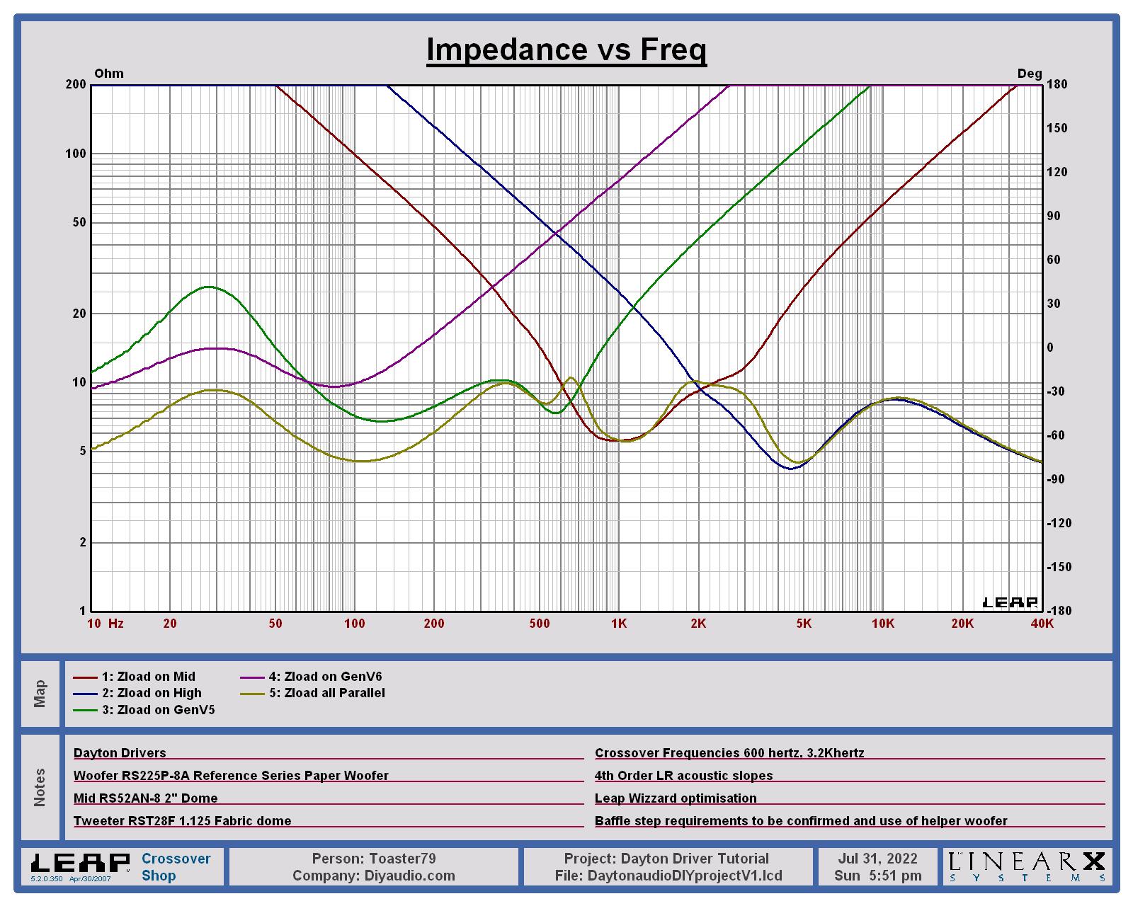

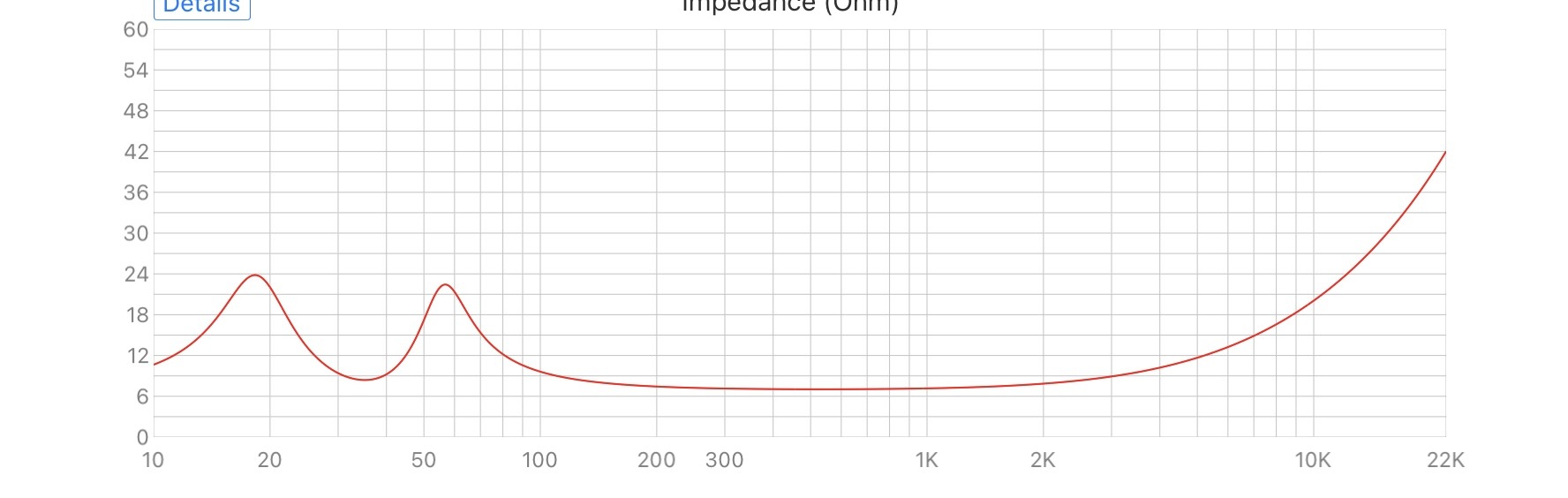

I have attached below the driver impedance curves so we can see the variations. Note that a driver with an 8 ohm labelled impedance is never strictly an 8 ohm driver. The significance of this is that we need to account for the actual impedance and the variations in the impedance when we calculate our crossover network filters .
I have posted the overall system impedance so you can see what happens with the network in place.
Now we need to scratch our heads and figure out exactly where the drivers are going to be placed on the baffle.
Toaster79 has already outlined his proposed concept. I have take this further and carefully placed the drivers on the baffle with real measurements of the distances between the drivers. The reason for doing this is that for the crossover slopes to work correctly we need to know the distance between the drivers. This is because the phase response of the crossover slope is dependant on the distance between the drivers. So it needs to be defined. The difference in the alignment of the driver voice coils also needs to be defined. Together with the lateral spacing of the drivers we call this the X, Y, Z co-ordinates.
Ideally the closer the tweeter is the the mid range dome the better.

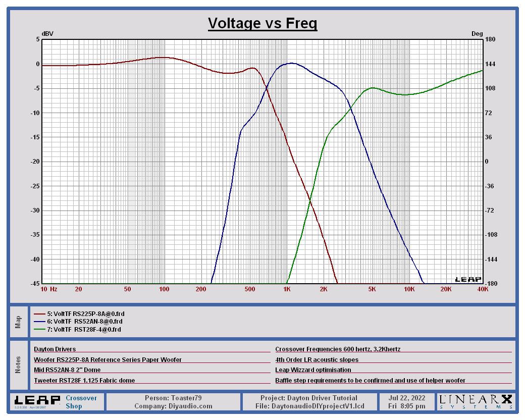

Next we have to think about crossover slopes. In a two way system where there is at least one octave or more of response overlap between the woofer and the tweeter you can use gentle crossover slopes. Its much simpler than the steeper crossover slopes to calculate parts values for and they can sound really good. However, in a three system with the crossover points only just over two octaves apart we need to use steeper slopes so the operating bandwidth of the midrange driver is clearly defined.
For this reason I decided to use Linkwitz Riley 4th order crossover slopes. A really important thing is to understand that this refers to the acoustic response of the driver. Not the electrical response. A lot of people mistake LR filters for the electrical response. This only ever applies with text book drivers which in practise don't exist.
The crossover network is if you like the engine room of the loudspeaker system. Its like the conductor and decides what goes where.
So what really matters?
Matching the driver levels - you can do this by ear as a diy exercise or use the data provided by Dayton Audio as in this case or you can use REW to make your own measurements. The later is not hard to do. Listening is the most important thing to do. The reason is that even the best simulations rely on assumptions and measurements that may not be applicable to your enclosure baffle and room placement of your diy loudspeaker system.
Correctly functioning crossover filters - you can attempt a cookbook design if you can measure your driver impedance with for example a DATS3 loudspeaker tester. This will save you a lot of time making adjustments when using RC and RL conjugate networks for impedance soothing which will make manual calculations work much better in practise. Then if your driver has a known smooth response your crossover slope will be reasonably close. The problem however will be your baffle and what it does to the smooth response of your drivers. The way to test your crossover is to reverse the polarity of one driver and listen for a null in the sound. This can easily be done with a measurement using REW.
Consider your driver frequency response characteristics per my earlier posts. Early listening in your loudspeaker design is the key. Trust your ears. If it does sound right try something different. What I have stimulated here will require careful listening and most likely some adjustments. Your early listening will instantly tell you if you have enough bass, if the tweeter is too bright or the mid range is too forward or recessed.

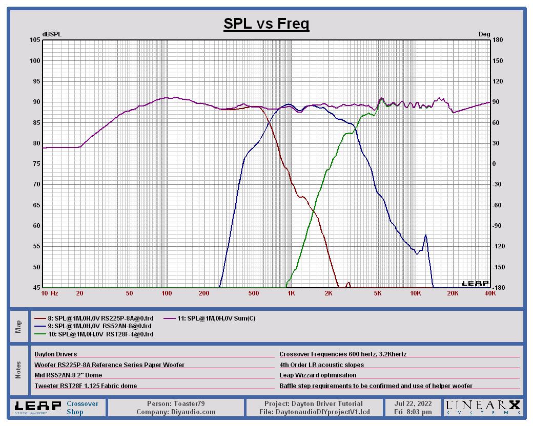

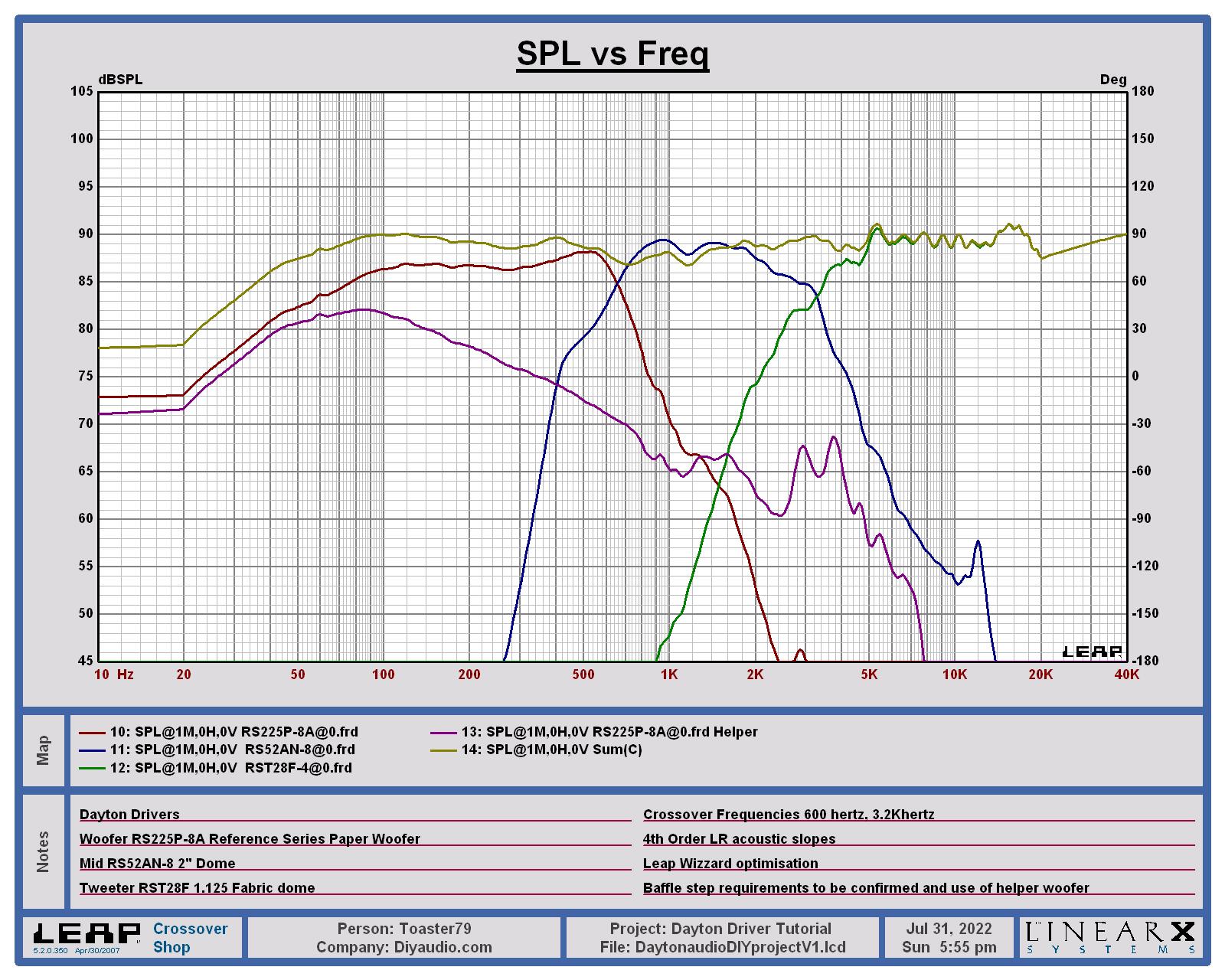

Please see the attached simulated crossover response using the principles discussed.
How did I do it? I used the power of the computer to produce this simulation. I have not introduced the 2nd woofer to keep the simulation as simple as possible. Adding the 2nd woofer causes a lot of phase grating in the response with the 600 hertz crossover point. A much lower crossover point of 200- 250 hertz would be required to operate both woofers over the same bandwidth. The possibility exists for adding the 2nd woofer as helper woofer over a limited bandwidth using a 1st order low pass filter if a baffle step compensation is required. Dual 8 ohm woofers would too sensitive unless wired in series. That might work in a D'Apolito arrangement with a woofer above and below the mid cone and a wider baffle to mount the tweeter beside the mod dome. I have such as system and it is exceptional.

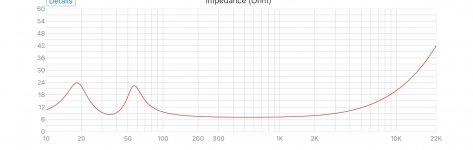

One thing l have picked up on is that the woofer impedance file is the driver free air resonance. Not the ported enclosure impedance. As a result the driver is acting as a bandpass resonance circuit causing some passive gain at 100 hertz.

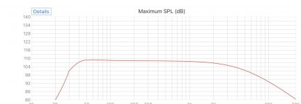

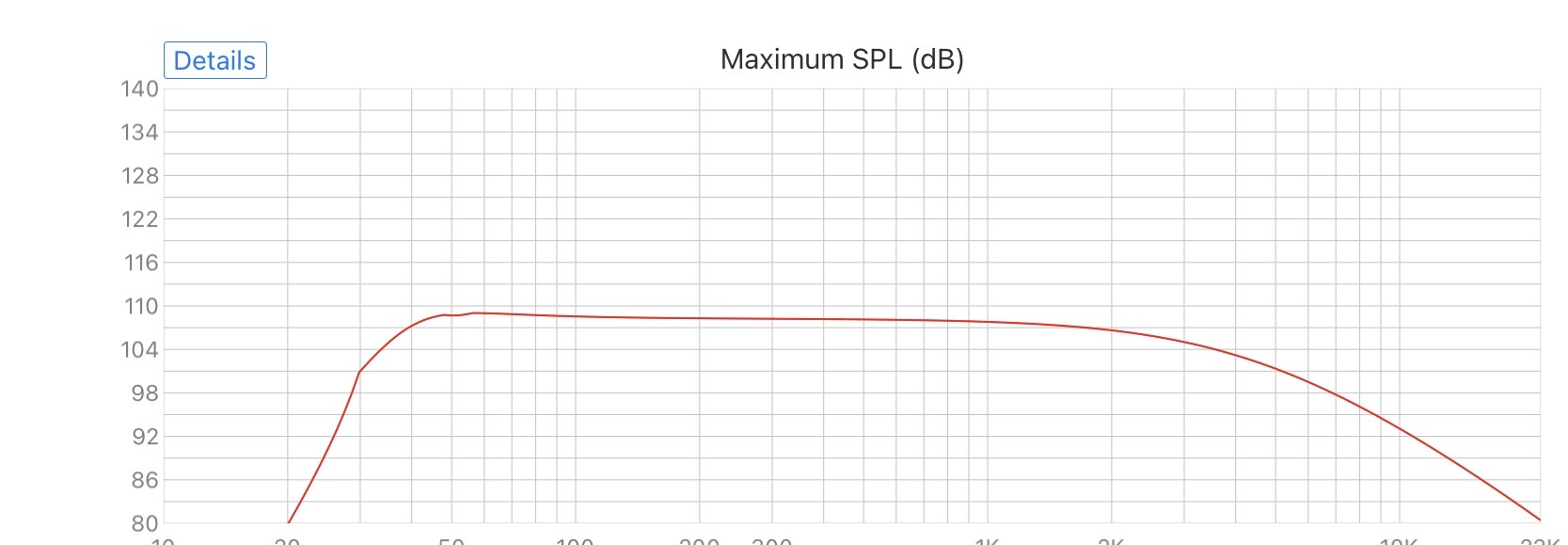

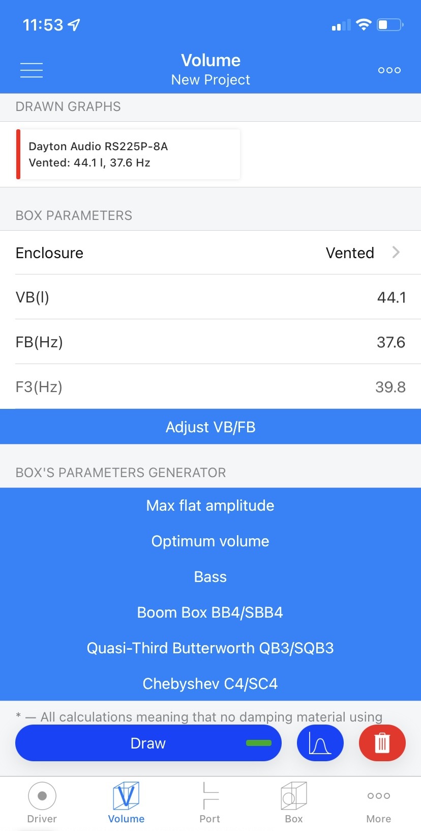

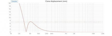

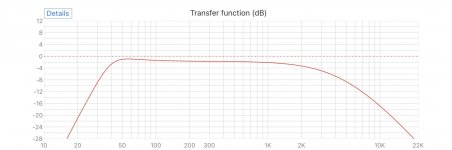

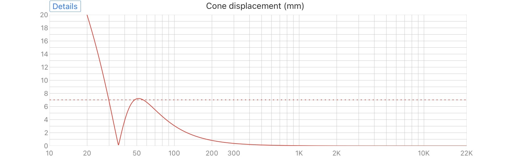

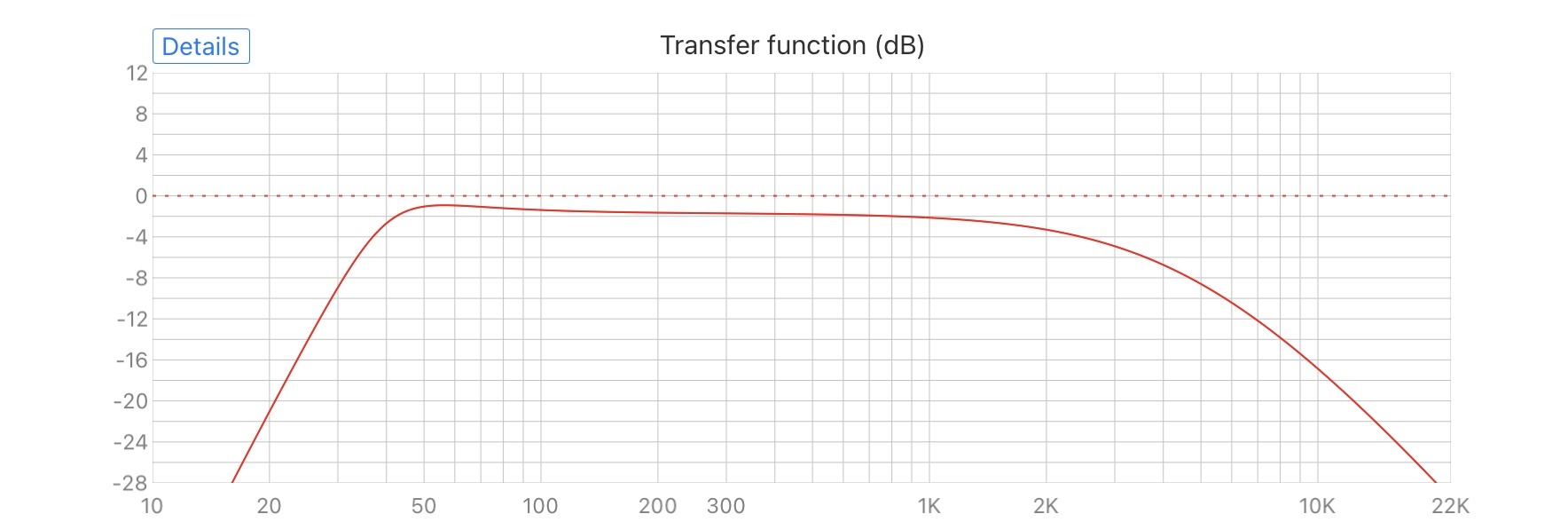

Below are some screenshots from a simple smart phone loudspeaker box designer called Speaker Box Lite. It is pre loaded with a lot of driver data from many different brands.
These curves are a simulation of the Dayton woofer selected by Toaster79.
Looking at the maximum low frequency acoustic output which is 106 db at 40 hertz a larger or multiple drivers will increase the output. The trade off is enclosure size, complexity and cost. Sometimes our egos want bigger. But bigger also invites the WAF.
A dedicated sub woofer or multiple subs will give you higher low frequency output and lower extension than any floor standing design.

Erratum.
In my previous posts I advised that I was unable two obtain a satisfactory outcome for a dual helper woofer where baffle step could be a problem with a 650 hertz crossover point.
On looking back at my work today I discovered an error in the simulation! This is the problem with simulations in that sometimes you can make blind mistakes and then dismiss what could be a solution to your design.
So please find attached some graphics exported from Leap 5 with the 2nd helper woofer used to level off the loss in bass due to baffle step. The baffle step was simulated using a diffraction simulator for this example.
The relevance to this thread is that you would incorporate a 2nd woofer and empirically design a 1st woofer crossover using listening tests in your room. A text book calculation on an initial inductor value used in the helper woofer low pass filter is quite acceptable. You can modify the response using a damping resister between 100R and 22R to smooth the Summed overall response. I used a DCR od 2 ohms for a 12mH inductor. This is quite acceptable. Please note what you should use a seperate woofer chamber for the helper woofer as the different voltage drivers to each woofer could result in non linear distortion.
Note : In these curves I used an electrical -6 db LF shelf filter to simulate the effect of baffle step in the SPL response.
