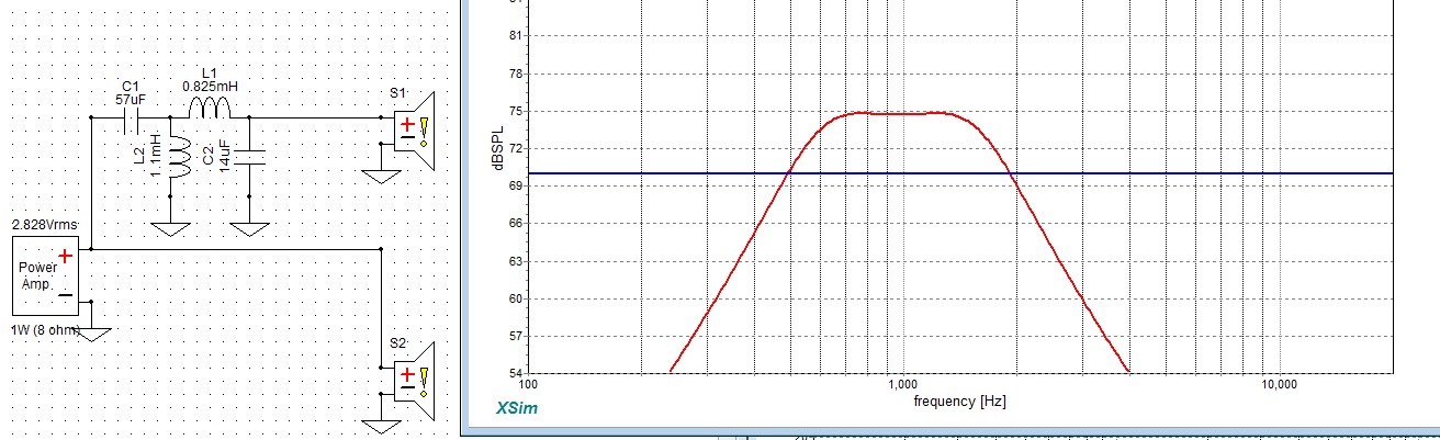

Ah yes. Filters use a property called resonance. You'll especially notice this with second order filters since you can control more than just the rolloff, but the level at the 'knee' of the rolloff. This is because of the way the components interact with each other.
Not only do the components of a filter interact, but different filters interact with each other. A low pass and a high pass sometimes do more than simply their own tasks, especially when they are close in frequency. They can be designed to give a perfectly predictable result, a flat response, a reduced or increased response, or it may be peaked at the edges if you're not careful.
I've made this example, where the combined filters draw more current into the circuit than the driver would alone, and they elevate its level (here compared to having no filters) it appears to have what's sometimes called 'midrange gain' ...

The midrange crossover with the close frequencies does want to take that shape and that gain, but it doesn't have to. The problem is it can get a little difficult to predict. So to answer the question does it have to be 3 octaves apart? No, it doesn't, but you can be even more sure if you do some experimenting. One good way to do that is with a simulator.
You can see I used a simulator above without taking measurements. While this is not going to tell you everything, you'll find that even the band-pass style filters alone are worth examining.

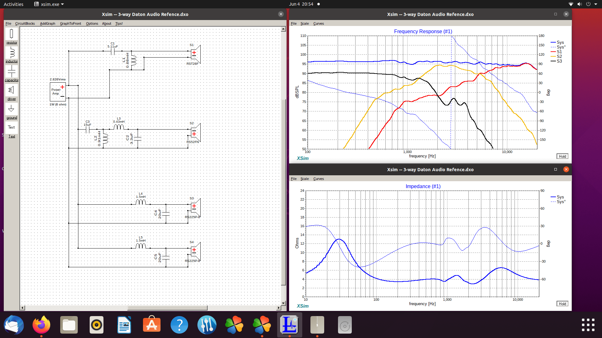

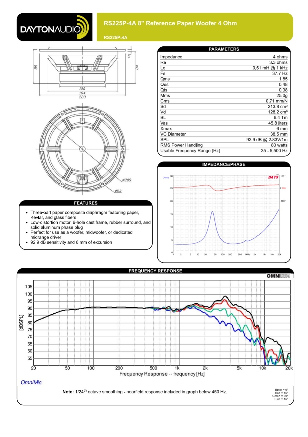

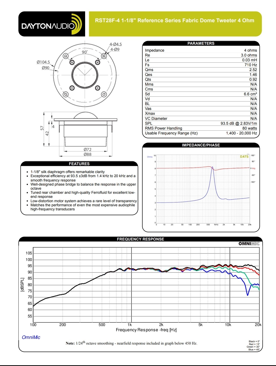

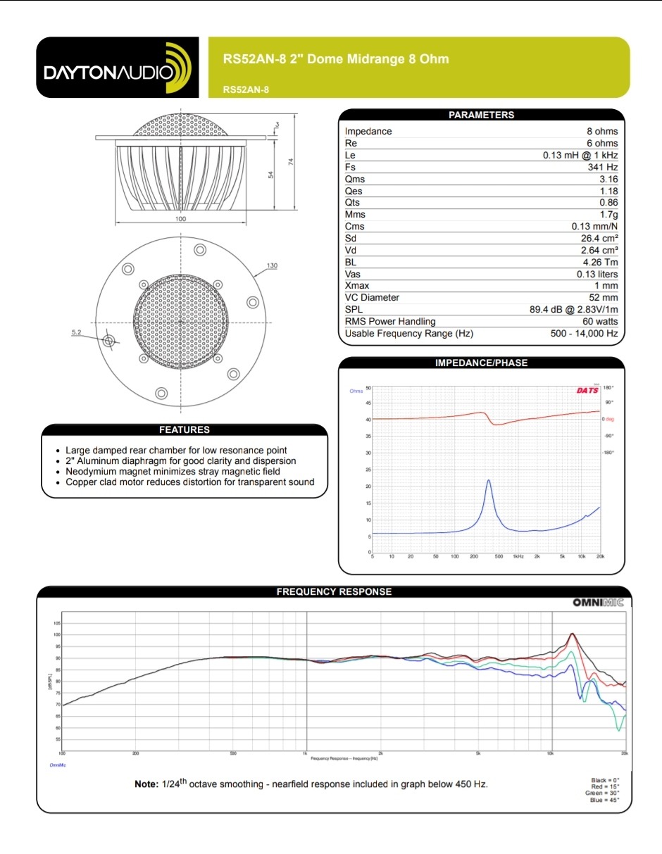

I just installed XSim on my computer trying to figure out how to design a crossover for a 3 way system based on Dayton Audio Reference series drivers attached
So my question is has designing a rather complex crossover became this simple using software? What am I missing and what am I doing wrong?

Simulation's big limitation is that the driver responses from the datasheets don't take the placement onto a given baffle and cabinet into account (diffraction and baffle step loss being two big acoustic phenomena). Therefore, simulation alone is incomplete if you want real world results. The next step would be to model the expected diffraction (can also be approximated in software) or dive into measurements (needing calibrated microphone and soundcard). Measurements will also let you analyze phase and off-axis responses due to acoustic offset between the drivers. Simulation also doesn't tell you how different crossover points and slopes will sound in your room, to your ears (equivalent to the tweaking by ear sections in the thread).
Basically, the usefulness of simulation is only fully realized with measurements.

Found a design thread using your drivers on htguide - as shown, I think he starts with the datasheet but ends up needing to take several measurements and iterations to crossover based on the effects of the baffle and cabinet used.
Listening and tweaking is a way to compensate for the things that are missed when designing without measurements. In three dimensions each cabinet shape sounds different. A box is just one option.What am I missing
You are not asking Xsim to show phase for your drivers. Turn off system phase too. Don't ask your woofers to play into their breakup region.
