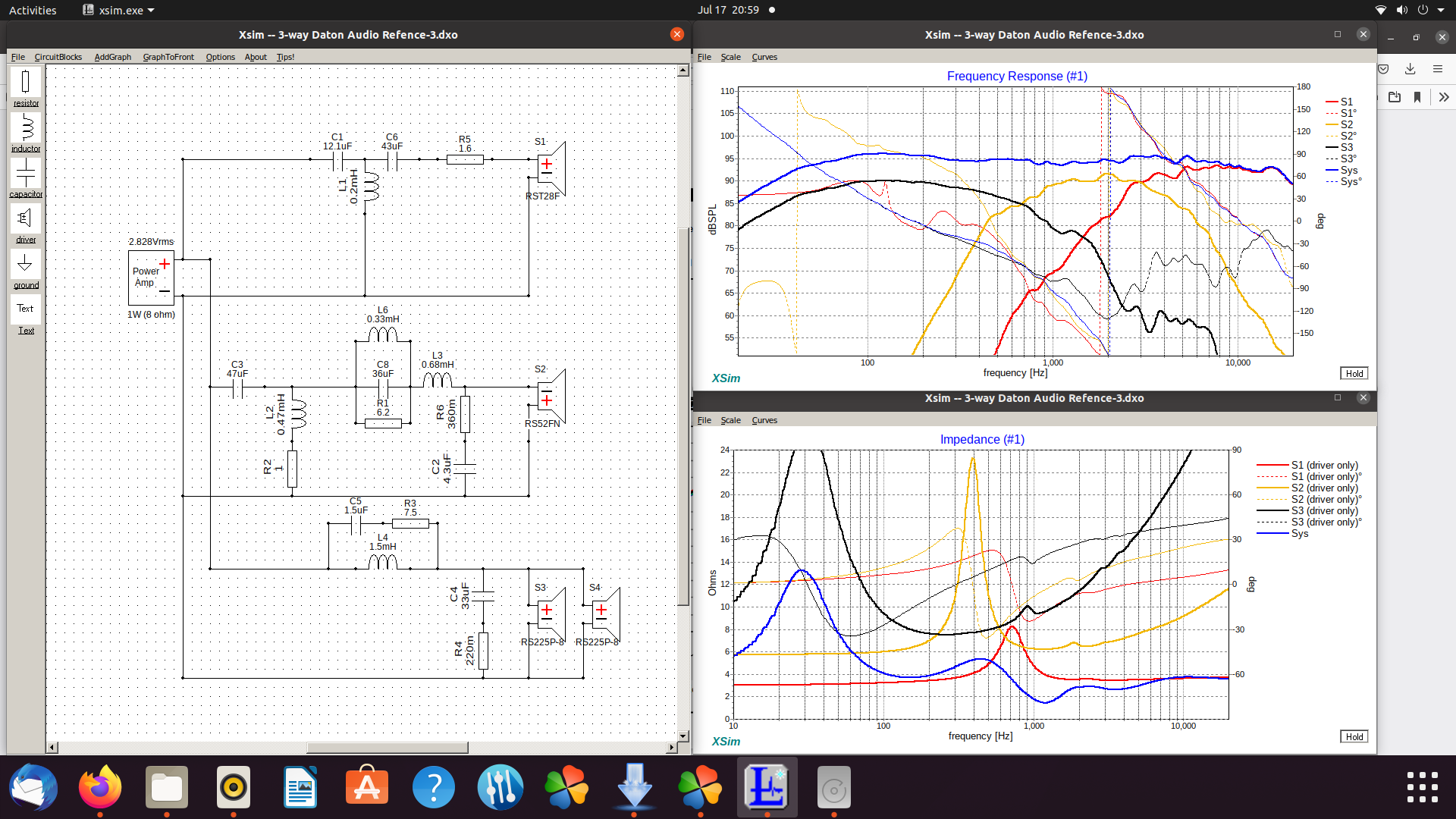

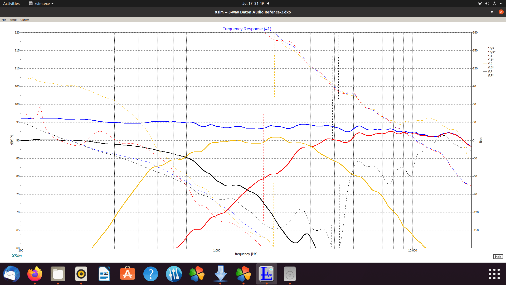

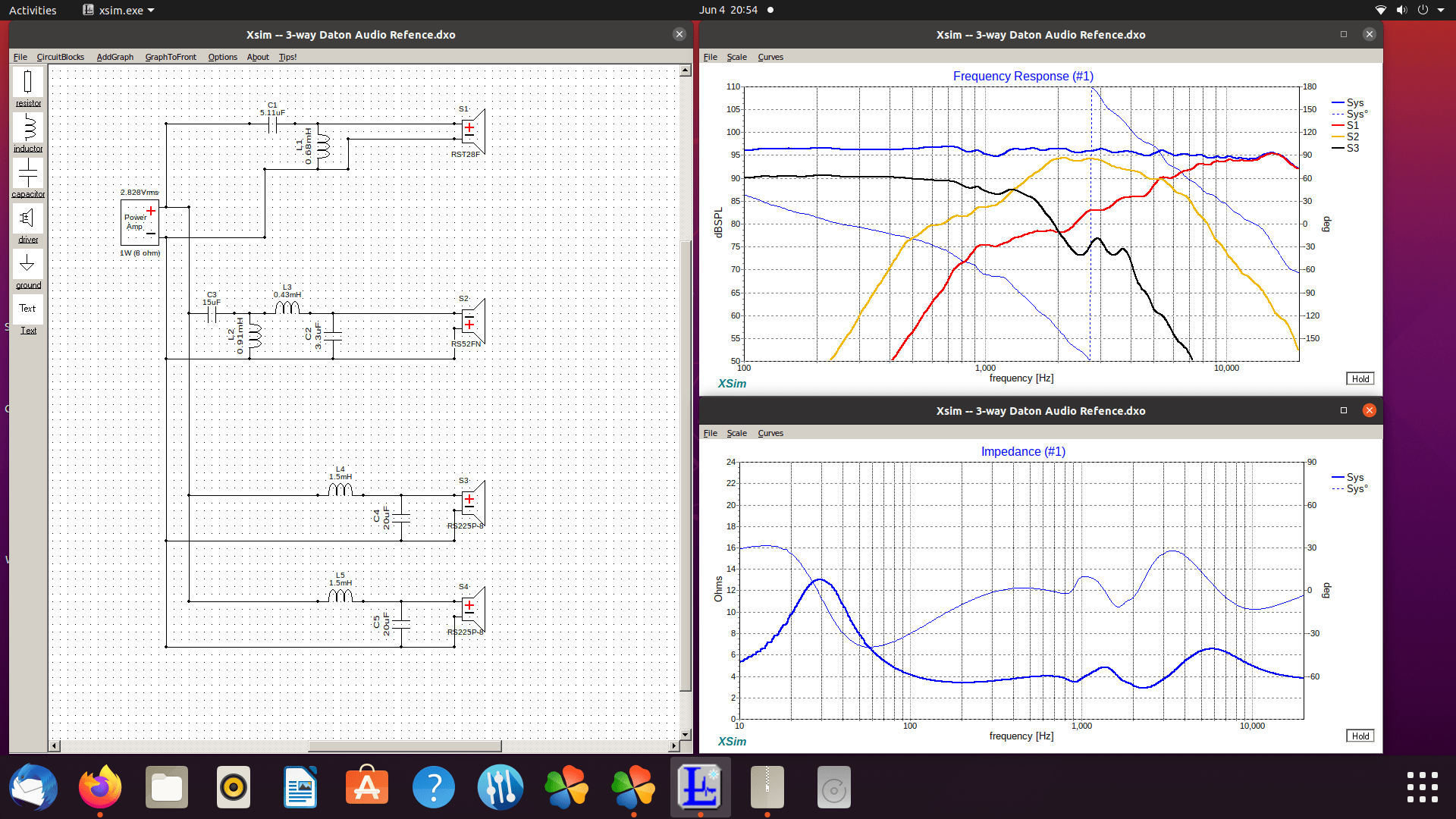

I just installed XSim on my computer trying to figure out how to design a crossover for a 3 way system based on Dayton Audio Reference series drivers attached
So my question is has designing a rather complex crossover became this simple using software? What am I missing and what am I doing wrong?
Just to make some things clear, I'm a complete novice in this area, have basically no knowledge about electronics and acoustics and the only thing I've built so far is a soundbar based on 2 full range drivers with a simple bsc.
The whole idea behind this post is building a pair of passive floorstanders for my living room that will be driven by a Yamaha AX-870 and the audio source is my linux based PC with Audigy FX sound card.
To answer your question the answer is No unfortunately.
Some preliminary objectives need to be established so you have compatible drivers.
I had a quick look at your driver selection and proposed crossover schematic.
1. You need to know what the combined sensitivity of both your woofers is going to be relative to your mid range and tweeter.
2. individual low pass crossover filters on each woofer are in appropriate unless you intend to use a first order low pass filter on the lower woofer to compensate for a known baffle step requirement.
3. Your woofer low pass crossover frequency look too high. Aim for 500- 600 hertz and 5,000 hertz for the midrange and tweeter.
If you wish l can assist you in your own thread or send me a pm. I can also run through how to use REW to get real measurements on your project. Non of this is difficult with some guidance.

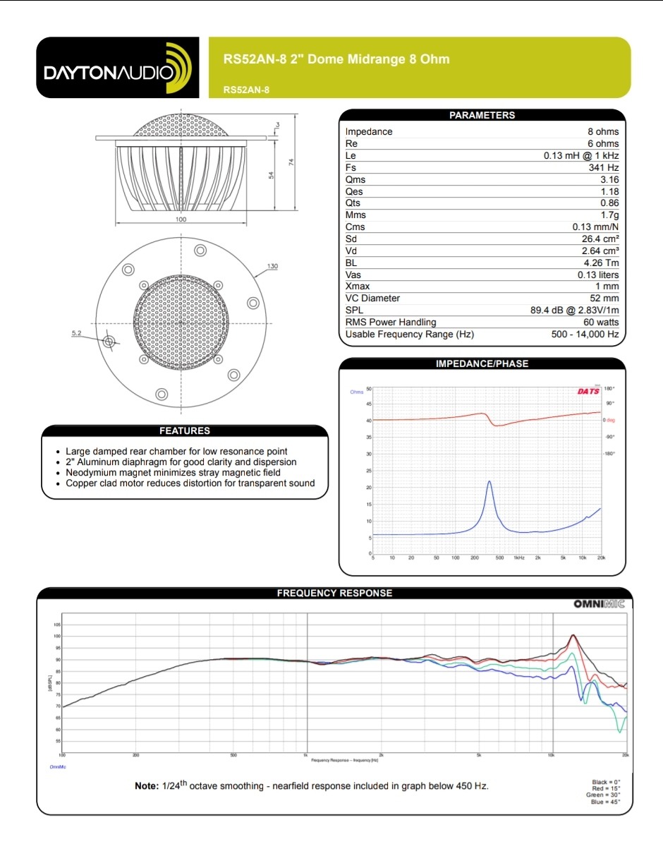

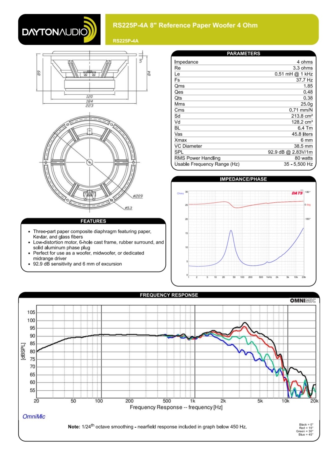

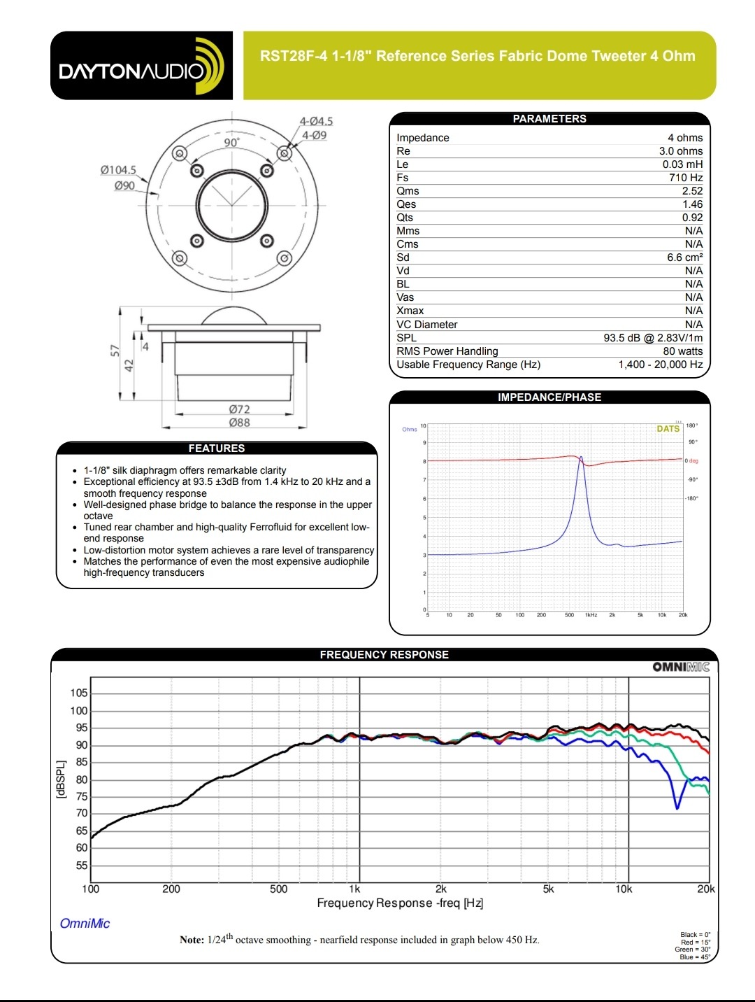

Thanks for your response and everyone elses response here. Really appreciate it.
I attached the data sheets of each individual driver for everyone to have look. Getting the sensitivity on par with other drivers isn't an issue here as you probably seen in my first attempt that came out pretty flat.
Crossing the woofers at 700Hz or even 1000Hz shouldn't be an issue as it starts getting directional above 1k and the cone starts breaking up at 3k. These would work perfectly well in a 2-way. However crossing them lower might present an issue with power distribution and overloading the mid.
Crossing the mid at 5k where it obviously gets directional would be detrimental compared to around 3k and the tweeter can go much lower than that.

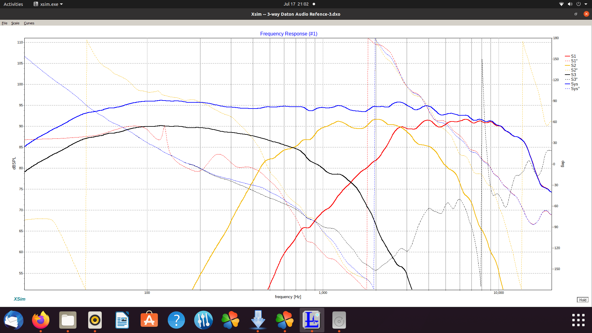

However I've been further playing with this theoretical design and came up with this
0° response
30° response
Phase and impedance

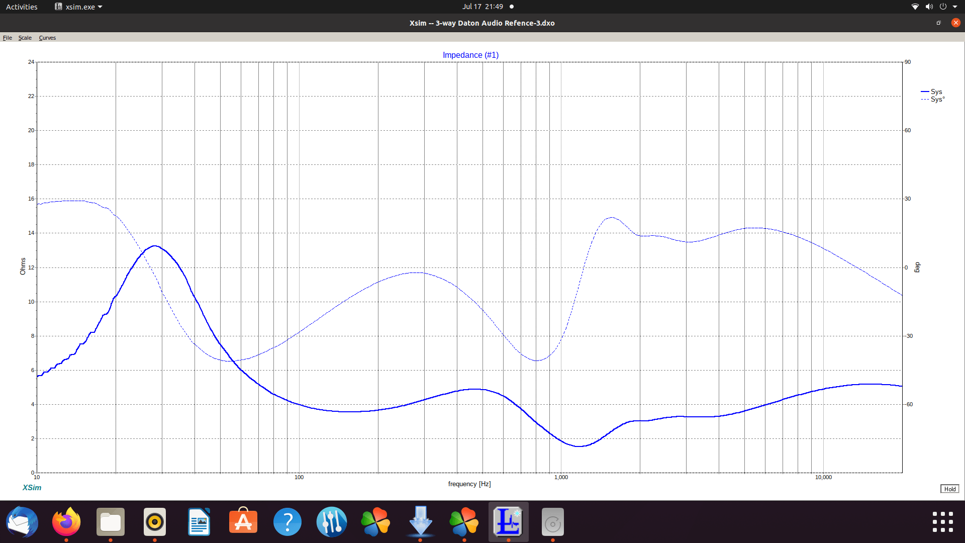

Now the only issue I have is the impedance dropping below 2 Ohms in the 1.3k region and would as for a hint how the address this issue as I don't know how happy my amp would be with this.

It’s a bit hard to know without looking at the voltage drives.
l would try removing R3 and C5. I am not sure the purpose of these parts?
l would try a simple RC zobel simulation to flatten the combined parallel woofer impedance to four ohms from 700-3000. Do not force the impedance below four ohms.
Then test and fit an ideal 2nd order filter for the actual impedance. Ie 4.2 ohms. The response curve should then be close without modifying the L or C which can upset your system impedance. Try a Linkwitz 2nd order filter as they sum flat with electrical phase reversal.
See what this does to the system impedance?
Your idea seems to be almost a fill in driver between the woofers and the tweeter.
Can you outline your driver layout and your baffle dimensions?
lf you intend to use a tall narrow baffle say 1200mm x 240mm you might simulate the possibility of baffle step in Jeff Bagleys Excel spread sheet. If you need baffle step “Compensation” l suggest using one of the woofers as a low pass helper woofer below the baffle step frequency ie 300 hertz. Use a simple 1st order filter.
You will get much lower THD at low frequencies, more manageable system impedance of around eight ohms in the crossover region and still good system sensitivity.
You could use an LCR series trap to flatten the mid drive resonance for a better high pass crossover function and possibly a RC zobel
to flatten the impedance for the low pass filter.
If your software can do it try a mid bandpass filter because your crossover points are relatively close together. It will possibly give some passive filter gain which can be useful to trim out the response level matching.
See how it goes.

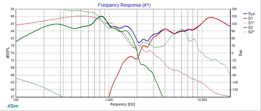

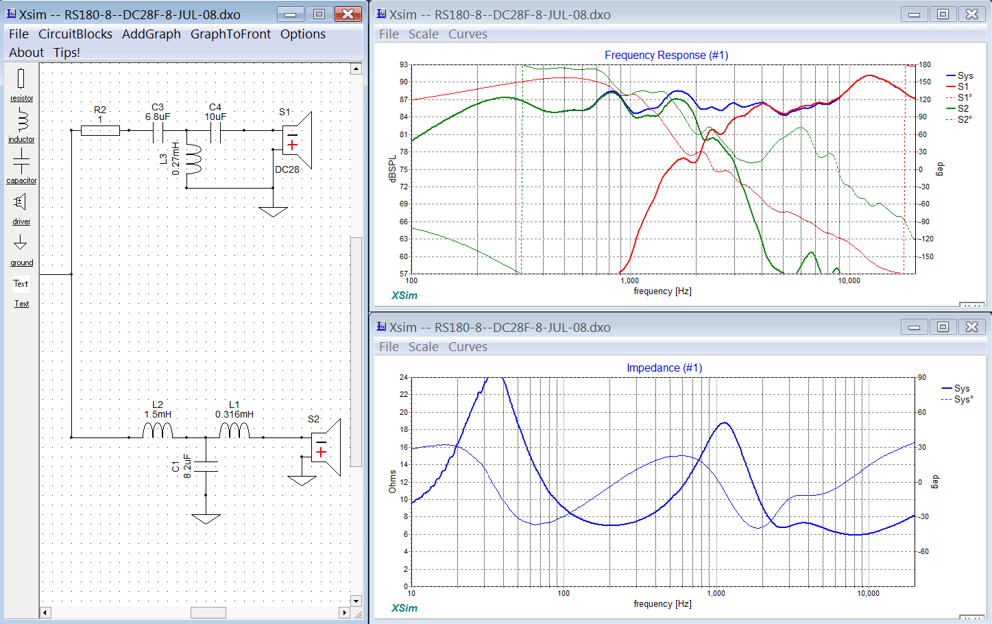

This is worth looking at, and it's fortunate because I was meaning to ask whether Toaster79 had considered the baffle step. Obviously if it isn't then when it is it would change the crossover.l would try removing R3 and C5.
These components are sometimes used to create baffle step compensation, but they may just be for shaping. There may be other ways to do the same thing. The downside is that if not done carefully they can introduce problems with low impedance, it's important that there is a resistor in there.

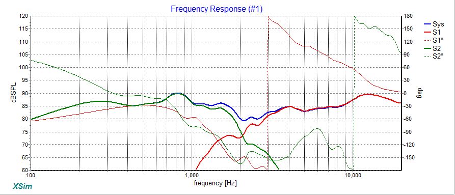

I am trying to design a crossover for RS180-8 Woofer with DC28F-8 Tweeter, however I am getting some nasty peak and dips. Can someone please suggest what is causing it?
Next, invert both drivers so that the phase plots don't go off the page right next to the crossover.
With a couple of quick simplifications I've been able to bring them a little closer. Sometimes it is just a matter of the values you use and sometimes you need a more complex circuit, but I usually look toward the former first.

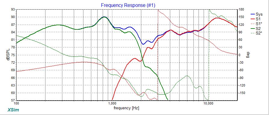

I think improvements could be made by improving the measurements, ensuring they are free of disturbances.
It's difficult to be sure with single measurements. What I would probably do at the start is try to ignore the peak near 800Hz, and listen to adjust the tweeter resistor. Set that value in the simulator and try to keep it there for the next stage.
