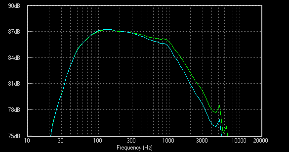

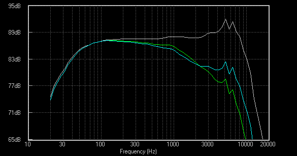

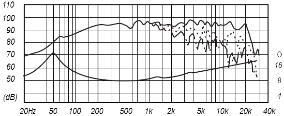

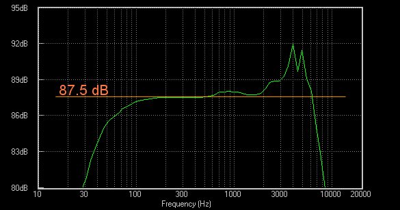

Woofers - choosing where to cross
If you look at the woofer's frequency response plot shown below, you will see that the woofer has a peak in its response at 4kHz (4,000 Hertz) just before it rolls off above 7kHz. In other words, it will play too loud at these frequencies. This peak is not uncommon for a woofer but it will not always be obvious when looking at some plots.
It is the region of cone breakup, and it is the result of the cone flexing when working at these frequencies. Woofers don't normally sound good here and it is best to cross them over below this point which prevents them receiving as much energy at these frequencies.
A rule of thumb is to leave at least an octave (or two) between the crossover point and the cone breakup. An 'octave' means a doubling or a halving in frequency, so in the case of the woofer shown below, our crossover should probably be at or below 2kHz.

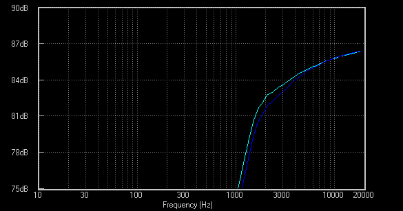

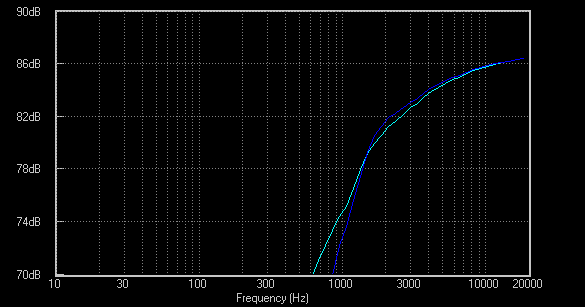

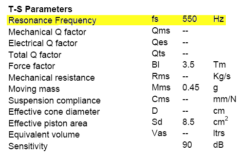

Tweeters
If you look at the spec sheet for the tweeter below, you'll see one spec named "fs". This is the resonance frequency of the tweeter (550Hz in this case) and you shouldn't cross this low. The response plot below (image 2) shows that the tweeter can't produce useful sound this low in frequency although the dome or cone will still move about freely if you ask it to. You can overdrive a tweeter if not careful. This may produce distortion, or cause damage.
The rule of thumb here is to cross the tweeter an octave above, and preferrably two octaves above the resonance frequency. In our case, this means our crossover should be higher than 1,100Hz and if possible 2,200Hz.
The best crossover frequency for this example set of drivers
With the woofer's maximum of 2kHz and the tweeter's minimum of 1100Hz, the crossover should be somewhere in this range. I would tend towards 2kHz as this way, when the volume is turned up the tweeter shouldn't be the first thing to strain (as it probably would if we chose 1100Hz for the crossover frequency). Sometimes a woofer will have particularly bad cone breakup and a tweeter may be known to handle a low crossover frequency so the option may be there to take yours lower as required.

Discovering the woofer's level

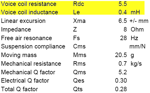

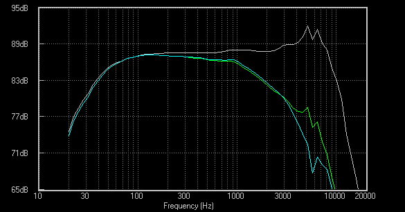

Looking at the woofer specs (image 1), we see that the sensitivity is listed as 87.5 dB/W/m. Looking at the woofer graph you'll see that much of the plotted response is at that level except for the cone breakup region (image 2).
This will be the level of our example system. If you choose to do some baffle step compensation (next post), this will come down further.

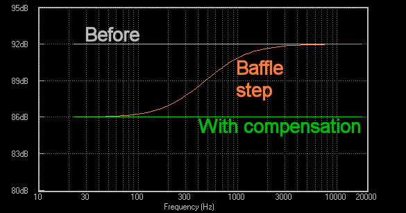

BAFFLE STEP DIFFRACTION
TL;DR -- If the treble is too loud, come back to this.
What is the problem?
The bass will not be as loud as expected because the baffle/box is too small to prevent the bass from spreading out and wrapping around the cabinet.. whereas the higher frequencies will stay in front. This is a matter of wavelengths being larger at lower frequencies. When looking at the response on-axis it may seem as though the lower frequencies have gone quiet by up to 6dB. (This can vary because the room complicates what happens to the rearward energy, so you may want to experiment with where you put the speaker, and how much you compensate the level.)
What to do
Make the tweeter about 6dB more quiet than the woofer sensitivity, and trim down the woofer's high frequencies as well. (This assumes that the width of your baffle causes your baffle step to be a little below the crossover frequency, which it typically will be with a 2 way, for example.)
For the woofer, sometimes this is as easy as increasing the inductor value. Sometimes you can change from the regular first to a second order filter..
..or you can use a 2.5 way (easy, and described in the next post), or a BSC circuit.. for example here it is with the 6.2ohm resistor across the 2mH inductor, which have been added to an existing crossover. The inductor trims more of the high frequencies and the resistor limits how much extra they will be reduced. This creates a shape the opposite of the baffle step shown above.

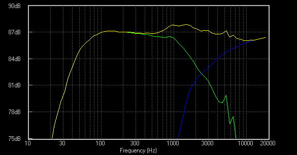

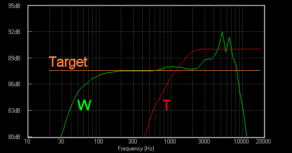

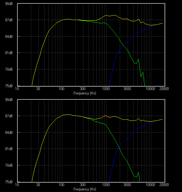

THE DESIGN PROCESS - Why the following stages are necessary
Note -- If you are looking for a 'cookbook' approach, feel free to skip this section. It is a discussion post, and is slightly technical but recommended. It covers the interactions between the crossover and the speaker, and how to approach the design process. (I will be ignoring baffle step compensation here as it can be dealt with separately, isn't always necessary, and would needlessly complicate the following sections).

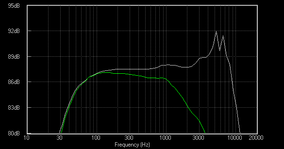

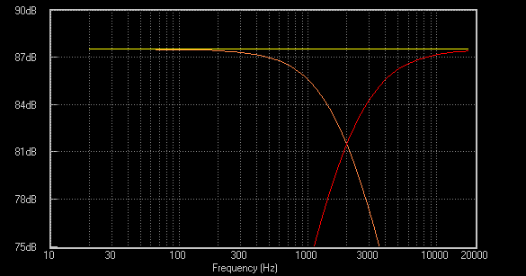

The first image below shows the example published woofer and tweeter response, with the desired final response. Now, it should be clear that the woofer and tweeter need to be treated differently… something you wont get following standard formulas.
In order to achieve this target response you'll want to make the individual responses look like the second graph shown below (around the crossover region). For this no-measurement crossover, I am going to use a first order electrical filter on the woofer and a second order electrical filter on the tweeter. Although these are not equal, it is more important that the drivers cross well acoustically and this combination typically works well.
This has the advantage of being a fairly straightforward crossover, whilst offering a fair range of control over the responses, and enough protection for the tweeter. Even for a 'measured' style crossover, this format is a common final result. I encourage you to think 'outside the box' once you get the feel for it… for the time being without measurement it may be prudent to start with something like this.

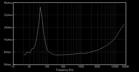

This is the final hurdle to cross before we can get down to designing the crossover itself. First though a short explanation of the word impedance. For our purposes, impedance is the same as resistance except that it applies to alternating current like music signals. Impedance can be a combination of plain resistance, inductance, and capacitance. The difference being that resistors behave the same at all frequencies but inductors and capacitors have a varying effect that shows greater influence at higher or lower frequencies.
A crossover is electrical, and when you put one on to a speaker, the impedance plot shows how the speaker will be 'seen' by the crossover. An example impedance plot is shown as the third image below, and it is fairly typical.
The problem here is that the crossover will have a varying effect as the impedance of the driver varies (i.e: the impedance will present a lighter or heavier load to the crossover depending on the frequency, which may upset the balance).

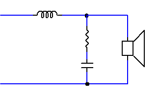

FLATTENING THE WOOFER'S IMPEDANCE

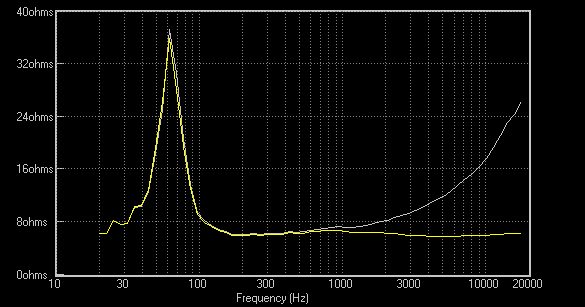

We'll need to use one resistor and one capacitor (per woofer). The first image below shows the before and after impedance plot (grey/yellow). The impedance is now the same at all frequencies around the proposed crossover. The second image shows the schematic (electrical) diagram so far.
Working out the values
Looking at the specs (image 3) you'll see one called either 're' or 'Rdc'. When working out the value for the resistor in this circuit you should multiply this value by 1.25. For our example this is 5.5 x 1.25 Although this equals 6.875, there is no easy to find resistor of this value, but 6.8 ohms will do nicely.
For the capacitor, look for a spec called "Le" which for our example is 0.4mH (that is 0.4 milli, also known as 0.0004). Take your value of Le and divide it by R squared. For example, our resistor was 6.8 ohms, and 6.8 squared is 46, so 0.0004 divided by 46 gives us a value for our capacitor of 8.7uF, which is close enough to the easy to find value of 8.2uF.

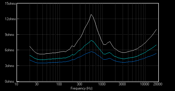

Adding the resistor
The tweeter has an impedance peak at its resonance like the white curve shown in the first image below, at 550Hz. If we don't take care of this it may cause the tweeter to play loud around the resonance as our crossover will be less predictable. It may also reduce power handling.
The simple way to deal with this is to put a resistor in parallel with the tweeter. The entire impedance will be reduced, but the peaks will be reduced by the greatest amount. The smaller the value of resistor the more effective it will be but don't go too low… you may lower the total impedance too much which some amps won't like. (It isn't so bad if you plan to add some series resistance later, as will be shown in the crossover section.)
The first image below shows the effect (from top to bottom) of no resistor, a 20 ohm resistor, and a 10 ohm resistor. This will be a matter of trial and error for your tweeter. The circuit so far is shown in the second image.
If you are interested in taking this further or have a difficult tweeter, you can look at resonance peak filters. One of these could remove the peak altogether.
The new impedance
We'll need to know what the impedance is now, in order to work out the values to use later in the crossover. Estimating the 'typical' impedance value near the crossover frequency will be good enough for our purposes, and is not too difficult.
This example tweeter is a 6 ohm tweeter. Looking at the white curve on the plot below (which is the published curve from the spec sheet), the impedance goes to around 6 ohms at 2kHz, where our crossover will be. This impedance 'dip' region is not uncommon for the chosen crossover point because it happens above the resonance where we often choose to cross. For an 8 ohm tweeter we might assume it will be 8 ohms at this point (it isn't really that critical as long as we don't do anything unusual or assume too much).
Because the two blue plots in the image below will not be given on the spec sheets, we need to figure in the effect of the resistance we put in parallel with the tweeter, and this is how to do it. Start with the rated impedance of the tweeter (such as 8 ohms but in this example it is 6 ohms). Multiply this by the resistor you put in parallel, then divide this by the amount you get when you add the two. For example, a 6 ohm tweeter and a 10 ohm parallel resistor…. (6 x 10)/(6 + 10). This equals 3.75 ohms. Write your value down.

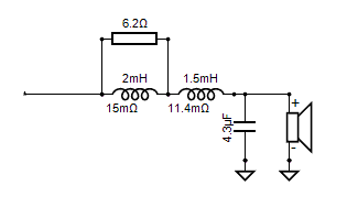

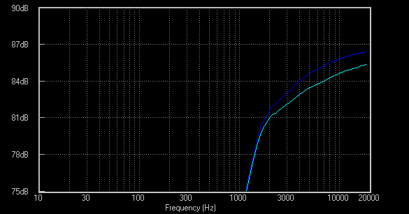

THE WOOFER'S CROSSOVER
What we will need here is an inductor. This is a coil of wire that has the property of impeding the flow of high frequency energy whilst letting the low frequencies pass. The final basic woofer crossover is shown in the image below (…more in the tweaking section).
Choosing the inductor value

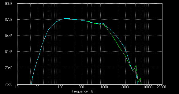

Since we have flattened the impedance, we can use the standard formula to find the starting value of inductance. First take the driver's rated (nominal) impedance and divide this by 6.3 times the crossover frequency. For example, 8 ohms divided by (6.3 x 2000Hz). In other words, 8/12600 which equals 0.000635 This is also written as 0.635m and the nearest easily available value of inductor should be 0.68mH, which will make a good starting value.
The second image below shows the frequency response of the woofer with and without the crossover. It isn't quite there yet, but in a later post on tweaking I will discuss how changing the values of each of the three woofer crossover components gives us a finer control over the woofers response.

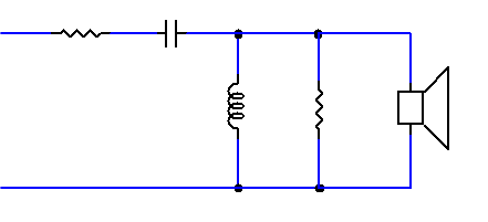

THE TWEETER'S CROSSOVER
There are three components we need to add to the tweeter. A capacitor and an inductor will prevent the low frequency energy below the crossover from overwhelming the tweeter, and will shape the response near the crossover. A resistor will be used to set the overall level of the treble. The complete tweeter schematic is shown below.
The capacitor
Take the value of impedance you wrote down two posts ago (for our example it was 3.75). Multiply it by 12.6 and then multiply it by the crossover frequency. For example, 3.75 x 12.6 x 2000 equals 94500.
Now, if your calculator has an invert function, use it on this number, or simply do 1 divided by your answer. ie: 1/94500 is 10.6uF which is close enough to 10uF.
The inductor
Take the value of impedance and divide this by the result you get when you multiply the crossover frequency by 3.15
For example, 3.75/(2000 x 3.15) which equals 0.000595, or 0.595m. The closest value of inductor is 0.56mH.

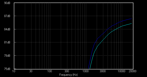

The resistor
If you subtract the woofer sensitivity figure from the tweeter sensitivity figure, you'll have a starting point for how much to lower the tweeter's level. Lower it a couple of dB more for good measure, if desired (there are several reasons for wanting to try this).
To choose the value of resistor to use, look at the following. To attenuate the tweeter by 1dB, take the tweeter impedance value we've been using here and multiply it by 0.12 to get the resistor value. For 2dB multiply instead by 0.25, 3dB by 0.4, 4dB by 0.6, 5dB by 0.8, and finally for 6dB of attenuation use a resistor which is equal to the impedance value.
You'll likely tweak this later, it is a very commonly adjusted component.
Polarity
One final point is the polarity of the tweeter. Try reversing the connections and listen each way. There will be more on why in the next post.
Finally
The entire response is shown below (image 2). It is a good starting point and will be tweaked later.

With and without having flattened the impedance
The fourth image below shows the woofer response when using the inductor before fixing the impedance (light blue). Green shows the proper crossed over response and grey is the raw woofer response for reference. It is obvious that without the resistor and capacitor, the response is not following the same downward trend. It fails to reduce the cone breakup region sufficiently (above 3kHz).
Notch filters
The fifth image shows the effect of using a notch filter to reduce the breakup region even further. Although I'll leave the design of notch filters for another time, it can be seen that one is useful in reducing the breakup region by a significant amount. It is usually good to try to have this region playing 20dB less than the rest of the spectrum. The green trace is the normal crossover and the light blue trace shows the notch filter in place. It was made using a 0.4mH inductor, a 2uF capacitor and a 3.3 ohm resistor.
Going second order
This will reduce the woofer's output above the crossover where only the tweeter should be heard. If you feel this is necessary, start reducing the value of resistance in the woofer crossover. This is likely to produce a peak in the response as discussed above and this can be offset by increasing the inductance. You will have moved closer to a second order electrical crossover.

TWEAKING THE TWEETER
The series resistor
This is the normal method of setting the level and is probably the first thing you'll try when sorting out treble issues. Changes to the woofer crossover may need an adjustment here as well. Changing this resistor will have the side-effect of bringing about some minor changes in the tweeter's tonal balance (image 1).
The capacitor
This will change the crossover point for the tweeter. This is a fair tweak if it gives you what you need, even if you don't do anything to the woofer. Larger capacitors will give you an increase in the response at the tweeter's lower end, and will also increase the level of the tweeter just above the crossover point (image 2).
The inductor
A larger inductor will also lower the crossover point, but it will reduce the level just above the crossover (image 3).
It may not always be clear whether to adjust the capacitor or the inductor until you try it.
The parallel resistor
Reducing this value will typically reduce the level of the tweeter (image 4). In some cases there will be an emphasis around the resonance, and top end. In some cases it will produce a better result than adjusting the other resistor, just don't use extremely small values for this one.
