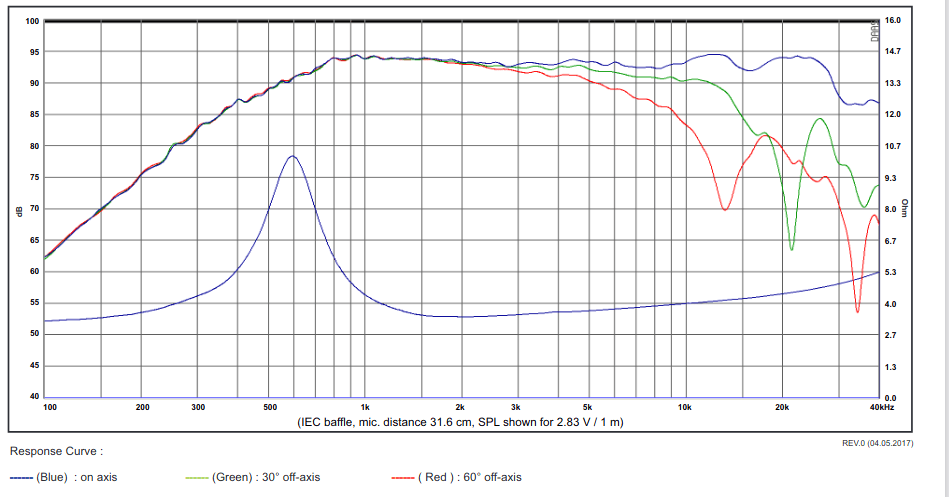

I'm not comfortable with your data files. The Dayton should have an impedance peak at 2k, yours is 2k7, the magnitude is also not correct.
I'd have expected the woofer to become unsuitable after 4k7 due to directivity changes.
Dayton suggests using the tweeter as low as 3k5.
The datasheet on PE is for the ferro-fluid version of this tweeter. This is the old ND20TA-6 for which I have not been able to find the datasheet.

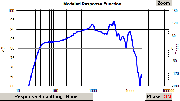

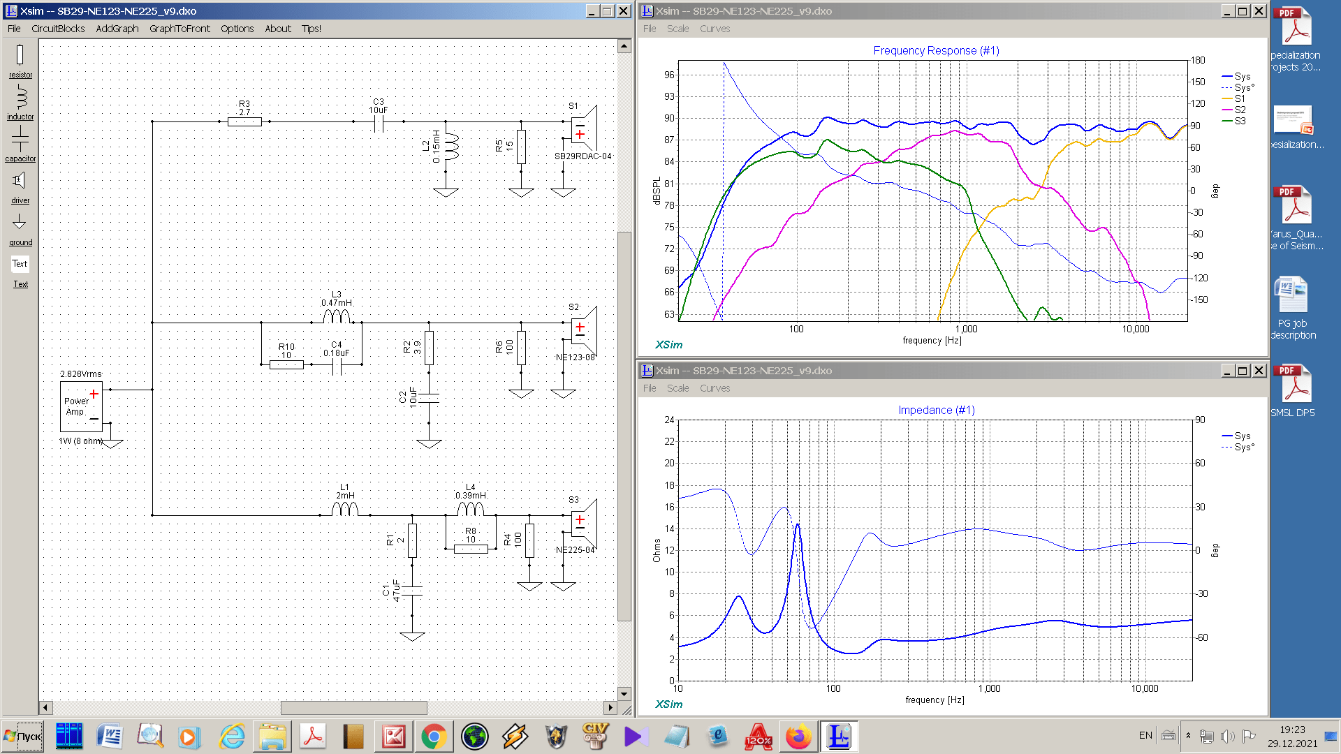

Hi Allen and others,
I have modelled my first crossover that is based on simulated measurements, using Paul Carmody's approach.
Can you provide your opinion and comments? what I should pay attention to?
Overall, the response curve looks ok. There are a few things I'd do at this stage...

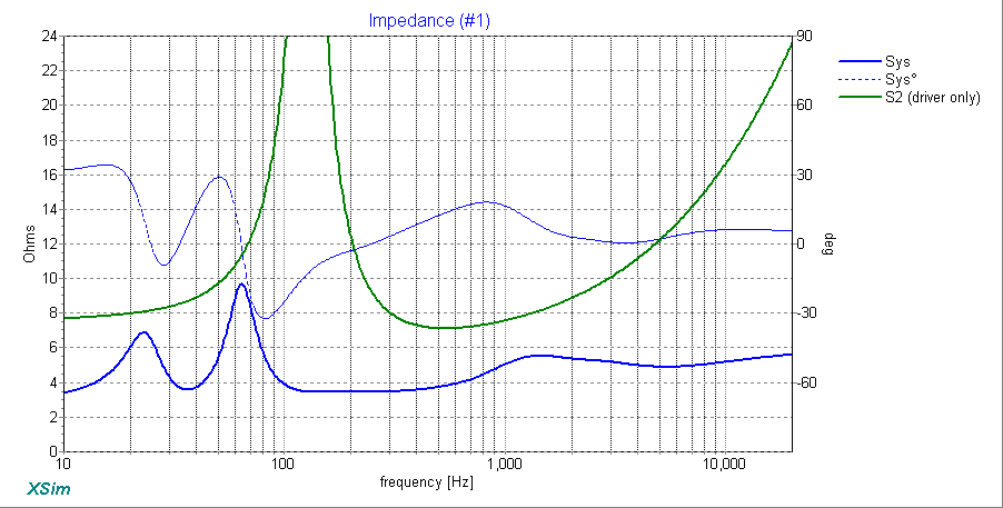

The impedance is low across much of the spectrum. Are these 8 ohm drivers? It would be interesting to compare the response you have here to the original responses. You want to see that you aren't raising them too much and you want to reduce their breakup regions. I'd turn off the system phase plot and add the phase plots of two individual drivers at a time or all three if you can see through them. (This is a big step but it helps you adjust to healthy values.)
Also, have you accounted for your box width?
Aniva, I can't see any High-Pass filtering for the NE123; are you sure it'll be happy getting fed all the LF in parallel with the bass driver without overheating or running out of excursion?
Obviously the cabinet is keeping its output level low there (presumably a small sealed chamber) but that alone isn't always enough.
That's also probably contributing a lot to the low impedance that AllenB has flagged up.

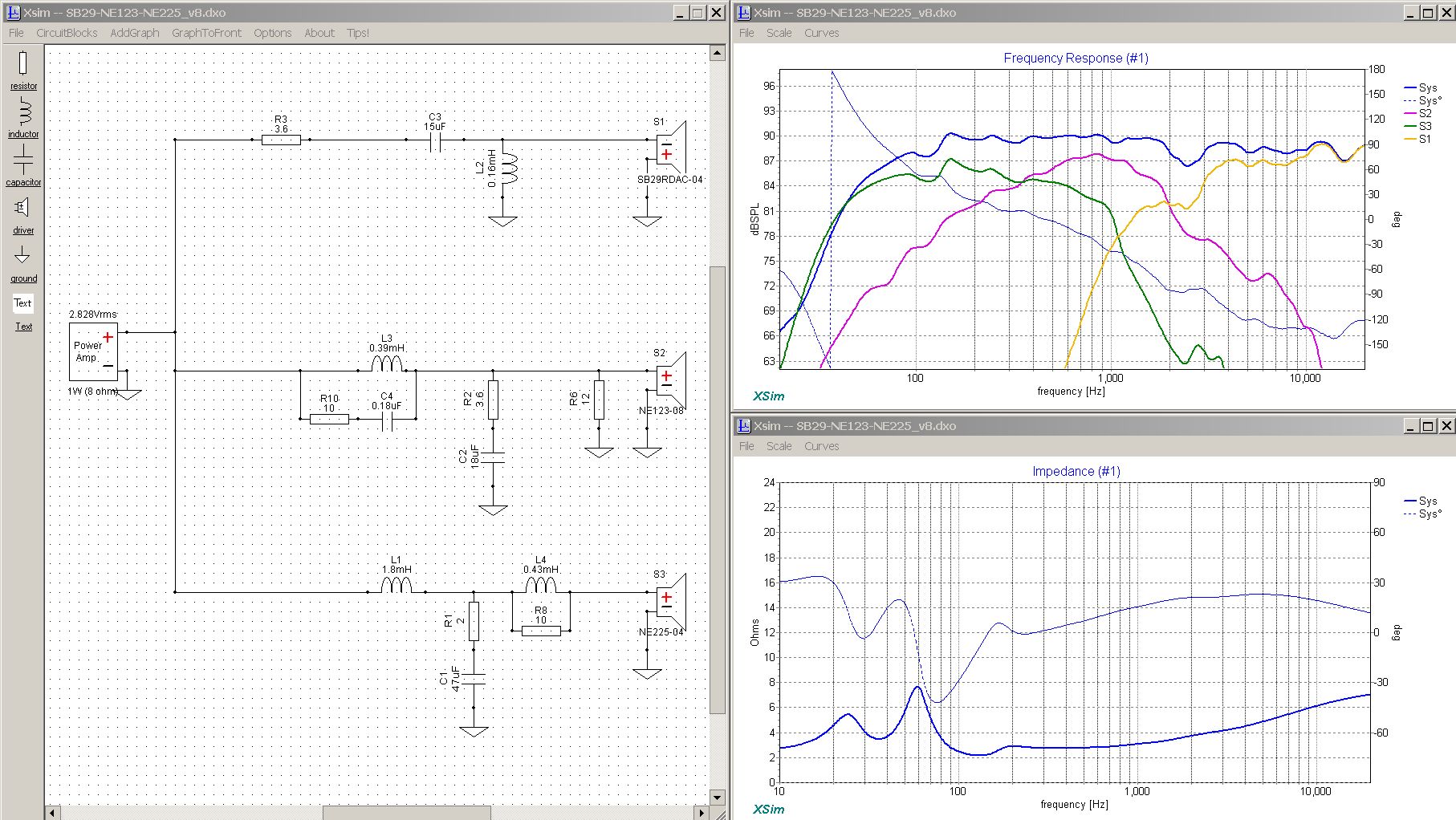

Allen and David, thank you for your replies!
David, you are right. I will use small sealed chamber for mid. Unfortunately, adding High-Pass filter to mid is destroying the response curve.
Maybe I will try to add it again..
Allen, I accounted for box width and drivers positions, using Jeff Bagby's Response Modeler. I am going to use boxes from my current speakers.

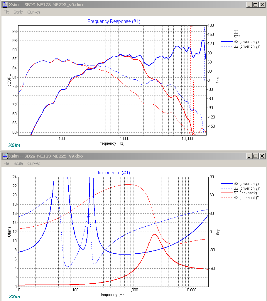

The drivers have the following impedance:
1) Tweeter (SB29RDAC) - 4 Ohm;
2) Mid (Peerless NE 123) - 8 Ohm;
3) Woofer (Peerless NE 225) - 4 Ohm.
I have tweaked my crossover to increase impedance, according to your comments.

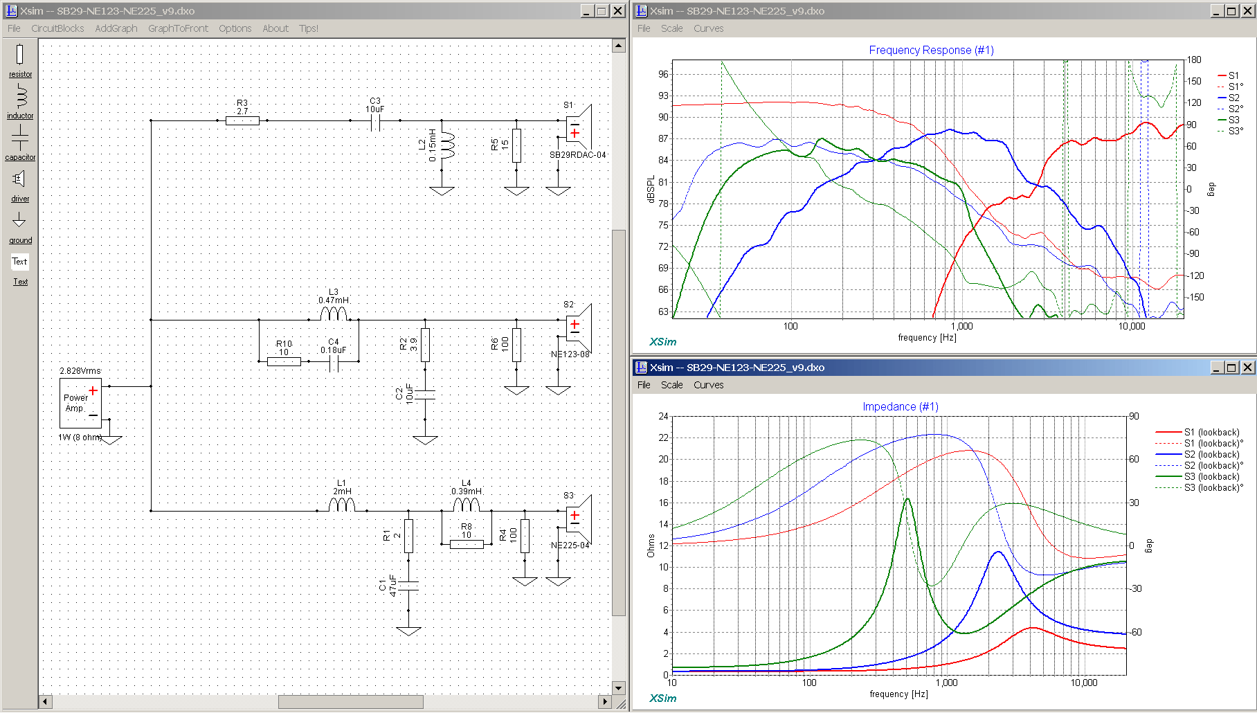

I also generated phase plots.
Please make comments, if you see some pitfalls or ways for improvement.
P.S. Allen, I really appreciate your tutorial for designing crossover! From my crossover you can see that I heavily used it.
Special thank for your openness to question!

Re the HPF for the mid messing up the response curve: welcome to the joys of crossover design!
If you want to post your frd's & zma's I'd be happy to take a shot at it, but I'm a bit of a beginner with VituixCAD myself so no promises that it'll suddenly be perfect 😉

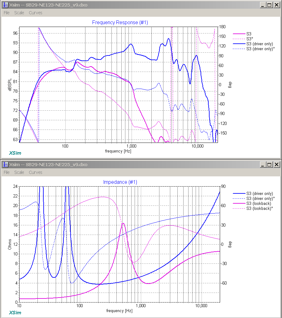

There are a very few cases where you can get away with running the mid open all the way through the LF but as I alluded to before, you'll run the risk of wrecking your sound quality due to increased distortion from the resulting high excursion and possibly damage the driver from overpowering if you go that route. Troels G has a couple of examples, but crucially he uses bigger mids when he does it.
Because your LF is already 4Ω you'll never really get rid of that dip to around 2.5Ω without the HPF, you'll want to check your amp is happy with that before turning it up to any appreciable volume.
Re the phase, what Allen will have been prompting you to check is that the phase of low and mid are similar at frequencies where they overlap, and the phase of mid and high are similar where they in turn overlap, so one graph with the phase of all three individual drivers present would be the most useful way for you to look at that.

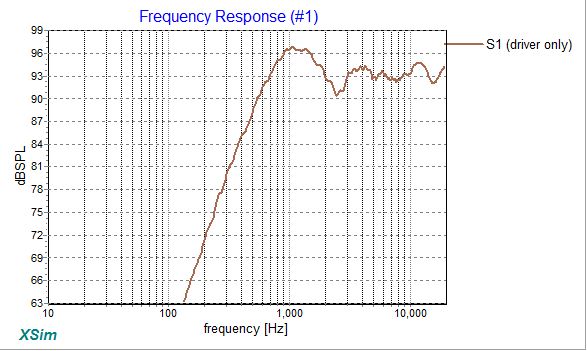

Edit PS: I'm also a little curious about the 3dB step in the woofer response around 130Hz, did that appear when you merged in a predicted LF/Box response to the stock curve for the driver? I can't see anything in the driver's raw response, or T/S parameters that would account for it, perhaps it might be worth rechecking how it got there?

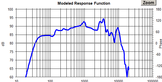

Have checked the PDF for the driver and the response curve is shown for 2.83V input, which is the equivalent of 2W into a nominal 4Ω load. If you modelled the LF at 1W, that would be exactly the 3dB difference visible on your traces.
David, you are right again) 3dB step in the woofer response is baffle step diffraction.

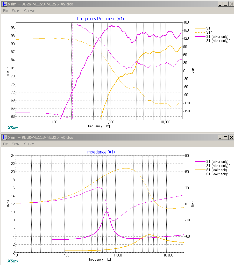

I did combined phase graph, hope it will work.

I have also checked others DIY crossover designs (Troels) with 4Ohm woofers, they have 2.5 Ohm. I agree with you without the HPF, I will not manage to increase impedance in that area.Because your LF is already 4Ω you'll never really get rid of that dip to around 2.5Ω without the HPF, you'll want to check your amp is happy with that before turning it up to any appreciable volume.

Your midrange highpass needs to work with the impedance. Your data is a difficult vented impedance. Unless you have something better you should work with the factory impedance data because it is closer to the closed box you mentioned earlier.

If that 3dB step @ 130Hz were bafflestep, it would imply a baffle at least 900mm on its shortest dimension, however your HF response is more consistent with a baffle about 250mm wide, could you confirm the baffle size you're working with please? The gentle slope down from 800Hz to 200Hz on your LF response would be more consistent with that 250-ish baffle size

Allen, you made a very good observation about midrange impedance. I resimulated it, as for small closed box, and got overall better result for system impedance with min about 3.5 Ohm.Your midrange highpass needs to work with the impedance. Your data is a difficult vented impedance. Unless you have something better you should work with the factory impedance data because it is closer to the closed box you mentioned earlier.
David, you are absolutely right, the baffle is 250mm wide.If that 3dB step @ 130Hz were bafflestep, it would imply a baffle at least 900mm on its shortest dimension, however your HF response is more consistent with a baffle about 250mm wide, could you confirm the baffle size you're working with please? The gentle slope down from 800Hz to 200Hz on your LF response would be more consistent with that 250-ish baffle size
BTW, do you own the drivers already? I know you said you were hoping to re-use an existing cab, wasn't sure if that applied to the drive units too.
I believe, the 3dB step @130Hz is artificial. I have reapplied baffle step diffraction response on woofer from 300Hz, before it was from 100Hz.
Please see in attachment.
