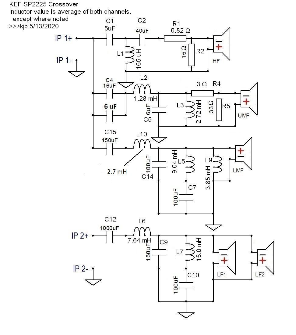

Hello gents,....I'm reasonable new to diyaudio and refurbishing vintage equipment. Main focus has been refurbishing Harman Kardon amplifiers from teh '80 which I kinda like to do🙂...I jus stumbled upn this quite interesting thread and I've pretty much read and understood the first few posts. I have a set of Kef Reference Model Ones from the '90 which I'm driving with a H/K PM645VXi which I fully refurbished last year. Although i hink it all sounds great there is always room for improvement I'd say and the corssovers are obviously also almost 30 years old.
My question is,...is there any benefit of recapping, refurbishing the cross-overs and/or change the crossover frequencies for that matter? I have inserted the speaker specs but have not found tweeter, midrange or woofer specific specs....yet.

A simple crossover can often be improved by designing one that is more specific, especially if you are able to measure. However there are times when you can make simple improvements as well. Apart from choosing values that you find improve the tone, sometimes a manufacturer skips using a resistor on a tweeter due to cost.. not that a resistor is always needed.
Another example is when they don't use an inductor on the woofer and the upper midrange is too bright. If you make changes like this then you'll probably want to look at the tweeter cross next to help balance the midrange. Rarely you might find the tweeter doesn't want to blend, or doesn't want to be crossed lower, and you have to go deeper into the design.
In a lot of cases you don't need to change old capacitors. Electrolytics might vary with use over time and it would help if you could measure them to see their value is near original. When unsure, you can change them.
Thx Allen,....understood and all makes sense. I will unmout one and have a close look at the components and circuitry and reverse engineer what they trying to do in the 3 drivers.

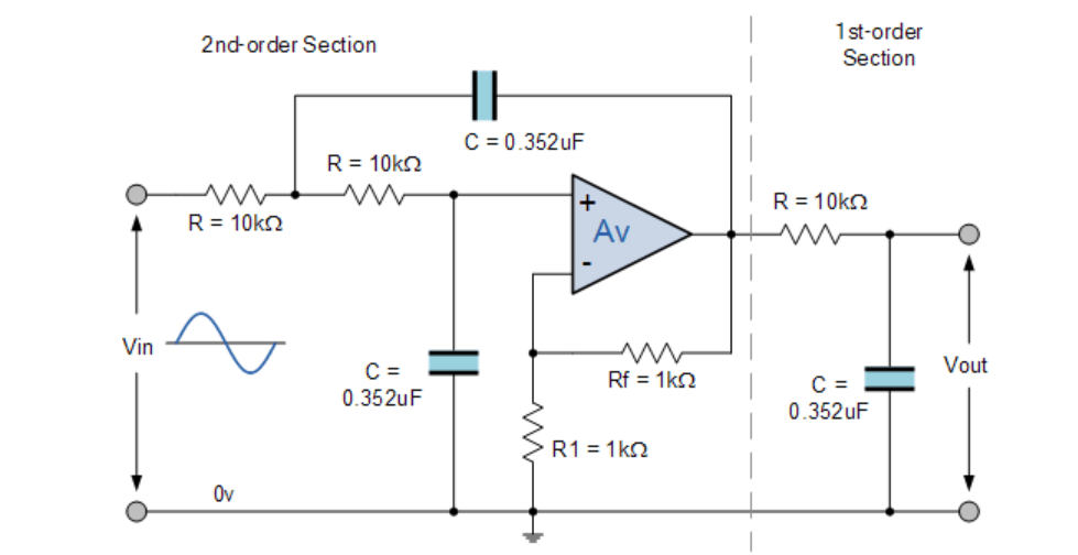

First doing some learning. Found these articles on Butterworth filtering. A complete new world for me and quit interesting indeed.🙂🙂

That filter is the low-pass version of a second order high-pass, equivalent to the capacitor/inductor tweeter filter from this thread. Since capacitors alone don't resonate the way a capacitor does with an inductor, this circuit uses the gain of the op-amp to push up the response. This is why it is also known as an active filter.
