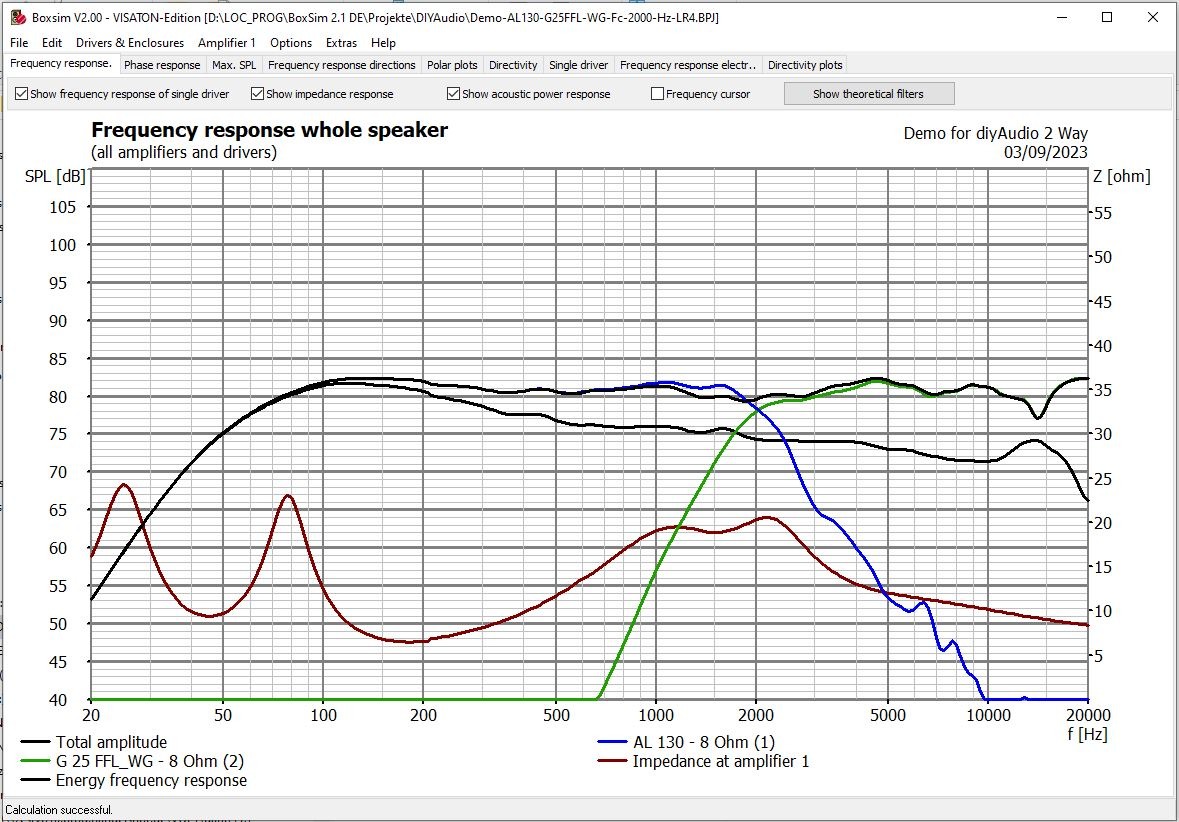

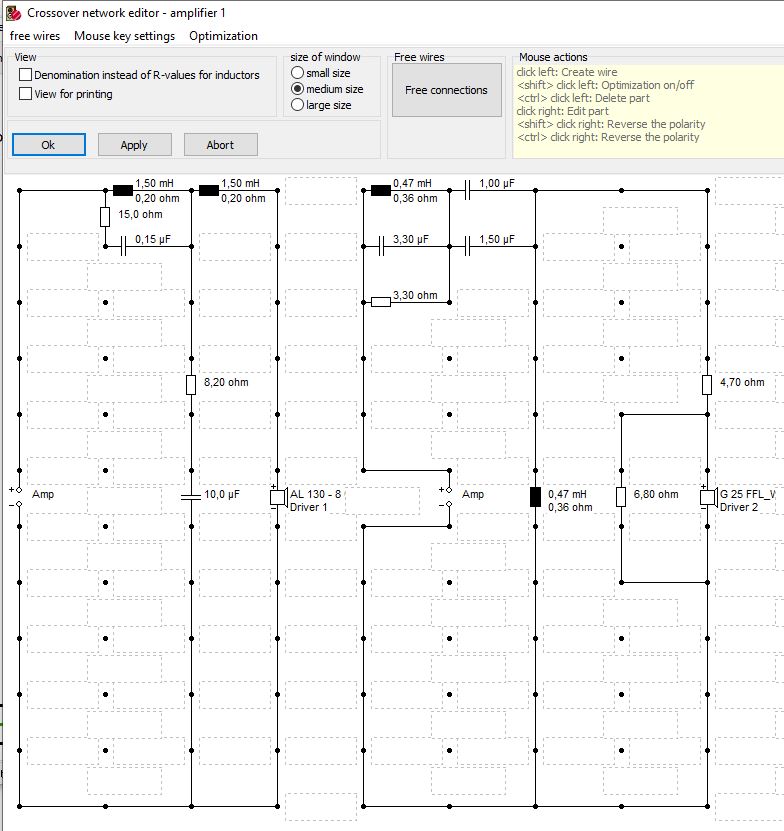

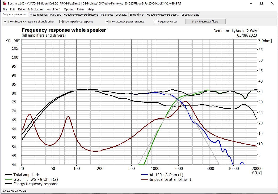

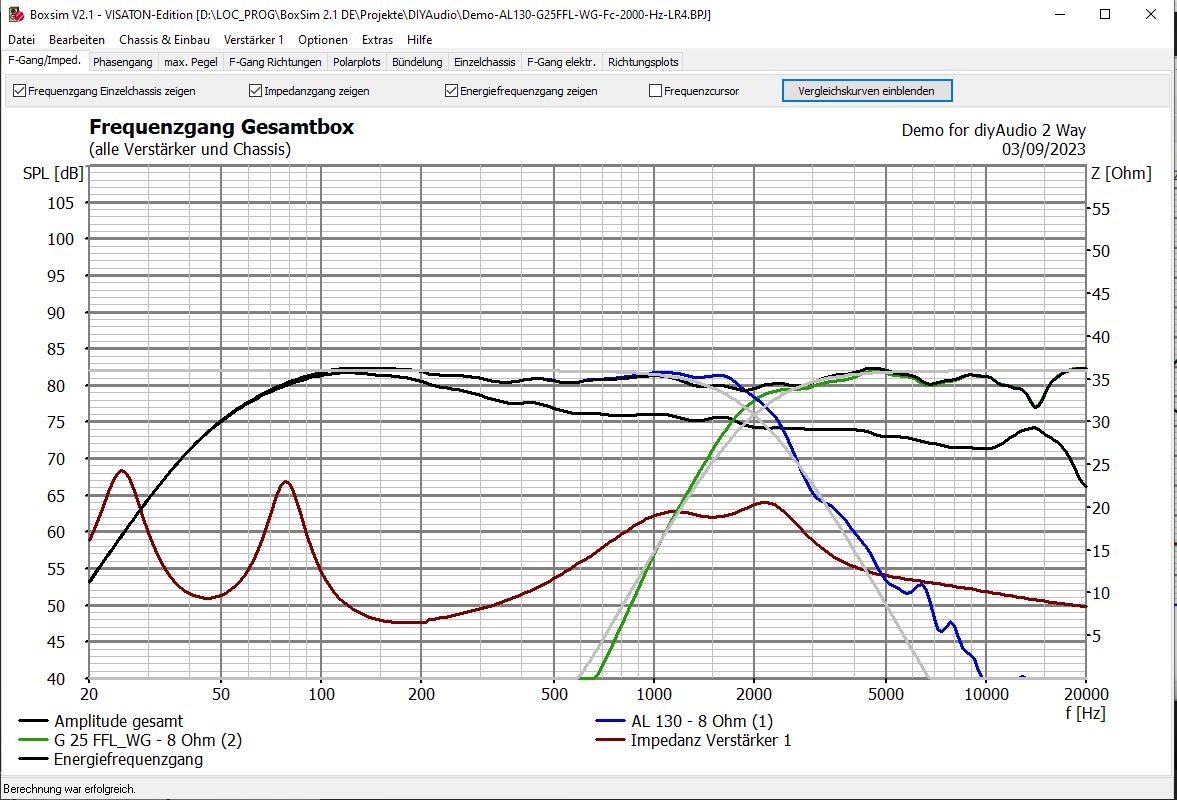

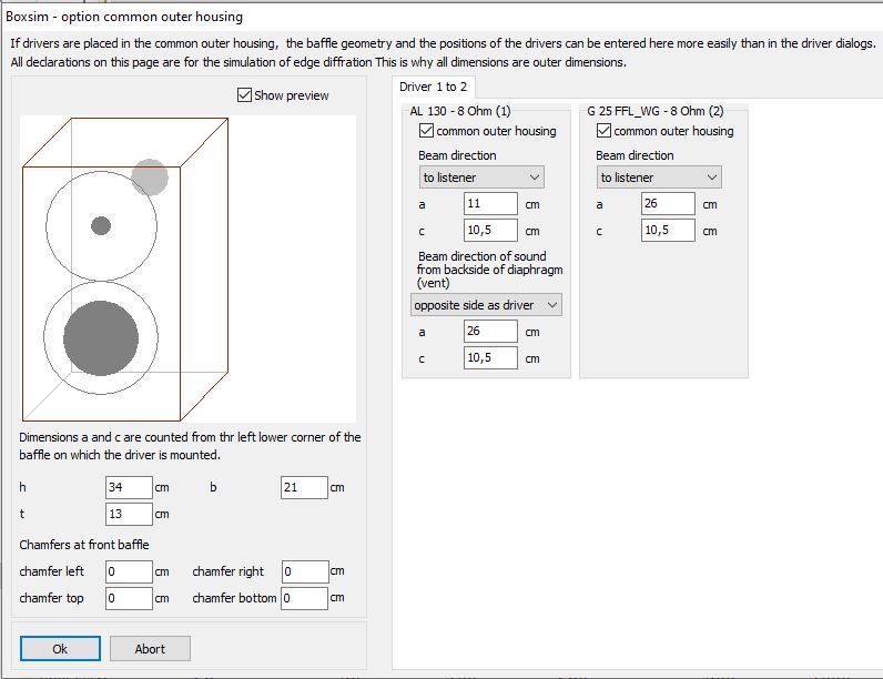

I have a question for this thread - is it meant to develop a passive crossover circuit without measurements AND without simulation software? If this is the case i wonder if it would be possible to come to a similar result like i found using Boxsim and Visaton chassis (used only as a demo because of the good measurements of Visaton used for Boxsim with the 19 measurements from 0 to 90 degree in 5 degree steps) for a fairly simple demo two way bookshelf speakers with this chassis:
A )
Midwoofer Visaton AL130-8
B )
Tweeter with waveguide
Visaton G25 FFL with round Visaton waveguide
One good thing about this choice is that you get a quite good time alignment with a very simple baffle. Here the screenshots: Demo-diyAudio-2way-bookshelf-FR-Capture.JPGDemo-diyAudio-2way-bookshelf-housing-Capture.JPGDemo-diyAudio-2way-bookshelf-CO-Capture.JPG
added additional screenshot from german version with the theoretical filter curves Fc 2000 Hz LR 4 81 db

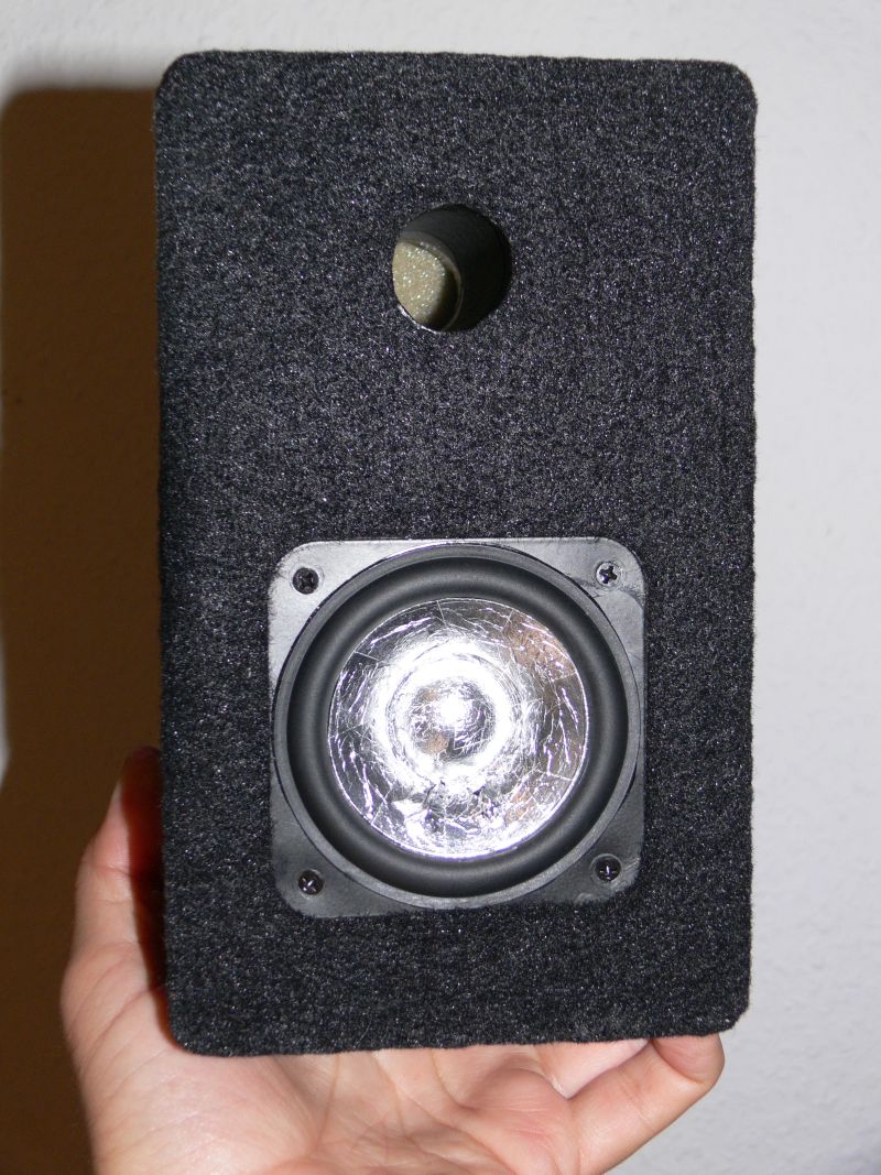

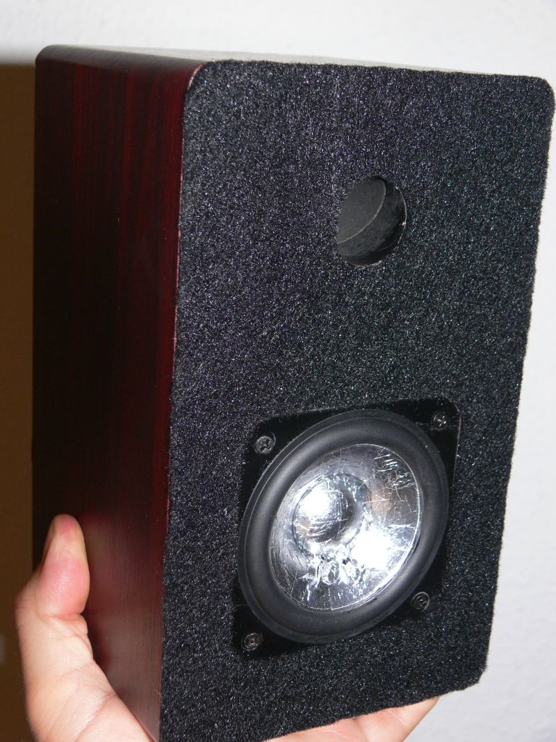

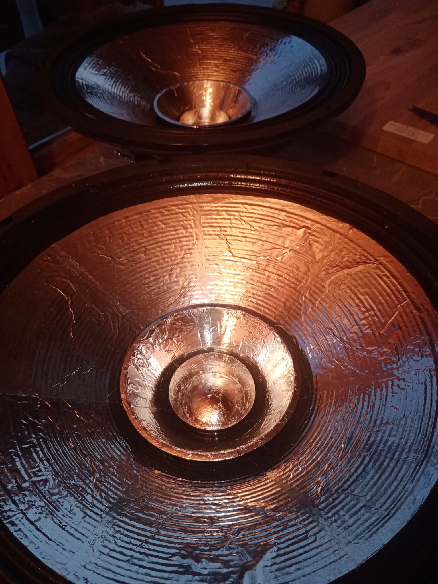

I enjoy a lot fullrange loudspeakers with current drive amplifiers which correct the sound of fullrange drivers "automatically".
Then putting aluminium foil on paper cones up to sandwich construction brings high end sound to these type of drivers which are naturallly time coherent if the frequency response is linear.
See for aluminium foil on paper cones: https://www.diyaudio.com/community/threads/how-to-make-a-loudspeaker-sandwich-cone.402917/
Current drive amplifier DIY (thread started by me): https://www.diyaudio.com/community/...-to-current-drive.389985/page-12#post-7450603
With positioning of fullrange drivers close to a back wall or a corner the baffle step in the frequency response can be cured without any crossover network.
