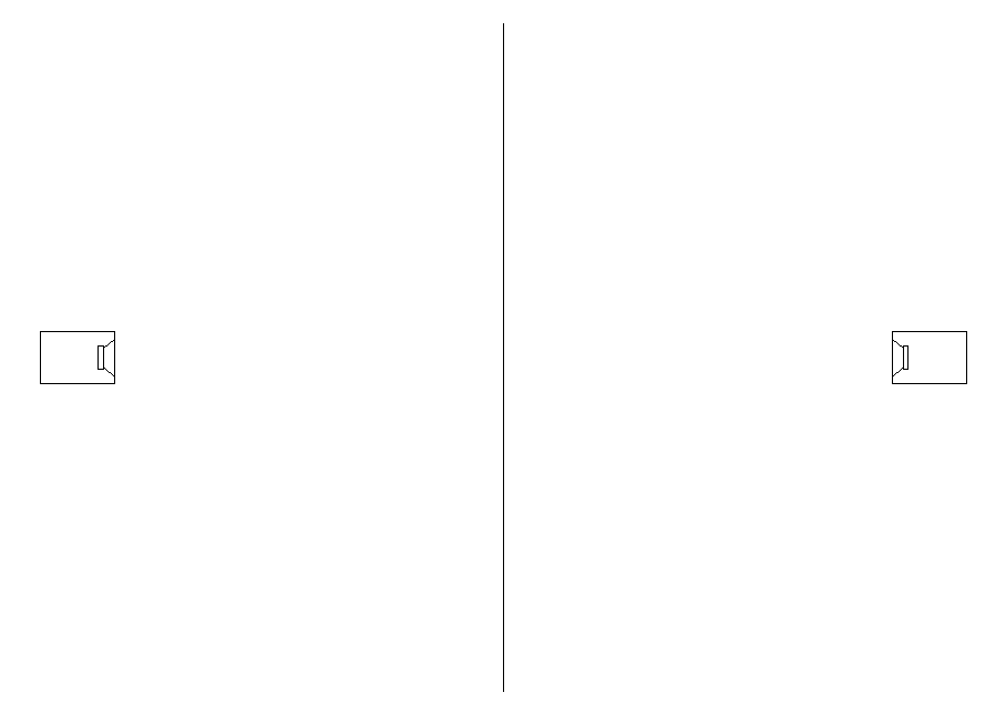

If you have speakers placed far apart then you'll also measure +6dB SPL. For example by measuring from any point on the line in the illustration, compared to turning off one speaker and measuring from the same spot.If they are spaced closer than approximately 1/4 wavelength apart
Of course with that much separation you get directivity effects, such as lobing. Lobing is where sound cancels at some angles, and it can be a good thing if wanted, or a problem if not.

It's a common misconception that something happens to pressure when the drivers are acoustically close, but there is no magic, no synergy. You get +6dB on a pressure measurement regardless.
@AllenB No, you will not always measure +6db.
And you've just illustrated an example. Move your microphone somewhere else other than on that line, and you will not see +6db. Variables, variables, variables.

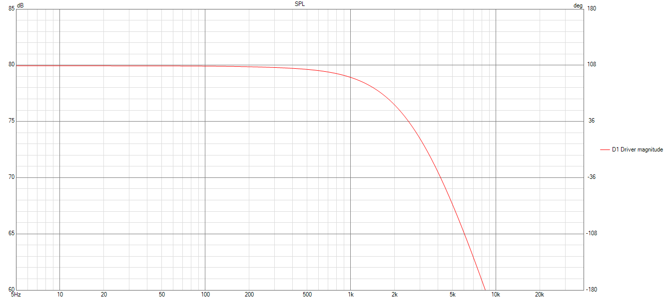

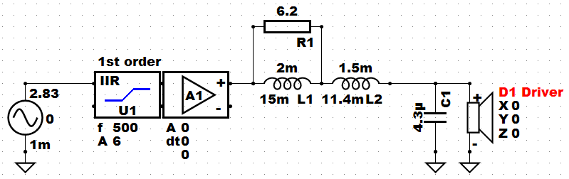

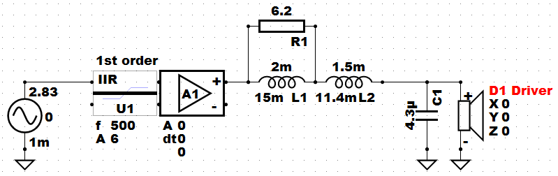

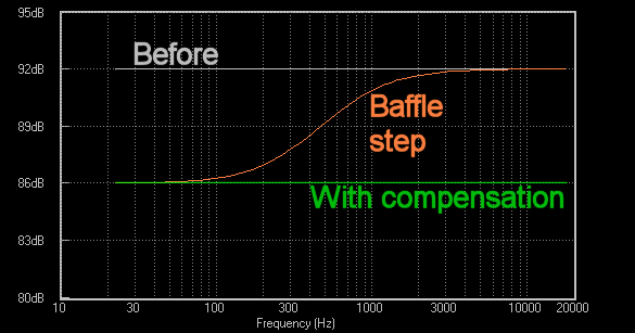

To better illustrate how the Baffle Step Compensation (BSC) circuit works, I've come up with a modification to the above circuit. The aim was to include the baffle step in the actual response of the loudspeaker driver, which is flat from 5Hz to 40kHz in a VituixCAD model. The way I accomplished this was to include a Power Amplifier component ahead of the crossover circuit. This amplifier was itself preceded by a 1st-order Active Shelving High Pass component, with its frequency set to 500Hz and amplitude set to 6dB. Using the component values from the original circuit, the resulting response is shown below. It produces a nice filter shape, with a –3dB point of about 1800Hz.BAFFLE STEP DIFFRACTION

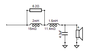

..or you can use a BSC circuit. Here it is with the 6.2ohm resistor across the 2mH inductor, which have been added to an existing crossover. The inductor trims more of the high frequencies and the resistor limits how much extra they will be reduced. This creates a shape the opposite of the baffle step shown above.
The VituixCAD circuit model used to produce the above is shown below.

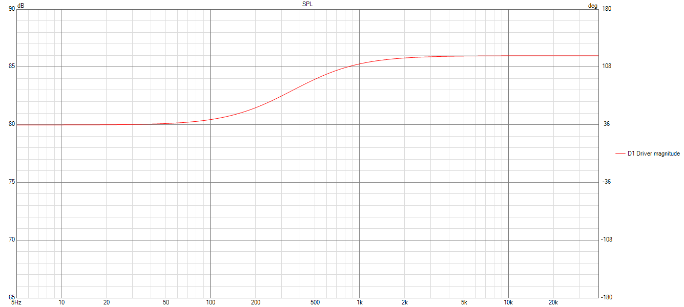

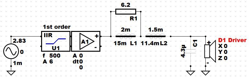

To see what the response of the simulated baffle step is like, simply short-circuit the two inductors and open-circuit the capacitor, as shown below.

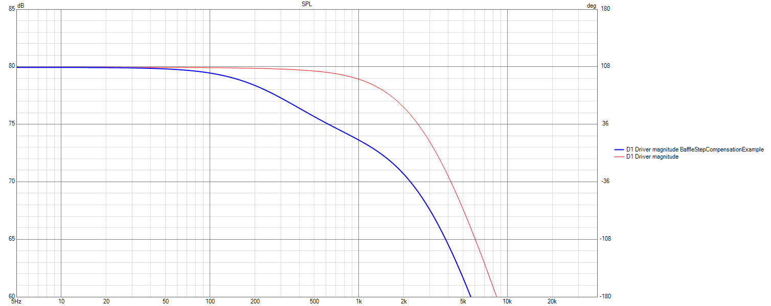

The resulting frequency response plot shows the effects of our simulated baffle step.
The filtered response without including the frequency response function of the baffle step looks like the following.
The circuit setup used to obtain the above is shown below.

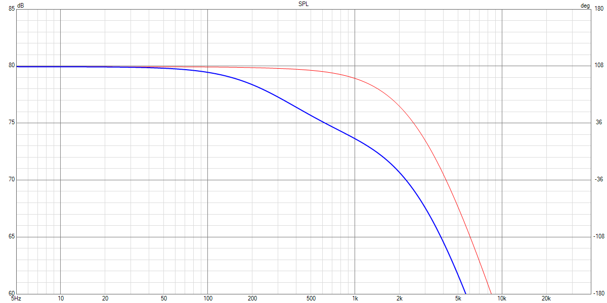

A comparison of the acoustic filtered responses with (red line) and without (blue line) the baffle step in action, on the same plot, is shown below.
