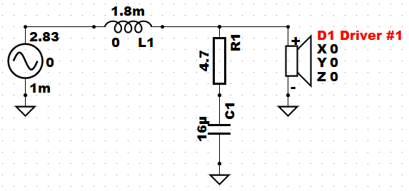

Can you provide the attendant circuit diagram of the filter network that was referred to above? I can't seem to get my idealizations to work the way I expected.
Sure.
Reactions: witwald

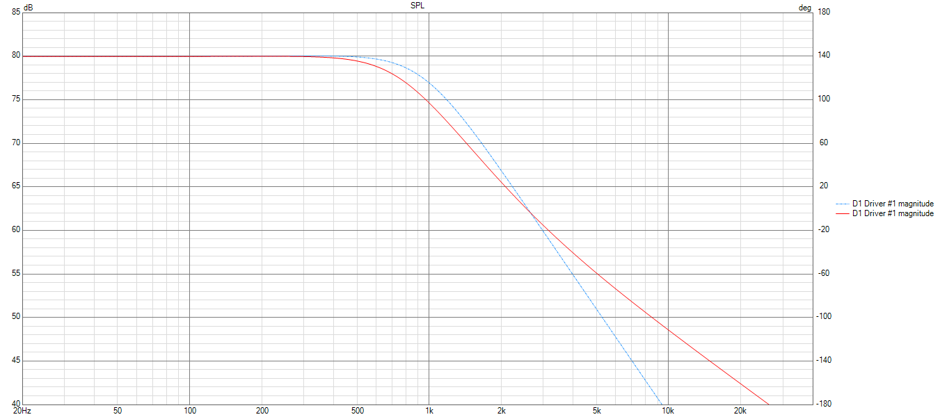

Thanks for the circuit. I've set it up in VituixCAD as shown below.
The resulting filtered frequency response curve is shown below using the red line. As expected, at higher frequencies the roll-off rate is less than second-order, due to the impedance of the series RC leg becoming dominated by the resistor.
In addition, for comparison purposes, the blue line corresponds to the above circuit with resistor R1 short-circuited. In this instance, the response seems to be much more like a theoretical 2nd-order Butterworth filter response function, with a 12dB/octave roll-off rate.
Nonetheless, it gives the correct response for that speaker. I’ll go into a little detail about the process in determining this.
This was a 15” woofer crossed to a waveguide, so the cross is snug against the natural upper rolloff. I was using Speaker Workshop as a simulator which explains the unique looks and smoothing parameters.
I used full polar measurements to determine that I could cross on top of the relatively benign 1st breakup mode. This allowed me to get the “kick” I needed to flip to a steep crossover slope. The real reason for crossing there of course, was to match directivity.
The resistor isn’t a standard Zobel value, it was there to tune the damping of the knee of the rolloff and in this case it gave me the control I needed to get that right.

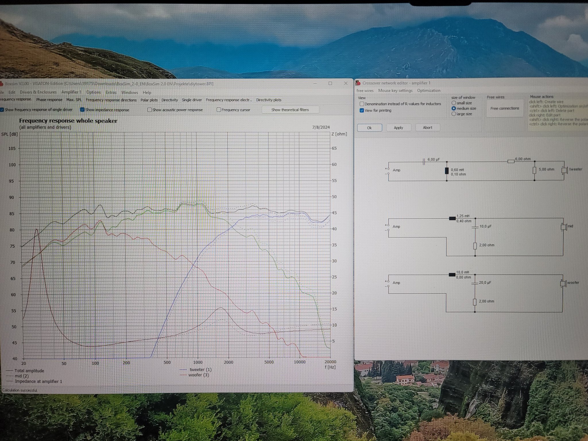

I am building a 2.5way tower using the Satori TW29DN-8 tweeter and two MW16-P midwoofers. Currently using the traced infinite baffle data for the drivers, which I loaded into both BoxSim and VituixCad. I found it easier to add the enclosure and model baffle step in Boxsim.
I just picked up an EMM6 measurement mic, but havent figured it out yet.
Here is my target for my first go at a crossover based on modeling from the traced data.
Other than that one 10mH inductor part, I have the rest of the components on hand to easily test.
One thing I am a bit concerned about is that plateau between 700hz-1200hz. How would I go about trying to flatten that part?

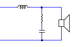

There are many ways to make such changes, it’s possible to get very fine control of response shape with passive components.
However it’s not always readily apparent how, and sometimes it can take a little work. I’ve given some examples in earlier posts of how the schematic can relate to the needed shape.
The first thing I’d do in this case is try tweaking each of the three existing components to see whether any has enough control over the problem region without affecting other areas too much.
The next thing I’d try is a bandstop filter. This is also known as a notch filter or band reject filter depending on where and how steep it is.
There are two main varieties to begin with. One involves a resistor, capacitor and inductor in parallel, the three inserted as an element in series with the existing inductor. Tweak the values as best you can.
If that isn’t satisfactory you can always try a resistor, capacitor and inductor in series, with that string placed in parallel with the driver.
Sometimes you can get greater control using two such filters together, with the frequencies side by side if that gives you the needed shape.

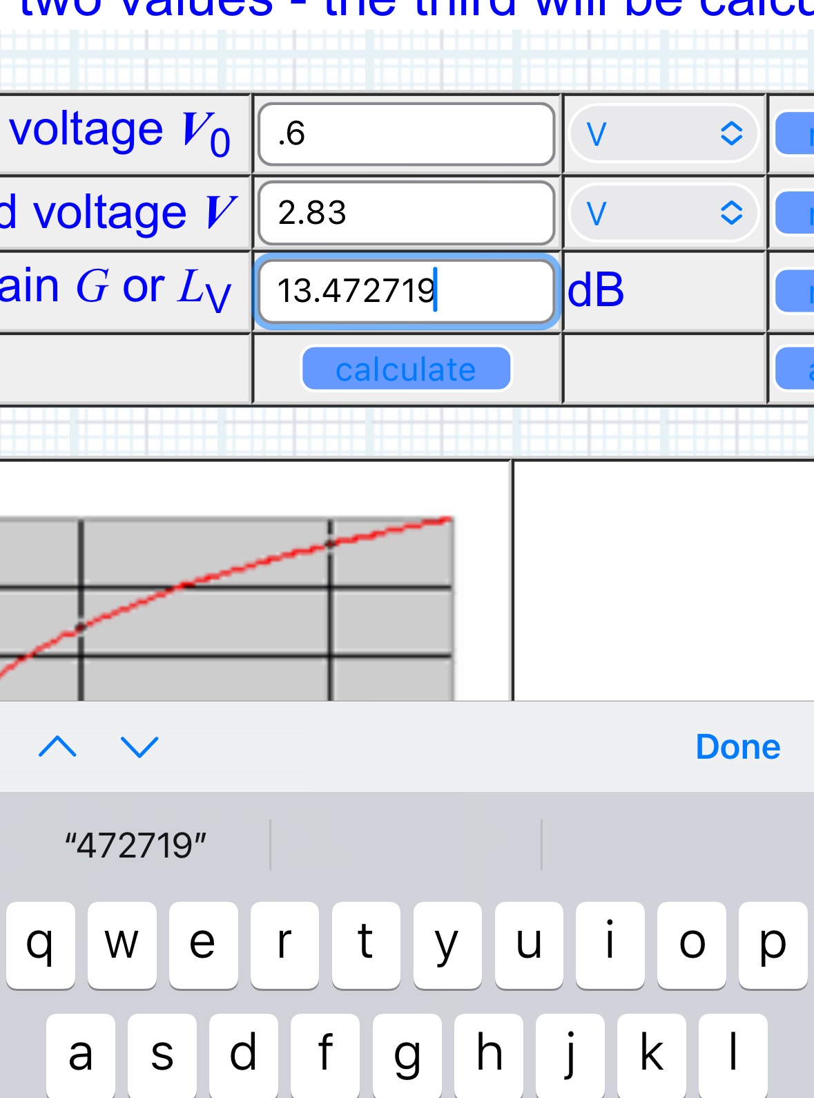

At 2.83 volts you won’t break anything. Measurements down to the resonance of your tweeter will be okay.
Sometimes in REW 2.83 volts will be too much and may overload REW. With a usb interface you should be able to reduce the input level to REW.
A reference voltage is not always practical
It might be only 0.5 volts.
This can be verified with the oscillator function in REW using a sine wave. Simply take an AC voltage measurement with your voltage meter at a known frequency.
To convert to 2.83 volts for your simulator use this online calculator
https://sengpielaudio.com/calculator-gainloss.htm
In REW you can add the magnitude difference in the calculator to normalise your FR measurement. Then export this normalised measurement to your simulation using the export function. Typically this is a text file ending in .txt
Obtaining the relative difference in FR spl is important because the levels in your simulation must equal when performing the crossover transformation.
This may require a resistance voltage divider if you are simulating a passive network.

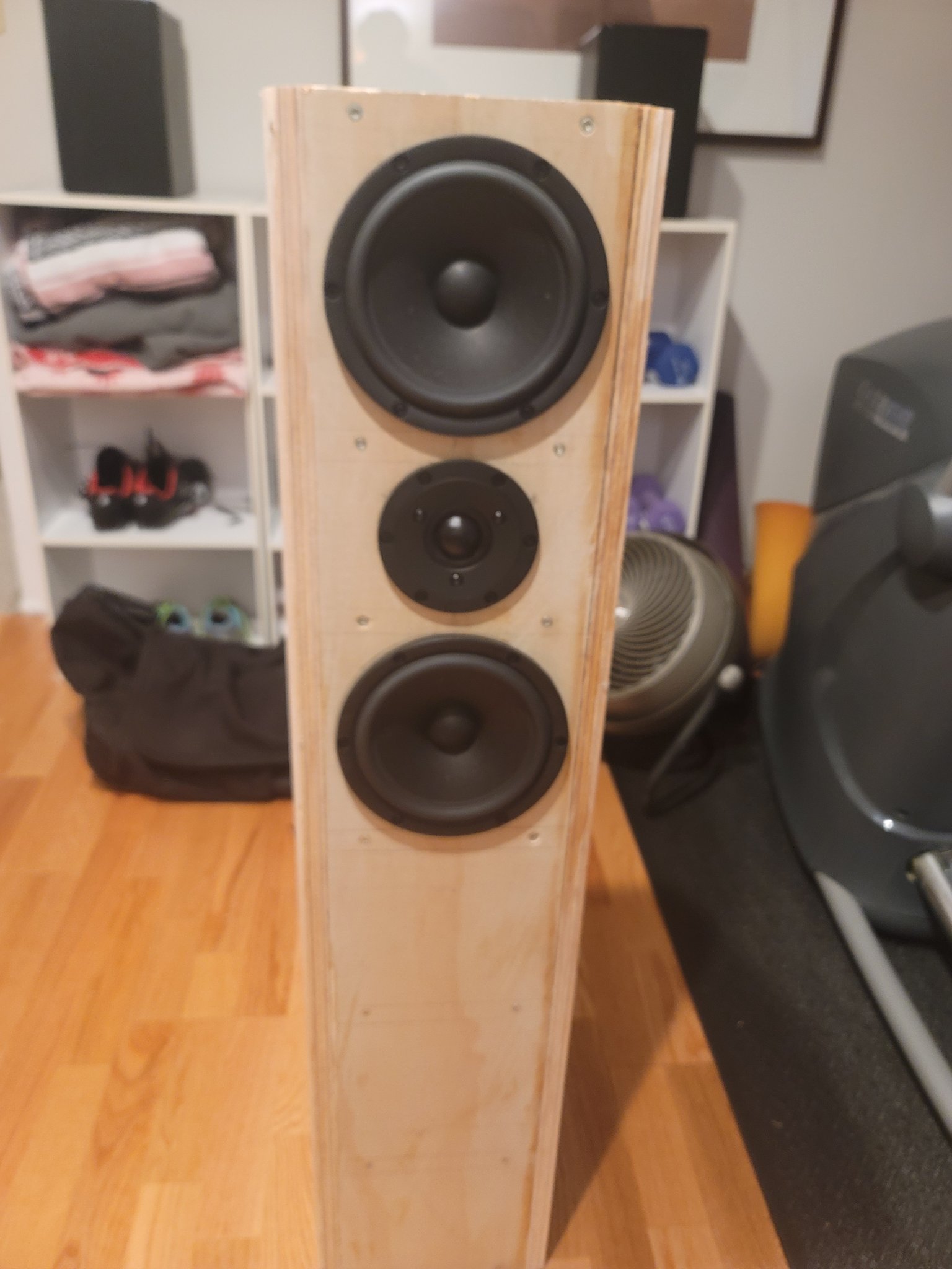

Well, back to the drawing board for this design. I had tried an MTM format, 15cm between tweeter and midwoofers, and 30cm between midwofer centers.
I was able to get a fairly smooth result. Sounded great on most stuff! But, the midrange just sounded smeared on complex passages, especially vocals. I guess it is from just too much driver overlap below the crossover, and possibly too much distance between the midwoofers in that critical midrange area.
I plan to switch to a 3 way design now. I am considering swapping out that lower Satori driver for an SB-17CRC (which I have in a 2 way bookshelf right now), perhaps even double up the woofer then.
